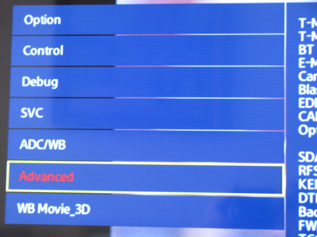

            After giving 0000 I have only got one item more in the menu. Watch the foto. The item Advanced is still unavailable.

              Re: TV Samsung UE48H6470-only 3 countries in setting
              Advanced is not a real sub menu page.
              Just some kind of activator.
              Now,after you activate Advanced,check again all menus and submenus maybe more options are available or some grayed out before are accessible.
              Advanced needs to be activated each time you enter service menu.
              On some models,don't know if on all,there was another command to enter some level of service menu,3speed or something like,found some info on sammygo wiki.
                I am sorry, no progress. I can not see any new item in menu. And if I could see the grey items, it would not be useful in my case.
                Would it be helpful for my cese (to set Local) to buy the Samsung AA81-00243B Original Remote Control?

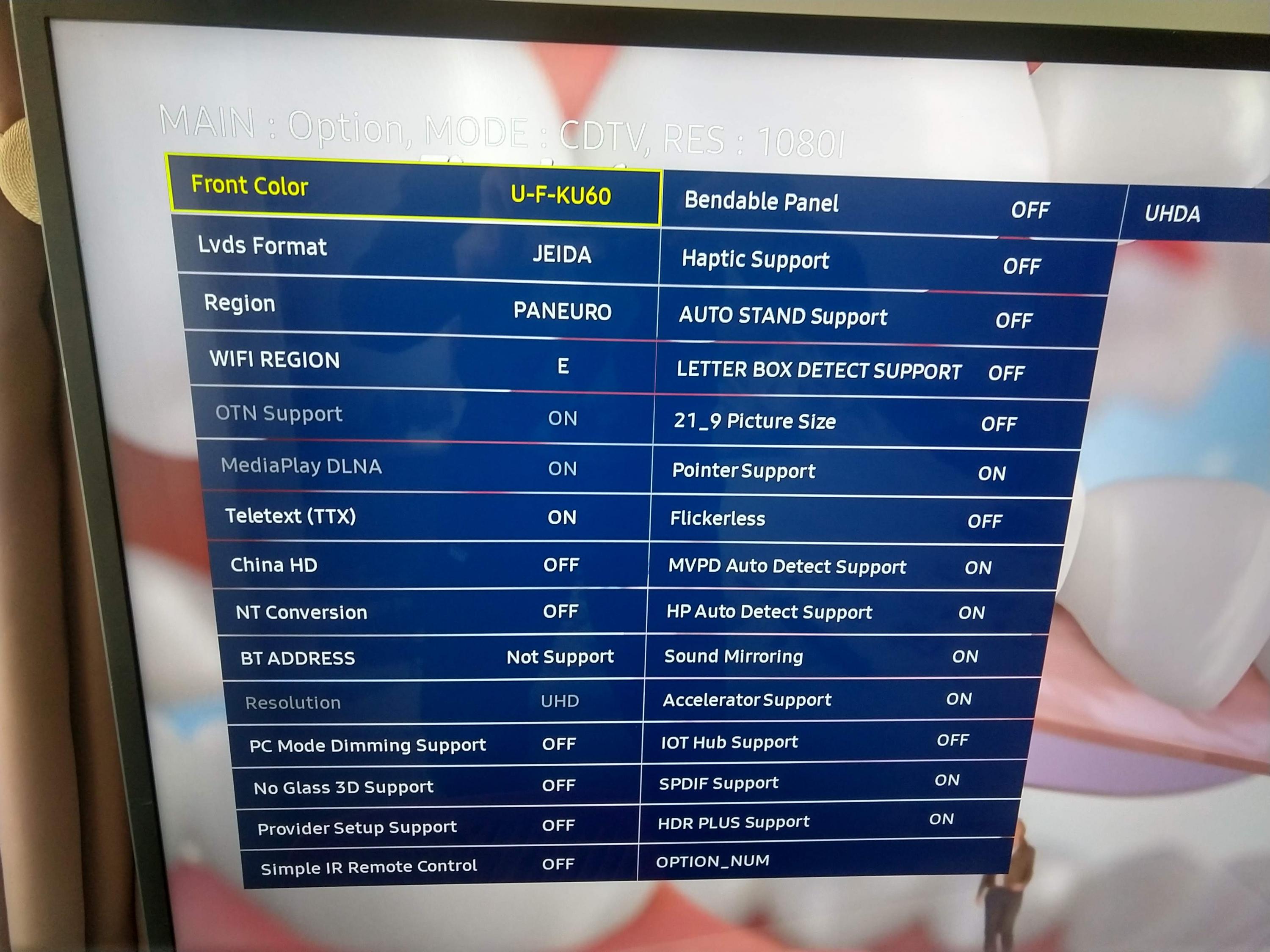

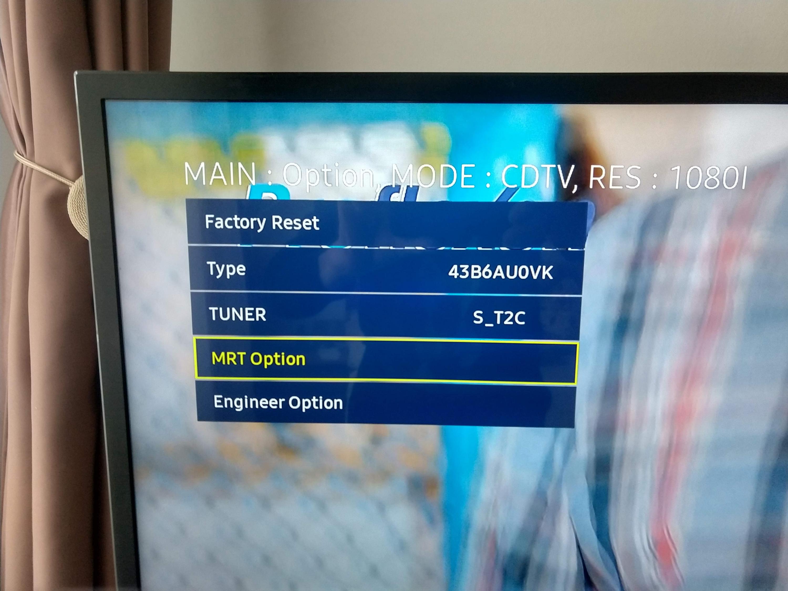

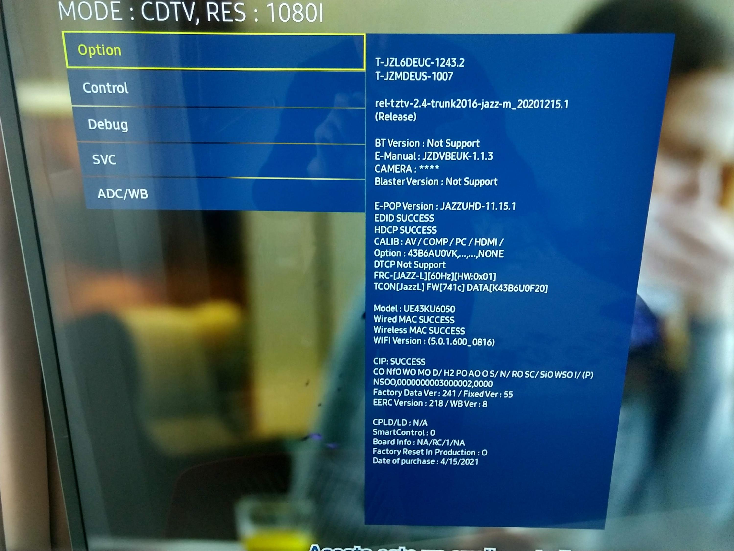

                                        My problem is similar. I have a Samsung UE43KU6072 with BN94-11273D / BN41-02528A main and CY-GK043HGEV1H panel. Defective motherboard. It has been replaced with another board WITH THE SAME CODE AND FOR THE SAME PANEL. The difference is that the new board has NO INPUT FOR LNB. But it comes from a Samsung UE43KU6050 not UE43KU6072. When selecting countries for channel scanning, it has ONLY ITALY. Samsung does not offer software update for UE43KU6050 but does offer for UE43KU6072. From the service menu I don't think there is the possibility that the colleague above had. Ideas ?.

                                          #40
                                          Not sure if it will work but can try, with tv on press 289 ff 289 f and see if a menu comes up.
