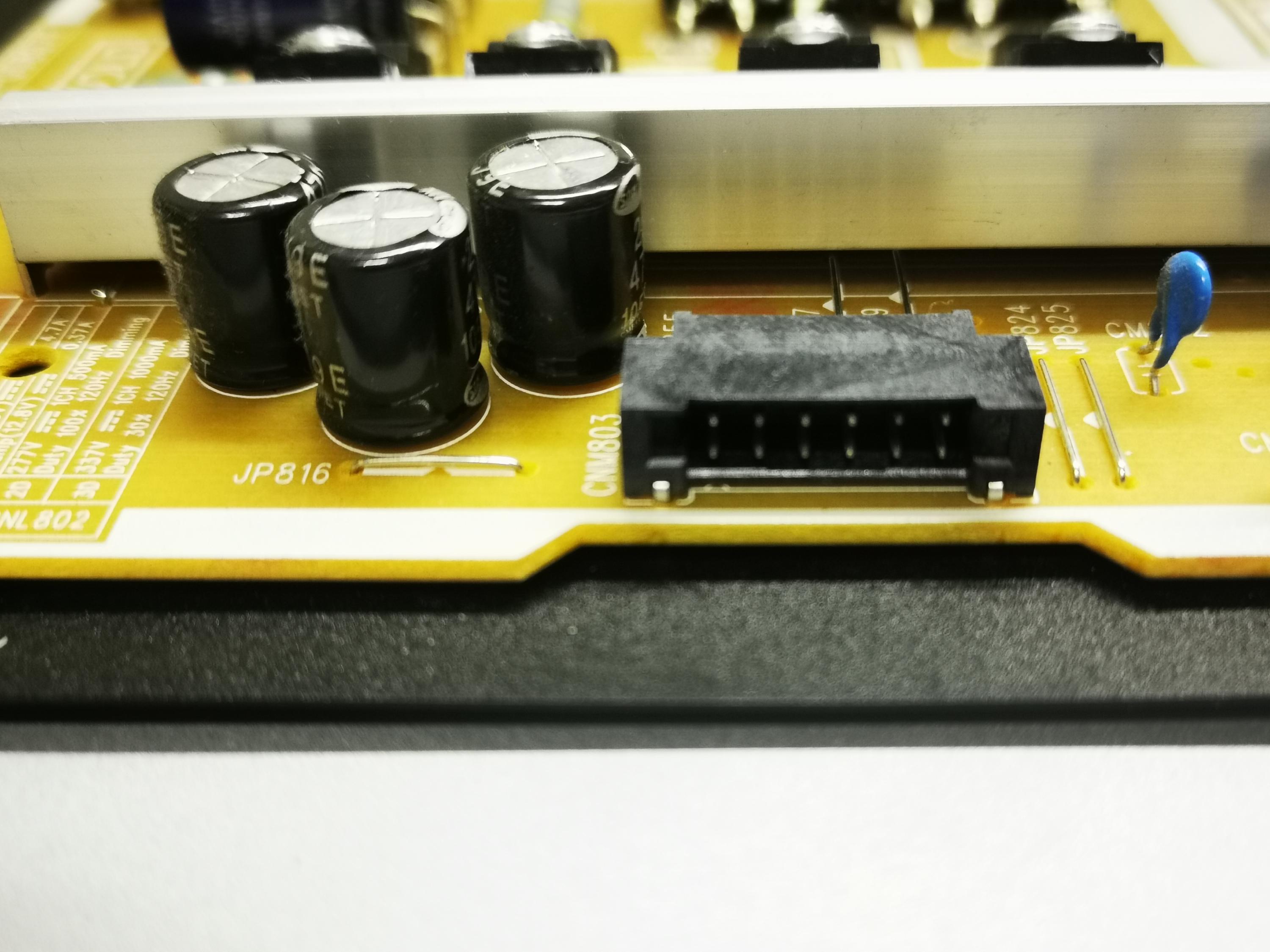

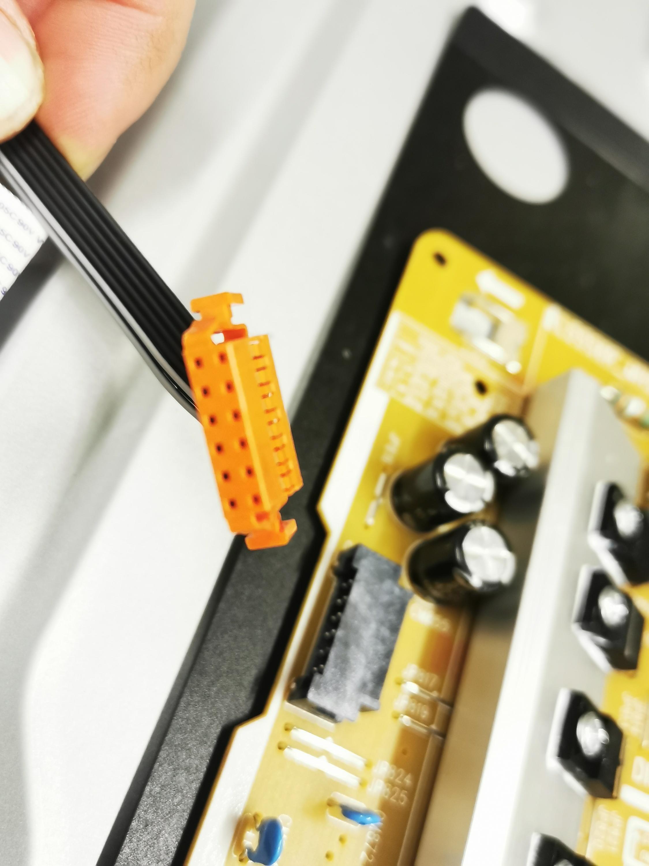

    @dick_barton
    So with the main board disconnected, the back lights don't come on.
    With the main board connected, the back-lights still do not come on. Just a single blink of the standby light. I don't hear menu sounds or anything like before.
    At the connecter I reported on earlier, with everything plugged in, at start up I get 380VDC and it slowly creeps downwards. After about a minute it only just falls to 250VDC.
    In AC it fluctuates, and strangely it doesn't really differ from start up or even when the unit is off. The first 3 figures I get are 4 digit numbers which I guess are mVs, then I get 25~V, then 140V~189V. At this moment I just tested this again with boards unplugged and plugged in, and it seems as though it always slowly comes down. 189V looks like the most normal figure and that drops off a few volts each time it comes back around
    I have posted a picture of the connector highlighted in your previous picture

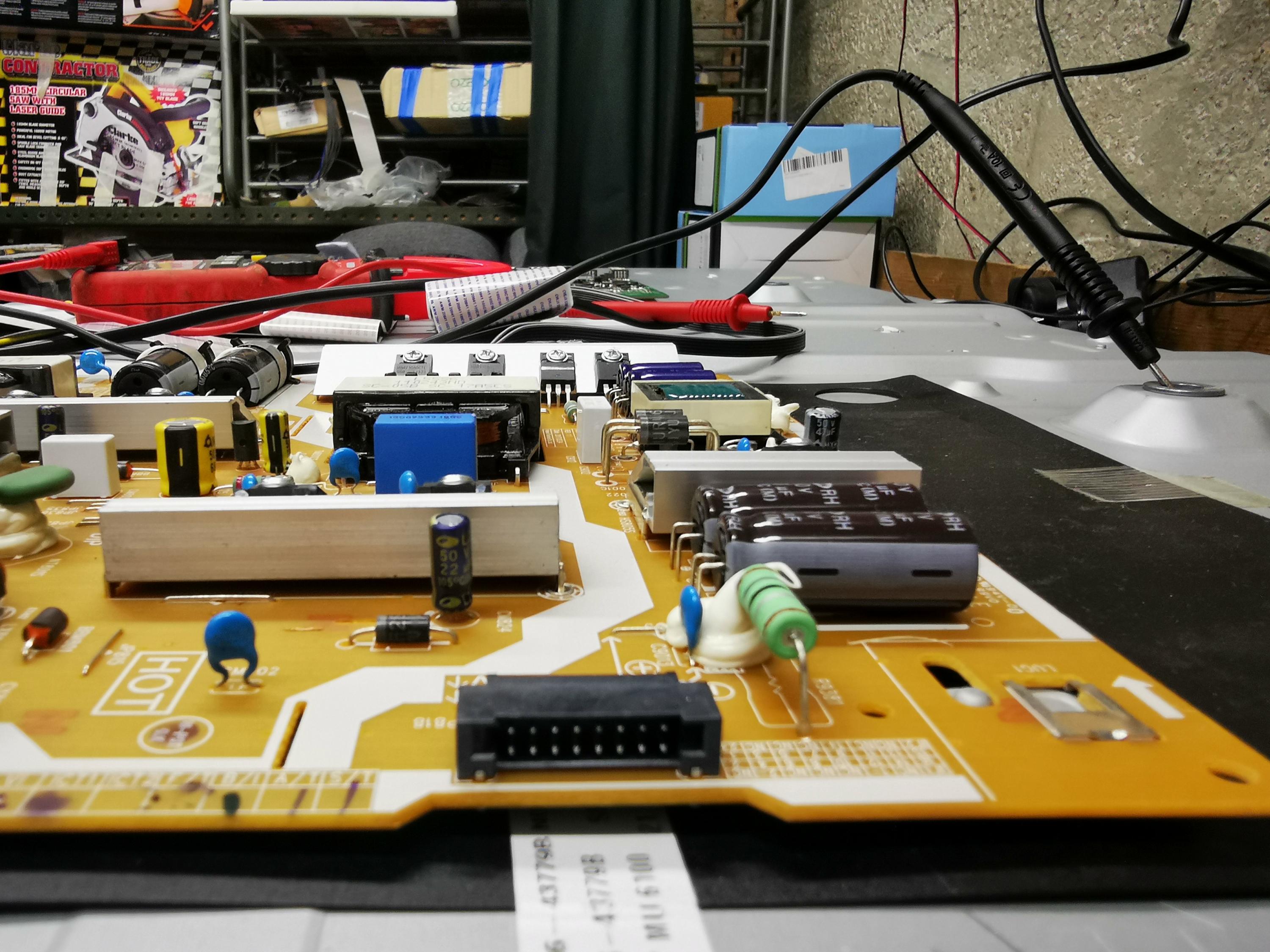

      Re: Samsung UE55MU6120KXXU, new main board, no picture.
      @Diah
      I have uploaded a picture of the angle I am testing the pin at and a picture of my results also.
      I may not be accurate in regards to knowing which pins are +1 +2 etc but here is what I think I found :
      Between +2 & - 2 I have 10.5VDC~11.8VDC
      Between +1 & - 1 I have 0
      in fact, when testing down to chassis, only the one in the top left returns a voltage, which is 380 VDC at start up. The rest are 0.

            • Diah
              • Feb 2013
              • 6564
              take the screen apart, you have one LED BL group open. always repair them when main boards disconnected.
              • dick_barton
                • Aug 2015
                • 6643
                • Wales
                I would tend to agree with Diah at this time.
