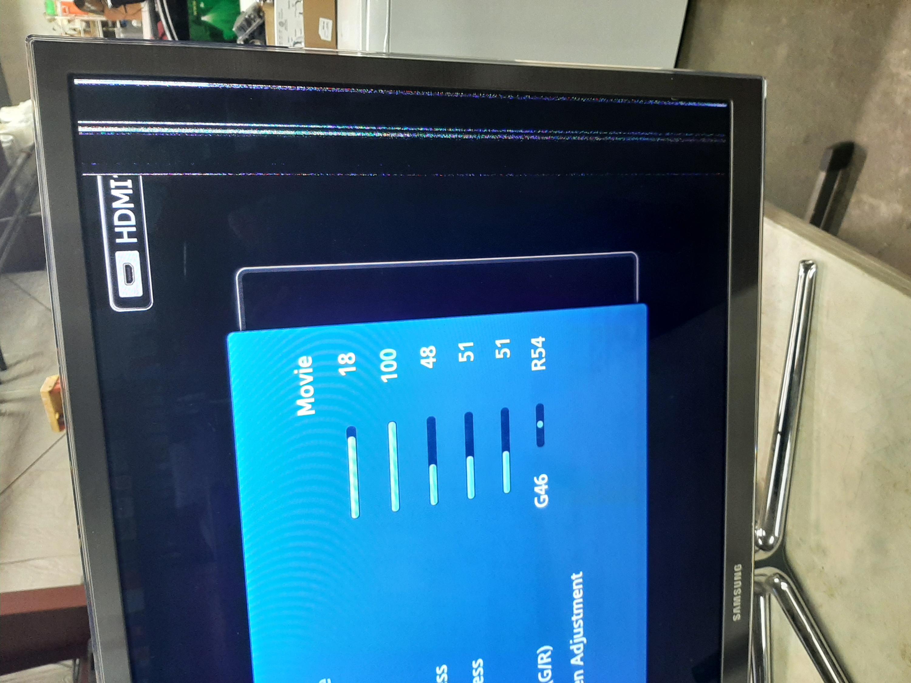

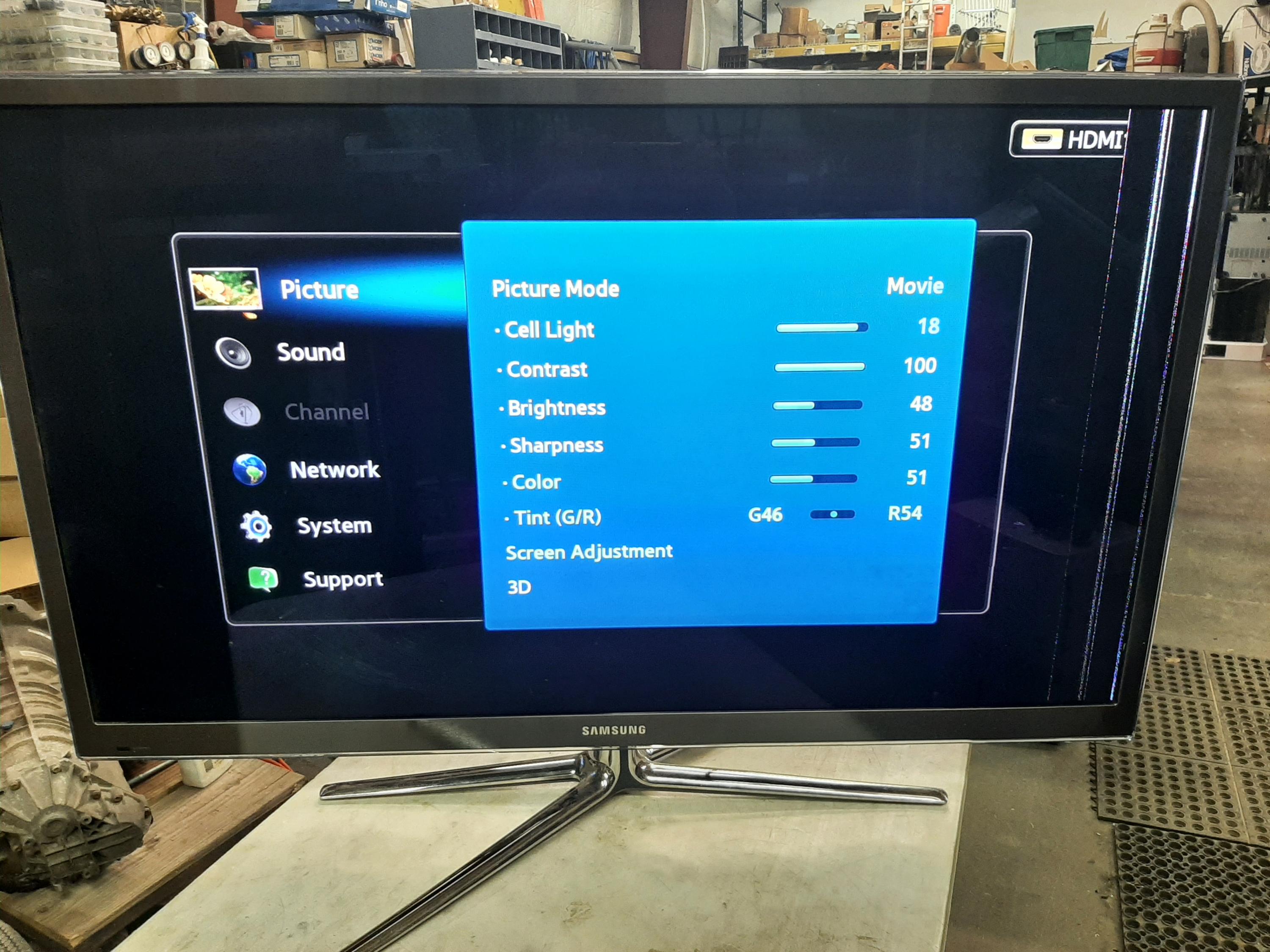

    just got a samsung plasma (3d version) that has a vertical band on right side. Has a great picture except for the vertical band. Haven't opened it yet. Is this a bad panel ?

    I have got a similar one, even the lines are in the same area. I'm courious if it could be repaired.

      Panel failure not repairable.

        played around with this today - buffer chip on ribbon cable that is bonded to display seems bad in area that is not displaying correctly. strange how the display doesn't change thou when pressing on buffer or bonded ribbon cable connection. Really sad that a quality plasma set like this goes bad from this failure. it really had a great picture except for the bad area. will be parting it out. thanks for the replies.
