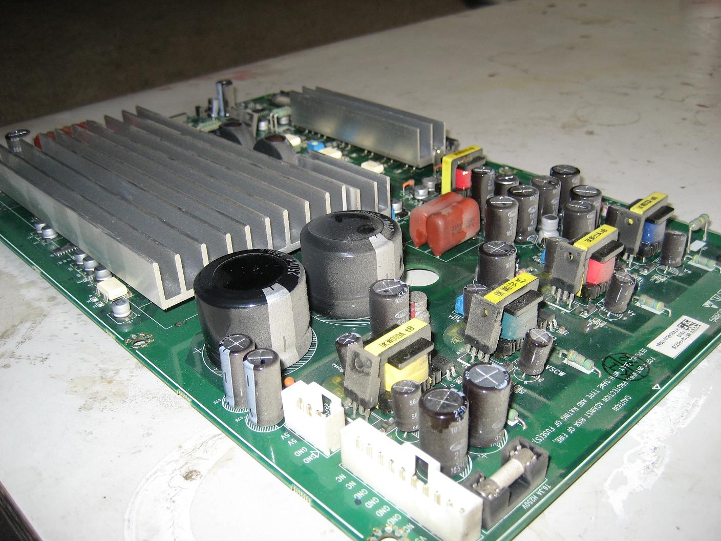

    Got a 42" Vizio Plasma TV. Original Owner says there was a loud pop and then the screen went dark. Simple searching around has shown this a common problem. Recommendation is to replace y-sus, z-sus and control board at the same time... thats not gonna happen on my budget. I'm not fixing this TV for anybody nor am I fixing it to resale it... this is simply for fun
    Anyways, I opened her up and found that there was a swollen cap on both the y sus and z sus boards. The the cap on the y sus board is swollen badly... the pictures I've included don't really do it justice as I took them from the wrong angle.
    The main fuse on the y sus board is open (it fuses the incoming Vs that is fed from the power supply). A continuity test shows there is a direct short between Vs and Ground... I checked all the major components (besides the IPM) and cannot find where the short is, but I suspect its the IPM module. I'm just waiting for an order of chip quick to arrive so I can remove it for a better look/test.
    I'm also getting a esr meter in a few days as well... I want to check the various caps throughout the TV as they are mostly samwha's circa 2004.
    Nothing appears wrong with the z-sus board except that one of the same types of cap is swelling on the top as well. Vs input fuse is still good and no short from Vs to ground as there is on the y-sus. Hopefully there is nothing wrong with the z sus board aside from the swollen cap.
    Swollen caps are Samwha HK 250V 680uF
    Pictures are of the y sus board. The swollen samwha is in parallel with another identical cap. These caps are installed across Vs and ground.

    Don't bother with caps. This is board swap only if the fuse popped because of poor design internal to the hybrid IC under that flat big heatsink, this is Y drive board by the way. If price of a new y drive board or good one scare you, dump plasma tv. They were poor investment to fix. especially ones that uses hybrid IC on the Y drive board or X drive board.
    Reason for this failure is internal solder break on the small ceramic hybrid module that is connected to another larger hybrid ceramic board.
    Later plasma TVs went with MOSFETs instead of hybrid ICs. Far more repairable.

      Remove heatsink....see if its an industry standard IC. If so, fix that and then fix all the other damage.
      If not, swap the board and fix the rest if you feel its worth it.

          This is the part under the large flat heatsink... is this what you guys are referring to as "hybrid IC"?
          http://cgi.ebay.com/NEW-YPPD-J001A-Y...16231008r19782
          If I understand you guys correctly, you are saying even if I replace this IC and the caps (and any other failed components) its very likely the set will fail again shortly?
          If so then this tv really is a disposable POS. Thankfully I haven't invested anything but a few minutes into repairing it thus far.

              Yes that is hybrid IC. Newer design. Difficult job due to very heavy power planes in the circuit when desoldering. The heatsinks is screwed to the IC before installation and soldered.
              No. It is certainly not disposeable unit. Anyone can buy name brand panels (they already come with their boards except the mainboard that generic maker designed and supplies the brackets, casing and mainboard to make their own TV.
              The panel is Samsung by the way and all the boards that is for panel (Y SUS, X SUS, and Z buffers, two boards are Samsung's for that particular panel. Power supply and mainboard usually other sources or custom designed.

                        IC Removal went fairly well... managed to do it without doing any damage to the pcb. I did this by adding a little Chip Quick onto each pin. My 60 Watt soldering iron was hot enough for most of the pins, but (as wizard mentioned) I could not get the connections that were heavily bused together hot enough (Vs, Ysus and ground connections). So I used two soldering irons at the same time to heat these connections while an assistant applied the chip quick.
                        Then I preheated the entire board in the oven at 150 F for 10 minutes, pulled it out and applied heat via a heat gun to get the solder/chip quick to melt. I was unable to get all the pins hot enough simultaneously in order to pull the ic out, so I worked in quadrants... heating the corners of the ic while gently pulling the ic out. Took only about 5 minutes of gently persuasion to get it out.
                        IC has definetly failed. Two of the transistors (IGBTs?) have popped.
                        Installed the new IC (Which required the use of two soldering irons again guess I need a hotter iron) and replaced the 4 caps previously mentioned on both the y-sus and z-sus.
                        TV works now BUT while looking around the internet elsewhere I've seen it recommended to check the 15 Volt supply on the Y-sus board because the likely cause of failure of the IC in the first place was an unstable 15V supply.
                        And whaddya know, the 15V supply was rising and falling between 10.9 and 12.4 V. Traced the 15V to where its generated on the y-sus board and found that a couple of small smd capacitors have failed there.
                        Caps are on order now.

                            Good news and bad news:
                            The good news is I replaced the caps around the 15V supply and now it is running at a steady 14.5V.
                            The bad news is I watched the TV for a few minutes and noticed that after a couple of minutes the display begins to develop sparkles... mostly green but sometimes blue and sometimes red sparkles blinking around the display. Looks like pixels are misfiring randomly.
                            Did quite a bit of research on this and it appears to be very common with these sets. There are a few recommendations on how to try and fix this.
                            1) Lower Vs about 5 to 10V (I tried this but it had zero effect)
                            2) Adjust Setup and Setdn on Y-sus board - haven't tried this yet as I don't have access to a 200Mhz scope (as recommeneded by the service manual).
                            4) Replace Y-sus, Z-sus and control board (and possibly y and x driver boards) at the same time
                            3) Replace panel... some suggest the panel has aged and its time to dispose of it and get a new TV.
                            I haven't given up yet. I did some more checking around the Y-sus and Z-sus boards today. I discovered two anomalies and was hoping to get some feedback if anyone had any:
                            1) The sticker on the panel lists all the power supply voltages. I checked all of them and they all check out excellent except for the Vsetup voltage which should be 210V. I get a reading of 208V and sometimes it drops down to 205 V briefly and sometimes it bounces up to about 213V briefly. This seems odd to me... I don't know if its the cause of the problem or a symptom of the problem
                            I checked the esr of the caps in the circuit that generates the Vsetup voltage and everything seems sort of okay. ESR on a couple of the caps is high... around 3 ohms, but its for the caps rated for 350V so I expect the esr to be high (datasheets dont list esr for these particular caps, only ripple current). There are identical caps elsewhere in the tv all with similar esr so I dont think this is the problem.
                            2)I found one surface mount capacitor with questionable esr on the z-sus board. Its right around the ramp_up IC and potentiometerr. ESR is reading 2.1 Ohms while identical caps on the board are all less than 0.1 Ohms. I'll replace it tomorrow and see what happens but at this point my hopes aren't high.
                            Any thoughts?

                              Sparkling needs slightly adjusting on Vs and Va on the power supply ONLY. If one did not fix that, return to original and try other. It only take a little. Must have panel warmed up 1/2 hour to a hour first and running while adjusting.
                              Do NOT adjust anything ELSE. These other adjustments on the other boards *requires scope* to do it. This is why I do not *like* leaving newbies with plasma panels.

                                  Adjusting Va didn't do anything to improve the picture so I set it back to where it was. Slightly adjusting Vs higher improved the picture dramatically (going lower did nothing)... there were still a few sparkles but they were nearly impossible to detect unless you stared at the TV from a few inches away.
                                  • Wizard
                                    • Mar 2008
                                    • 2296
                                    Re: Vizio 42" Plasma - Bad Caps in Y and Z Sus
                                    Then adjust Vs more higher if not adjust the Va bit more either way. It interacts, getting you closer and closer to ideal.
