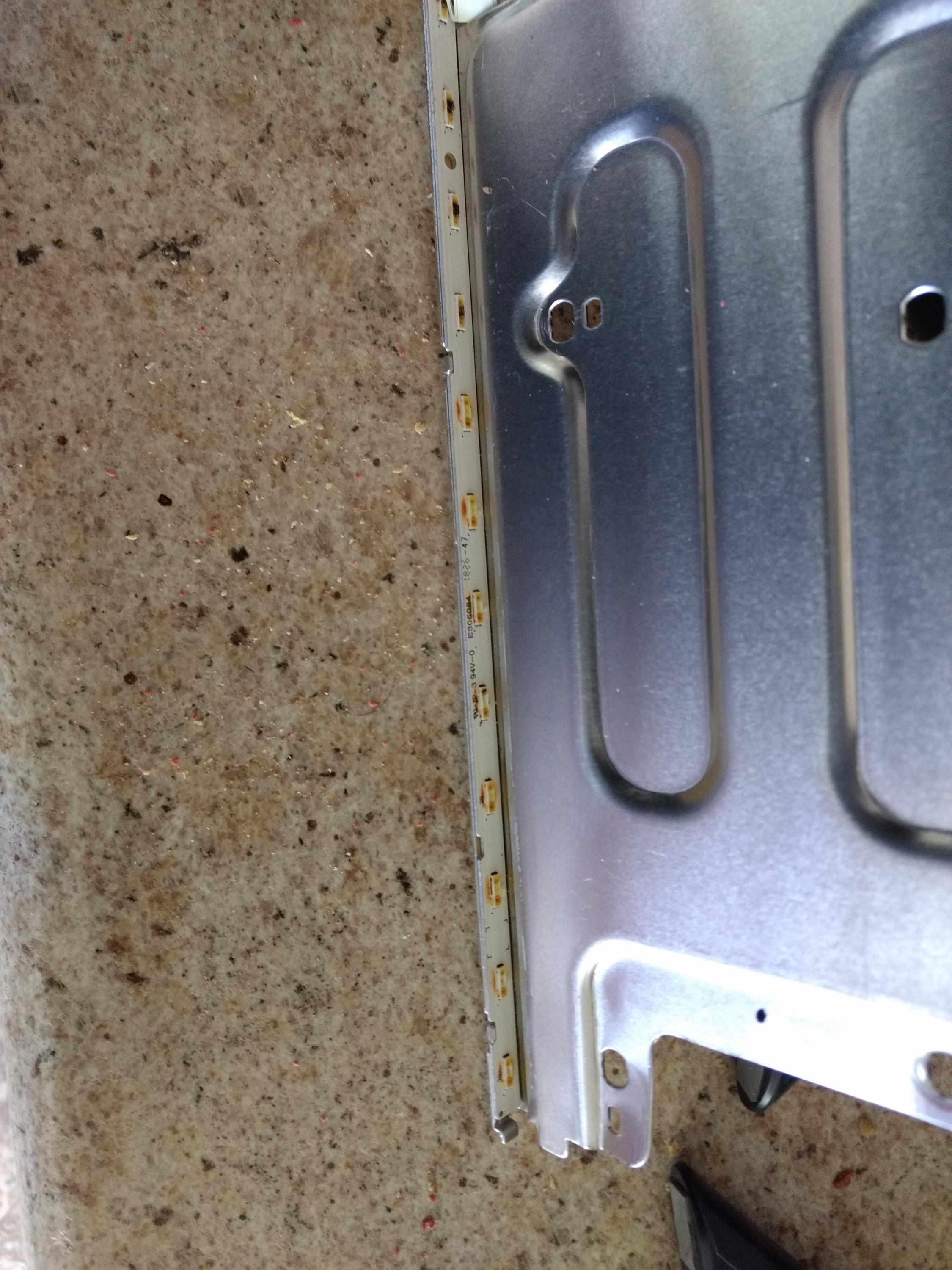

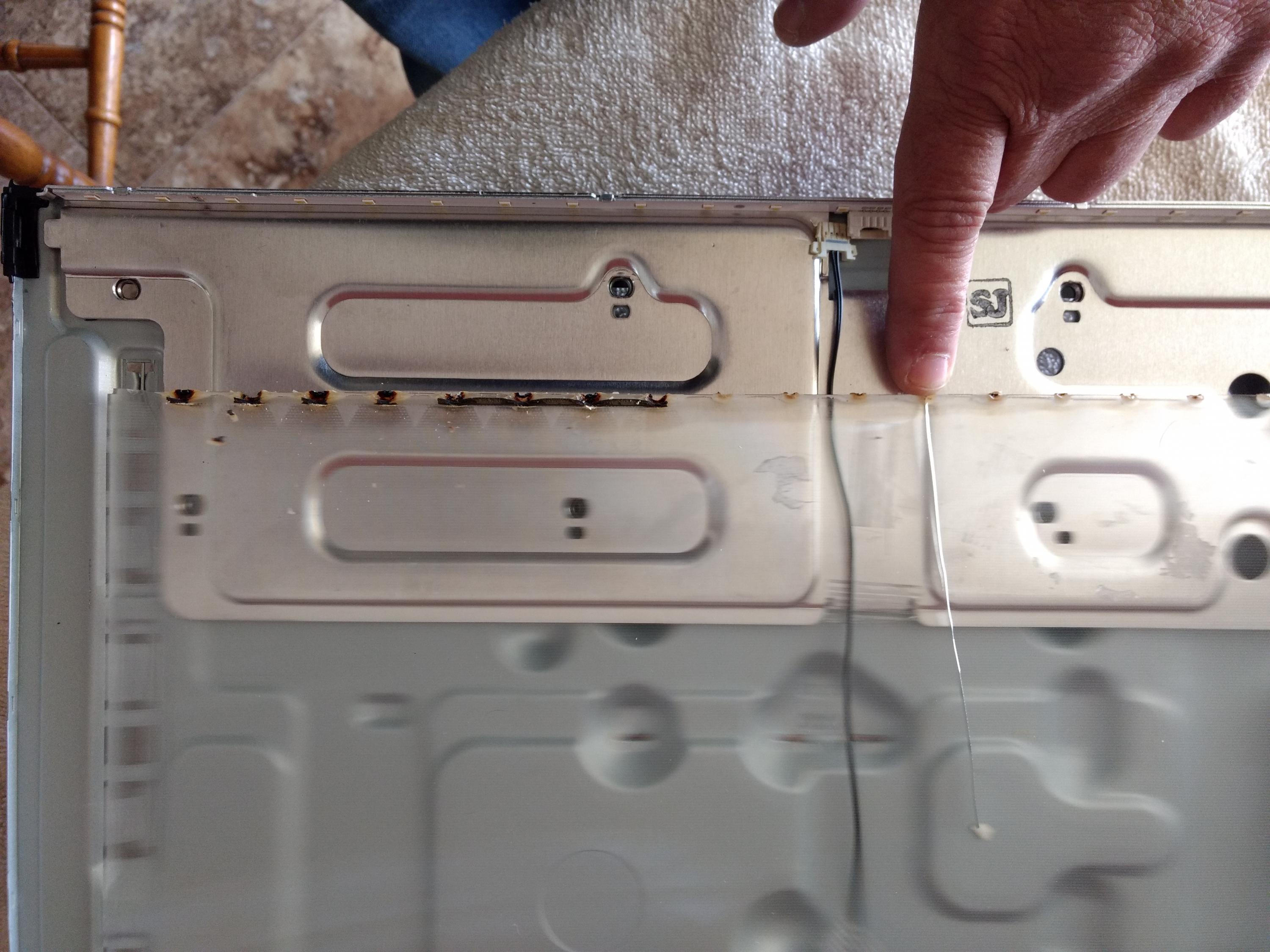

    Hello everyone. So this time I come less asking for advice and more with a warning. As far as I can tell this is the first post for this model.
    I picked up a Samsung UN40NU7100FXZA from a supplier the other day, build date January 2020. I checked it before purchase to find there were only a few LEDs working. Where they were the diffusion of light looked "abnormal" but the picture was obviously still there.
    I disassembled the TV. See what I found in the pictures below.
    The LEDs upon the right side of the TV had obviously been so hot they melted themselves in to the main light diffusion panel! You can see their impression in the diffuser! Furthermore the lower part of the diffuser is heat deformed and appears partially melted! There are cracks radiating in to the diffuser from a couple of the LEDS!
    Based on the design I see I can also see every TV of this model having this problem.
    This said I have one question....does anyone believe an LED current adjustment and turning the backlights down are enough to prevent a repeat failure?
    I'd say with this model if you see ANY CHANGE in the diffusion of light at the bottom of the screen you may be having this problem. Also, I think once the change in diffusion has started the main diffuser panel is already damaged to the point the TV isn't worth fixing.
    In the absence of a fix the most reasonable work-around appears to be turning the backlights down to the lowest possible practical setting.
    It's sad to see Samsung not thinking ahead. A potential failure like this should have been obvious.
    Last edited by DXseekerMO; 02-14-2021, 04:30 PM. Reason: I ain't got no good english

    See lots of NU failures on the tvrepair subreddit. Haven't tackled one yet.
    Replacement strips appear fairly cheap due to the design. Can you flip the sheet so the LEDs are shining into a clean edge?
    https://techhometravel.com/samsung-n...ight-failures/

        Can you turn the diffuser sheet around or is it too damaged?

          I see arrows at the bottom of the diffuser pointing up. That leads me to believe this diffuser is directional, however I do have almost 50 different main diffusers from other TVs. I thought aboot trying a couple of those and see what happens. May have to cut some down to fit.

          It is real bad. I think if I try to use it there will be artifacts on the screen.
          Also the reflector sheet under the main diffuser has LED witness marks melted in to it as well!

            from the distances between LEDs they look double LED high power at least 120° 200 lumen..
            the first solid plate are reflector .. then coming on it the diffuser, the reflector side opposite to the LEDs strings it had reflection type to keep the light inside.. unlikely the side which faced the led which are transparent.. no way to flip it..
            i would suggest to replace all the LEDs at once with new one.

              Yes for sure, and I already have some ShopJimmy LEDs ready for it, already heat-sink mounted.
              I also recycle TVs, and I have some of these main diffusers and reflector sheets out of other Samsung edge-lit TVs. I thought about trying to swap in one of these. I'd have to cut the diffuser and reflector sheet down since these are from 55" TVs.
              If I do that I'm less concerned about the reflector sheet, I should be able to match the color ok. The main diffuser may be a different story. I think it may be hard to match the "polarization" of the diffuser and the picture may not be right afterwards, like the presence of artifacts at the bottom of the screen.
              If anyone believes swapping and potentially cutting down a main diffuser would work I can post pictures (and hopefully a model/panel part#) if anyone is interested?

                i see, so you are going to replace the strings complete with used one.. i meant only the LEDs to replace LOL
                cutting will not work.. as i wrote, if the edge LED are downside. mean the up side of the reflector have reflection Type glued on the edge top or some do it by coating so you can't cut it from this side... and if you are going to cut from downside ( which facing the LED you need to smoothing the edge surface after cutting to let it transparent not easy work... LOL. other side left or right no problem by cutting.

                  It sounds like the only way to go is a new diffuser, or at least one the same size.
                  Guess I'll go see what I have later.
