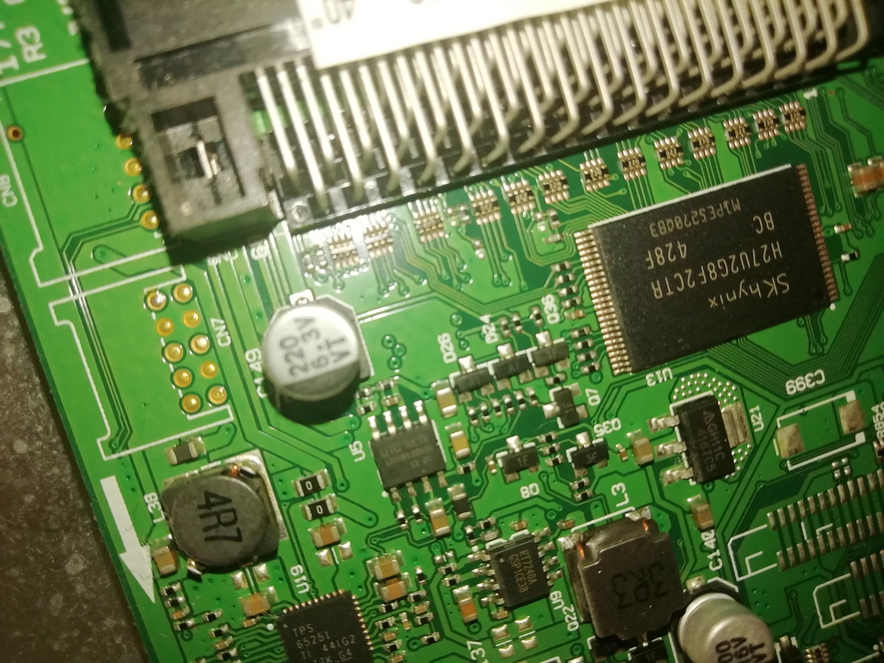

    Hi, just need a bit of advice please
    I have a Toshiba 40L3453DB tv with the blinking red/green light and the light grey screen but no picture or sound
    there are no swollen caps as far as i can see
    I have searched the forum and found this thread for the smaller size tv
    https://www.badcaps.net/forum/showthread.php?t=58640
    which recommends redoing the firmware, so i have searched and the only firmware i can find is this one
    h**ps://repairalltv.com/toshiba-40l3453db-software-17mb95-download/
    the 17MB95 board is the same as mine but the Panel model panel number is slightly different to what they show on that link, there's is Panel NR- VES400UNDS-03
    mine is VES400UNDS2DR06-2D-R06
    I have download the file and all it contains is the "upgrade_mb90.bin" file
    Does anyone know if this will work and will it flash using this by powering on holding the ok button down on the remote or do i need mboot and usb_auto_update_A1 file to go with it like in the other thread on here in the first link?
    I have attached pictures of my boards, any help would be appreciated

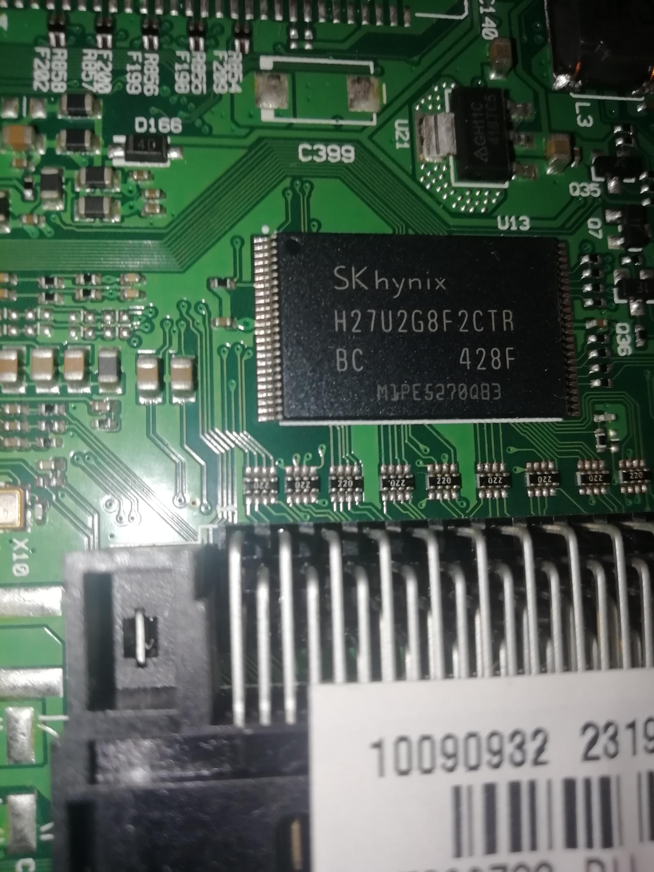

                      show me please clear focused photo on the whole mainboards.
                      • Fergal22
                        • Feb 2021
                        • 50
                        • United Kingdom
                        Re: TOSHIBA 40L3453DB red-green blinking light
                        Hi, thanks for the reply,
                        I have attached more pictures, my phone camera is not the best, if you let me know what particular area of the board you want to see i will take a close up shot of it
                        • Diah
                          • Feb 2013
                          • 6497
                          hmm. yours NAND from the Korean Hynix. its sector construction need specific partition.
                          its same issue with any other android tv boxes with this type of NAND.
                          so what the status you are in now.. ?

                              • Diah
                                • Feb 2013
                                • 6497
                                also look closely on the mainboards... you will have ic chip with 8 pins (SPI FLASH) with label No 25 could you focused photo on it or write its full label over here
                                EDIT: should be U10

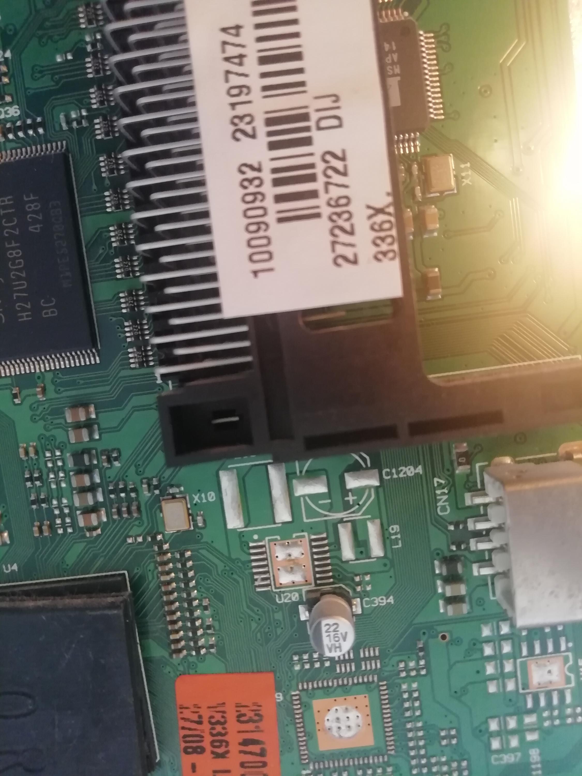

                                  Hi, I tried the first link firmware a few times and nothing happens, no lights, nothing
                                  I have added close up pictures of some of the chips in case that helps
                                  sorry never seen you last post i will do that now
                                    There is no u10, there is a U9 with this on it
                                    RT7240A
                                    GSPICE38
                                    There is another 8 leg chip by it (U5) but its very hard to make out what it says on it
                                    • Diah
                                      • Feb 2013
                                      • 6497
                                      check again it should had label with 25L1606 or some things ells after L
                                      • Fergal22
                                        • Feb 2021
                                        • 50
                                        • United Kingdom
                                        I found U20 but there is no chip on it plus it has more than 8 pads were a chip would be soldered on there
                                        I managed to get what was on chip U5
                                        UTC RET8 (I think its an 8)
                                        LR18120MB
                                        12 01
                                        there are no other chips with 8 legs on the board anywhere
