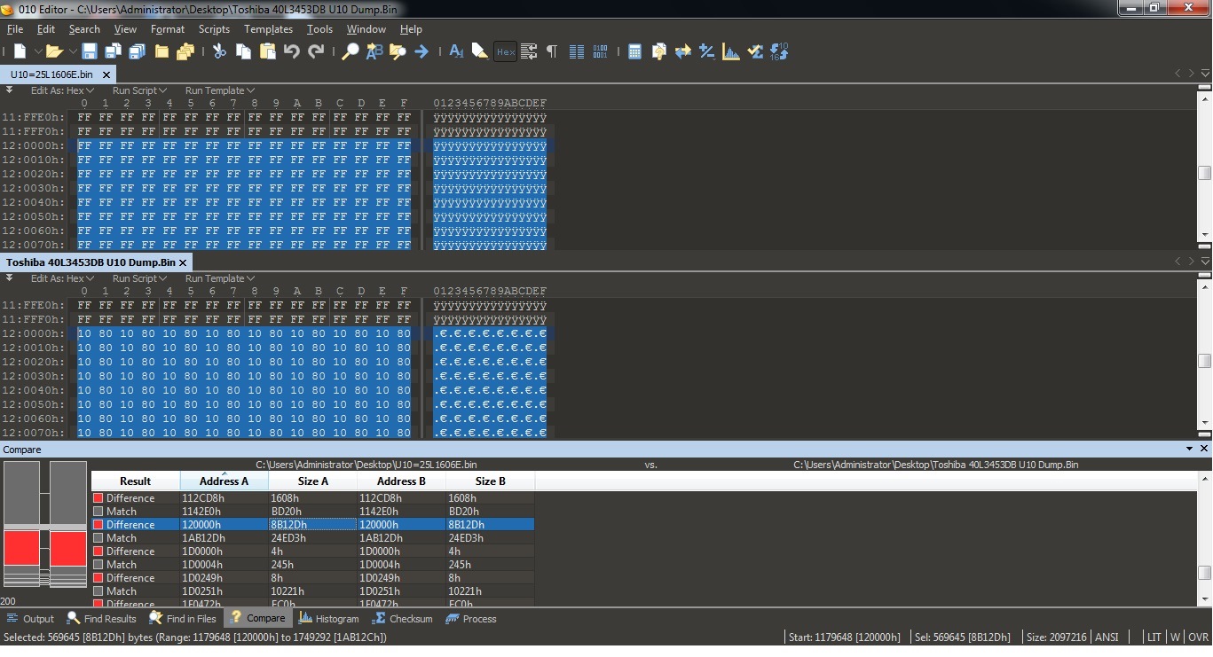

        Morning Guys,
        Thanks Diif for the files, i tried the U10 file but no joy I'm afraid
        Here are my findings when trying different flash dumps
        Toshiba 40L3453DB U10 Dump Mine, must be Faulty
        No lights-no response from remote or side buttons
        Toshiba 40L5435DG Dump Flashed
        MB9x_Faz3_V362H_Core bin file
        Flashing Green Light
        unplug connect usb press and hold ok on RC, get a green solid light, release ok button after 10 seconds and light just stays solid green
        turn off and back on just get red/green blinking light, black screen
        40L3453DB bin file
        Same as above
        17MB95 full v3.6.6n bin file
        Same as above
        17MB95 full v2.2.4t bin file
        Same as above
        UPG02
        Same as above
        Toshiba_40L1333DG_U10_25L1606 bin file flashed
        Toshiba 40L3433DG bin file flashed
        I think one or 2 of these two i got a solid red light when unplugging connect usb press ok on RC plus black screen, if i turned off and on again with ok on RC i get red/green blinking light
        Toshiba U10=25L1606E bin file flashed, the one Diif uploaded
        unplug connect usb press ok on RC, get a no light, release ok button after 10 seconds and still get no light
        turn off and on without holding ok button on RC just get red/green blinking light black screen
        I also trying with pressing input button the the side, no idea if that's the button you are suppose to press as i jus got red/green blinking light when trying this on all the above
        I don't know what else to try, i might but another main board but just concerned it might not fix it

          #64
          Re: TOSHIBA 40L3453DB red-green blinking light
          Originally posted by Fergal22
          Morning Guys,
          well i cant follow because now became many files..
          i took yours dump file and compared it with diif file.. both are same version.. yours dump one had one pause boot section was corrupted, i did rewrite it with hex. try flashed it, and dont do any more than plug in wall and turn on.. let see what you will have.

              #66
              My friend gave it to me as it just went like this when he turned it on one day
              I tried all 4 files you posted and just turned tv on that's all and got the following results
              Toshiba 40L3453DB U10 Dump_repaired
              No lights no screen, nothing
              FINLUX__MX25L1606E
              flashing green light only, no screen back light
              MX25L1606E_U10
              Polaroid SPI
              flashing green light only, no screen back light.

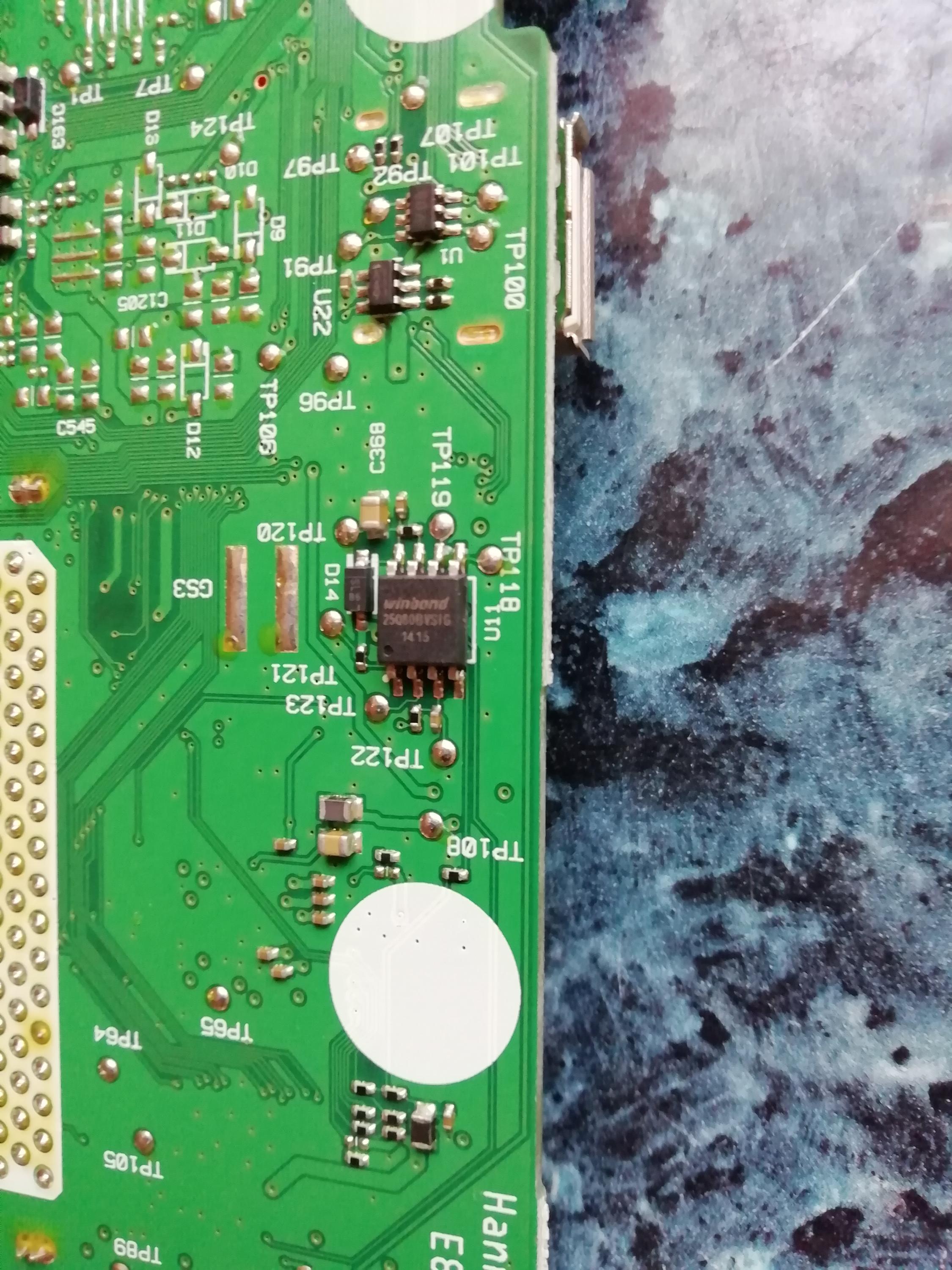

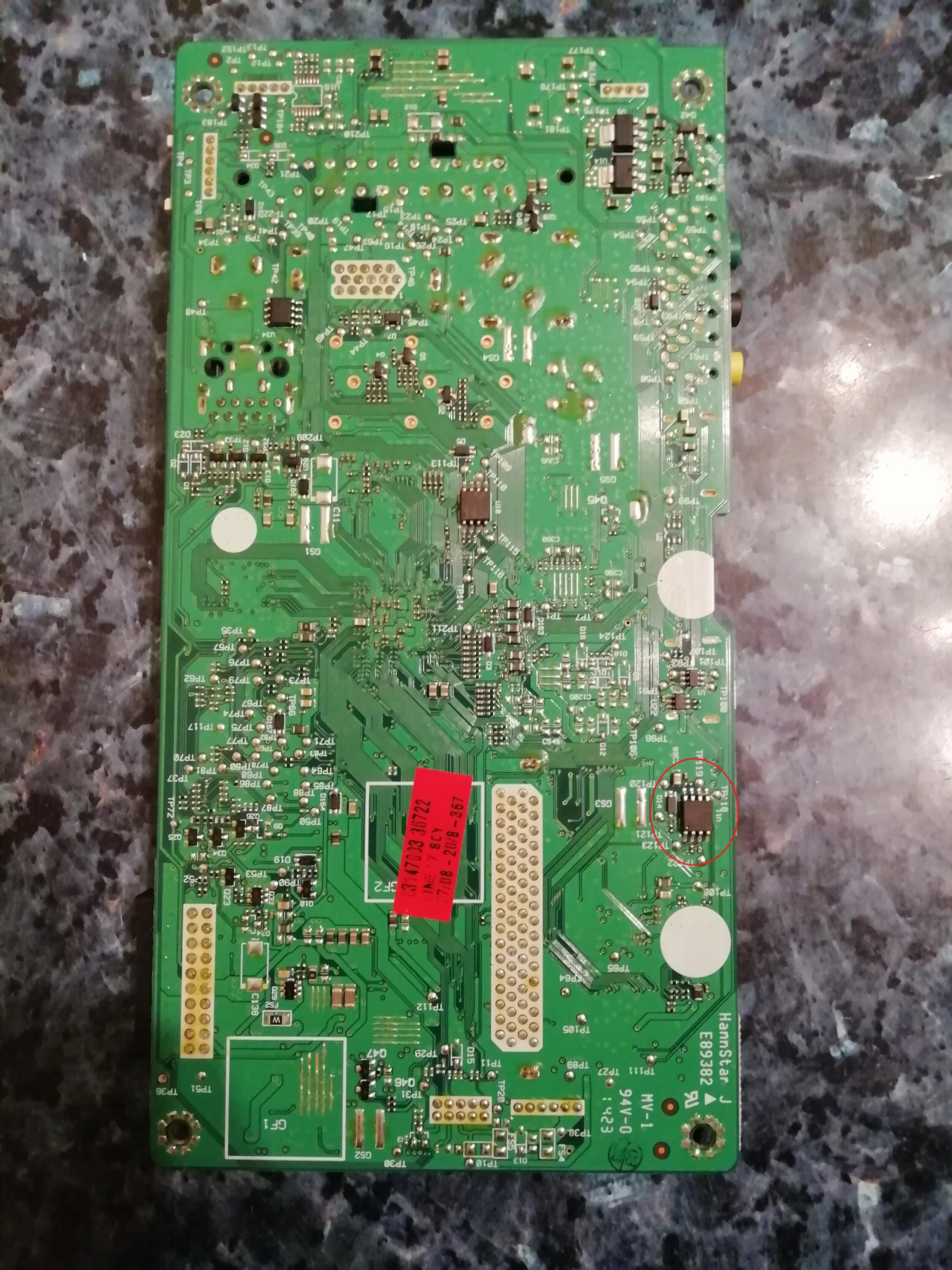

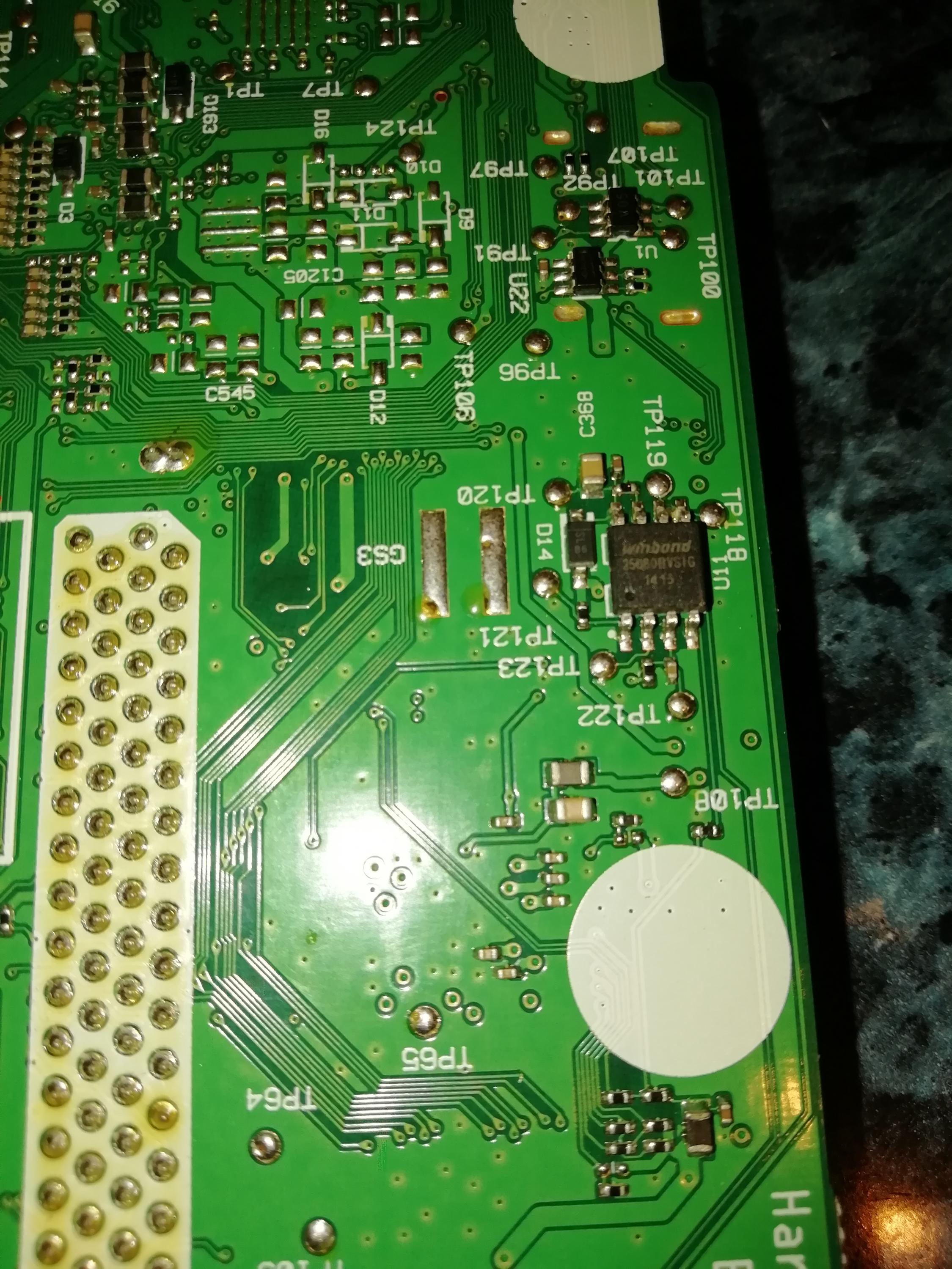

                  #68
                  Originally posted by Diah
                  then just flash diif file and power it on.. let see... it sound to me we have some issue related with NAND or BGA... but we can by try to be sure of the issue..
                  U11 can you show me where it located... as diif package include it ?
                  Flashed the file Diif posted(Toshiba U10=25L1606E bin)
                  Turn on without holding ok button on RC just get red/green blinking, no screen back light
                  Then if i try with a flash file on the usb and unplug connect usb press ok on RC, get no light, release ok button after 10 seconds and still get no light
                  Attached is pictures of the location of the U11 chip on the underside of the board

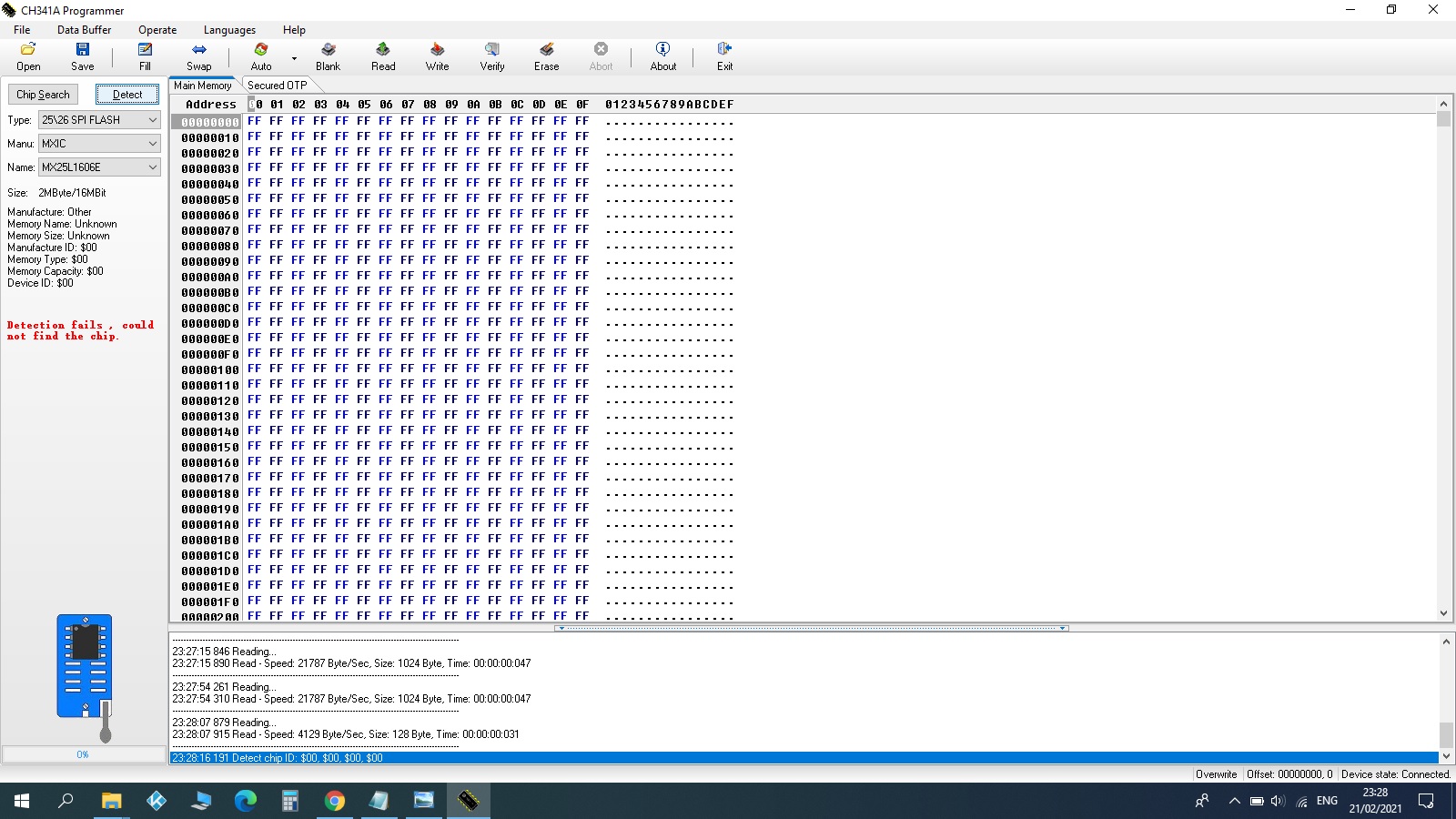

                          • Fergal22
                            • Feb 2021
                            • 50
                            • United Kingdom
                            #73

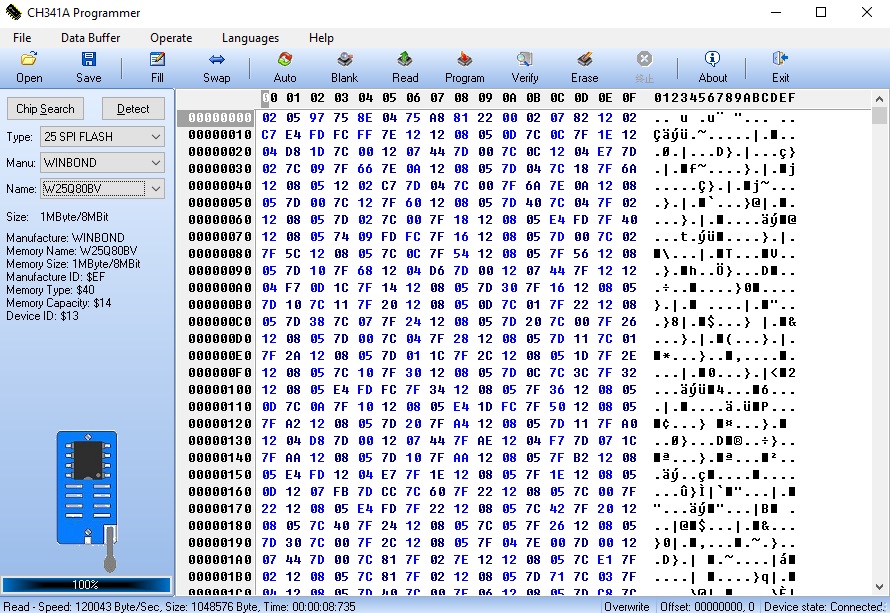

                            1Gb very fine if you have less will be more fine
                            the software didn't recognized it and read it at auto?
                            When i click detect i get the following, see attachment
                            i tried a few times
                            • Diah
                              • Feb 2013
                              • 6498
                              #74
                              change the manufacture type
                              try
                              Manu ------WINBOND
                              Name ------W25Q80V

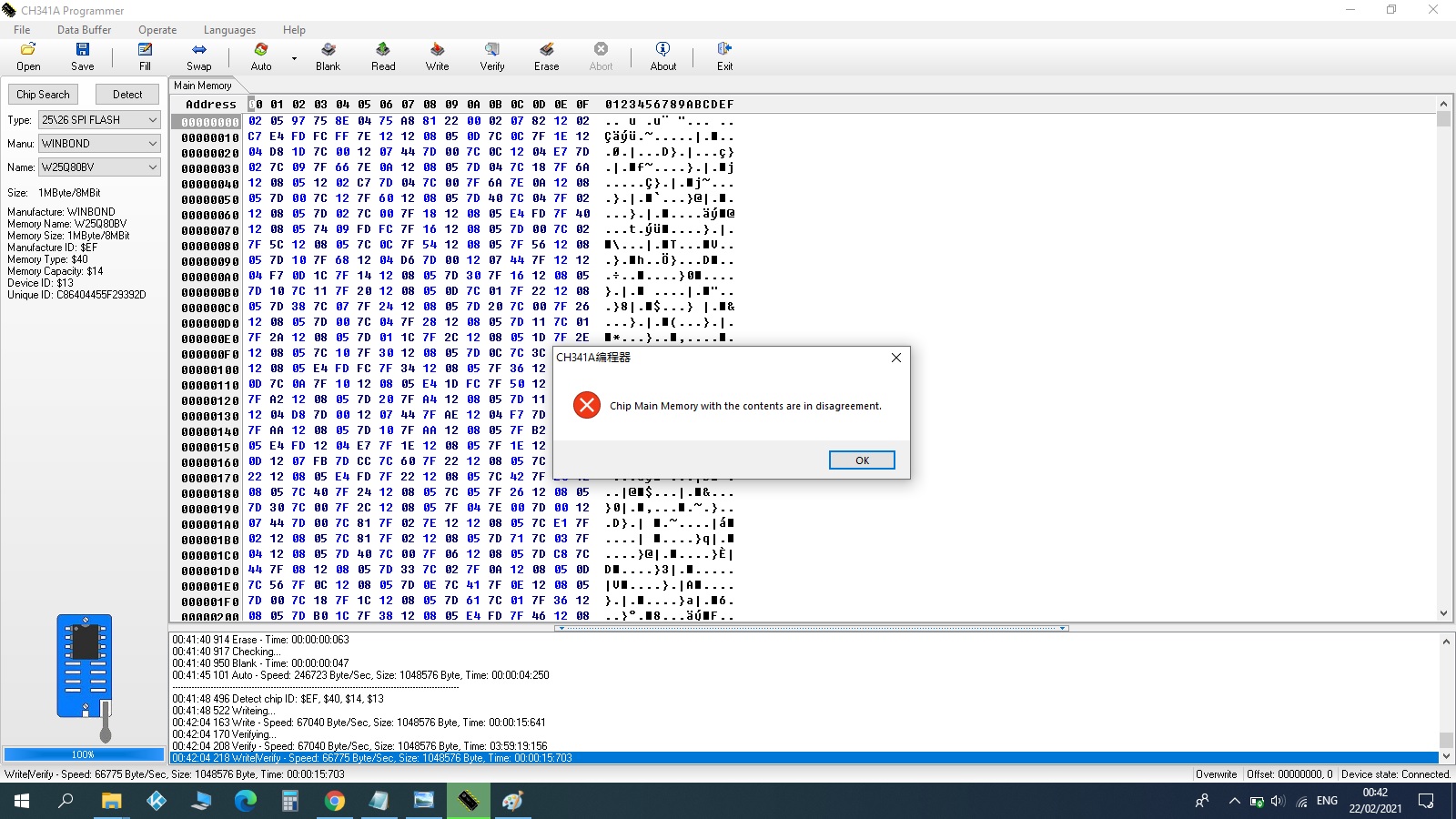

                                  • Fergal22
                                    • Feb 2021
                                    • 50
                                    • United Kingdom
                                    #77
                                    flash it with diif file
                                    Keep getting this error
                                    • Diah
                                      • Feb 2013
                                      • 6498
                                      #78
                                      this error maybe because flashing while the chip on board. some need to be out of circuit to flashing or could be the dump was taken with other programmer more pro than CH314. also just consider the software of this CH314 are simple one.. some time need to restart it & clean Temp. ... however after searching yours boards service manual , this U11 are for T2 DEMOD. assigned to U17. so ignore it right now... and try my post #70 if this wont help... sorry i am out of any other idea to replace the boards.
