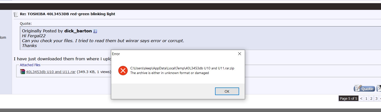

                      #90
                      Re: TOSHIBA 40L3453DB red-green blinking light
                      Hi Fergal22
                      Can you check your files. I tried to read them but winrar says error or corrupt.

                          #92
                          It may be my Winrar program but I still see the error message as shown.
                          Edit
                          Just updated my WinRaR and all is well. My error. Many thanks.
