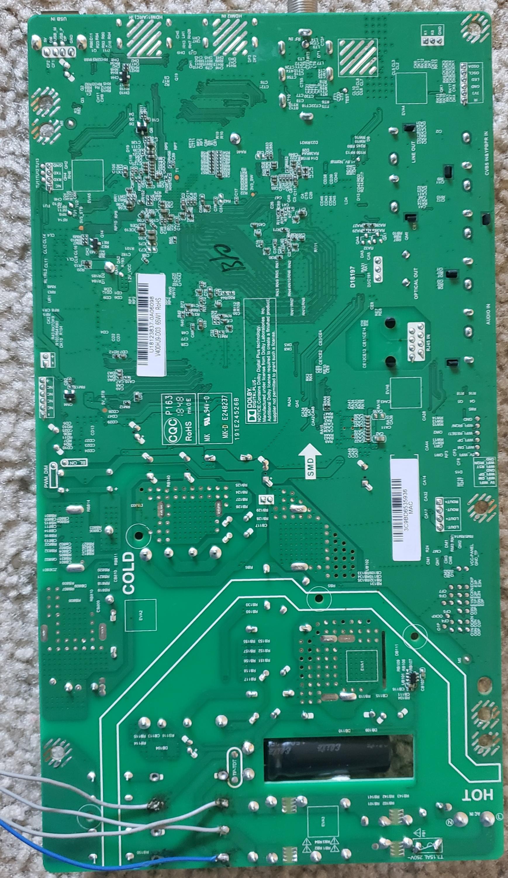

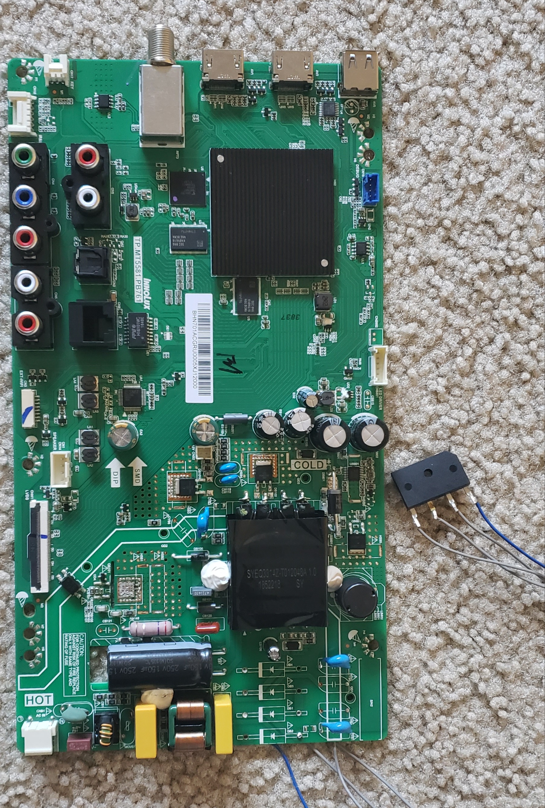

    I'm working on Vizio D40F-G9 tv, there is no voltage present on the secondary side of SMPS. Fuse was blown out and found two diodes on the bridge were shorted. So I replaced it with bridge as I was not having replacement diodes. Then found the mosfet QB101 is shorted. Original mosfet was SW7N65 which I replaced with TK10P60W. Again it shorted and fuse blown. I could measure the continuity between legs of main caps with shorted mosfet so I removed mosfet. Then found the diodes marked in red (R12K J0) color are shorted, could this be an issue to make mosfet and whole circuit shorted? Or what else do I need to check?

    The diodes are not likely shorted, they are parallel to the 0.27Ω resistor. If the mosfet was shorted drain to gate, I suspect the gate drive circuit or driver ic UB101 is bad aswell

        The driver ic, it's on the other side of the board. If at any time during the mosfet failing the +300vdc may have found its way to the gate and took out the ic. If the ic is damaged it might just turn the mosfet on hard so it just shorts again.

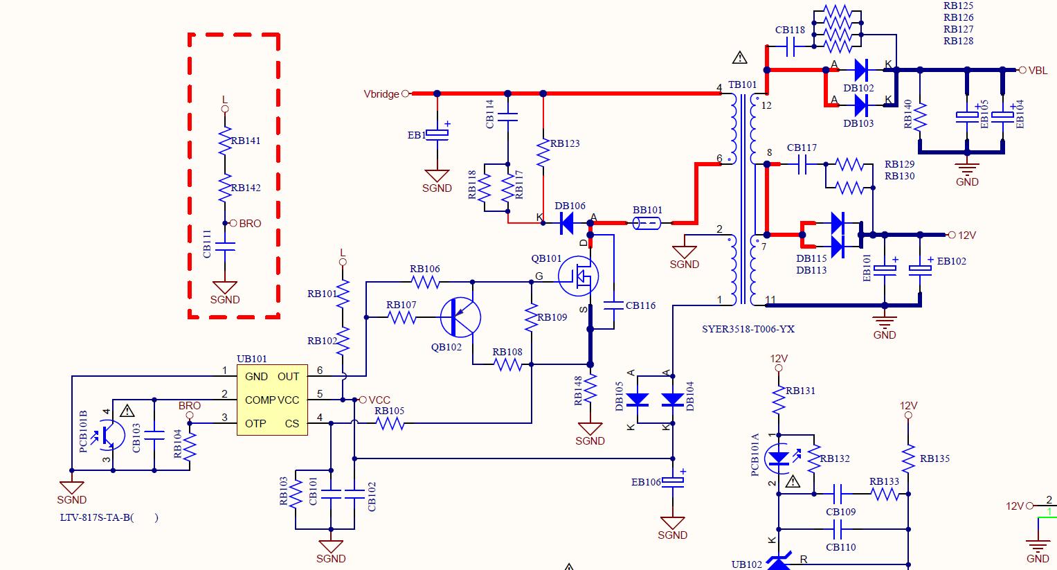

              The negative lead of the main capacitor is connected to HOT ground. The source of the mosfet will be connected to hot ground via 0.27Ω resistor, The positive lead of the main capacitor will be connected to one end of the primary winding of the transformer, the other end will connect to the mosfet drain. The transformer DC resistance will be very low so it will seem like the cap positive has a short to the fet drain.
              If the mosfet is just turned ON, this will cause excess current in the primary blowing the fuse.
              Under normal operation, the mosfet switches at around 60kHz, this is how the supply operates.
              Here is a similar power supply primary circuit
