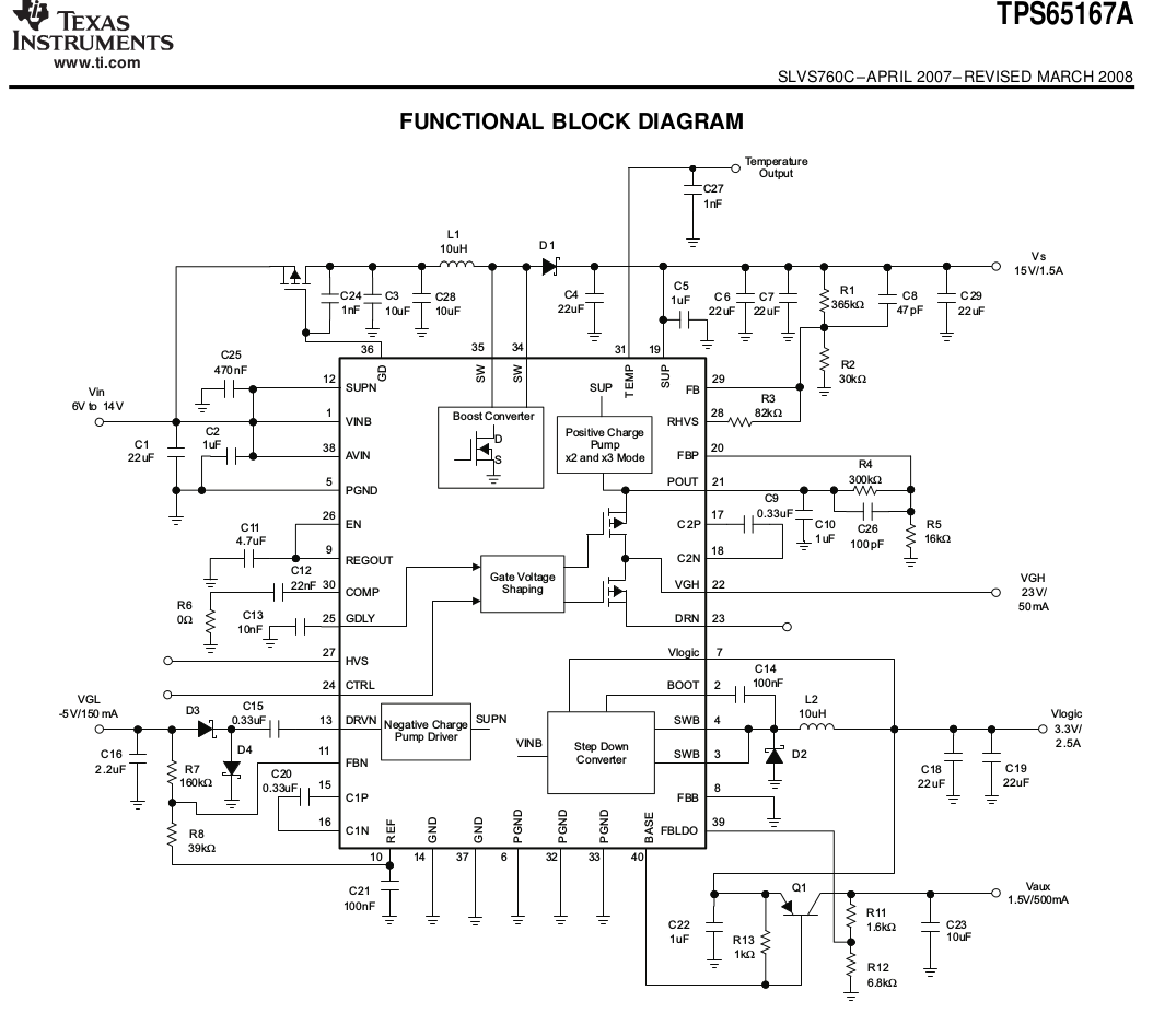

        Re: Samsung le40a656a1f reaaaaaly slow poer up
        Hi there, having the same television I get a weird problem. Already recapped the power supply, I can hear sound from the speaker and see backlighting turning on but no image. Looking further, the tcon (input voltage 12.8 Volts so ok) does not have avdd, vgh etc. Left side has no voltage at all. The right side with 3.3V and 1.3V seems ok. Any ideas?

                  #68
                  Unhook ribbons from tcon to panel on tcon side and retest those tcon voltges.
                  Two panel cables already disconnected, only cable on is the one to main board to get power. The voltage ic I see is TPS65167 and the circuit is something similar to the image uploaded. avdd and vgh are not shorted to ground.
                                  Yes it could help if it was operational! In the meantime I connected the cable from main board to another plug (the one with the white arrow above CN1) and now it has voltages on the right side as before but voltage has appeared in the input of IC11 (bottom left corner). Nothing else though...

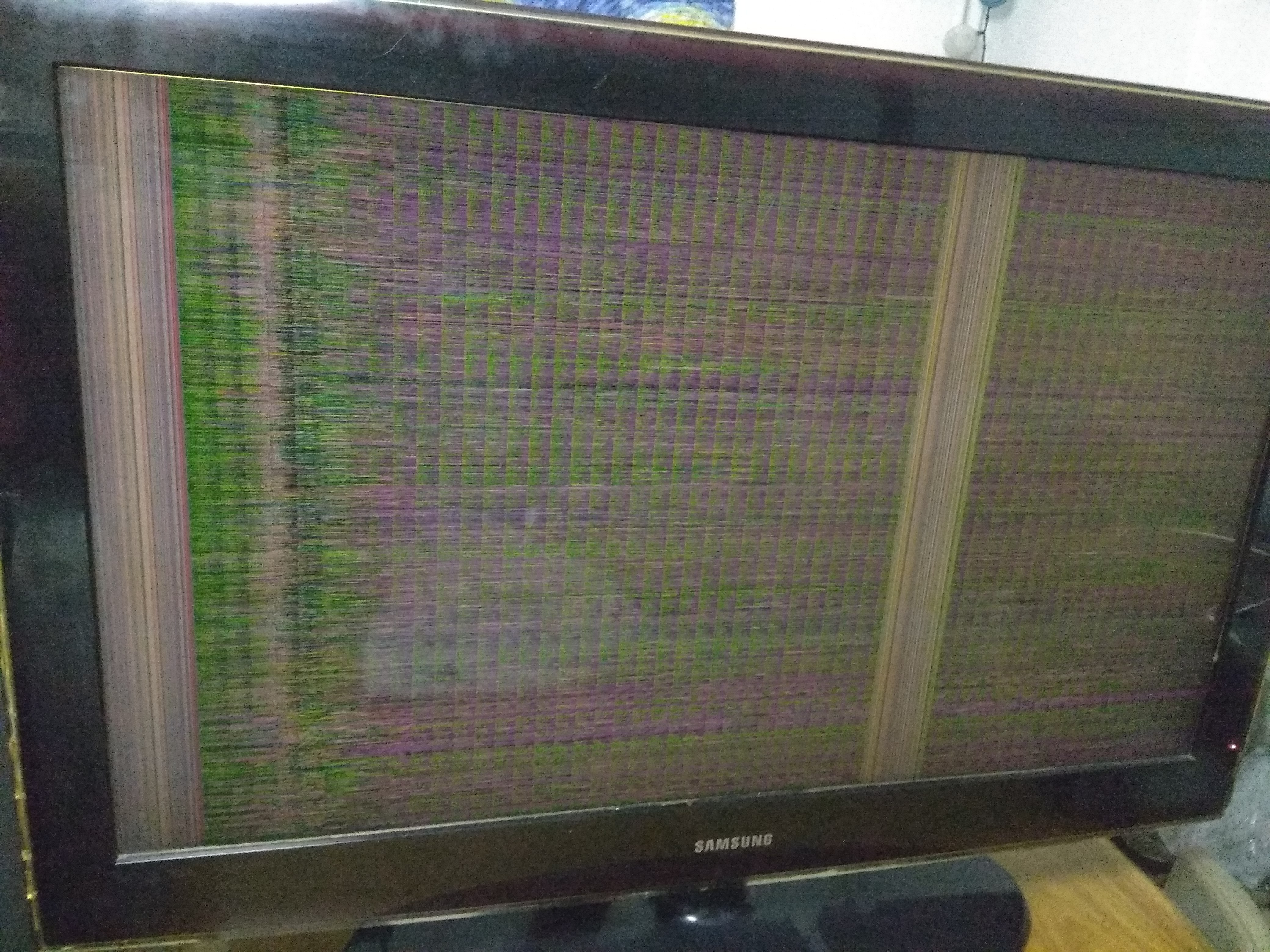

                                    #77
                                    After many tests the tv won't work! The only one time the screen showed something and the led stopped blinking was this. What should I make of it?
                                    • electrocuted
                                      • Aug 2023
                                      • 39
                                      • alban
                                      #78
                                      No one is familiar with this type of fault, showing this image on screen?

                                        i know this set has very consumptive TCON with big heatsinks and fan, the age corrodes the BGA balls and needs to be reballed.. on this type of set only homemade reworking can be accepted.. i think is far too late to do this but try to put tcon on freezer for almost 1 hour, then rapidly mount it and test it, watch if it make improvements or degrades with heat.., check also temperature on the chip on normal mode..

                                          Thanks, I'll give it a try and see what happens
