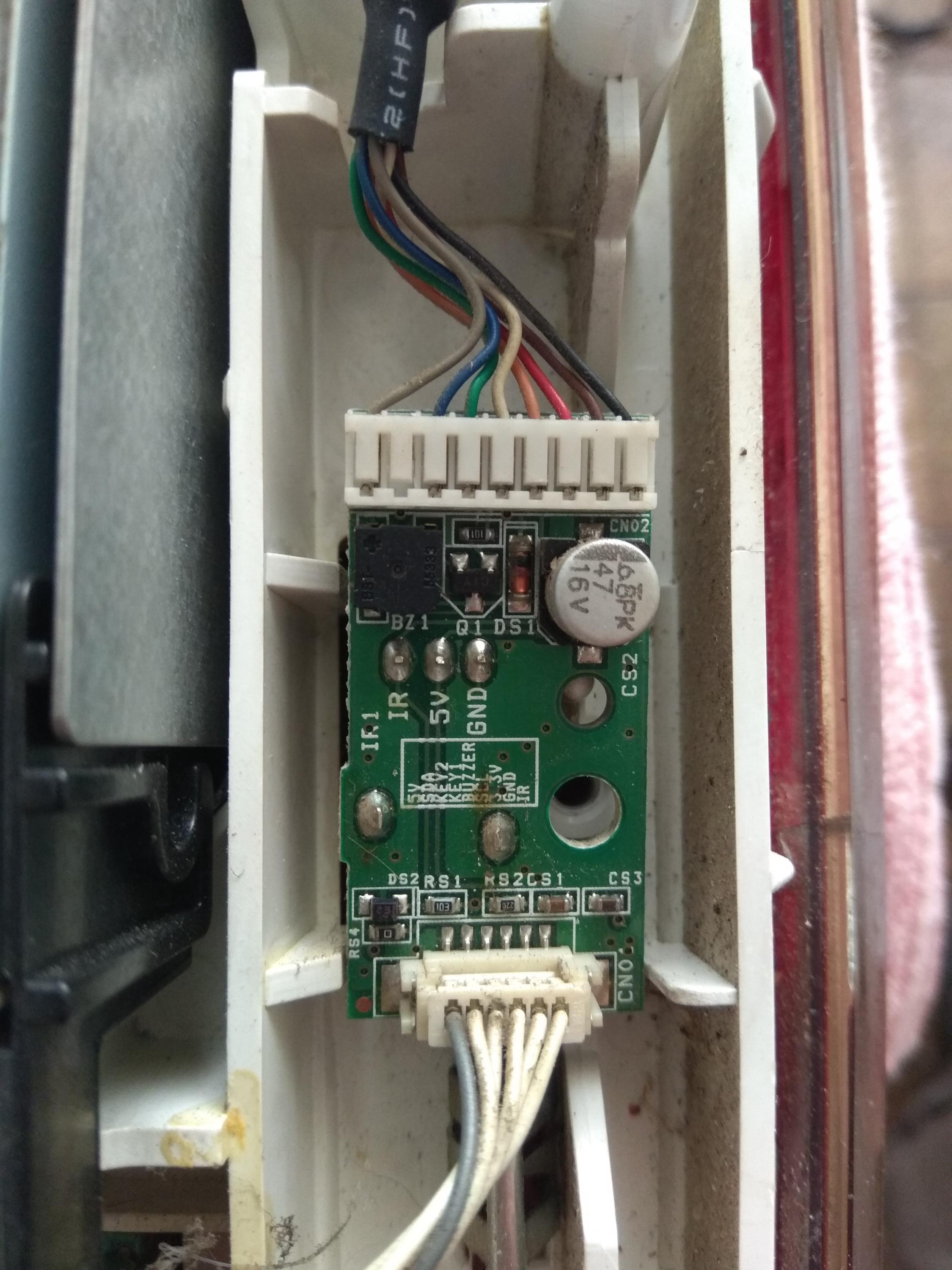

                        I get a bizarre reading when connecting ammeter between psu and mb on the 5v stand by rail. It indicates 0.5A. This doesn't seem normal (tv is turned off). Is there a schematic of the mb (BN41-00974B)?

                              In post #41 you told the psb behaves bad also whithout the main board, so it is not important to jump to the mainboard attention.. how many tl431 are there? The one to be changed must be the one of the 13v supply stage

                                    There is the culprit for the high current on the 5v stand by voltage! The diode and the cap are shorted. Trying to find a way to turn on the set without the panel (led,touch,infrared) connector.

                                        Re: Samsung le40a656a1f reaaaaaly slow poer up
                                        If you didn't yet, unhook that board from both sides and retest the diode and cap, if they both still read short, take out of circuit the easiest one to get out first and recheck and check where they connect to the board see if the short is still there or gone, need to fix any short or tv won't work.

                                          I removed the grey ribbon (touch pcb) from the small pcb and the short is gone. Powering on, the cap voltage is 5 volts, ir still works but once again no image or sound. Going to remove the diode and see...
