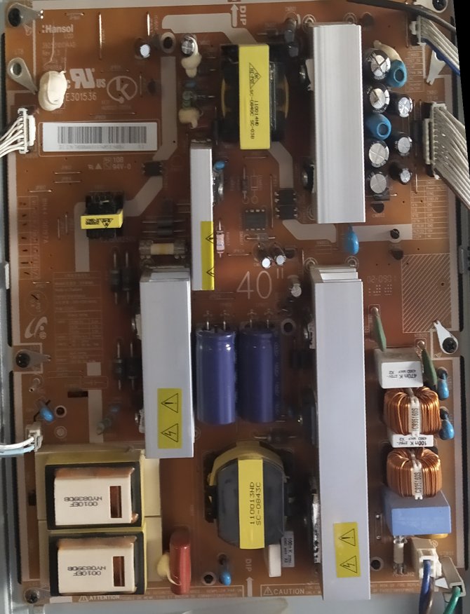

                    Ok, definitely wont hurt to do so. Im attaching a pic of the PS board. There are some medium size caps around the (already) swapped ones (pic taken before swapping), but there are also some other smaller caps farther away.
                    Should I care for those too?

                        Not a bad idea to change all those electrolytic caps, just for good measure but I would for sure change those 7 right there.
                            Ok With "seven" you mean those together in the top right corner? But not the other spare and smaller ones at other areas of the board right?
                            If you look closely the bigger ones in that group of 7 are bulging and after the pic was taken, they were replaced. I would still have to replace the other 5.

                              Yes, you may be fine just changing those 2 but electrolytics life expectancy is 10 years even tho some have worked for 50 years or more, it's definitely the aluminum electrolytic caps that go first, I would just change those out those other 5 and see how it acts.
