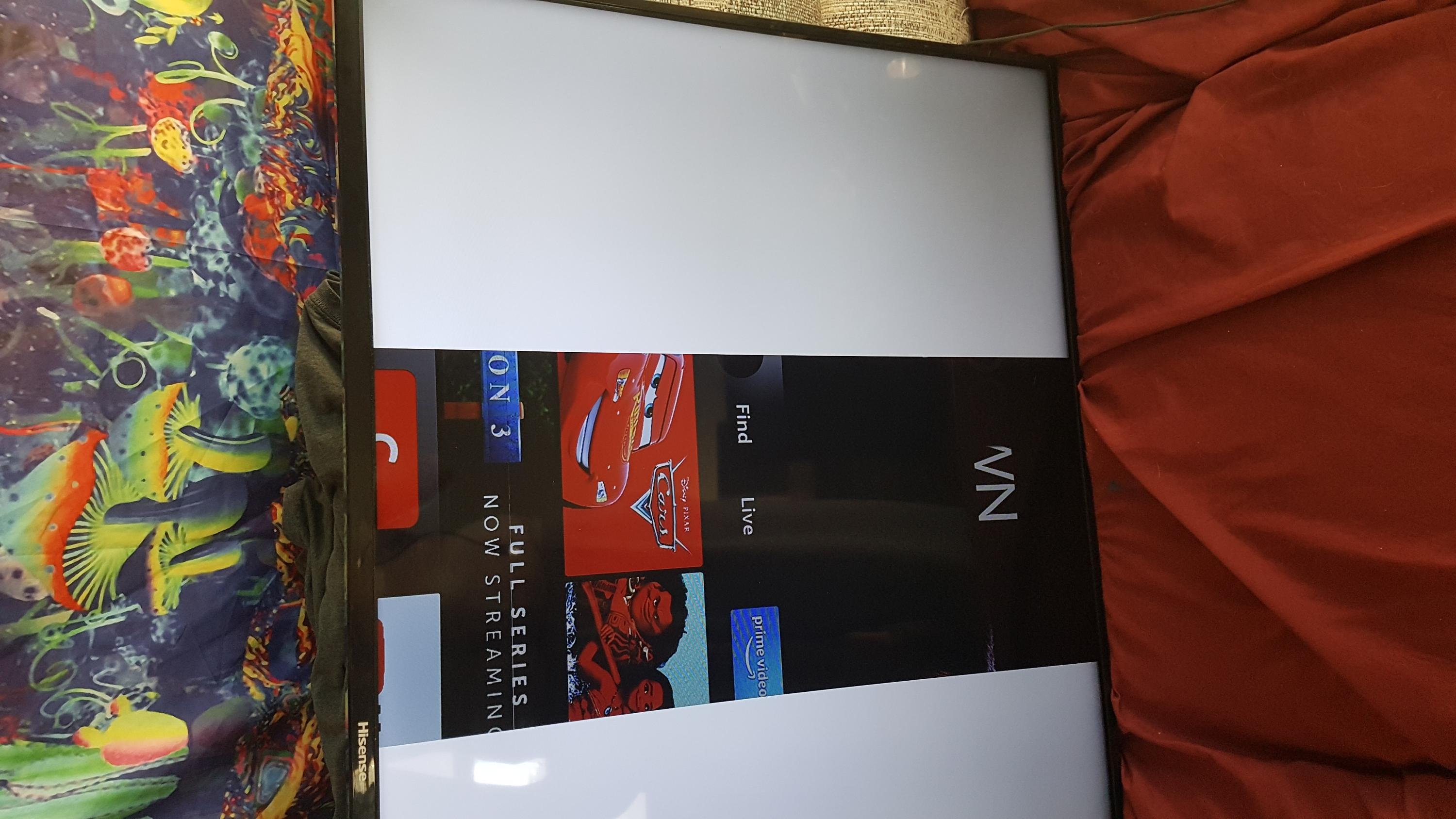

HiSense 50CU6000 screen goes black after a few seconds

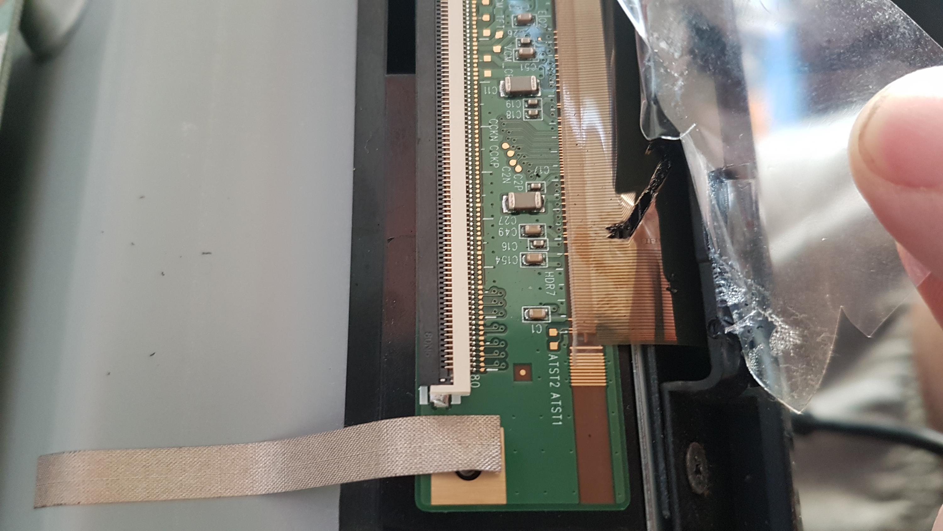

        Re: HiSense 50CU6000 screen goes black after a few seconds
        Might be a candidate for "tape cut-off method"
        Forgot to attach a pic last time. Also when the tcon came of the side of the screen by the power buttons got pretty hot. I'm guessing I fucked it, not sure why I bought a broken tv anyways when I usually get them for free.
        • Diah
          • Feb 2013
          • 6596
          what hell this photo ???
          did you broken the ribbon cable... it look you have short on the ribbon cable
          • MikeRWK
            • Jun 2017
            • 121
            I swapped the ribbon cable from the other side and part of the screens circuit board caught fire and a trace burnt, she's fucked. I think I fucked something up when the tcon came off the the tv while it was powered.
              You mean you only get a quarter now, when last exact setup gave you half a good display?
              • nomoresonys
                • Jan 2013
                • 12331
                • U.S.
                Oh crap.

                    #29
                    seam you never listen to other Man... the first point i write to screw the t-con to chassis..
                    sad.

                      #30
                      When the tcon lost ground it found it somewhere else...
                        dont do any things more its not bad... remove the speaker and metal cover of the panel boards let see where it damage... its look just lines not parts burning
                        I thought I had it screwed down already.

                            #33
                            Ok, Dr. Frankenstein, let's re-prep the patient for surgery.
                            I'm done. Whatever happened to the tcon it gets hot as fuck now, so even if i fix the traces on the screen they'll just burn up again.

                              #34
                              if you can fix the traces.. you will be hero... then with replacement t-con yours set will back to life
                                I'll try to fix it sometime but for now I've had enough.
