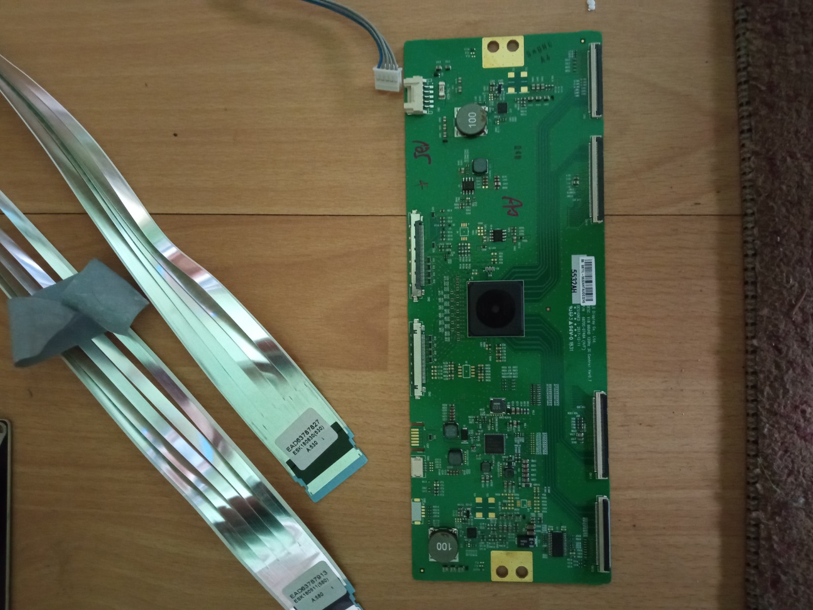

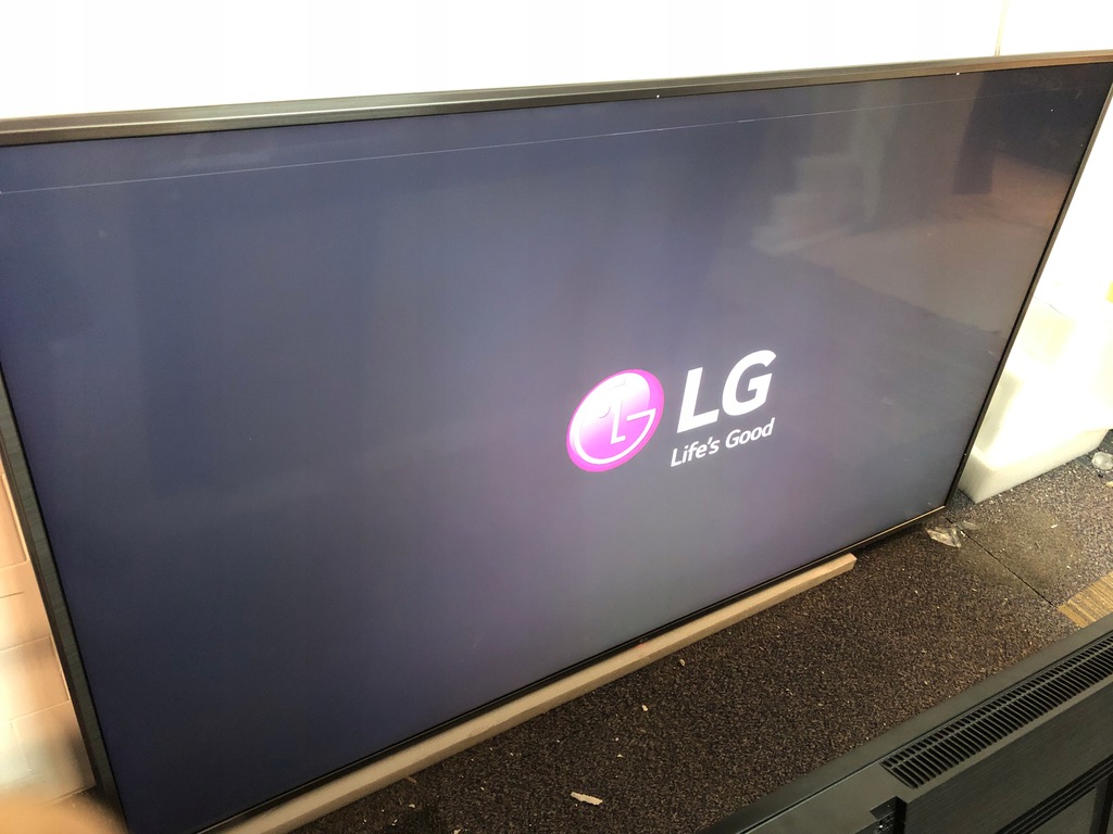

    I'm trying to fix a 86inch monitor from LG. It is LG 86ul3e-t
    The symptoms are:
    - after power on the LG logo blinks for a 1-2 seconds (there is a horizontal line visible for a short while at a top).
    - then the screen comes black, but the backlight stays on
    I can power it off with a remote control.
    I thought that the mainboard was damaged, but I have checked it with another one buyed on auction, and it didn't helped. I have checked also another power board, and even changed all three boards pulled from another 86inch LG TV. Every time the same result - LG logo and black screen.
    LCD panel looks fine. LG Logo looks excelent, when it is shown

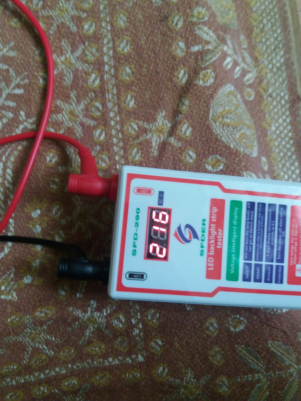

    I tried to checked the backlight LEDs, and all LEDs are fine. With the external tester, each LED circtuit shows 216V DC. When I measure the voltage on the power board, then on the first circuit (left side) I get 215-216V, but on the seond one I see valid result 211-214V. But as I said - all LEDs works.
    Does onyone has an idea, what elese may I check?

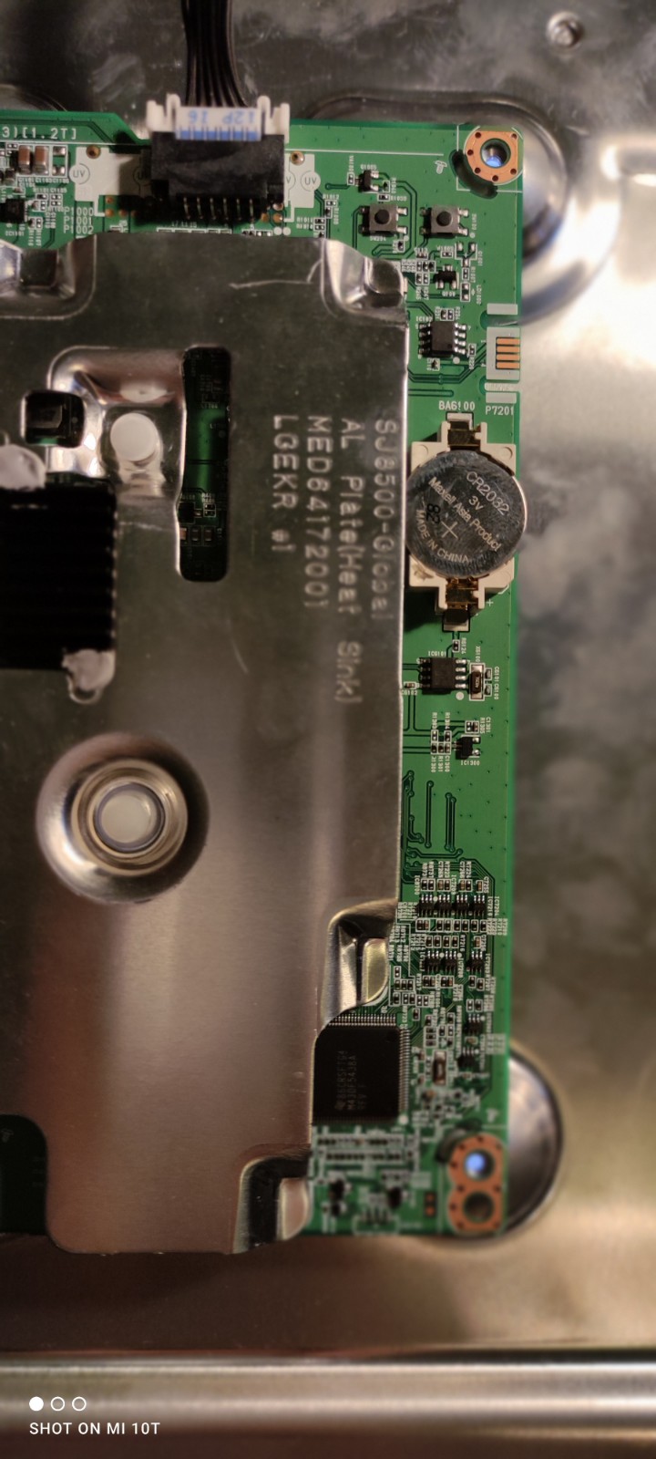

    could you show photo on whole back of boards to see how they connected... specially the T-CON. if it separated or integrated with panel.
    BTW. did you feed it with signal before turning it on ???

      The TV is currently dissasembled. I checking the led strips, but all looks fine there for now.
      I'm attaching the pictures, that may show how the circuit boards are connected.
      I tried to connect a laptop VIA HDMI, but nothing was shown on the panel. I can't enter the menu. Only power up/down is possible from the remote.
      The led at the bottom of the TV flash 7 times during the startup. If the TV stays on for a couple of minutes, than it reboot itself (on the orginal mainboard). When I tried to connect the boards pulled from the 86inch TV, than it doesn't reboot, but just stays with the backlight on, without any picture on the screen

        this way you will be in lost.. the best way. are
        1-put all back.. install the original Main Boards in place.
        the test to close diagnose:-
        1- disconnect the wifi module & speaker from the set and turn on. ( to remove load ) if every things as before you have the 7 blinking.. then --->

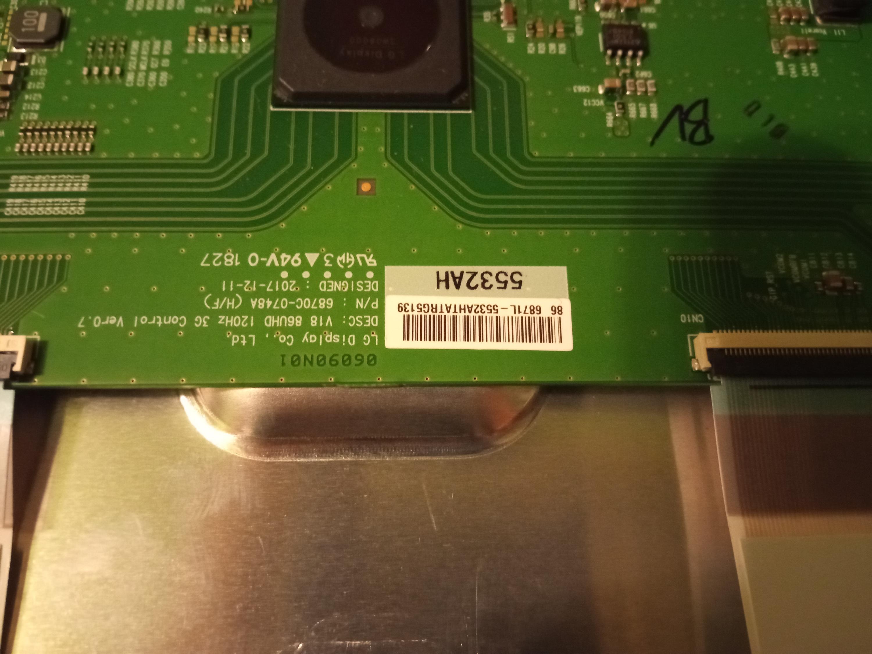

        2- locate the SPI flash on the T-CON.. write over here its label. ( the horizontal line you showed over here on the right top side.. its much T-CON issue..) but let start with T-CON firmware.
        3- disconnect one side of the panel ( 2 ribbon at once ) from each side.. see if the blinking cleared. and look if the panel display half picture..( this test should be with Signal preferred HDMI signal ) so the set will sync the signal and switched to input automatically.

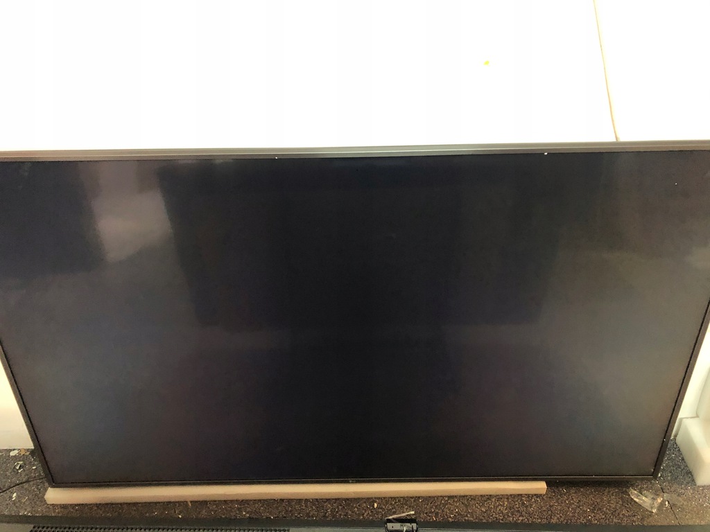

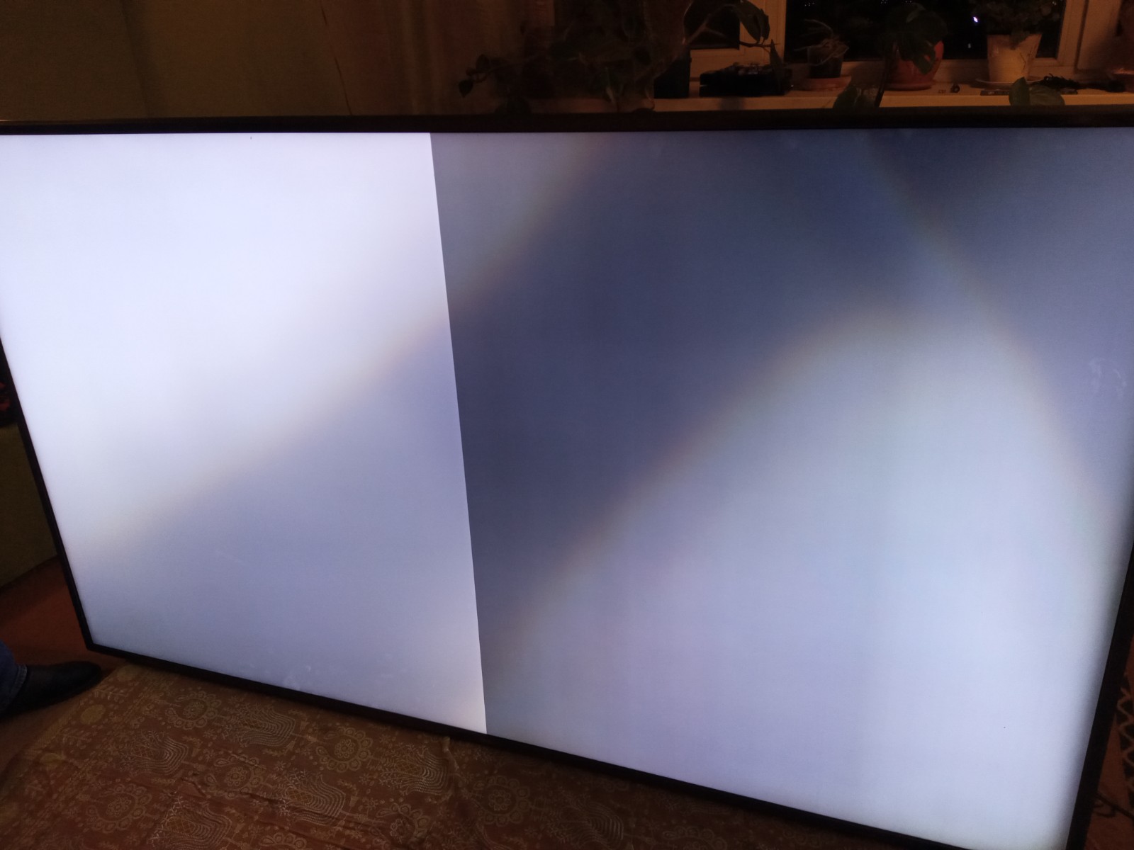

          Here is the result, when the two tapes from the TCON to the LCD drivers disconnected. On the next pictures you can see what happens, when the next two tapes are disconnected. I have disconnected also only the third tape, and only the fourth one.
          The logo appears only when all four tapes from TCON to the drivers are in place.
          I've connected my laptop via HDMI, according to your request. You were right - monitor was recognised in Windows as "LG Electronics LG SIGNAGE". But it didn't changed anything with the display, as is still stays black with and the backlight stays on.
          My assumption is, that the the power board works fine, the mainboard too. Backlight was tested, and all looks fine there. So the problem is somewhere in TCON or in the LCD drivers. I suppose that the LCD panel itself works fine, as it shows the beautifill LG logo, when it starts.
          Regarding the TCON
          I'm not sure which number represents the firmware version, which you have asked, so I'm adding the pictures of both TCON boards that I have (orginal one is on the metal background). Both TCONs works the same, so only the LG logo is visible at the start, and then the same problem with no picture on display.
          It looks like a some sort of protection. I have no idea where the problem could be.

            yours Photo . its look we have no clear white screen on this half.. but this issue we can deal with it later..

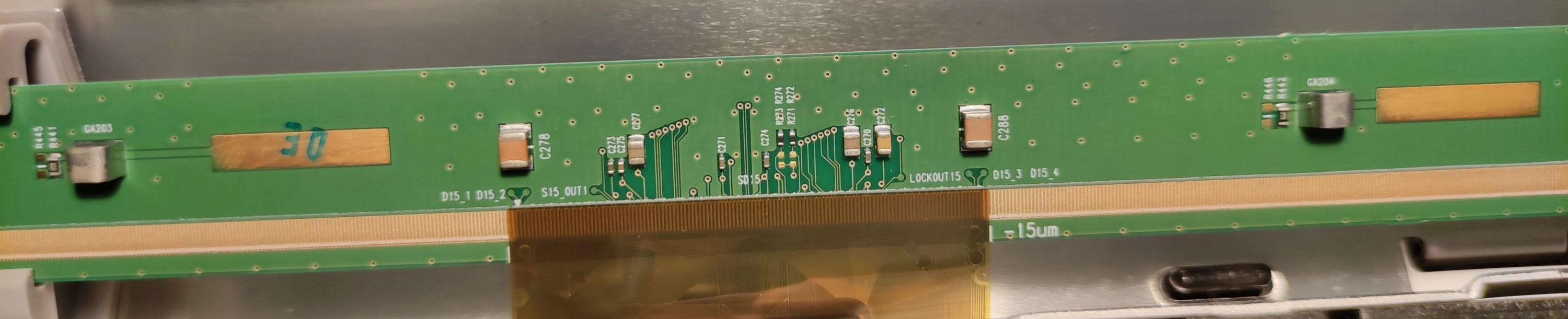

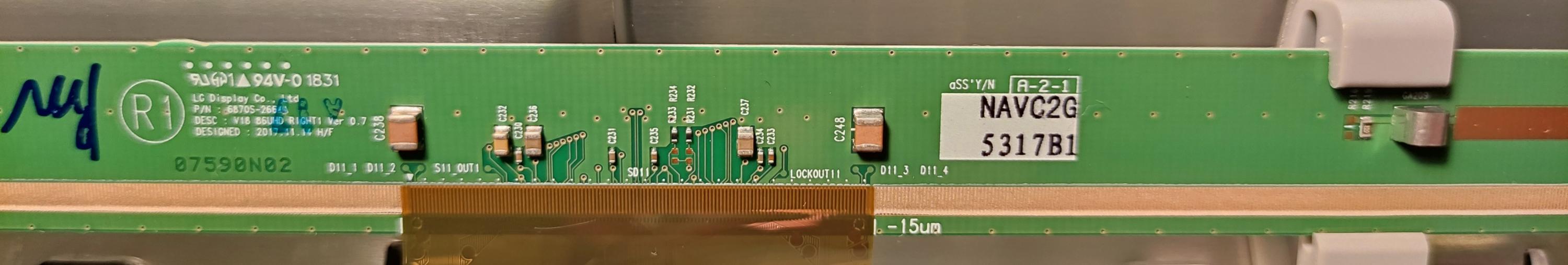

                  upload very close high resolution Photos of the panel edge boards from both side left and right.. we need to check if there are circuit build in which it make cutting signal.. between did this panel come with touch function??

                      Regarding the driver boards, here are the pictures.
                      The horizontal line that flashes on the screen, apperars only, when the right panel ribbons are connected (in fact it apperas only when the third ribbon is connected, as it is shown on the tcon_2.jpg picture). So I think that the problem is in the third driver board. There is also something written with a permanent marker there (pictures driver_3_2.jpg and driver_3_3.jpg).
                      What should I do next?

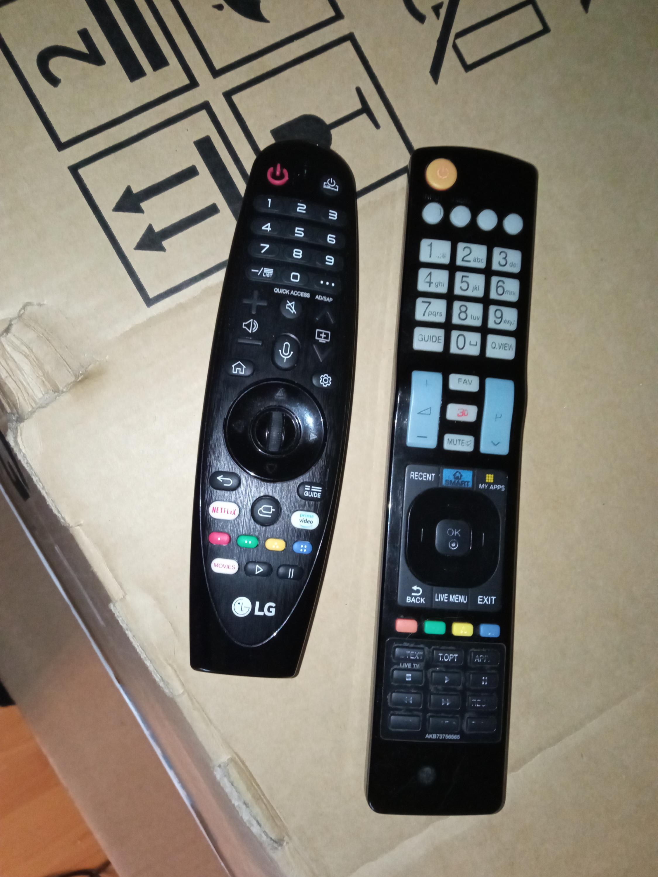

                          I already wrote, that the settings button doesn't work. I'm pressing it, but the display stays black(with backlight on). I can only turn off/on the TV with a power button from the remote. It seems that the panel is in protection mode or something like this.
                          Could it be a problem if I'm not using the original remote from this monitor? My pilot is from LG TV, but as I said - it can power ON/OFF the device.

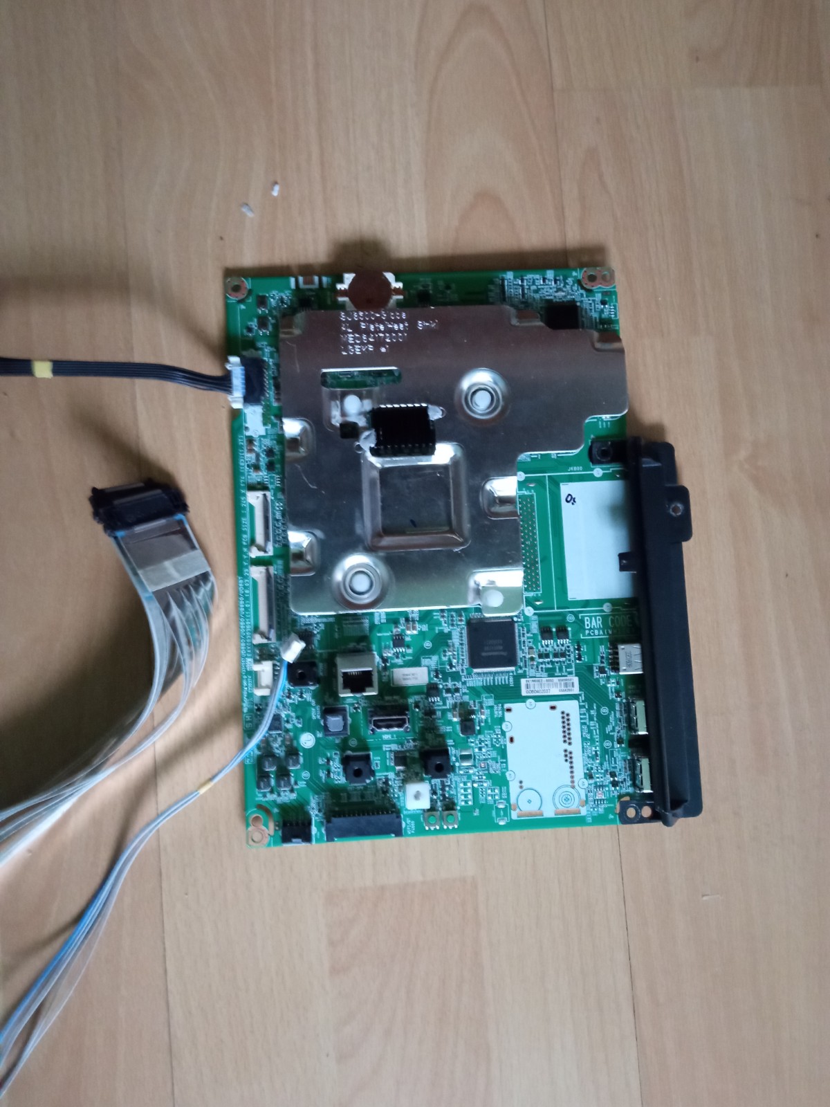

                          Some additional data. There are 4 buttons on the motherboard, as on attached pictures. I'm using 2 remotes and a application on my smartphone. All remotes are able to power ON/OFF the TV, but none of them can display anything after clicking the settings menu.
                          I have another set of motherboards from a LG TV, the same type. Maybe I should try with those boards?
                          It looks like a protection mechanism from a LCD panel. Driver sense some error on the 3rd IC board and it sends a power of as a protection mechanism. After the logo appears the screen can't display anything more. Mouse change nothing, USB with jpgs too, and the same with the remote and settings button
                          Some videos
                          Only Left ribbons disconnected
                          https://photos.app.goo.gl/Rn9c3CjYYM8soss29
                          Only Right ribbons disconnected
                          https://photos.app.goo.gl/Q9AeEz9JYTzXneSd9
                          Startup with LG logo:
                          https://photos.app.goo.gl/bFTGsJsoyG1gq4B17

                            both remote wasn't original belong to this Monitor !!! if you have android mobile with IR sender like Galaxy S5 download apk smart remote or RCoid and use them to send INSTOP to reset the eeprom of the set.. when the set On send the command followed with 0413 the set will go to stand by.. if there any protection or wrong setting will be set to default ( factory state )

                                I have followed your advice. With RCoid and a LG service remote I was able to send the INSTOP command, confirmed with the code 0413. TV has set itself to the standby mode. Unfortunatelly, after the power on, the whole story repeats, and there is again only a LG log, a horizontal line flash for a while, and the screen stays black.

                                  did it show you the password box when you sent INSTOP ?
                                  • Panczis
                                    • Oct 2020
                                    • 28
                                    • Polska
                                    Re: LG 86ul3e-t logo blinks and then nothing (but backlight stays on)
                                    No. I just pressed in-stop (the remote sensor led on the TV blinked), typed the code on remote (the remote sensor led on the TV blinked) and pressed in-stop again and the TV went to stand by mode. Nothing shows on the TV for all the time. No metter what I'm trying to press there is the same situation all the time. The backlit is on and there is nothing on the screen... You can see it on the movie I attached to the message #13

                                        1- INSTOP need to send one time only.. you send it then follow with 0413 ( nothings more need ) if the set accept it will turn off to stand by alone.
                                        2- you wrote when you pressed INSTOP on the mobile remote the LG LED at front blinked... good if it so... did it blinked before when you tried press setting on the remote to inter the menu ???
