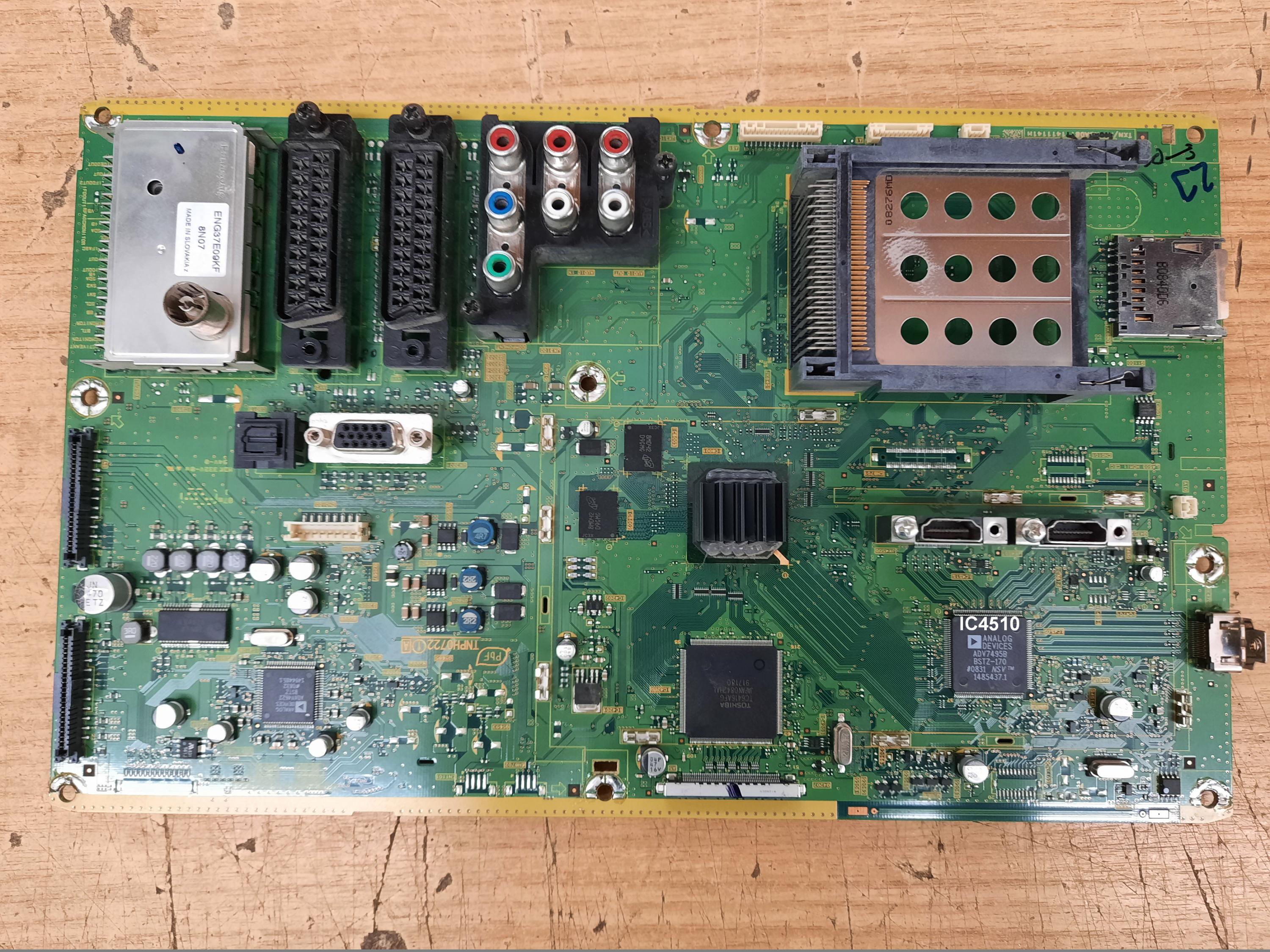

    Hi all
    As per the title , there's no signal via any of the 3 HDMI ports .
    Have inspected all 3 ports under magnification & no signs of damage .
    Checked the S M D components leading off from port pins & again seem good .
    TV works fine via free view channels , and s c a r t ports .
    My prime suspect is the HDMI processing chip I C 4510 .
    It's manufactured by A n a l o g Devices . Type ADV 6495 B B S T Z - 170 .
  • zen
    • 511
    Re: Tx 32 l z d 80 panasonic tv , no hdmi signal
    Managed to find a different Panasonic board in stock , that uses the same chip .
    Swapped it into the customers board , & success .
    On test via HDMI 1 at the moment & working well .
    Will test out other ports , then report back .
