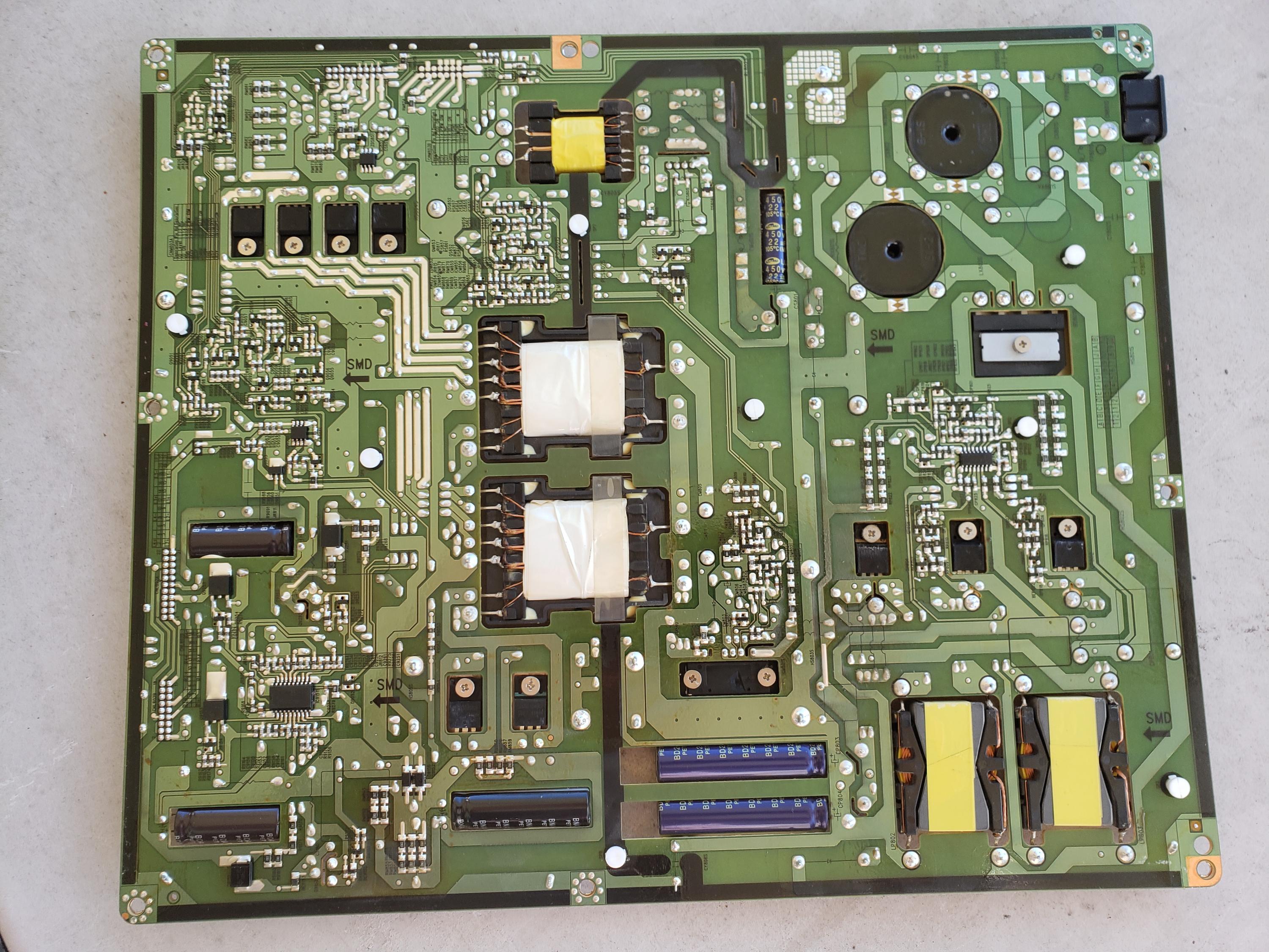

    Hi, I am working a Samsung UN60D6000SF that will not power on. Status light blinks two times with 5 successive iterations, pauses, and then repeats. Power Supply relay can be heard audibly clicking.
    LED backlights all tested with LED meter, all read 144V and illuminate when testing.
    Removing power cable between Main and Power Supply the backlights do not illuminate.
    With Main and LED disconnected PFC voltage jumps to about 390V and then drops to 240V, measured at CP804
    With Main and LED disconnected A5V is 5.3 V, B5V is zero, 13V is zero, and PS-On is 3.3V. Input to TS801S is 238V.
    With Main connected:
    PFC output at CP804 is 390V, varies a bit as relay is cycling but stays between 370V and 400V.
    Power on command is cycling from high to low.
    No B5V, 13V, or backlight voltage.

    Re: Samsung UN60D6000SF P/S BN44-00425A
    ICS801S and Transformer TS801S are for the standby A5V power supply which is working since you do report that you do have 5V at A5V.
    Post #1 "With Main and LED disconnected A5V is 5.3 V, B5V is zero, 13V is zero, and PS-On is 3.3V." so is the PS-ON 3.3V steady at 3.3v and never go down below 1V, correct?
    Post #1 "With Main and LED disconnected PFC voltage jumps to about 390V and then drops to 240V, measured at CP804" So the PFC Voltage stay steady at 240V and never go back up to 390V?
    Also when the main board and the LED connectors are not connected, the power relay stay on, correct? and not clicking ON and OFF, correct?

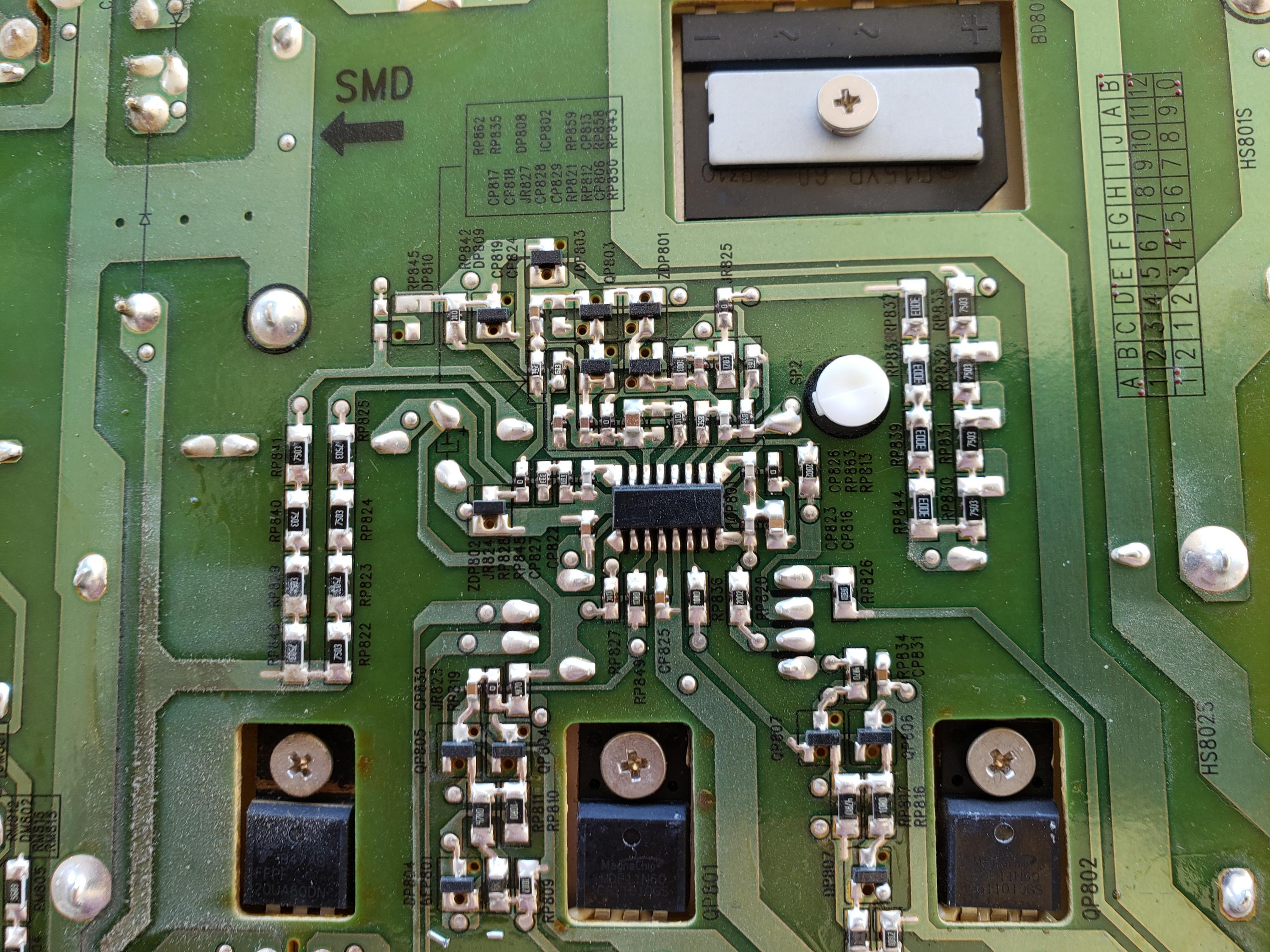

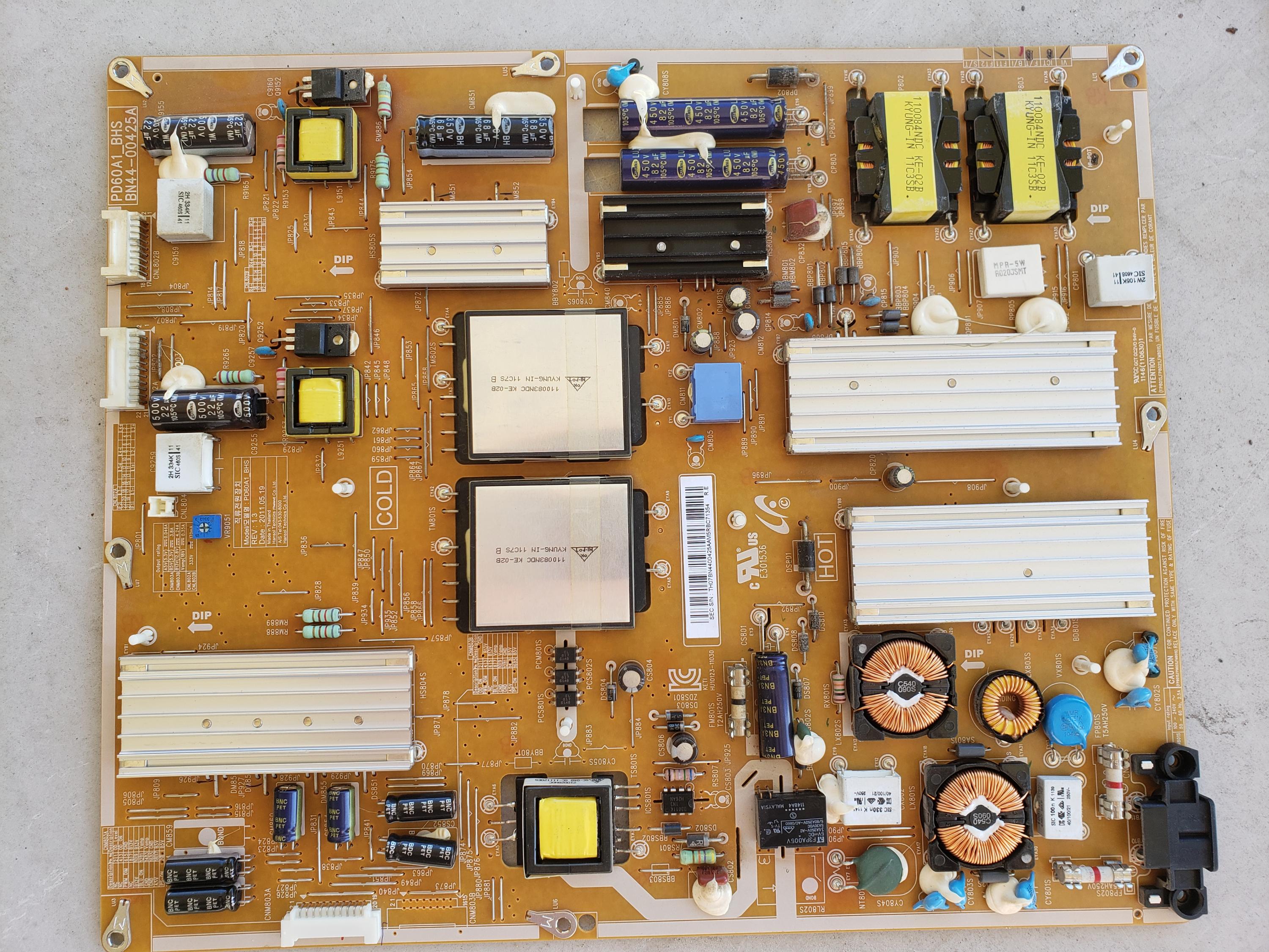

            Any idea what part number the PFC control chip is? This one is not readable - 16 pin - see attached.
              You need to use alcohol to clean the top of the IC so you may be able to read the prints on top of the IC.
                Thanks, i tried that earlier and again but just can't get there. I got the attached using a digital microscope, but I couldn't get any hits from those numbers.
                15A408M or DCC2806 see attached file

                  So a bit more inspection today and I noticed ICM801S had a hole blown in it, at least I believe that is the case - photo attached. The depth of the hole is about 2 mm. I removed the device and it has some quite low reading such as:
                  1 to 2 = 3.7 ohms
                  1 to 4 = 6.7 ohms
                  1 to 5 = 34 ohms
                  So am I correct in assuming with this device not operating the built in protect design will shut down the PFC and lower the voltage?
                  Any thoughts on why it blew, the diodes and caps on the output check out OK?

                    The pfc ic will be a UCC2806, Yes the ICM801s is blown, I would replace the 3 caps CM802, CM807, CM8112 as well
                      Thanks R_J, now that I look at the photo I posted it seems obvious. I don't know how I got an "M" out of that "U." Texas Instruments is even my old company, but I can't quite make out the "Texas State" logo on the chip as would be normal with their IC's.

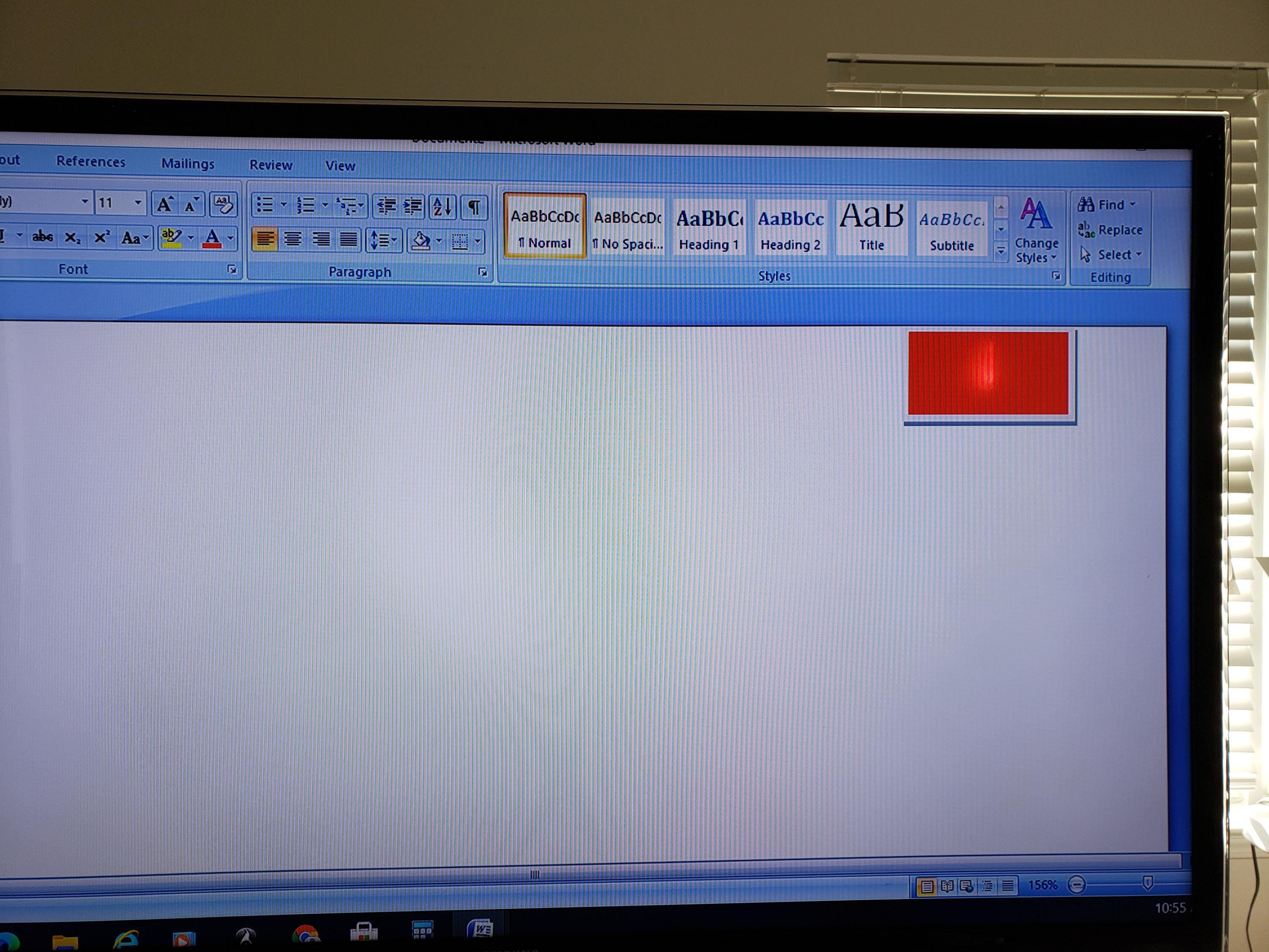

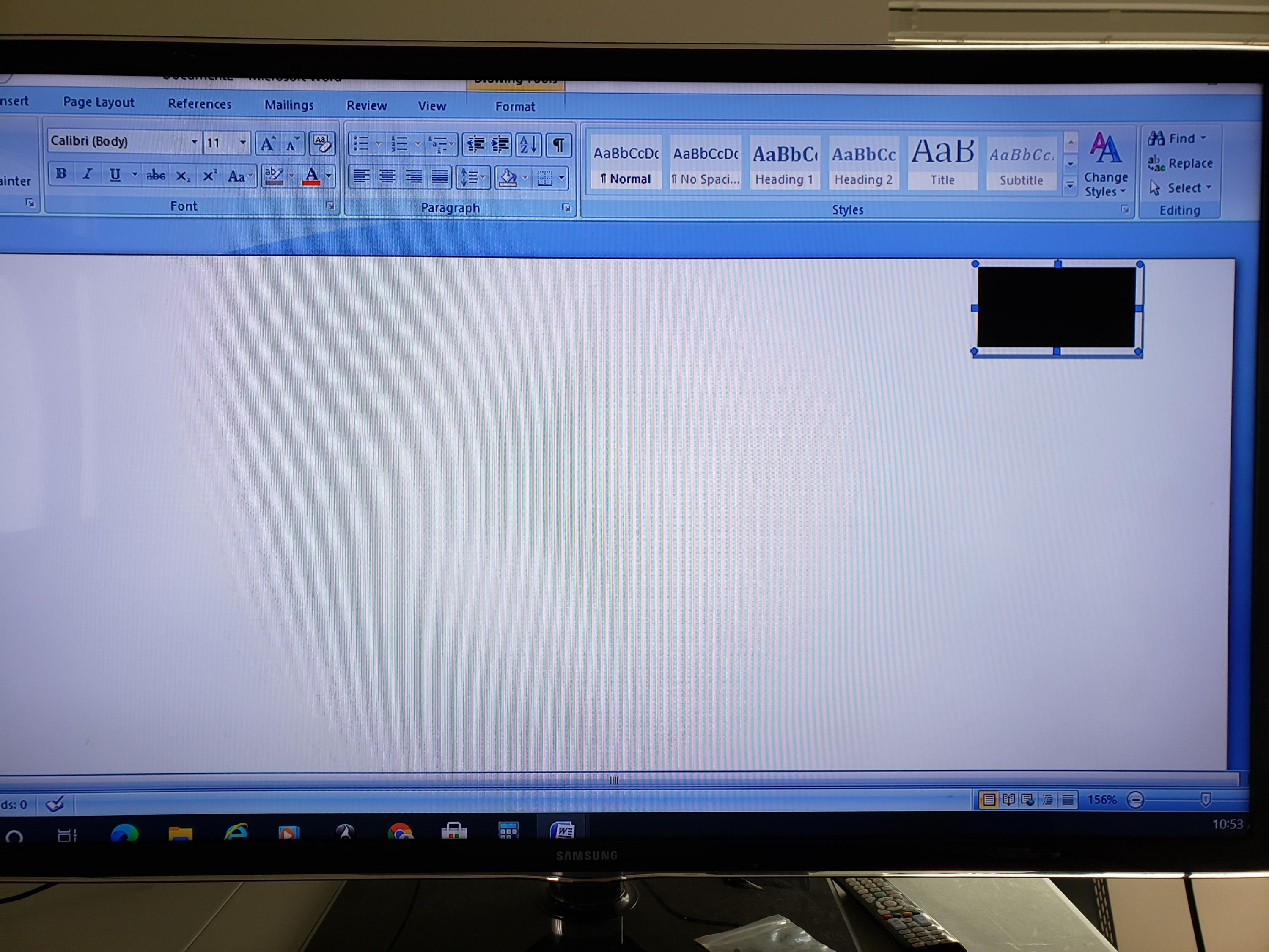

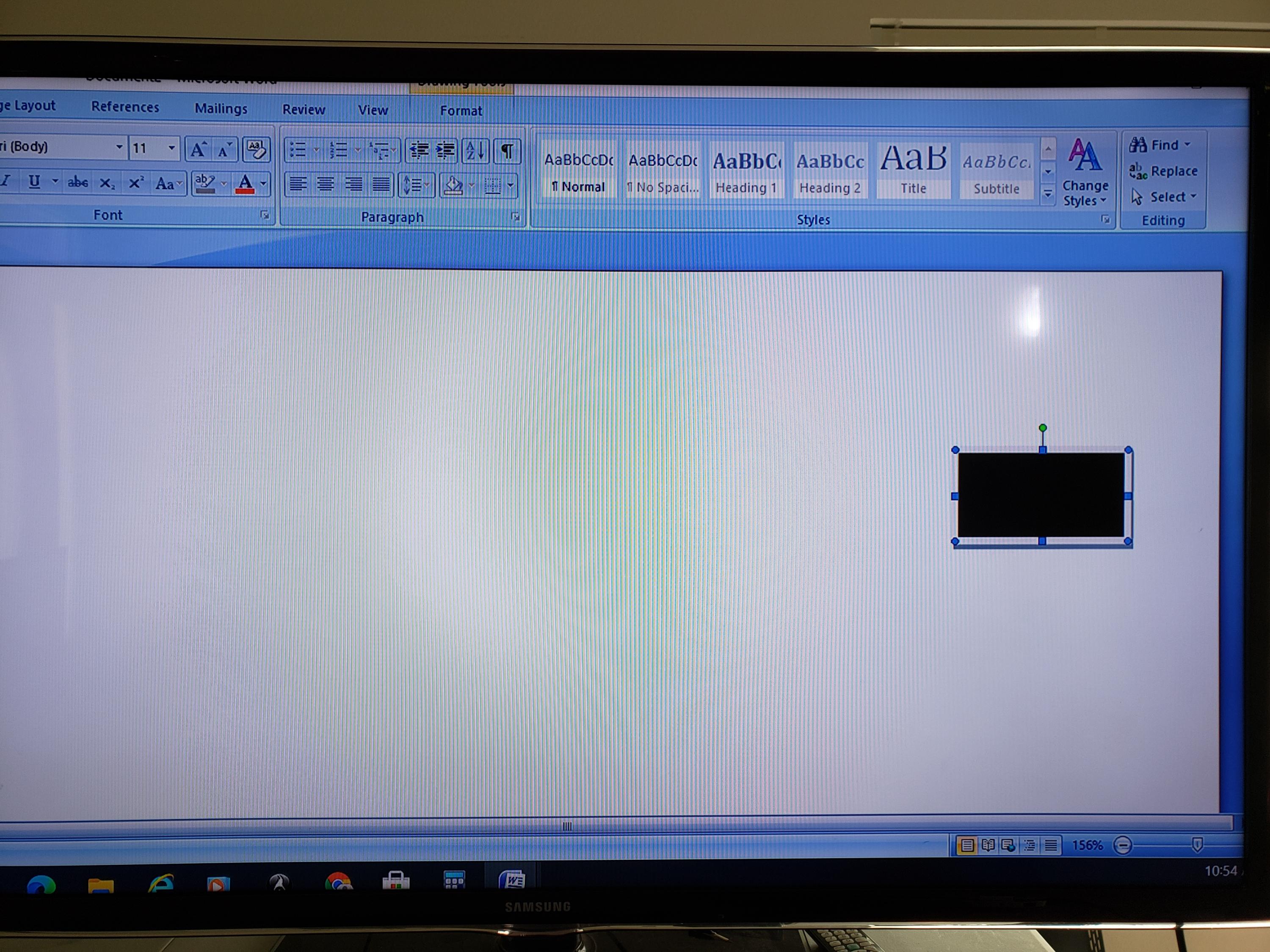

                        First off thanks for the help, the Power Supply is up and running after replacing ICM801S (FSFR2100XSL) that was cratered. The 3 caps were also replaced per R_J's suggestion.
                        Unfortunately, after seeing the video for the first time there is an obvious defect appearing on the screen - a bright spot in the upper right viewing area - see attached. Since this is an edge lit TV my first guess is a panel issue, but I wanted to ask if anyone else has dealt with this type of defect before and if there was any chance this is a light guide or diffuser issue?

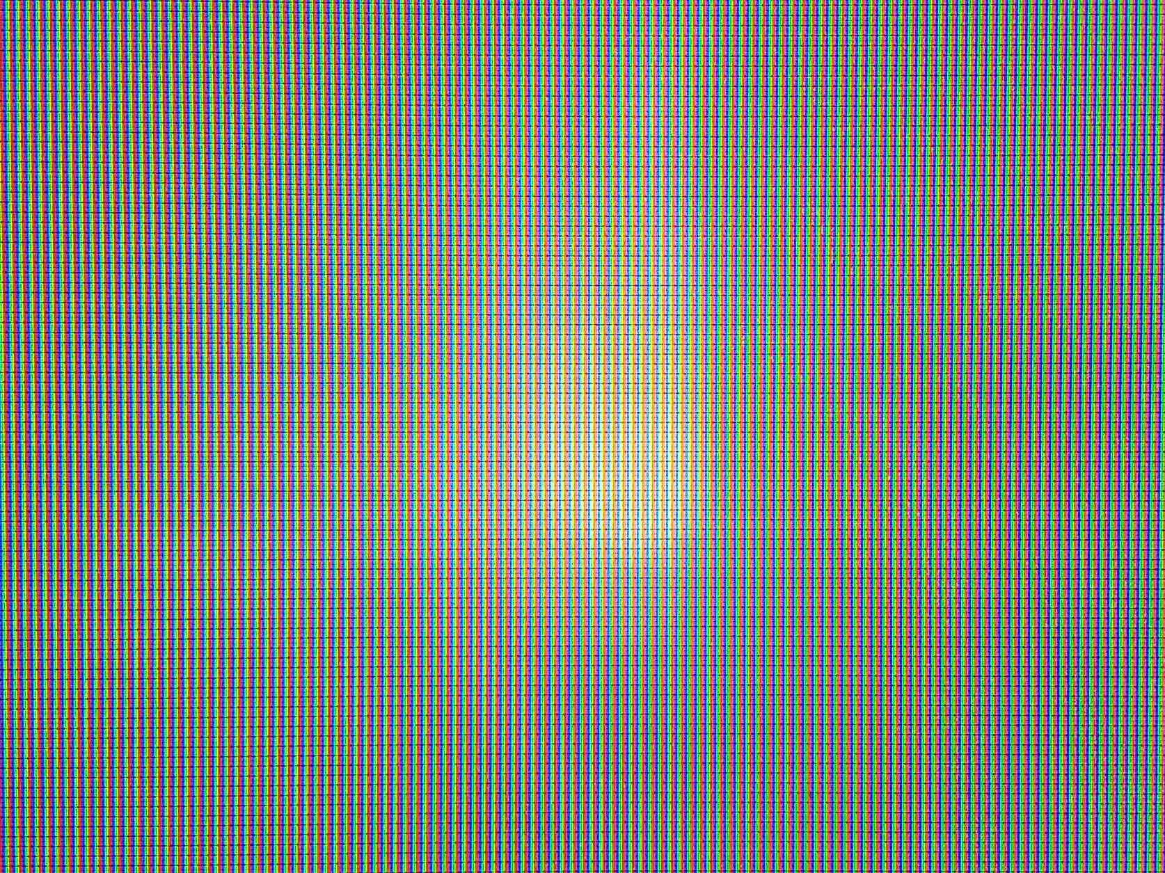

                          Adding a closeup view of the defect noted above. It's pretty obvious the colors are saturating in this area but I would be interested if anyone has some thoughtful speculation as to why?
                          • football0062
                            • Dec 2011
                            • 98
                            looks like you got a good scratch on the light guide, sits behind the lcd panel. if you can find a donor that uses the same model

                            with a broken screen for cheap, you could use its light guide, and be all set. very easy to scratch those things, so be careful handling
                              It is likely that the lens on the led fell off, this will show up like this.
                                not since this is an edge lit model, there are no diffusing lenses
                                  UA60D6600VJXXZ
                                  Thanks for the reply. I guess that would suggest someone has removed the panel before for LED repair. I don't know the history of the TV as it was a dumpster find, but I did see a big hand print on the metal chassis at the edge suggesting some type of repair action had occurred.
                                  It was manufactured in Feb 2012 so that would be a long time for LED's to last.
                                    Yes it does look like it is a edge lit model. I should have looked up the model first.

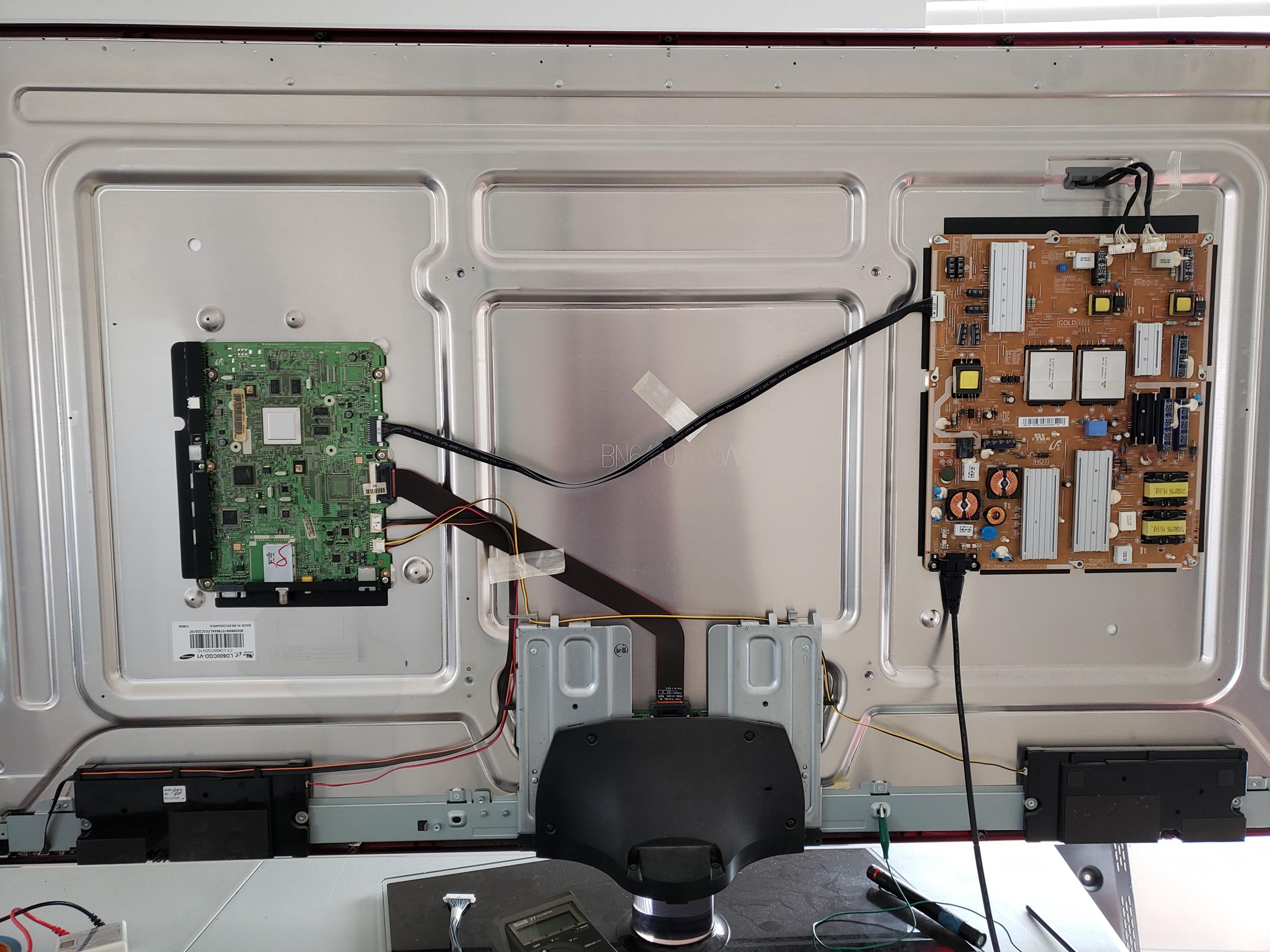

                                      Well it took a while but I finally tore this thing down - it weighs a ton so I had been avoiding it.
                                      Anyway, the video defect was nothing more than a smudge on the light guide. After removing the panel and powering the LED's on it was very visible. It was less visible with the diffuser sheets pulled up but still obviously there. I could barely see the smudge when viewing the light guide from an angle with the LED's off.
                                      I simply wiped the spot with some isopropyl alcohol and all was well. And, just to duplicate it I touched the back of my wrist to the light guide and a large bright spot appeared, which is odd that the area gets brighter, but that is what it does. A quick wipe with alcohol and no more spot.
