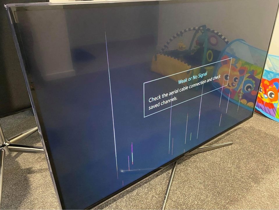

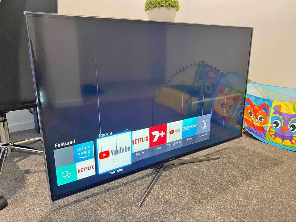

    Just a quick question if anyone has seen this before as I'm not sure whether to take this one on as a repair yet. I haven't seen this behaviour before.
    There is a Samsung 55H6400 screen (55 inch, 3D panel) that has some stationary vertical lines on it that are not full length. The panel seems undamaged physically and the unit is not suffering any other fault.
    Just curious as to what may cause this. Attached are two images of the unit before opening it up.

    Is it possible water damage where the screen has been cleaned and moisture has penetrated between the bezel and panel down to the ribbons. That is, if the panel ribbons are at the bottom. Just a thouught.

      to my eyes this is Noise LVDS signal. reason could be main boards...LVDS cable or T-CON.. need to test the T_CON and panel as stand alone to narrow the issue
