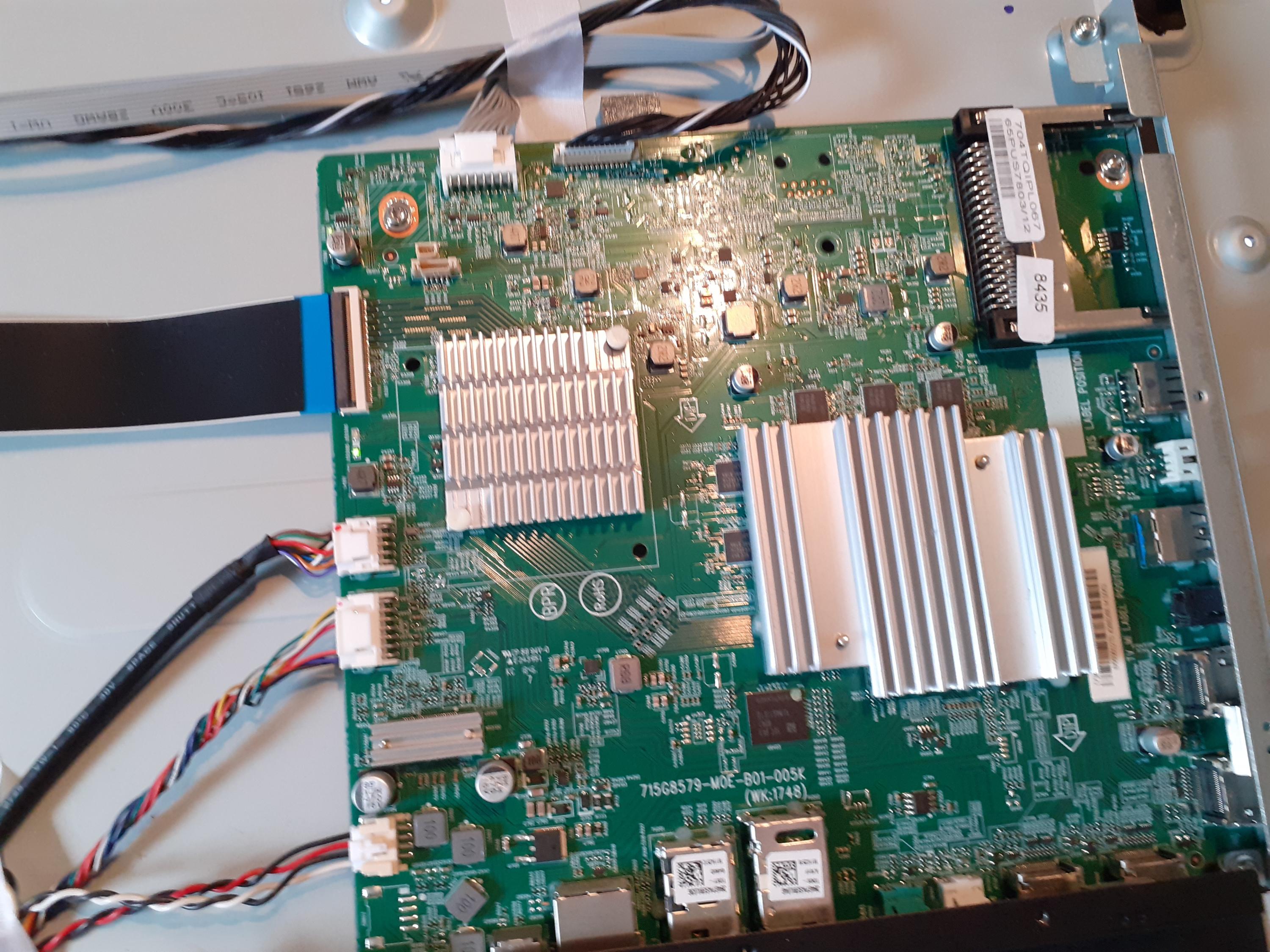

    For a month now my Philips 65PUS7803/12 has had problems on startup.
    It boots up every time, but 4/5 times it has no video. Sound and LEDS are on.
    You can shut it down and try a couple of times again and eventually it will come on after 4-5 times.
    It stays on and for the next hour or so it is possible to turn on the tv at once first try.
    It also has a pretty high standby voltage for an hour or so after shutting down (14 Watts +/-). After an hour it will drop to a more decent 0,1W
    I am pretty sure it is a main board fail since everything else is endeed working, but I might be wrong.
    What do you guys think?
    I want to avoid opening the tv if I can. these 65" screen are too big for me to handle without cracking the panel and if it is the mainboard I can't repait it anyway

          Re: Philips 65PUS7803/12 is only turning on video 1 out 5 times
          Thank you for this answer.
          Power supply I can work with. There some screws in the bottom of the back cover. I hope it is possible to open it this waay. I'll try this weekend and give an update how it went

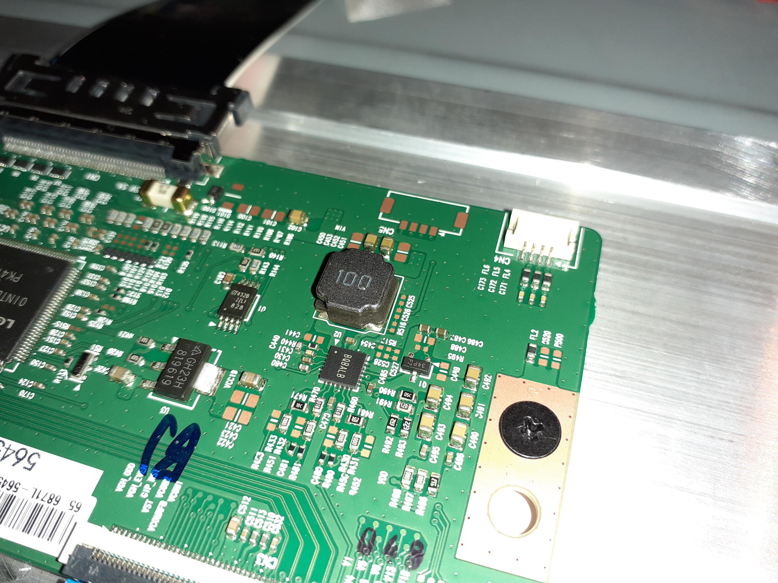

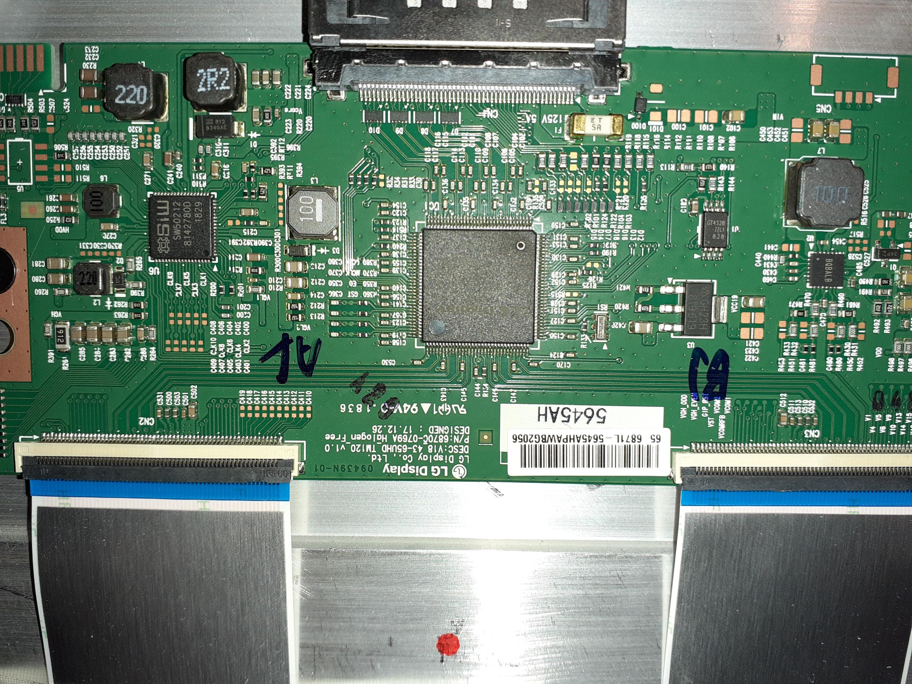

            It seems that the issue was the t-con.
            I get 12V on the tcon fuse, but it stops after the first transistor.
            I have no voltage on cofs when screen isn't working, but voltage when it does.
            Can anyone help with ordering a spare transistor? I can't figure out how to identify it
            It says 34P F7
              12V on both sides of the fuse?
                  Yes
                      Update: problem solved
                      Updating the firmware did not help
                      I ordered a new t-con from aliexpress and installed it. TV came on immediately and has been working ever since
