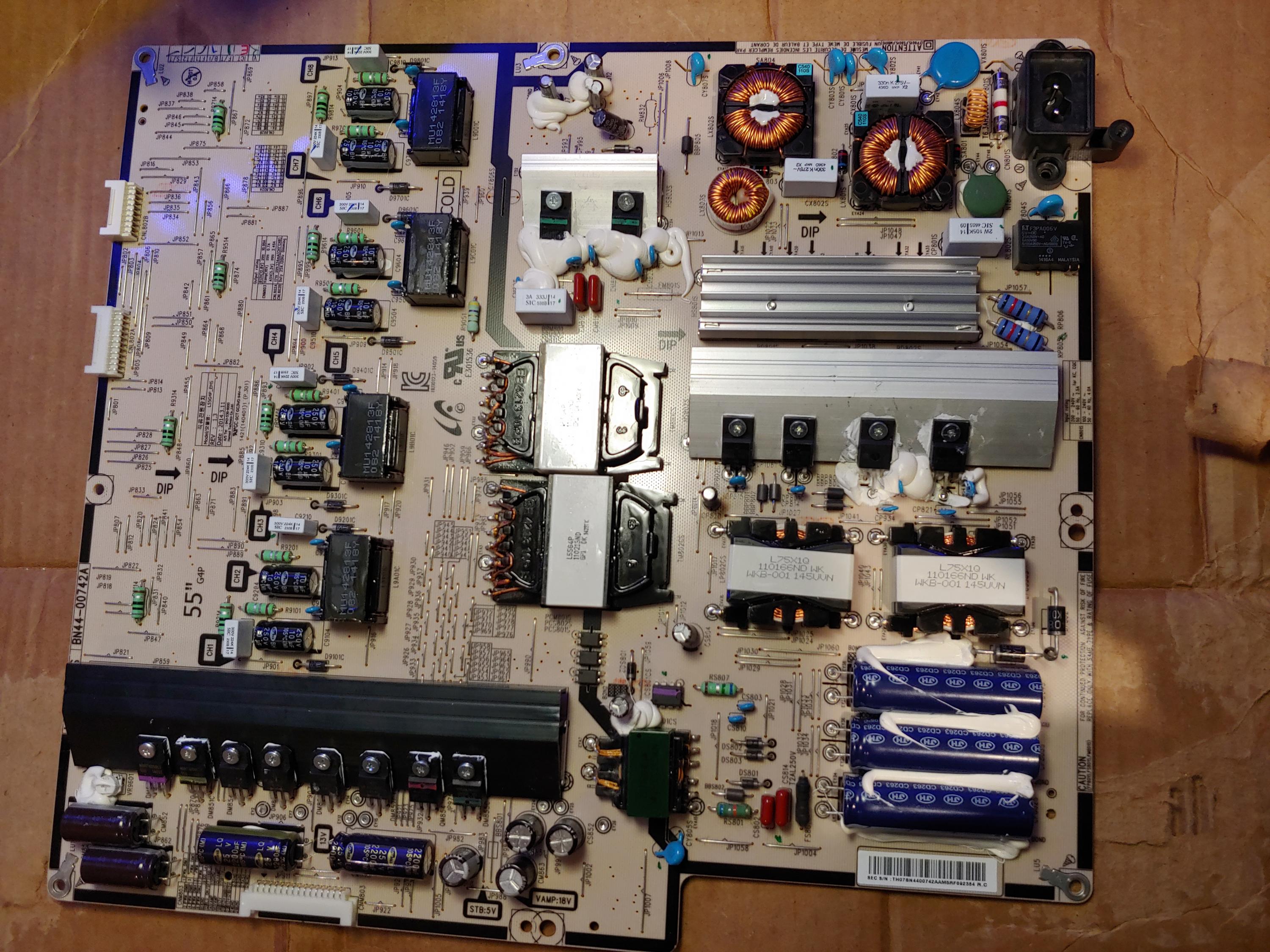

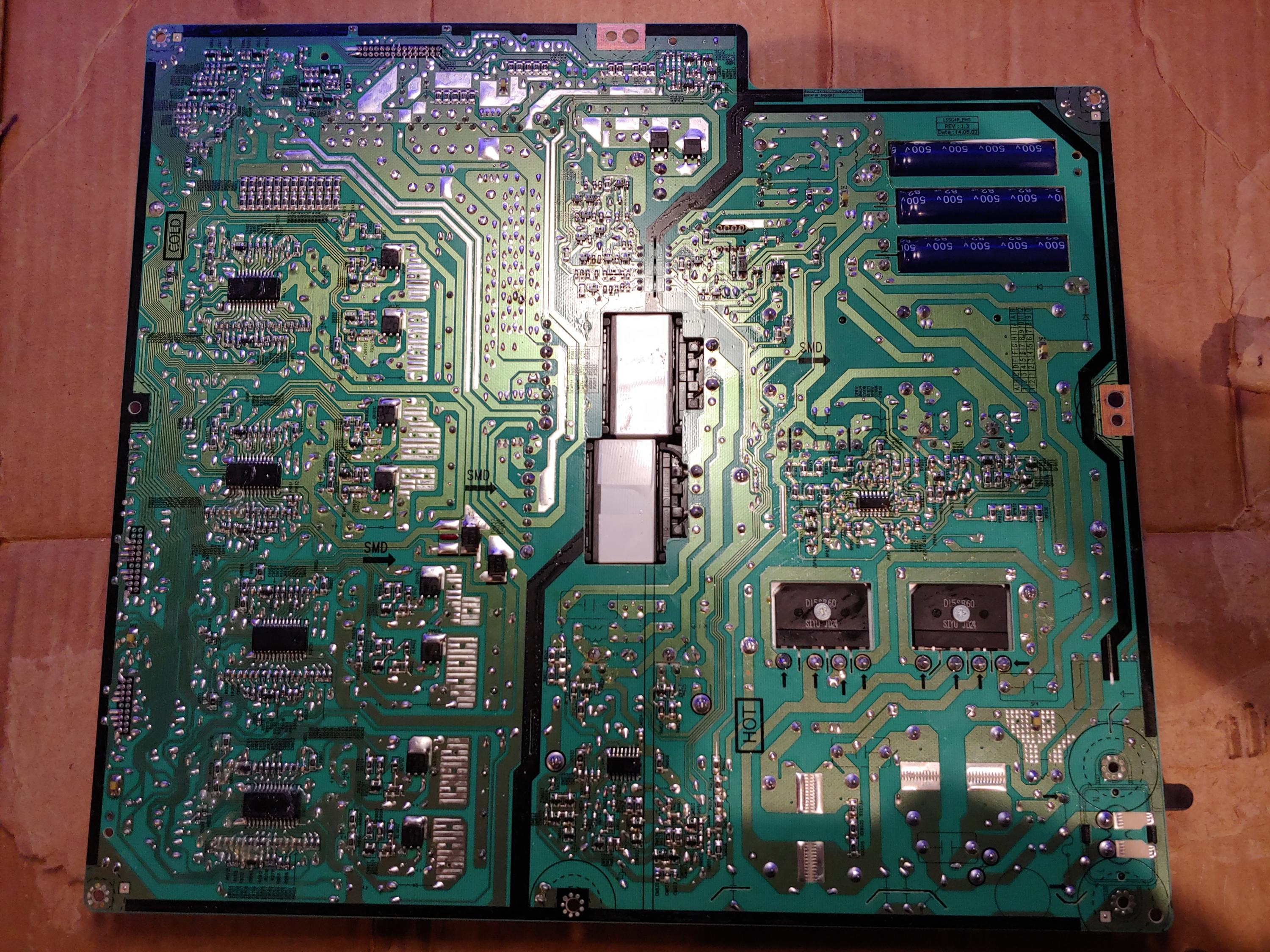

    Below is my issue:
    I have a Samsung 50uhd8550. The standby led is on but pressing the power does not turn it on. I disconnected the connector from the power supply board to main board and the backlights did not come on. I measured the pins on the connector CNM803 and I only gets the following:
    PS ON/OFF = 3.5V
    A5V = 5V
    ALL other pins are showing no volts.
    Any help will be appreciated. Thanks in advance.

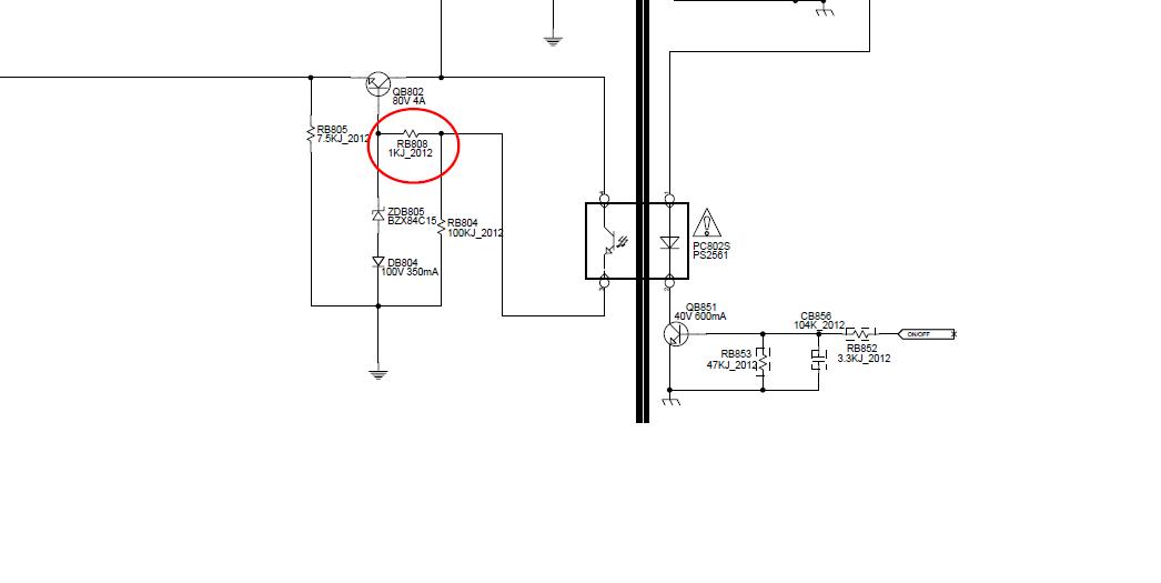

                      The collector voltage seems ok, the base is not correct, There should be a zener diode (ZDS802) and another diode (DS811) in series between base and ground, then there should be a resistor from the base that connects to pin3 of an optocoupler (PC802S) and the other pin4 will connect back to the QS801 collector (or vcc source)
                      I traced out the circuit the best I can, here is a basic circuit that is similar.

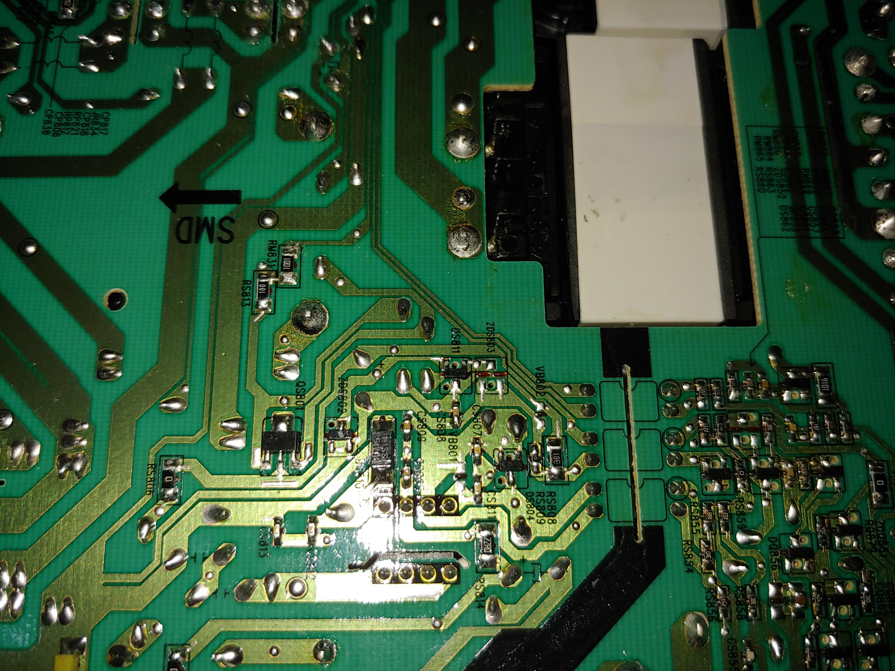

                        Re: Samsung 50uhd8550 standby led pressing power button does not turn TV on
                        Hi R_J,
                        I have attached an image of the the QS801. Where exactly do you want me to get the readings.

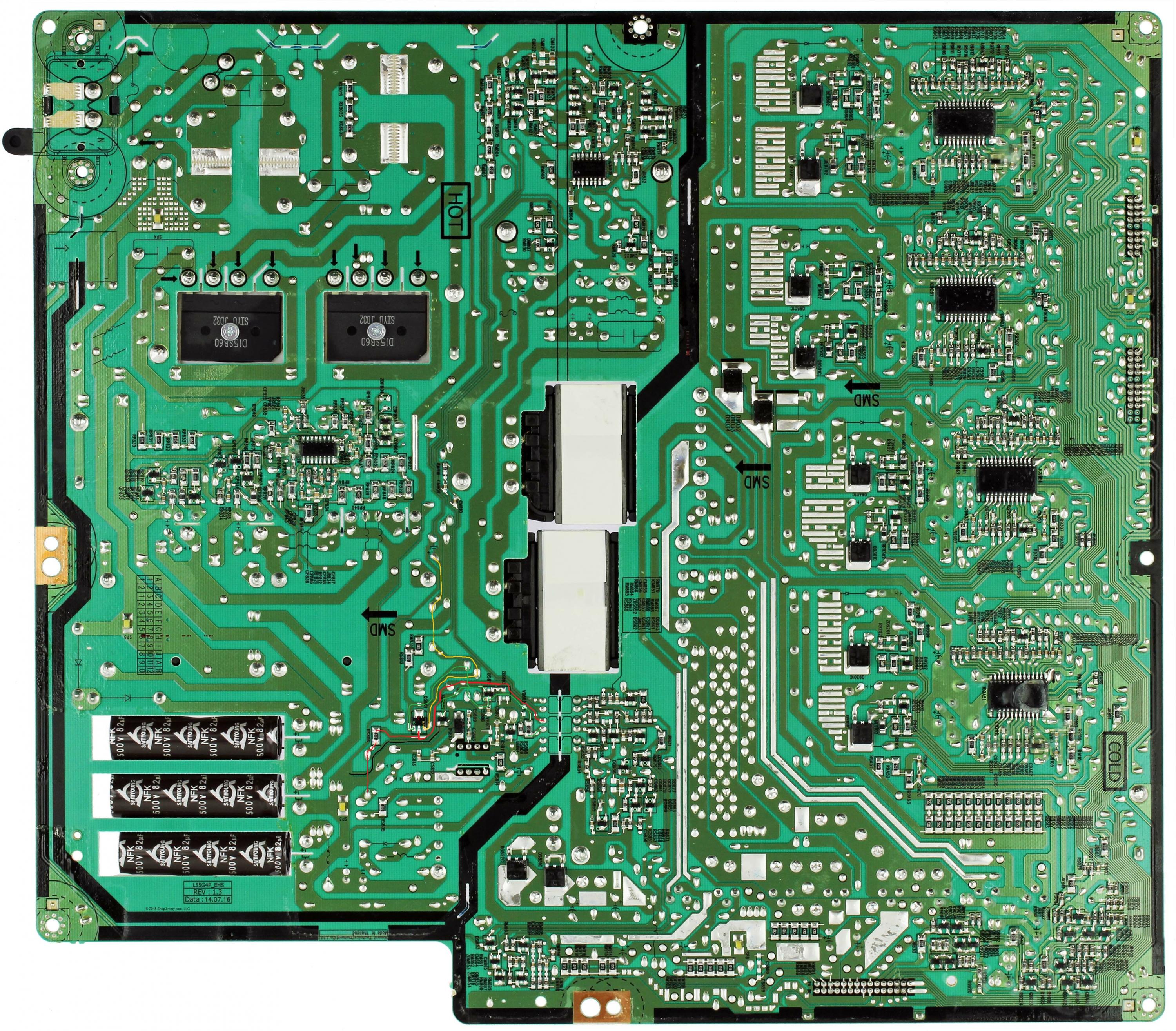

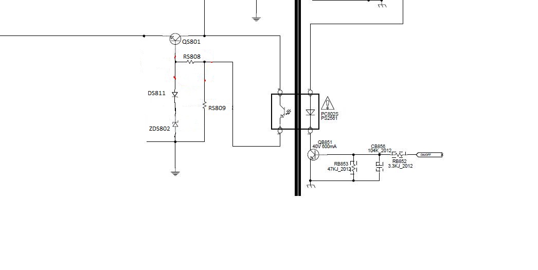

                          I tried to trace out the circuit, Red should be raw vcc source, Yellow is the VCC to supply the main/pfc ic. Green is the base and control circuit, when the optocoupler led is turned on, pins 1 & 2, the pins 3 & 4 are basically connected together. I added a basic circuit so you can get the idea of how it works.
                          When the power supply is forced on, opto pins 3 & 4 should be close to the same value, if not it could be that the opto is not being turned on or it is bad.

                              Check that ZDS802 is not shorted, also check the voltage on pins 3 & 4 of the opto when the opto is turned ON, it should supply 18v to one end of RS808, the other end should connect to the transistor base and apply about 15~18v (depending on the zener value)
                                Check the pin 3 and 4 of PCS802S. Pins 4 shows 21.4v and pin 3 shows 100.1mv when the power supply is forced on.
                                When it's not forced pin 4 of PCS802S shows 18.6 and pin 3 shows 3.56v.
                                The end of the resistor RS808 is showing the voltage on pin 3 of the PCS802S.
                                • R_J
                                  • Jun 2012
                                  • 9535
                                  So either the optocoupler is not turning ON, OR the zener diode is shorted
                                  • waakye
                                    • Dec 2018
                                    • 340
                                    • Electronada
                                    Could you tell me how to measure the zener diode?.
                                    • R_J
                                      • Jun 2012
                                      • 9535
                                      Using your multimeter in DIODE test, check the resistance from the single lead end to the double lead end, then reverse the leads and check again, one way it should be around .6xx the other way should read open circuit or close to it.
                                      • waakye
                                        • Dec 2018
                                        • 340
                                        • Electronada
                                        One way reads .376 on both ends and when reverse reads .470.
