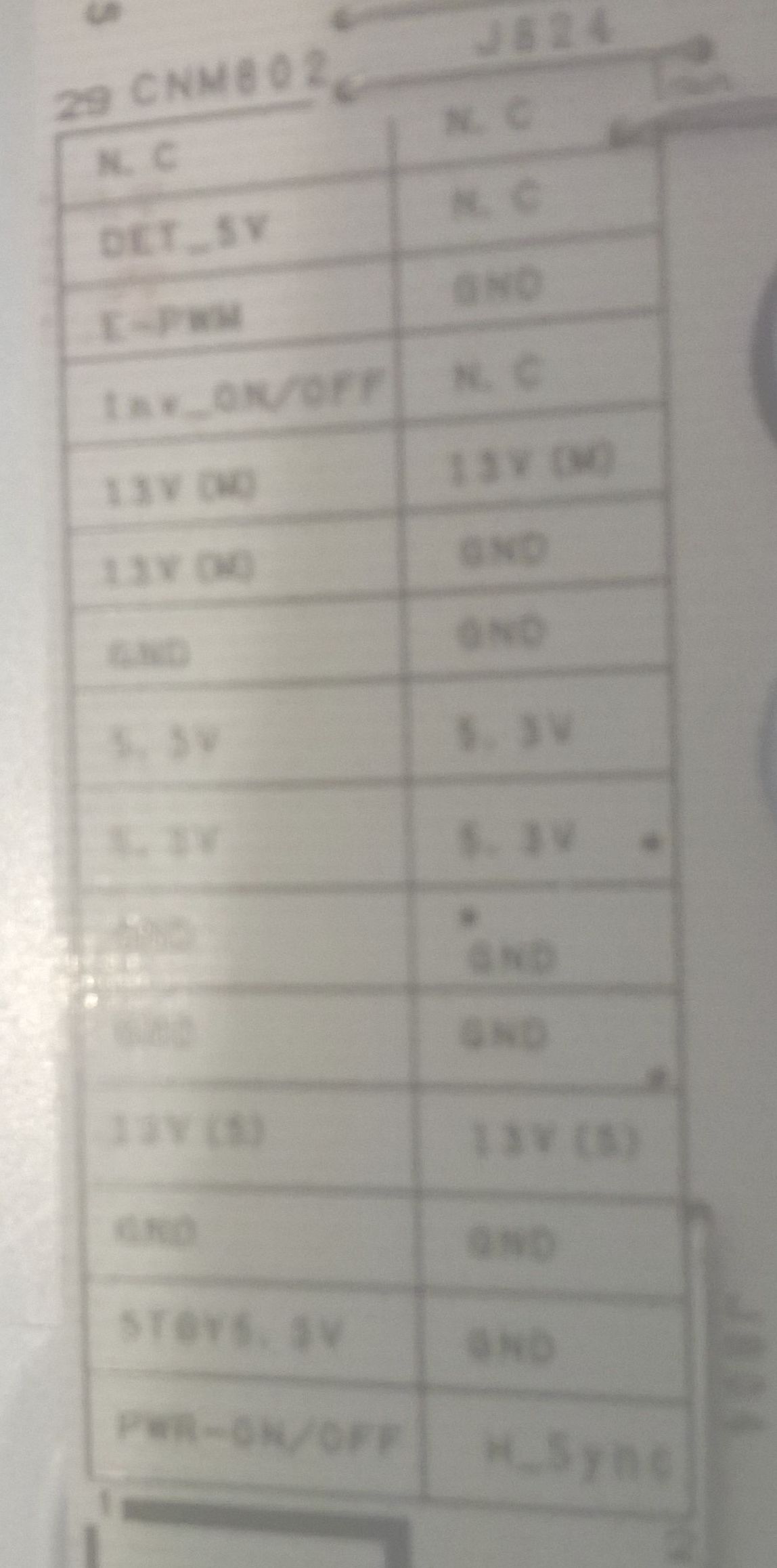

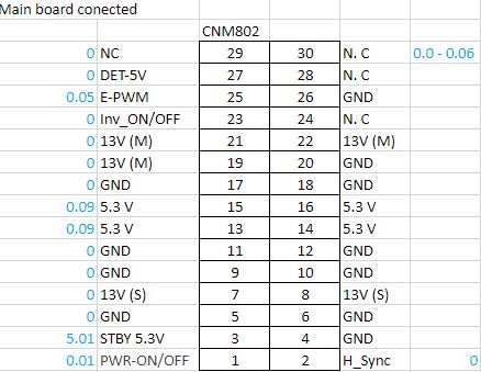

Samsung LE40B620R3W shuts down
  • Ukdigger
    • May 2020
    • 121
    • England
    Samsung LE40B620R3W shuts down
    Samsung LE40B620R3WQXU
    I'm thinking that the main board may be faulty, I would appreciate any help to test and fix it.
    The TV works for about 2 minutes and then shuts down with no standby light. When the main board is disconnected the back lights come on and the TV stays on until powered off.
    Voltages on power board
    Main board disconnected
    4.88
    4.88
    2.74
    12.07
    12.07
    0
    5.01
    5.01
    0
    0
    12.07
    0
    5.01
    0.76
    Main board connected
    4.88
    4.88
    2.74
    12.23
    12.23
    0
    4.95
    4.95
    0
    0
    12.23
    0
    4.95
    0.75
  • nomoresonys
    • Jan 2013
    • 12129
    • U.S.
    Re: Samsung LE40B620R3W shuts down
    Is there a legend/label on the board describing the pins and the number of the pin?, you put the voltage but we have no way of knowing what it is, so you want to do like, pin 1: ps on 3.3 volts, pin 2 etc. etc.
    • dick_barton
      • Aug 2015
      • 6642
      • Wales
      Re: Samsung LE40B620R3W shuts down
      Post pictures of your power supply board and of the legend as nomoresonys suggests, What is the part number of the power supply BN44-xxxxxx?
      • Ukdigger
        • May 2020
        • 121
        • England
        Re: Samsung LE40B620R3W shuts down
        Voltages on power board
        Main board disconnected
        pin 29 0
        pin 27 4.88
        pin 25 4.88
        pin 23 2.74
        pin 21 12.07
        pin 19 12.07
        pin 17 0
        pin 15 5.01
        pin 13 5.01
        pin 11 0
        pin 9 0
        pin 7 12.07
        pin 5 0
        pin 3 5.01
        pin 1 0.76
        Main board connected
        pin 29 0
        pin 27 2.68
        pin 25 1.79
        pin 23 2.74
        pin 21 12.23
        pin 19 12.23
        pin 17 0
        pin 15 4.95
        pin 13 4.95
        pin 11 0
        pin 9 0
        pin 7 12.23
        pin 5 0
        pin 3 4.95
        pin 1 0.76
        • Ukdigger
          • May 2020
          • 121
          • England
          Re: Samsung LE40B620R3W shuts down
          • Ukdigger
            • May 2020
            • 121
            • England
            Re: Samsung LE40B620R3W shuts down
            • dick_barton
              • Aug 2015
              • 6642
              • Wales
              Re: Samsung LE40B620R3W shuts down
              Your photo is difficult to read. It would make easier reading to list them similar to below. Where are all the even number listings.ie pins 2, 4, 6 ....28
              Also what is the board number.
              Last edited by dick_barton; 10-15-2020, 12:38 PM.
              • nomoresonys
                • Jan 2013
                • 12129
                • U.S.
                Re: Samsung LE40B620R3W shuts down
                I think the mainboard isn't sending the proper signal/s.
                • Ukdigger
                  • May 2020
                  • 121
                  • England
                  Re: Samsung LE40B620R3W shuts down
                  https://www.badcaps.net/forum/attach...1&d=1602832478
                  Last edited by Ukdigger; 10-16-2020, 01:21 AM.
                  • Ukdigger
                    • May 2020
                    • 121
                    • England
                    Re: Samsung LE40B620R3W shuts down
                    The board number is BN44-00264A. I only tested the pins that had wires coming from them.
                    • vinceroger69
                      • Mar 2012
                      • 6714
                      • uk
                      Re: Samsung LE40B620R3W shuts down
                      Originally posted by Ukdigger
                      The board number is BN44-00264A. I only tested the pins that had wires coming from them.
                      psu schematic
                      • nomoresonys
                        • Jan 2013
                        • 12129
                        • U.S.
                        Re: Samsung LE40B620R3W shuts down
                        Recheck pin 1, check it with everything hooked up, all boards connected, check in standby which is tv plugged into power but not turned on, which looks like you have .76 v, keeping probes in place hit power button on tv, see if that voltage changes, usually it should be around 3.3 steady v, when tv on and working properly.
                        • Ukdigger
                          • May 2020
                          • 121
                          • England
                          Re: Samsung LE40B620R3W shuts down
                          I did what you said and I get 0 volts in standby and when the power button is pressed it shoots up to 0.76 volts
                          • dick_barton
                            • Aug 2015
                            • 6642
                            • Wales
                            Re: Samsung LE40B620R3W shuts down
                            The ON/OFF is connected to the 5.3V Standby rail via RM882 so should be several volts when the mainboard is diconnected from the power supply.
                            I would measure the dc voltage on the 3 pins of QM802.
                            • Ukdigger
                              • May 2020
                              • 121
                              • England
                              Re: Samsung LE40B620R3W shuts down
                              As you look at my photo, I'm getting 0.06 volts of the left pin, 0 volts top right pin and 0.67 volts on the bottom right pin
                              • dick_barton
                                • Aug 2015
                                • 6642
                                • Wales
                                Re: Samsung LE40B620R3W shuts down
                                I think this is an always on power supply. If with the power supply disconnected from the mainboard you jumper a 1K resistor from ON/OFF to ground can you check that only the +5V stanby is running and the other supplies are off.
                                If this is the case then you probably do have a mainboard fault.
                                Last edited by dick_barton; 10-16-2020, 09:52 AM.
                                  Re: Samsung LE40B620R3W shuts down
                                  PS-ON of 0.76V is fine since the Base resistor RM864 is only 200 Ohms and RM882 pull-up is 10K.
                                  The circuit is working otherwise you will not have switched 13V right now.
                                  So the question is what are the Voltages at the connector when TV goes into shutdown after 2 minutes?
                                  • nomoresonys
                                    • Jan 2013
                                    • 12129
                                    • U.S.
                                    Re: Samsung LE40B620R3W shuts down
                                    Originally posted by budm
                                    PS-ON of 0.76V is fine since the Base resistor RM864 is only 200 Ohms and RM882 pull-up is 10K.
                                    The circuit is working otherwise you will not have switched 13V right now.
                                    So the question is what are the Voltages at the connector when TV goes into shutdown after 2 minutes?
                                    Ok then, my bad.
                                    • Ukdigger
                                      • May 2020
                                      • 121
                                      • England
                                      Re: Samsung LE40B620R3W shuts down
                                      When using 1K resistor from ON/OFF to ground all other voltages were 0 volts, only +5V standby was on. The TV has been working normally now for about 30 minutes. When it goes off again I will test all the voltages and report back.
                                      • Ukdigger
                                        • May 2020
                                        • 121
                                        • England
                                        Re: Samsung LE40B620R3W shuts down
                                        TV was working normally until this morning and then went off with no standby light. Here are the voltages.
                                        https://www.badcaps.net/forum/attach...1&d=1603099828
                                          09-07-2024, 05:50 AM
                                          09-06-2024, 11:40 PM
                                          09-06-2024, 11:40 PM
                                          09-06-2024, 08:40 PM
                                          Samsung Galaxy Book Ion NP930XCJ-K01DE Notebook Specification for Upgrade or Repair
                                          This specification for the Samsung Galaxy Book Ion NP930XCJ-K01DE Notebook can be useful for upgrading or repairing a laptop that is not working. As a community we are working through our specifications to add valuable data like the NP930XCJ-K01DE boardview and NP930XCJ-K01DE schematic. Our users have donated over 1 million documents which are being added to the site. This page will be updated soon with additional information. Alternatively you can request additional help from our users directly on the relevant badcaps forum. Please note that we offer no warranties that any specification, datasheet,...
                                          09-06-2024, 06:20 PM
