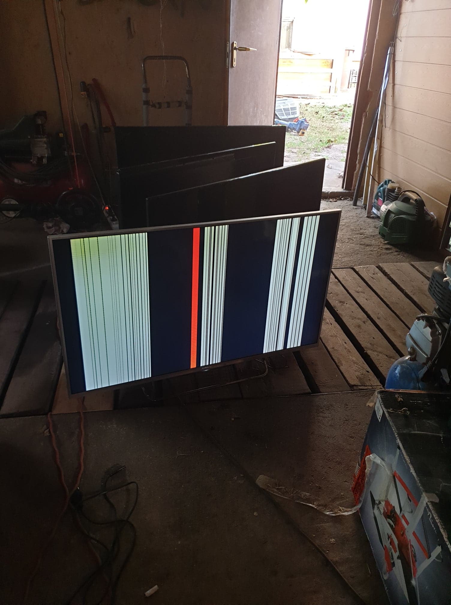

    Hello!
    I would have an opportunity to get this TV for $25.
    It turns on, has backlight and sound, but the screen is full of vertical lines. Picture attached.
    I saw videos where someone could fix this with cleaning the ribbon cables, however, it could be a lot harder to be fixed.
    Would you buy it and try to fix it if you were me?

    Re: Sony KDL42W706B vertical lines
    you have tcon board problem
    disconnect one by one fpc cable from tcon to panel glass. and post result.
