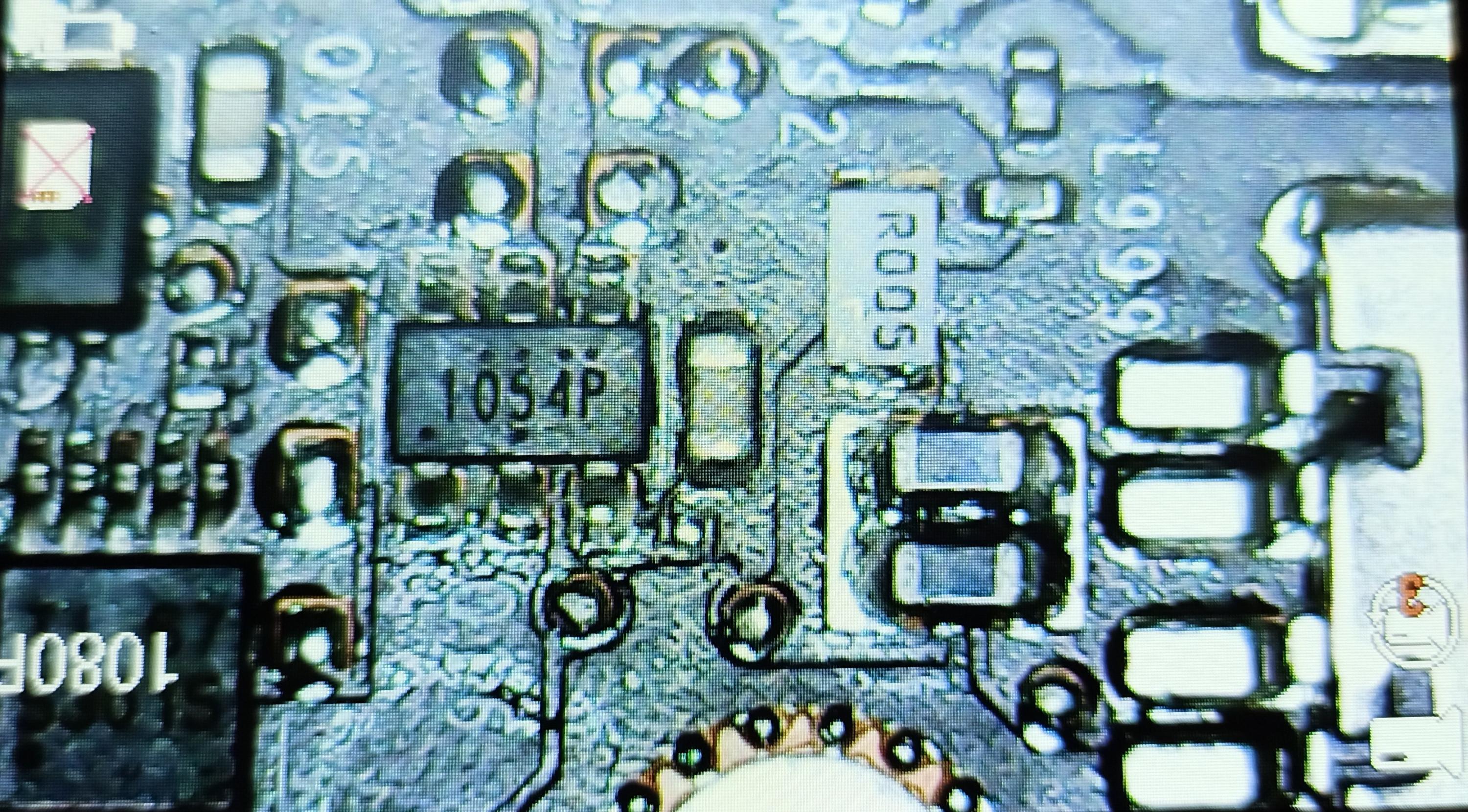

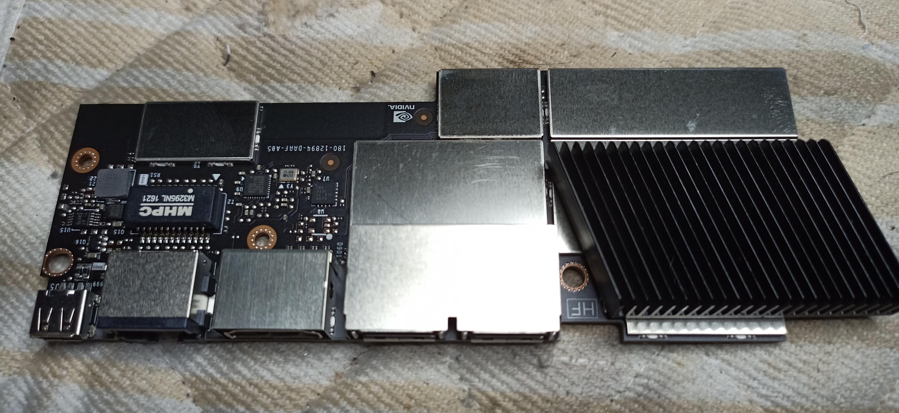

    This is the one with the 19v supply with the proprietary connector. Looks like a USB-C but it is not. There are many complaints of this adapter failing. I cracked mine open and found a vapourized trace. After repair it puts out the required 19v.
    When plugged in Q16 is heating quickly and shutting off and that cycle repeats. I can't tell if this ic is functioning as intended due to a short further down the line because I can't find information on it. It is labelled as 1054P I think.

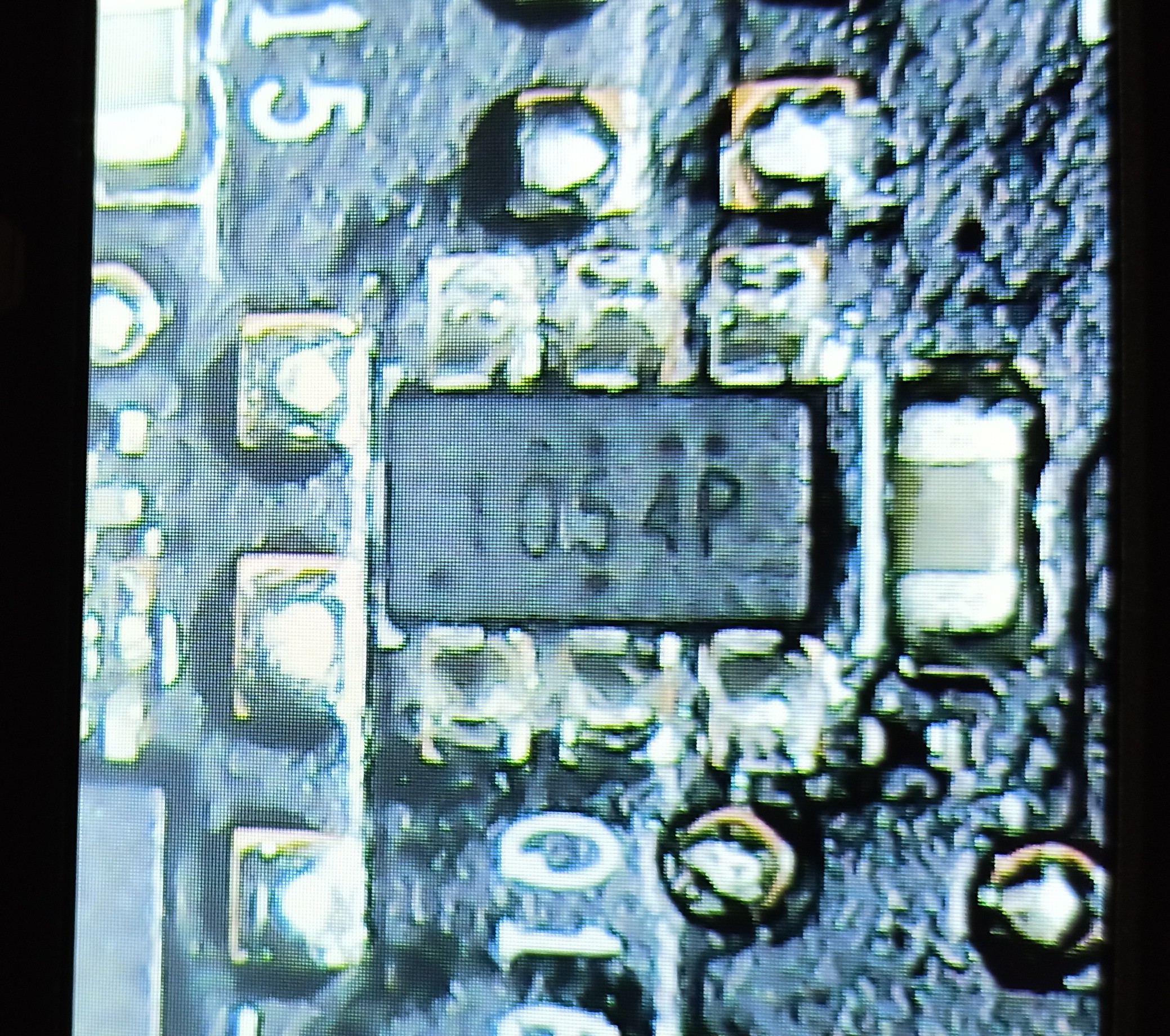

    Can anyone identify this chip ?

    Re: Nvidia Shield TV 2017 Dead
    take q16 out and fire that thing up.

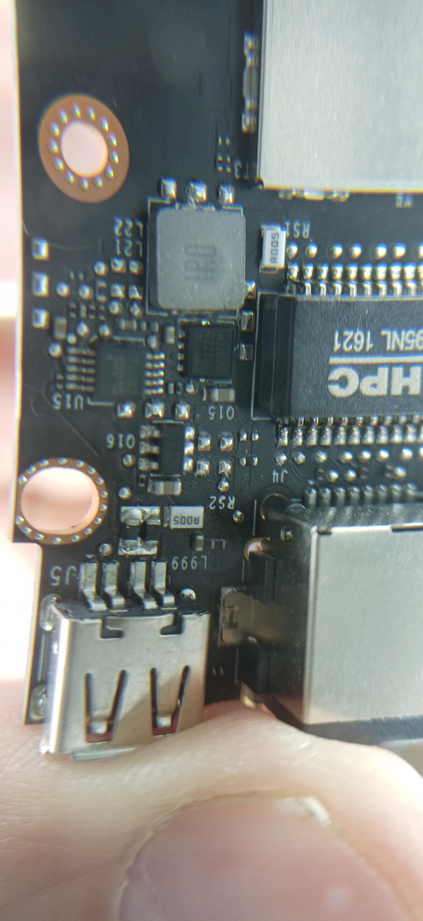

        With Q16 removed I have 19v on pad 4 and zero on the rest. A continuity test shows pads 1, 2, 5, and 6 shorted to ground.
          I would check and see if any of the pin that shows shorted to GND to see if it is connected to any MLCC hoping for just shorted MLCC.

              Would it be ok to inject some voltage at the drain of the removed mosfet or at the large filter coil in pic 3 ?
