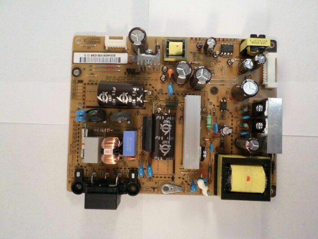

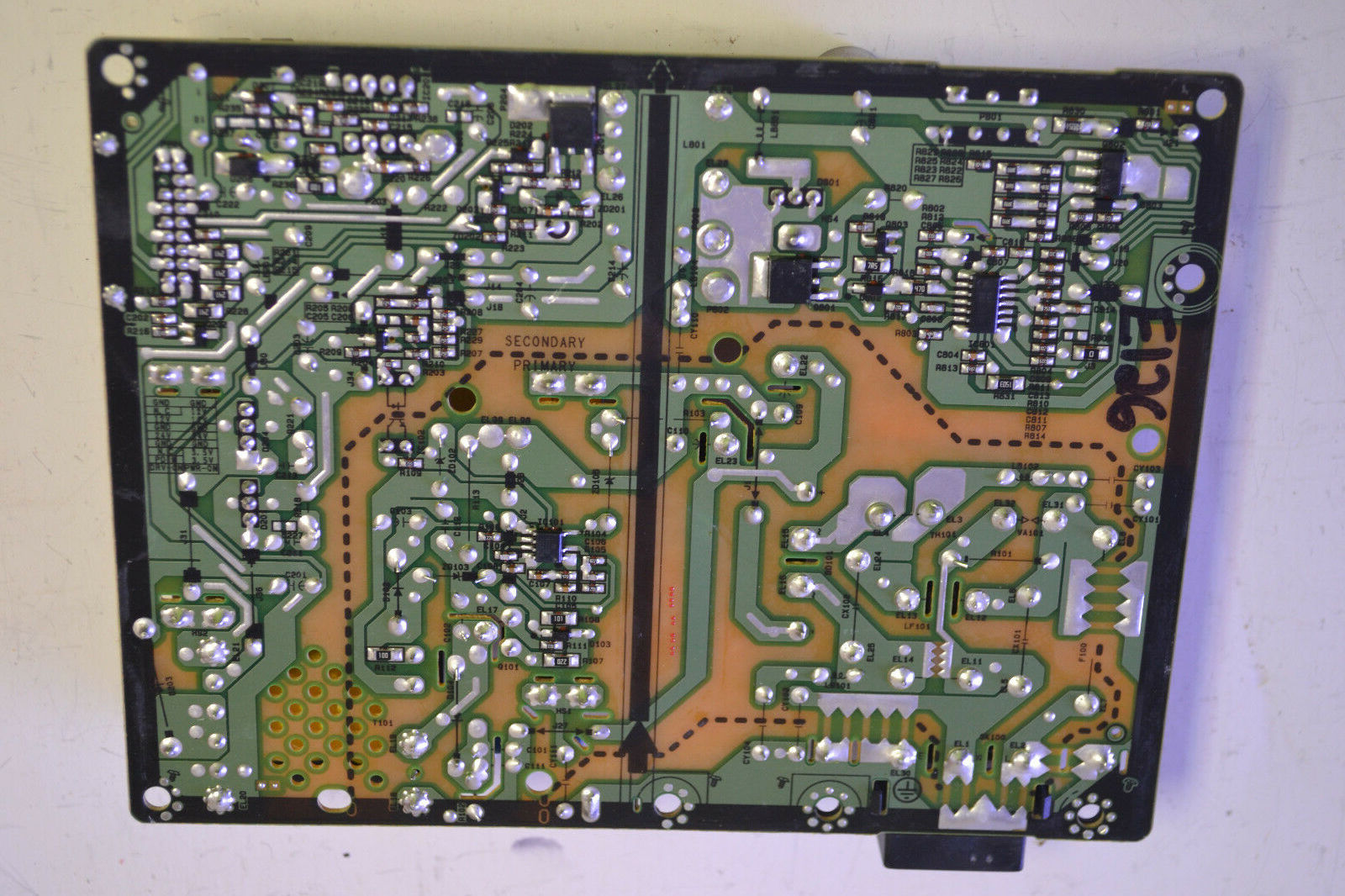

    I'm working on LG power supply where I'm not getting any voltage on the board. I'm getting fluctuated voltage from 12v-15v on C103 on primary side. Also getting voltage fluctuations on pins of IC101. I replace all ceramics on primary side however same issue. Also tested mosfet Q101 looks good. Can some one tell me whats going wrong here?

    Re: LG32LN5300 No standby voltage no power
    What's the part number of the power supply. Pictures are difficult to read off.
      It's EAY62810301 Power Supply for LG 32 inch LED tv. C103 I'm getting fluctuating voltage on C103 is 100uf 50V which I already replaced and IC is SC1S311.
        This may be the power supply schematic
        Have you disconnected the mainboard from the power supply and used a 1K resistor between standby 3.5V and PWR then checked the voltages at the output?
          I'm not getting stand by 3.5V on the secondary side. Could that be IC issue?
            It looks like SC1S311 is attempting to work but failing so trying again which is probably why the voltage is jumping around.
            Here is the data sheet for SC1S311.
            I would be checking that there is no physical damage to the IC and next check the components around it.
              Try checking the R103 and ZD105 feeding the startup voltage to the IC101. If they are leaking, IC101 could be on the way out.
                I tested both r103 and zd105 and looks good to me.
                  Check that R113 is not open, It is likely the VCC voltage you are measuring could be from the startup cell in the ic itself. Check that R112 and the transformer winding are not open.
                  It is possible that the ic is bad as in no drive.
