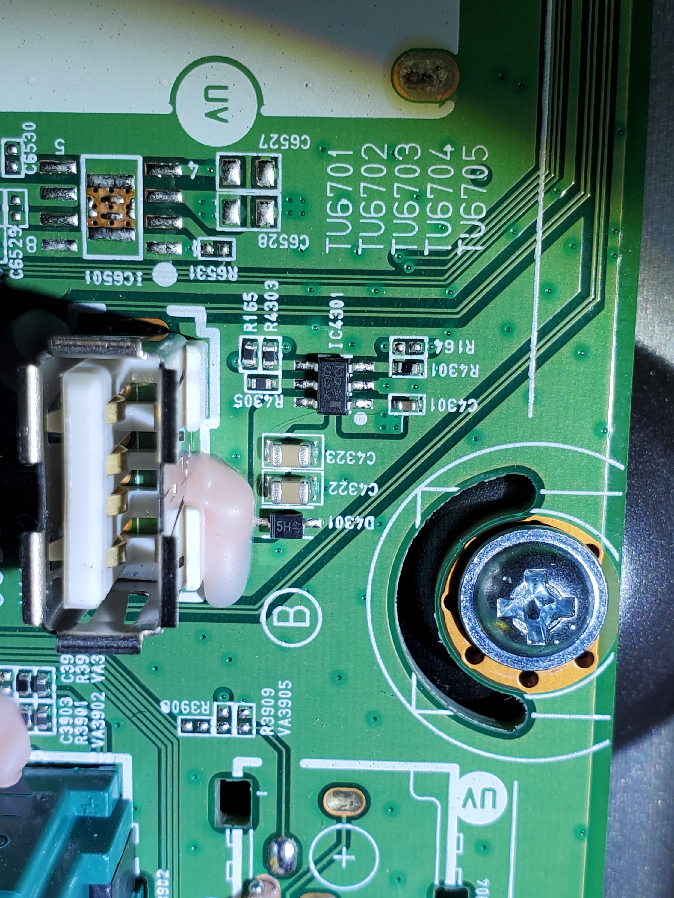

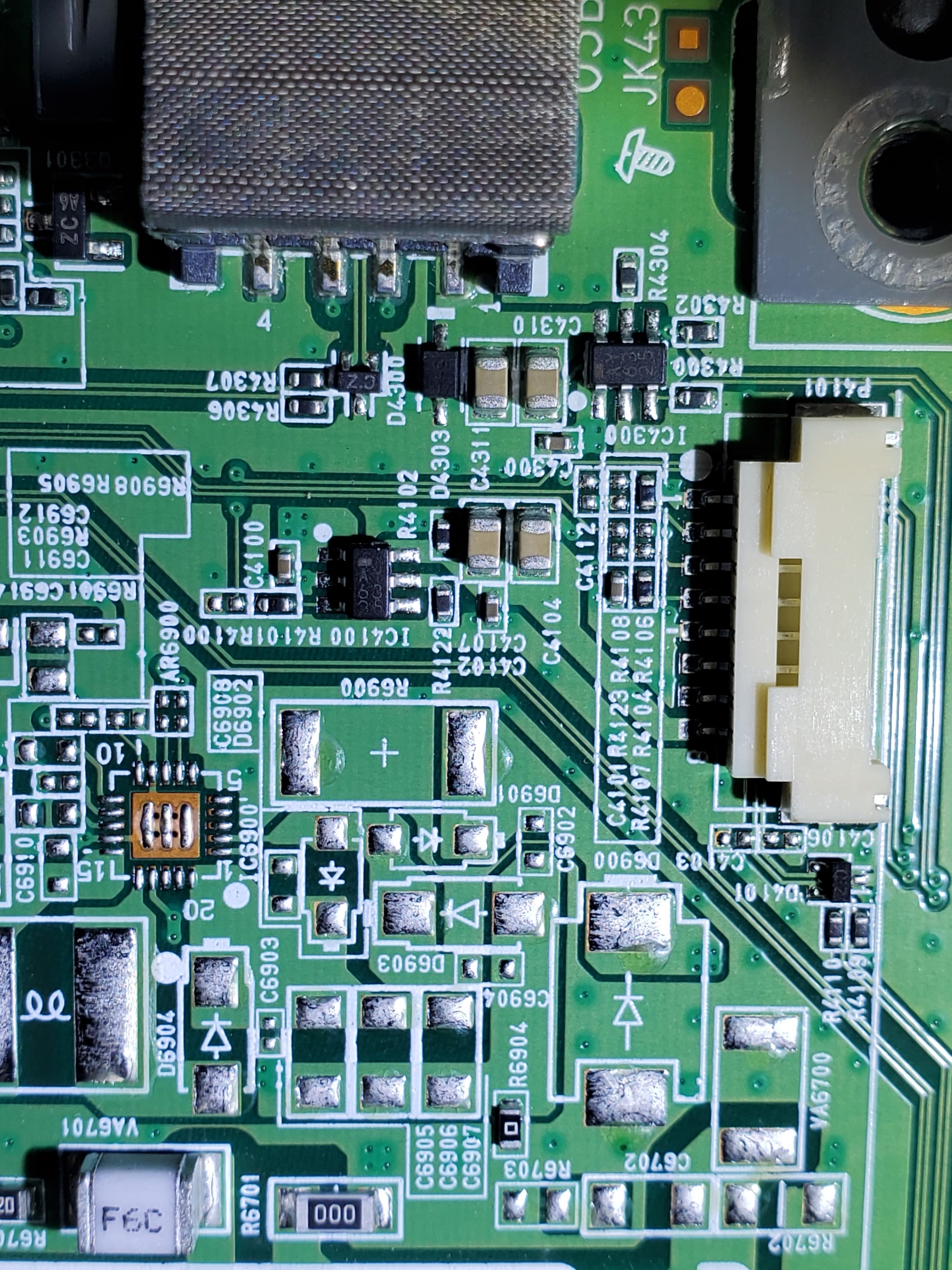

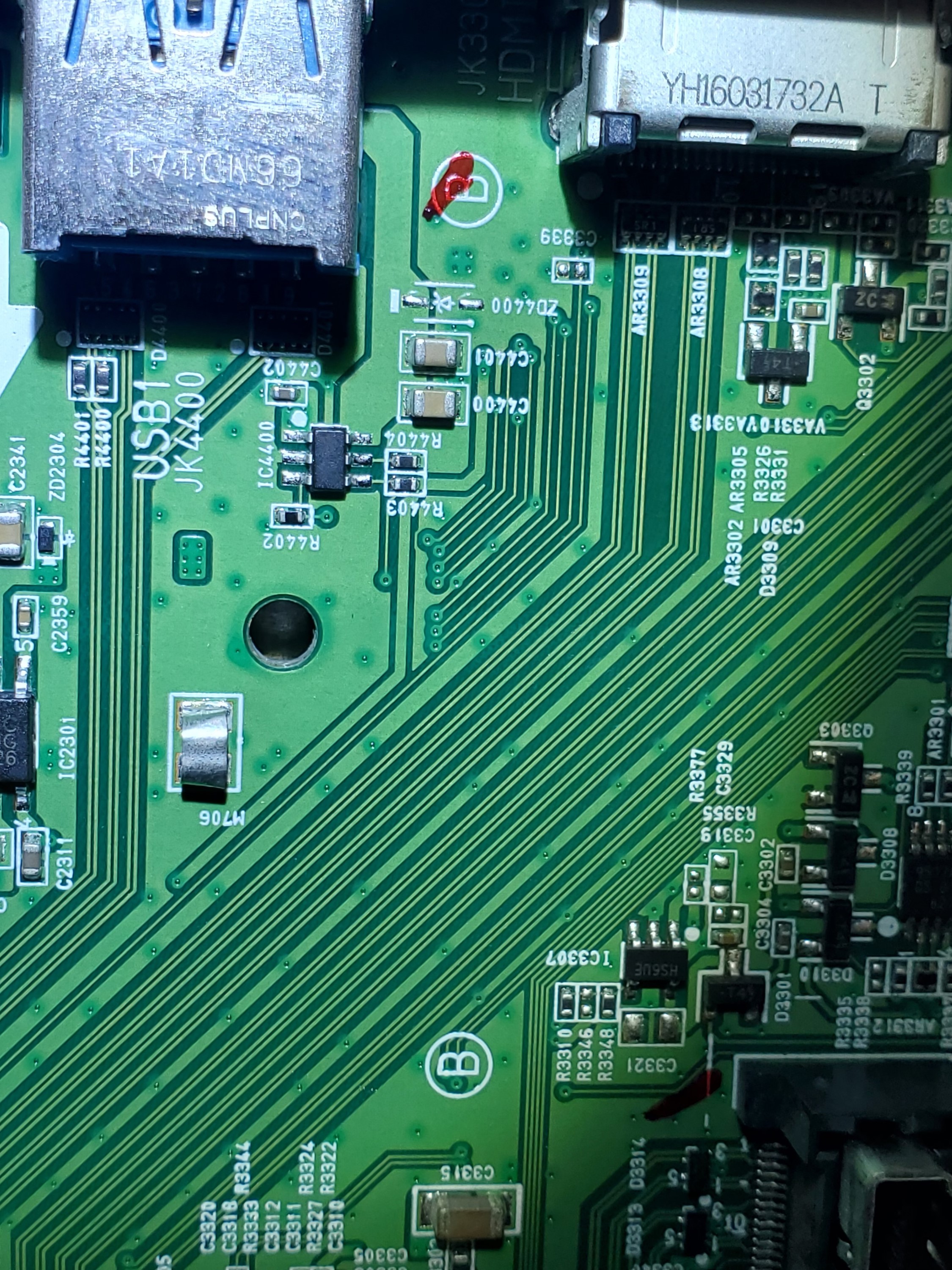

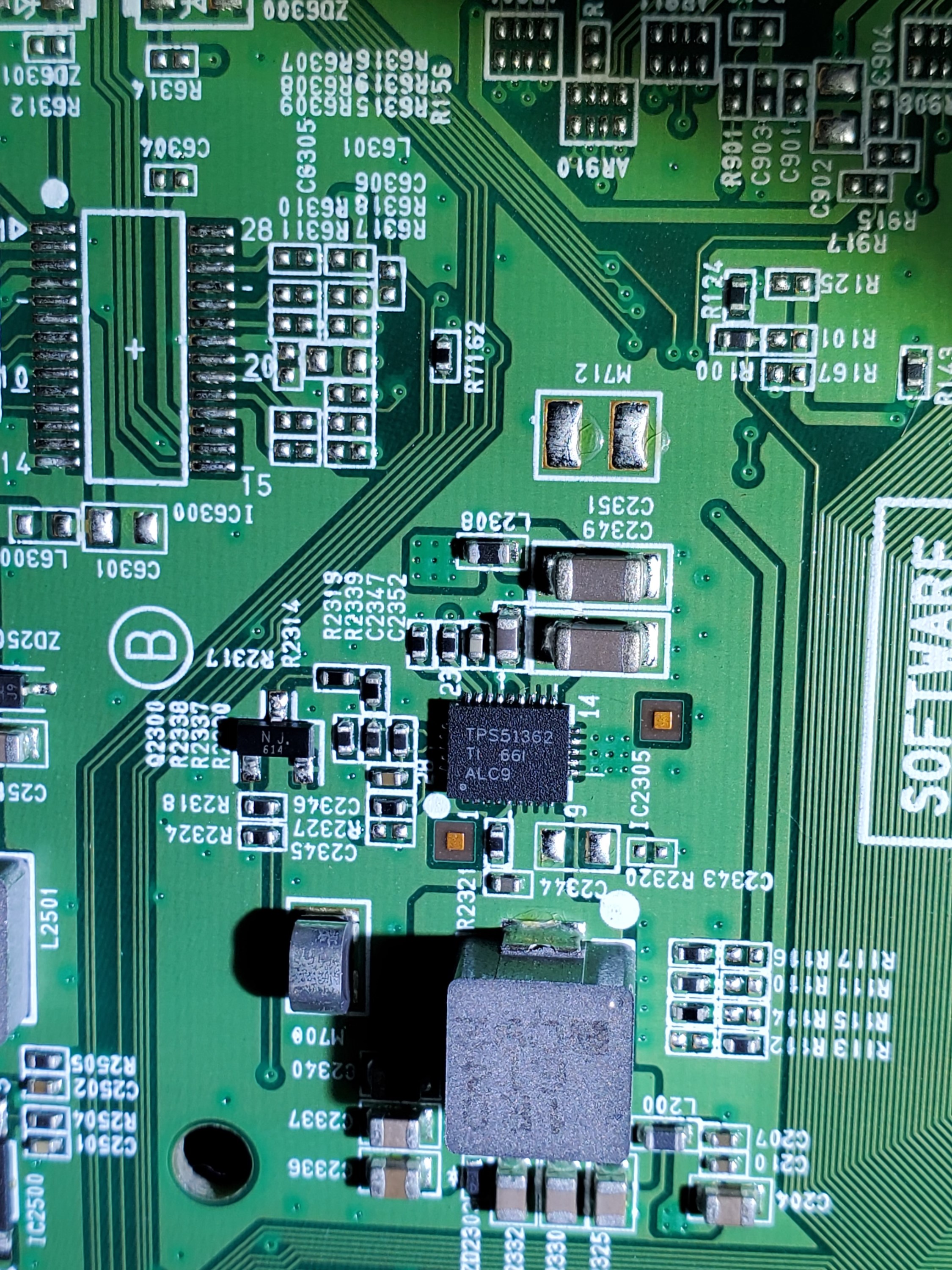

          also locate IC2305 (DC to DC )on MB and shoot clear photo of it and round parts such IC4301 IC4400

            Re: LG 55B6P OLED No image/sound
            P2500
            24.56 on Pins 3, 4, 5, 6
            New IC's attached

              so if you check IC4301 IC4400 pins could u find 5V ?
              • blkrx7
                • Oct 2019
                • 24
                IC4301
                IC4400
                1 -> 5v
                2 -> 0v
                3 -> 0v
                4 -> 3.3v
                5 -> 0v
                6 -> 0v
                IC2305
                15,16,17 -> 12v
                18 -> 0v
                These aren't easy to measure, if something looks way out, yell.
                • Diah
                  • Feb 2013
                  • 6614
                  so 2305 working..

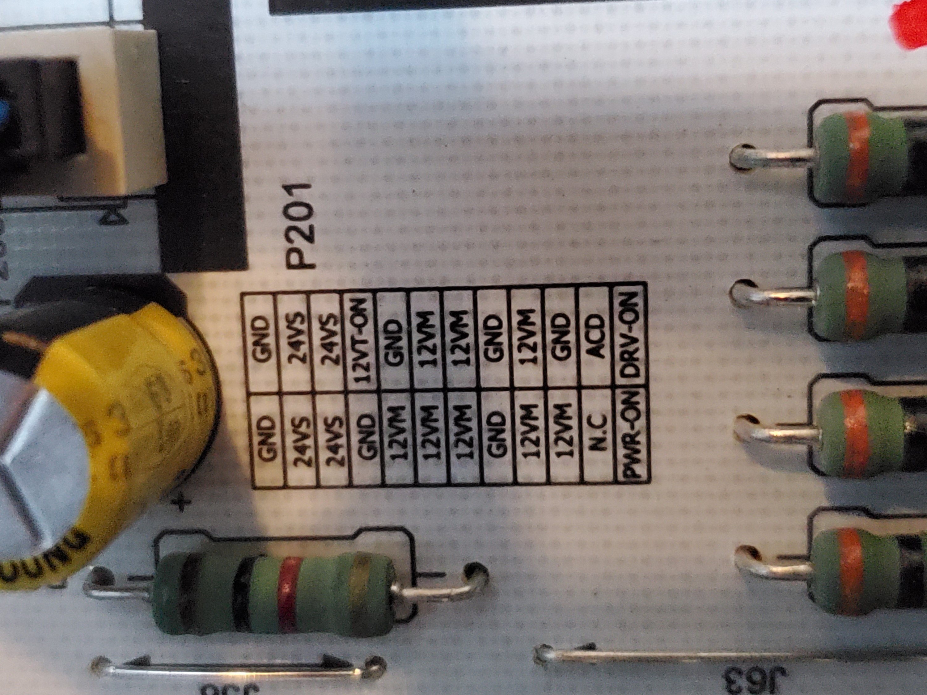

                              Yep, I can bridge the P201 pins 24 (drv_on) & 17 (stby) and confirmed the power supply outputs 24v (tcon/mb unplugged from power supply).
                              That signal is not getting sent from the mainboard.
                              Would you like me to bridge it while it's connected to the mainboard/tcon?

                                can you show the pins print label of the sockets which goes from PWB to MB?
                                • blkrx7
                                  • Oct 2019
                                  • 24
                                  #36
                                  See attached

                                    #37
                                    you can do it but only in this way... if pin 24 are drv_on trace the cable of it which it come from MB.. cut it in the middle then bridge pin 24 with stb put back socket 202.. and turn on and put your eyes on the screen and the audio optic if its turn red
                                    BTW: of course we are talking on the bridge only at PWB side
                                    • blkrx7
                                      • Oct 2019
                                      • 24
                                      #38
                                      Unplugged
                                      I removed pin 24 completely from p202, so it would not connect to power supply.
                                      Jumped 24/17 on the power supply
                                      Plugged in
                                      Turned on
                                      I have 24v at the tcon now
                                      No optic LED or anything on the display
