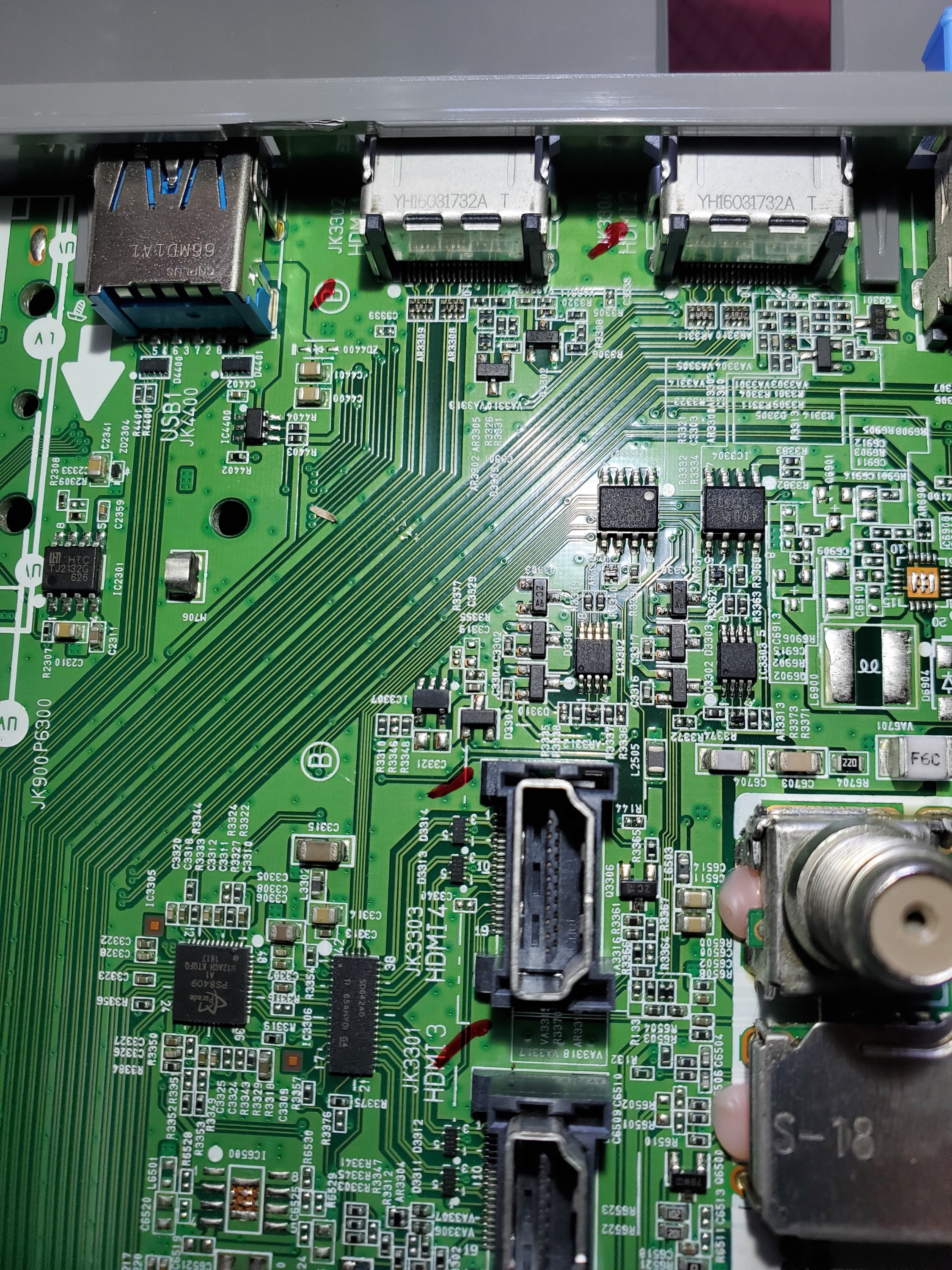

    Good evening,
    I've been chasing this for a while and wondered if anyone had run into this scenario.
    TV was plugged into a cable-tv box which was damaged by a surge.
    TV turns on/off via remote, (tv indicator flashes three times then goes out, as normal) but no image/sound. Pressing power again on the remote shuts it off and the indicator comes back on again.
    Power supply (when jumpered) outputs 12v/24v where applicable.
    When the TV powers up, I get 12v up to the mainboard, 12v to the tcon, but the 24v rail never fires up (shows 1v). Both the mainboard and tcon get warm (35c), but no voltage on the USB ports, no activity on the network card.
    I built the IR blaster via headphone jack, have sent POWER_ONLY wav file, and the TV responds by turning on. No other change.
    Have depressed both reset switches on the mainboard (one will shut the tv off if it was on). No other change.
    I've replaced the power supply, my next guess is mainboard, except I keep wondering if this is how the set would act with a bad Tcon?
    Any thoughts?

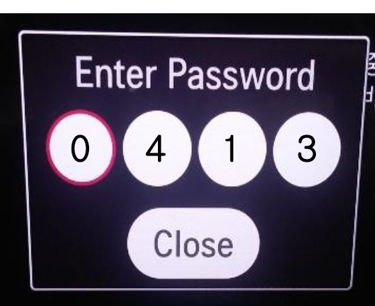

      Thanks so much Diah,
      Following this:
      Turn set on with RC
      Send in_stop.wav
      Type 0413 on RC
      The TV does not go back into standby
      After the above procedure the TV still responds to the power button on the remote and will shut off normally (ie, hasn't locked up that I can tell).
      I've tried a number of other variations, but so far no luck. Just to confirm, I don't need to hit 'enter' after 0413? And the set should be turned on normally, not just power_only correct?

        it seem the wave didnt play correctly.. however i upload over this forum many time apk to run on any android mobile with IR sender.. its more easy and sure too the command sent out.. any way.. if the wave played will do the job too.
        the TV should be ON. you can confirm it from the Optic Audio socket.. the RED LED inside will be on.
        after send the wave file give time 4 second then put the 0413... you dont need to press any other key,, as son you put the last key (3 ) the screen will show resetting and its go to stand by ( the indicator at the front will lid on ) so the look of the inter password in case the IN_STOP command sent and received correctly

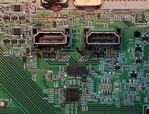

                its time to trouble shooting hardware issue on Main boards.. lets start with clear photo on the MB.. and tel chassis No. to trace the missing volts.. hope i own the service manual of yours chassis.
                  Thanks so much, please see link:
                  https://1drv.ms/u/s!AkYvRKy_t0NMiYgY...dOwRQ?e=ReW7Un
                  Board: EBT64292507
                  Chassis: LJ6 or E#64B (Written in two places)
                  Some service manuals included with photos in the link. Let me know if you'd like closeups of any one area.
                  I have a multimeter, small oscilloscope, precision iron, hot-air-rework station on hand.
                  I neglected to mention the surge came via the HDMI port, but don't recall which one. When I removed it from the wall I just reached around and pulled the HDMI without paying attention to which port it was plugged into. I don't need any inputs to the TV, so there is no problem cutting out the HDMI input side.

                    please don't use external link to upload photos.. lets make it easy.. to use the advance option and upload over here in this threat high resolution focused photo on this parts of MB HDMI3 / 4.
                    as tv on (no led indicator at the front panel ) listed please all voltage you have with pin No on the socket at main boards side

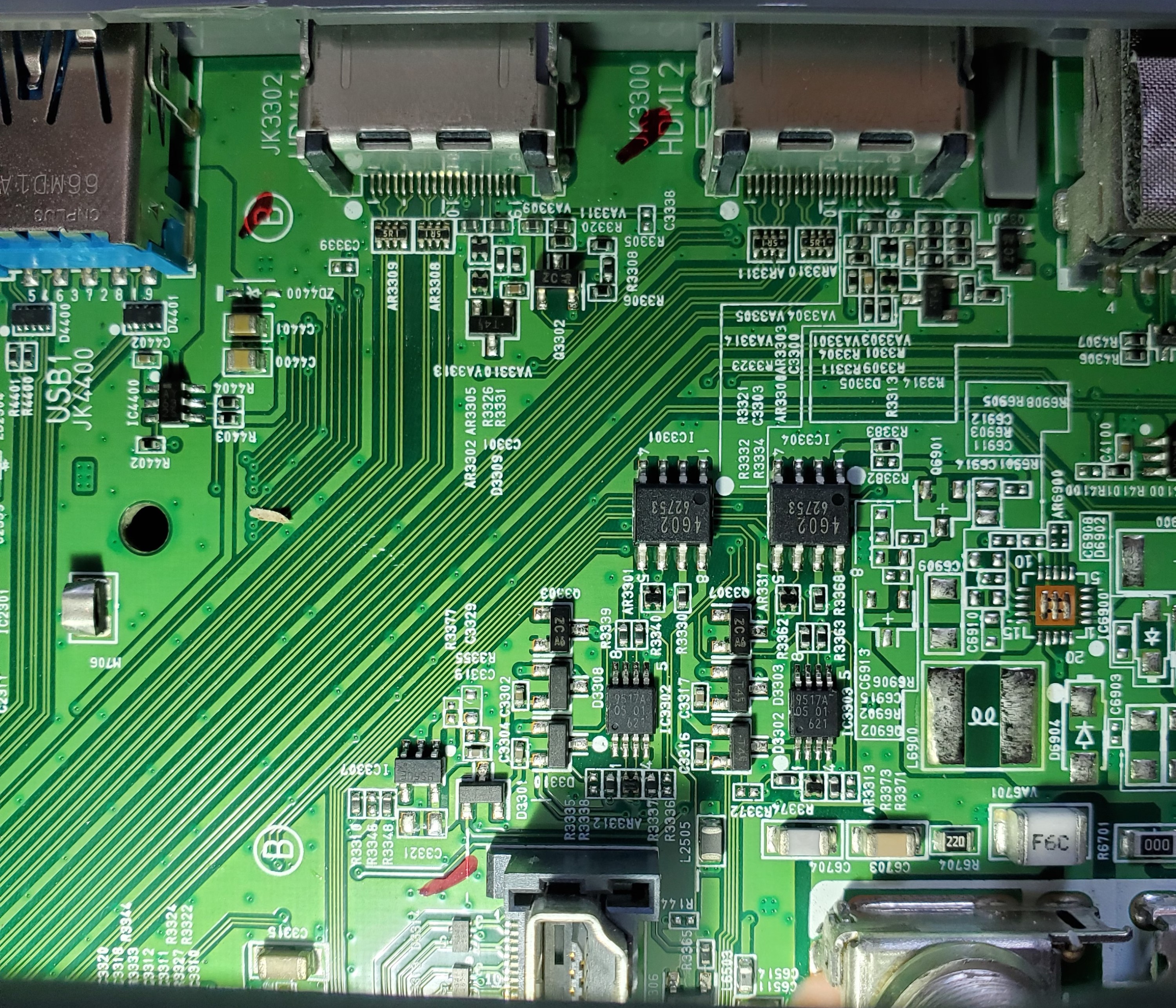

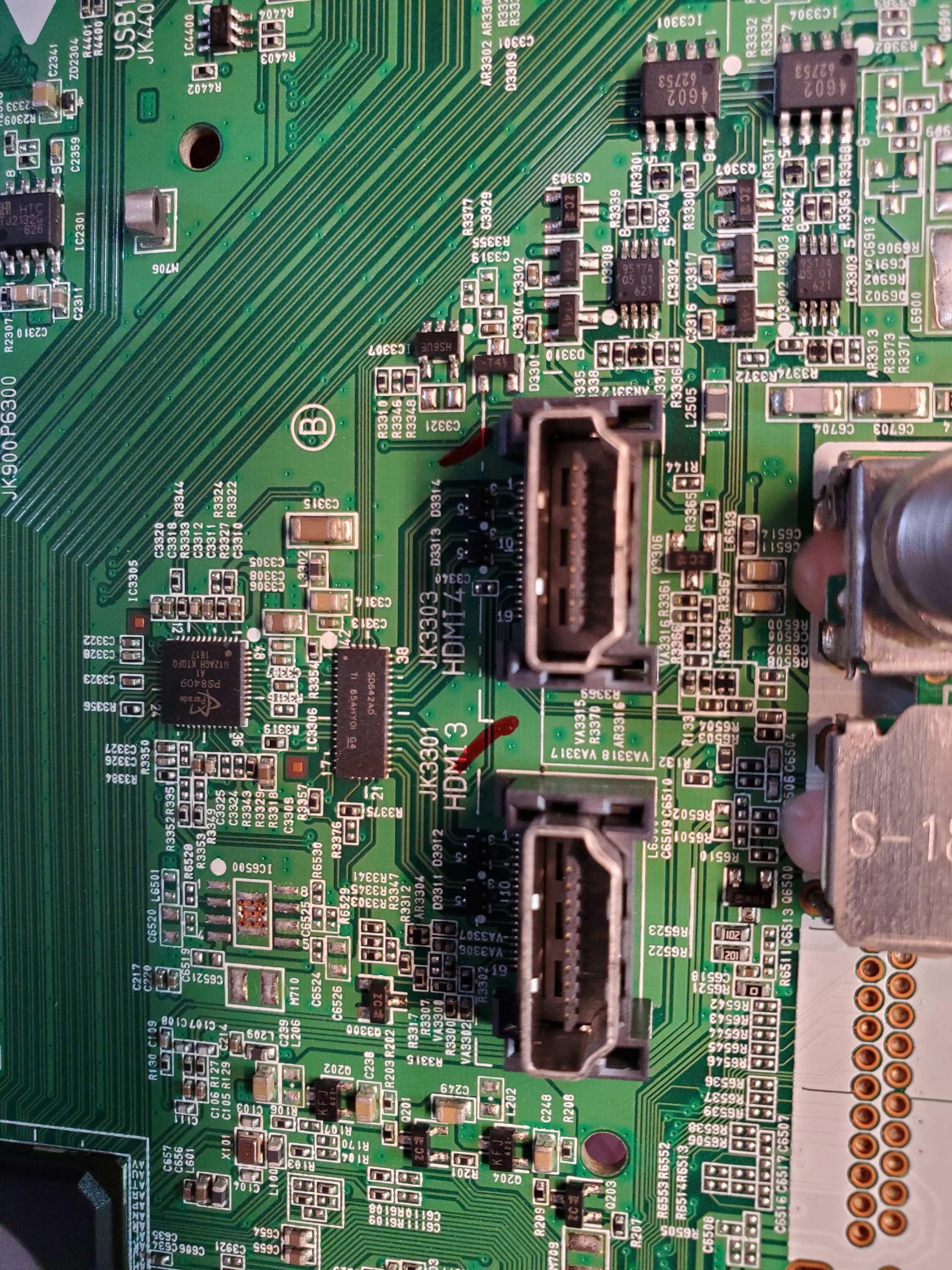

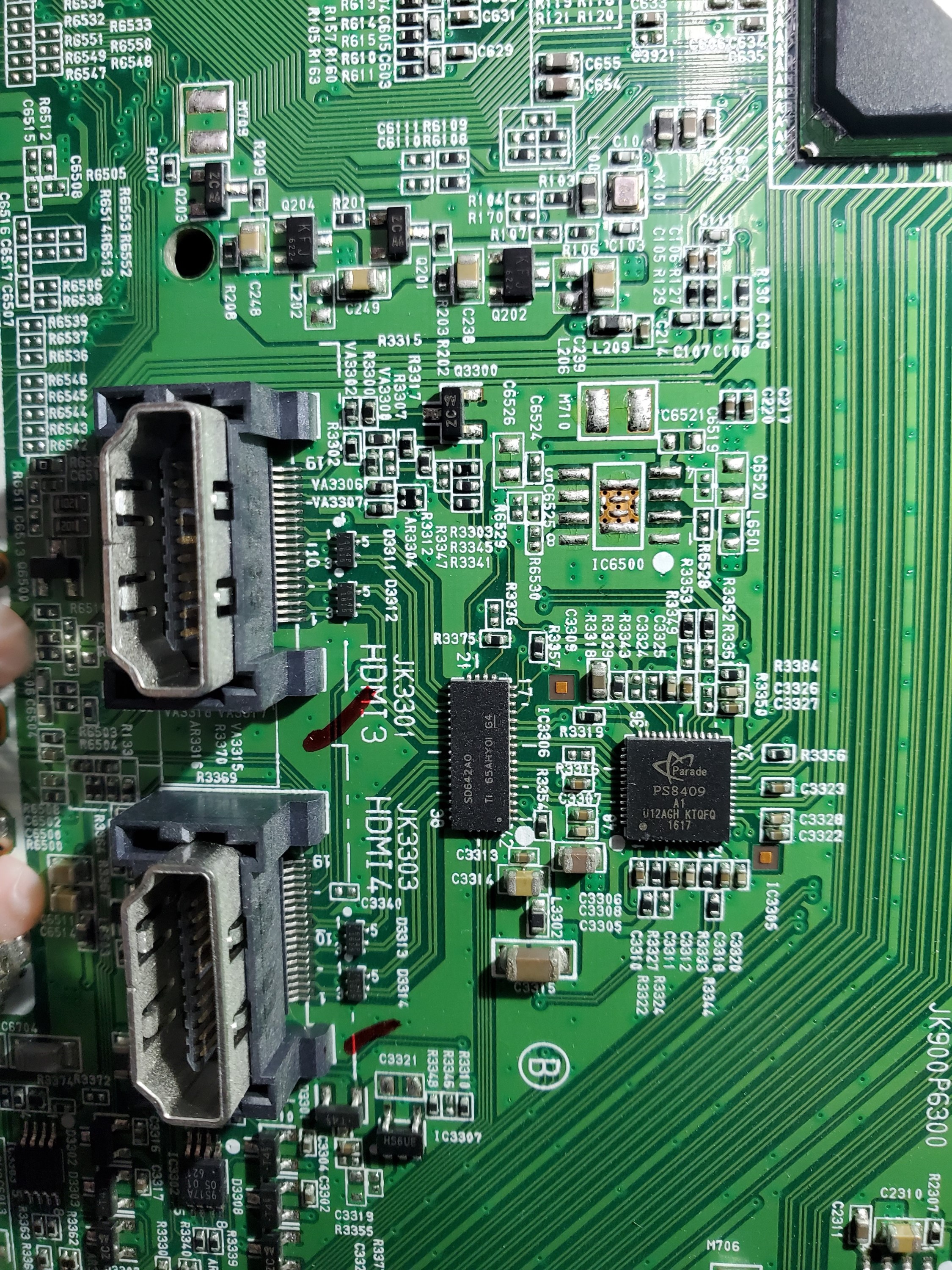

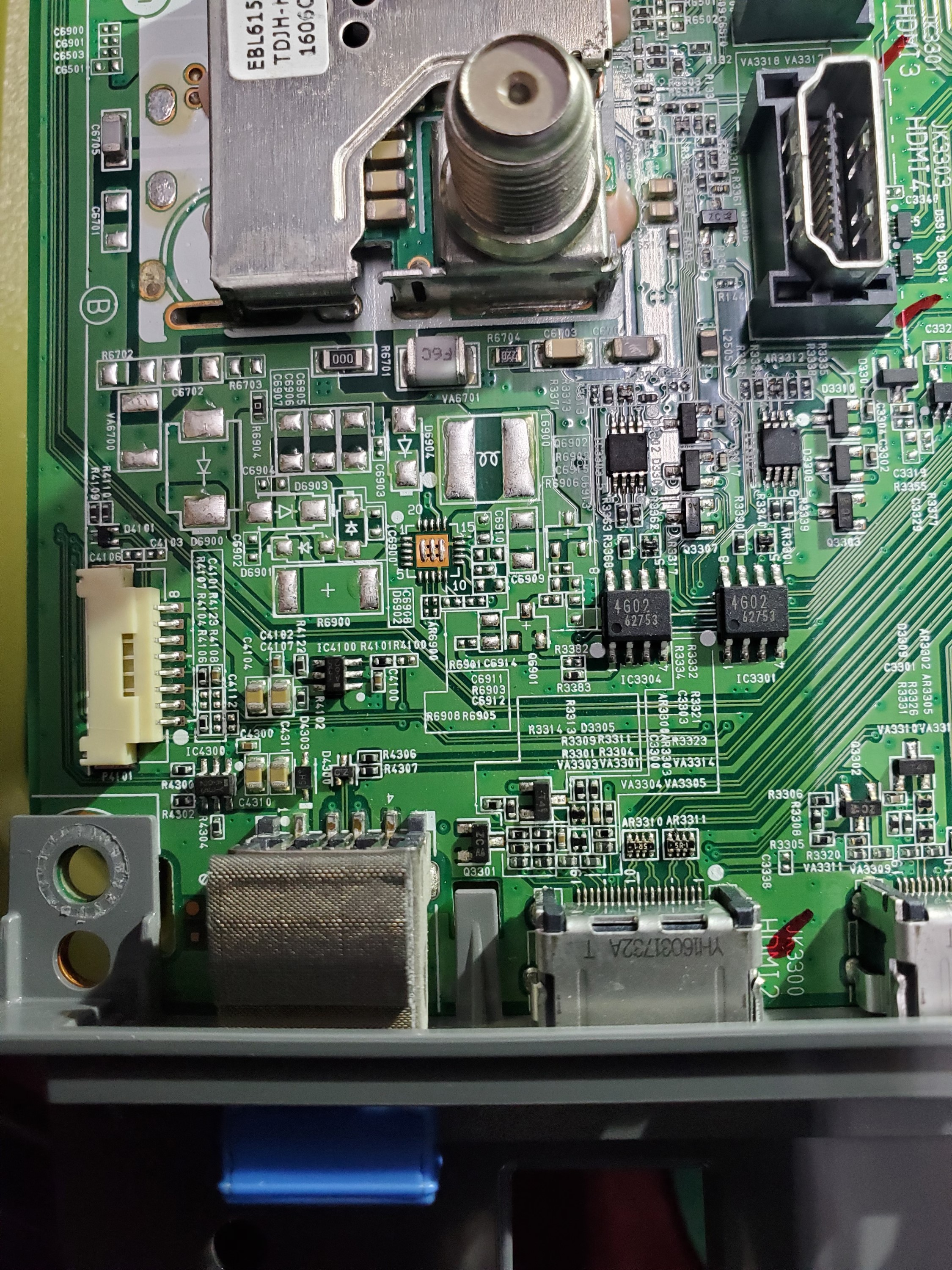

                      Absolutely happy to.
                      Two angles of the HDMI 3/4 area attached. A couple angles of 1/2 as well.
                      Original files are stored in the link if you need higher resolution.
                      Working on getting voltages off of the HDMI sockets now, will be in touch shortly.

                        HDMI 4 and 3 have the same pattern in voltages:
                        1 0
                        2 0
                        3 0
                        4 0
                        5 0
                        6 0
                        7 0
                        8 0
                        9 0
                        10 0
                        11 0
                        12 0
                        13 ~3.5
                        14 0
                        15 4.5
                        16 4.5
                        17 0
                        18 0
                        19 0
                        Pins 2, 5,8,11,17 are grounded, both jacks

                          ok do you have 13V on the socket at main boards which it come from power supply?

                            I can only easily measure the top of P1000, working at getting access to the bottom.
                            Currently, I show 12v on:
                            7, 9, 11, 13, 17, 19 (17-19 should be 3.5 no?)
                            23 has 3.2v
                            And HDMI 1/2, same pattern except higher voltages on 15/16, at 4.9v

                              let us now explain the function of DDC. before you start with IRON work.
                              HDMI 3/4 receive the 5V from main processor via IC3306. and you have them.
                              HDMI 1/2 received 5V direct from main processor ( so you need to check do you have 4.5V as you did for HDMI 3/4 ... in case YES you have V on them..
                              HDMI 2 had ARC function.. if the set at safe mode mode now (blocked) you need to put the set at stand by mode.. and connect any external HDMI device with ARC function ON at the set HDMI port 2 ( marked with ARC) then turn on the external device.. check your set will turn on or not.

                                Interesting,
                                HDMI 2 - ARC nothing happens. I've tried a Nintendo Switch, and Nvidia shield, neither detect anything plugged into them (tv on, or off) and the tv doesn't respond while in standby to turning on the devices.
                                I plugged a laptop into 1/2, doesn't recognize anything plugged in.
                                I plugged a laptop into 3/4, and it recognizes an "LG RVU Display" (TV still doesn't respond, no picture/sound), the laptop attempts to mirror the desktop at 1080p (old laptop, may be as high as it goes)
                                Seems like maybe this was plugged into either HDMI 1 or 2 when it got zapped. I'm encouraged to see a response for 3/4.
