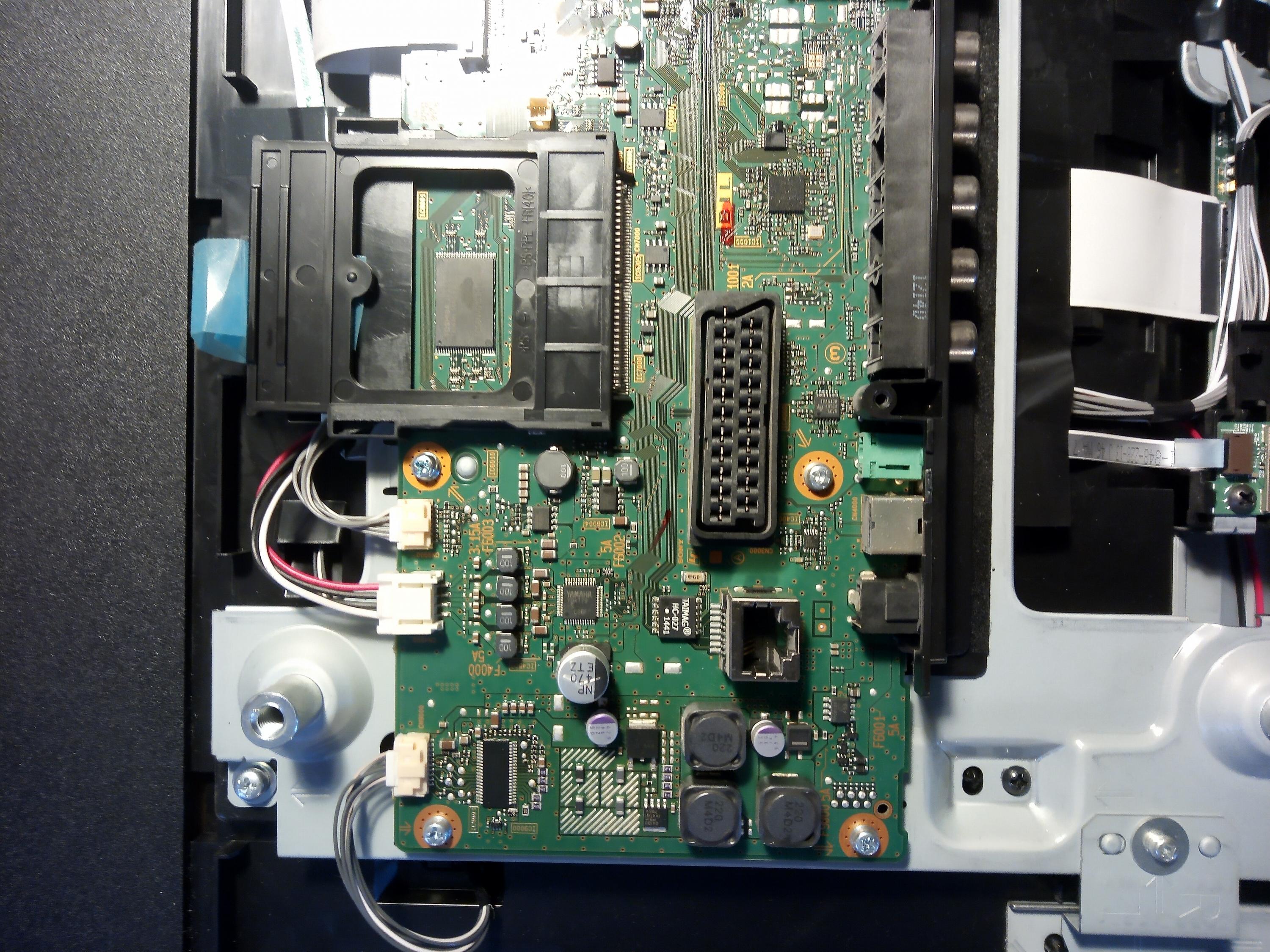

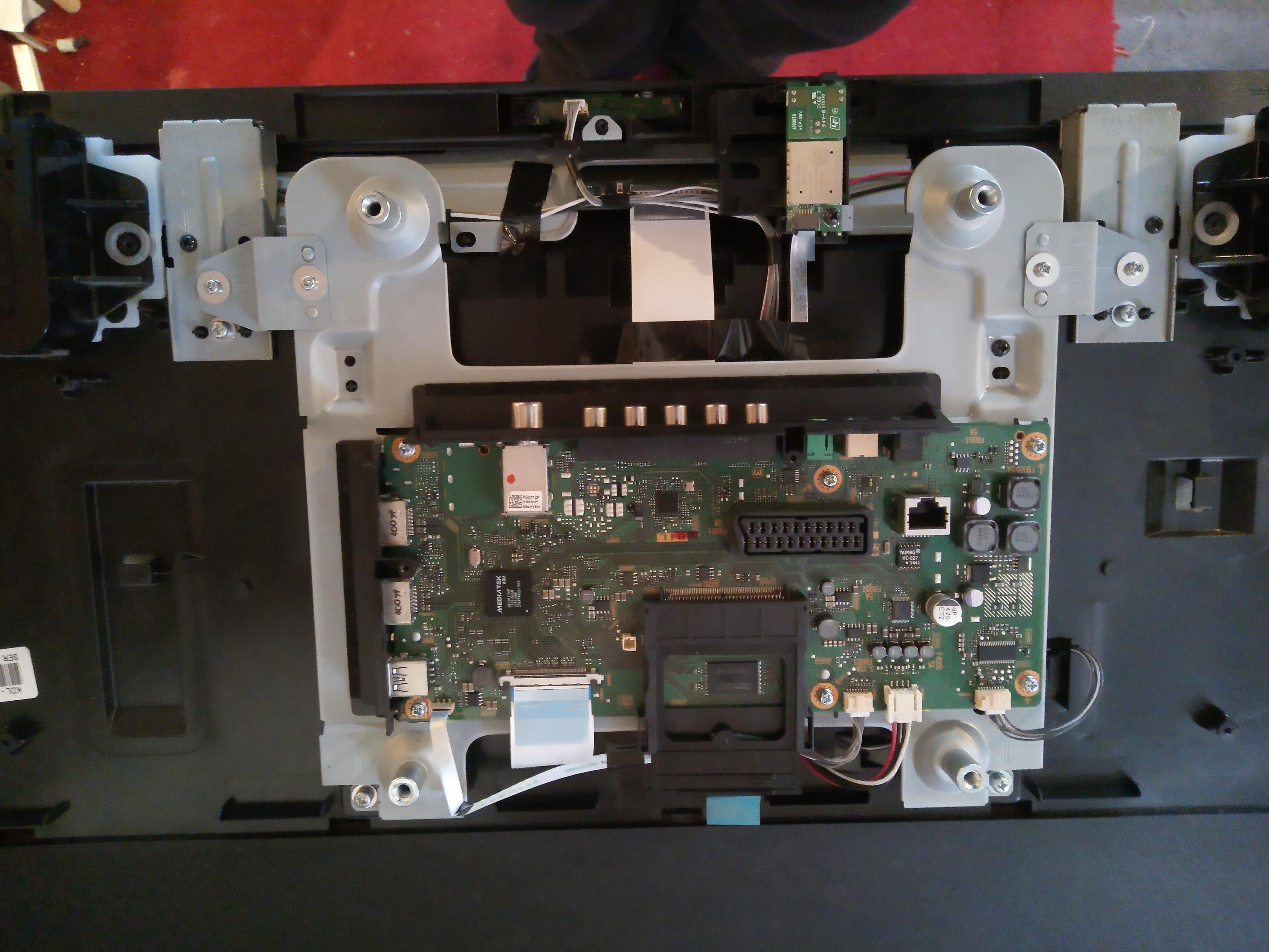

    Hi need some help with this one, tv has external psu 19.5volts .
    powers up backlight comes on ,
    front led goes green ,sony welcome logo appears
    then backlight goes off and 6 blinks .
    ive tried various reset procedures with no luck
    the internet advice is that 6 blinks is due to backlight problem
    and like most led tvs backlight should be reduced as much as possible in the settings menu.
    but cant adjust backlight until tv will stay on " catch 22"
    cant find any service procedures specific to this model for reset

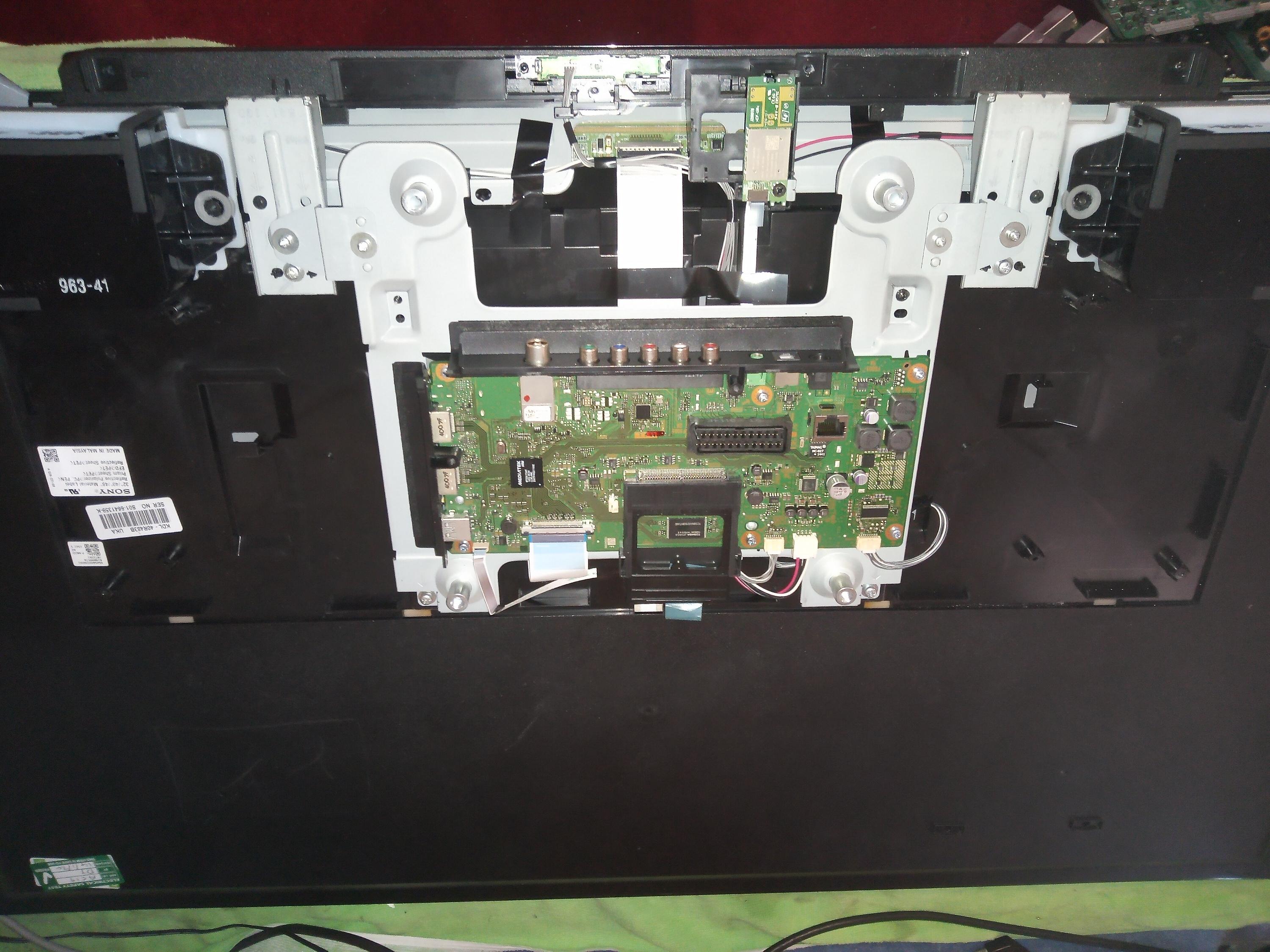

    this is the first "one board" model ive seen ,
    the main board seems to contain t con, psu regs ,and i/p interface
    ive looked at the sony website but theres nothing specific to this model

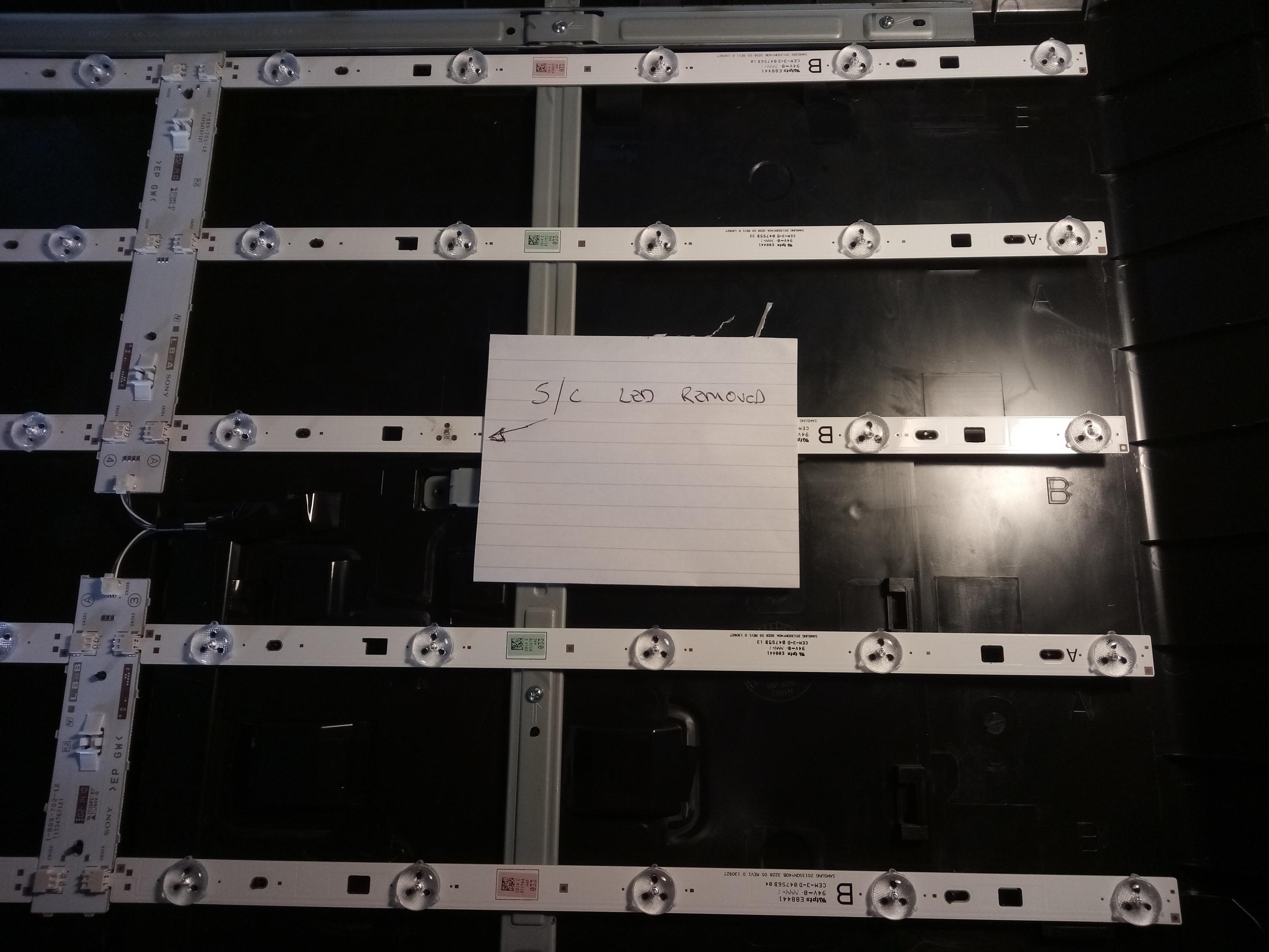

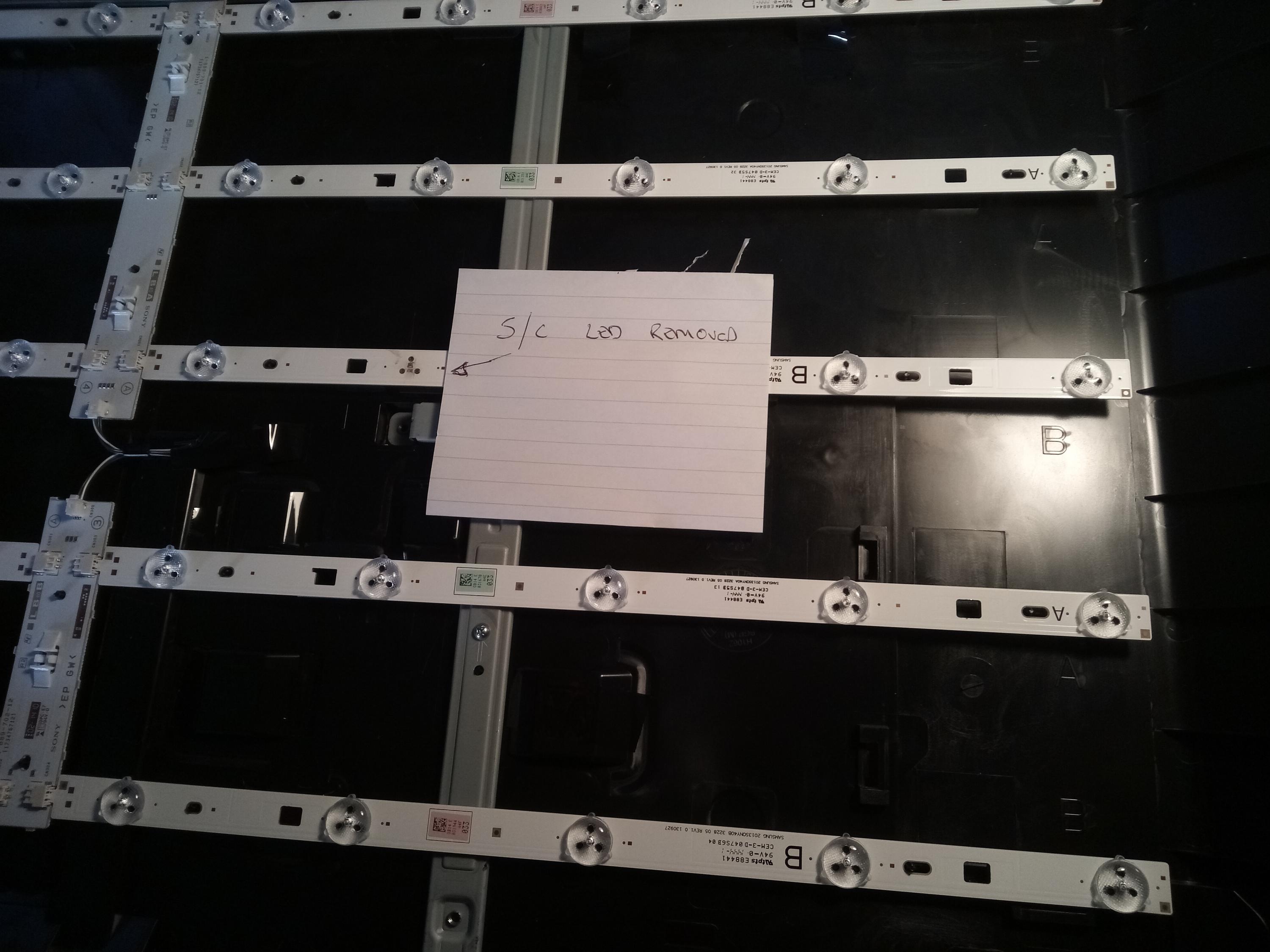

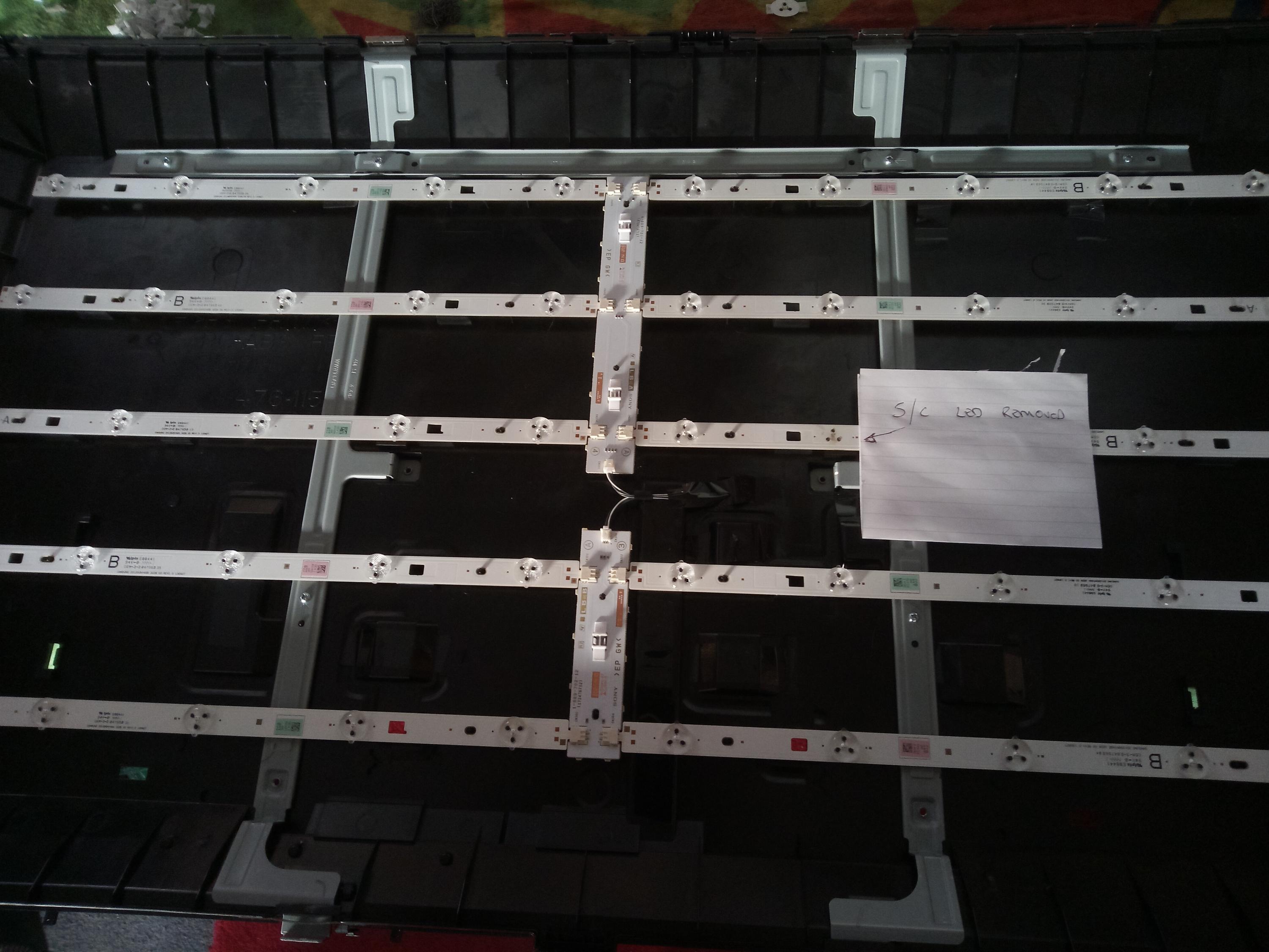

            ok stripped down to find one led s/c .
            there are two strings of 5 strips each with 5 leds.
            i assume that there is a comparator type cct that compares the current drawn between both sets of led strings, and as one string has a s/c diode the current drawn will be different .
            these leds are 3v but have built in zener for foreward current .
            i have a selection of leds but none have the built in zener
            (meter on diode test one way led lights then, reverse leads reads 950.)
            for some reason the strips all look the same
            but some are marked A and some B
            any ideas where i can buy these leds with zener ,as i can remove and solder in replacements

                all the working leds have a reverse reading on diode test mode of my meter .
                i have found a suitable led and fitted it ,
                all strips now light with external supply
                also tested on 200meg ohm range all leds read 4.9meg one way and 1.2meg the other
                all plugs and skts checked for dry joints . chain is not o/c ,
                reassembled
                and true to my luck fault still exactly the same .
                so now i suspect the cct that feeds the leds
                not producing enough volts to drive the leds
                any ideas please?

                          good news fault traced to poor connection on one of the plug in led strips,
                          sounds simple but it was a pig to trace ,
                          as when i used meter to check
                          i was putting slight pressure on the connection making it good
                          with panel removed you only have a few seconds before the set trips out ,
                          after a lot of head scratching i found i could cause a strip to flicker on and off which was enough to cause the sensitive control cct to activate
                          there was no sign of overheating ,
                          but a quick resolder of the plugs and skts ,and also cleaned and tinned the copper connections to ensure a good tight fit on each strip
