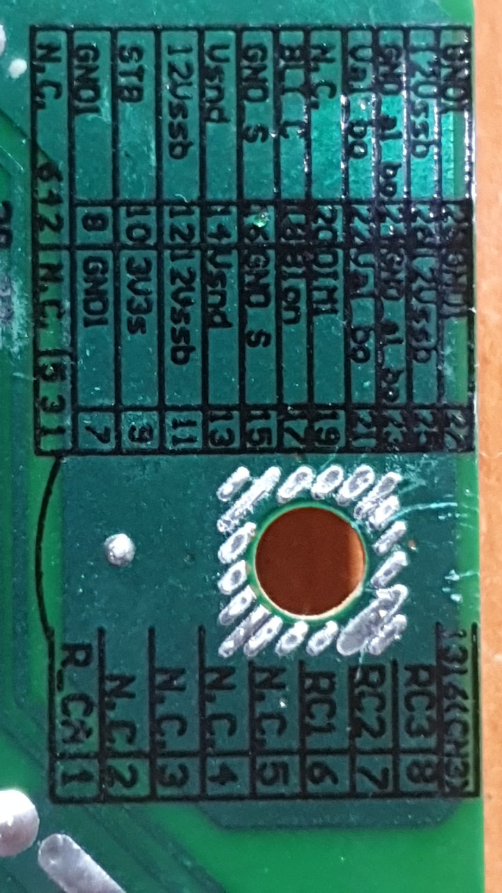

    I have this tv that is completely dead. Not even the power led.
    The PSU is this model FSP140-4FS01.
    I have measured the voltages and I have no voltage, not even on the standbye pin which is 10.
    I have removed it from the TV and plugged it in alone and there is still no voltage on that pin but I have almost 300 in the primary capacitor.
    My question is if this model of PSU when tested outside the TV, does not have the voltage on pin 10 of STB, or is it faulty?
    [IMG][/IMG]
    [IMG][/IMG]
    [IMG][/IMG]

    You should have 3V3 on that pin even tested outside of the TV,
    Which voltage to you have on the + and - of the recitifier ?

      Just to be clear, you do not have ANY Voltages on any pin of the connector on the cold side?
      STB pin is not Standby power supply output pin, it is PS-ON pin for getting the on control signal from the main board.
      Looking at the picture #3, it looks like this TV use 12V Standby Voltage, I see 12VSSB pin labels, and 3V3S for 3.3V standby. I can tell more when I see better pictures.
      Please attach good clear pictures of the board using 'Go Advanced'. Right now I cannot read any prints on the board due to pictures are not in focused.

          Now I'm not sure which pin to jumper for the PSU to give me the rest of the voltages

            Hello, I upload a better photo of the pins and the chassis number.
            What I do not know which I have to join to have all the voltages and turn on the LEDs and thus check that the PSU is fine

                1) Are you testing the Voltages with all the connectors in place.
                2) "10 STB again and now I do have 3v3" Are you saying you now have 3.3VDC on STB pin 10? What do you have on pin 9 3V3S pin, 3.3Vdc?
                3) What are the Voltages on the other pins? We need those readings!
                4) Does the Voltage on the STB (PS-ON) change state when you turn the TV on and off? what is the STB Voltage when TV is OFF and when the Power switch is turned on? I need this information to find out if STB (PS-ON) is Active HI, or Active LO control signal..
