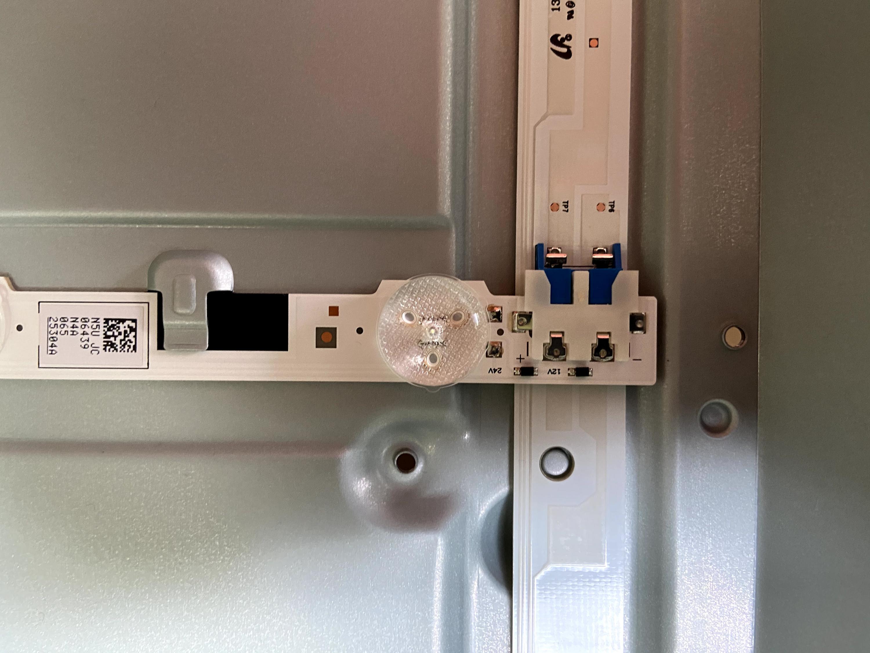

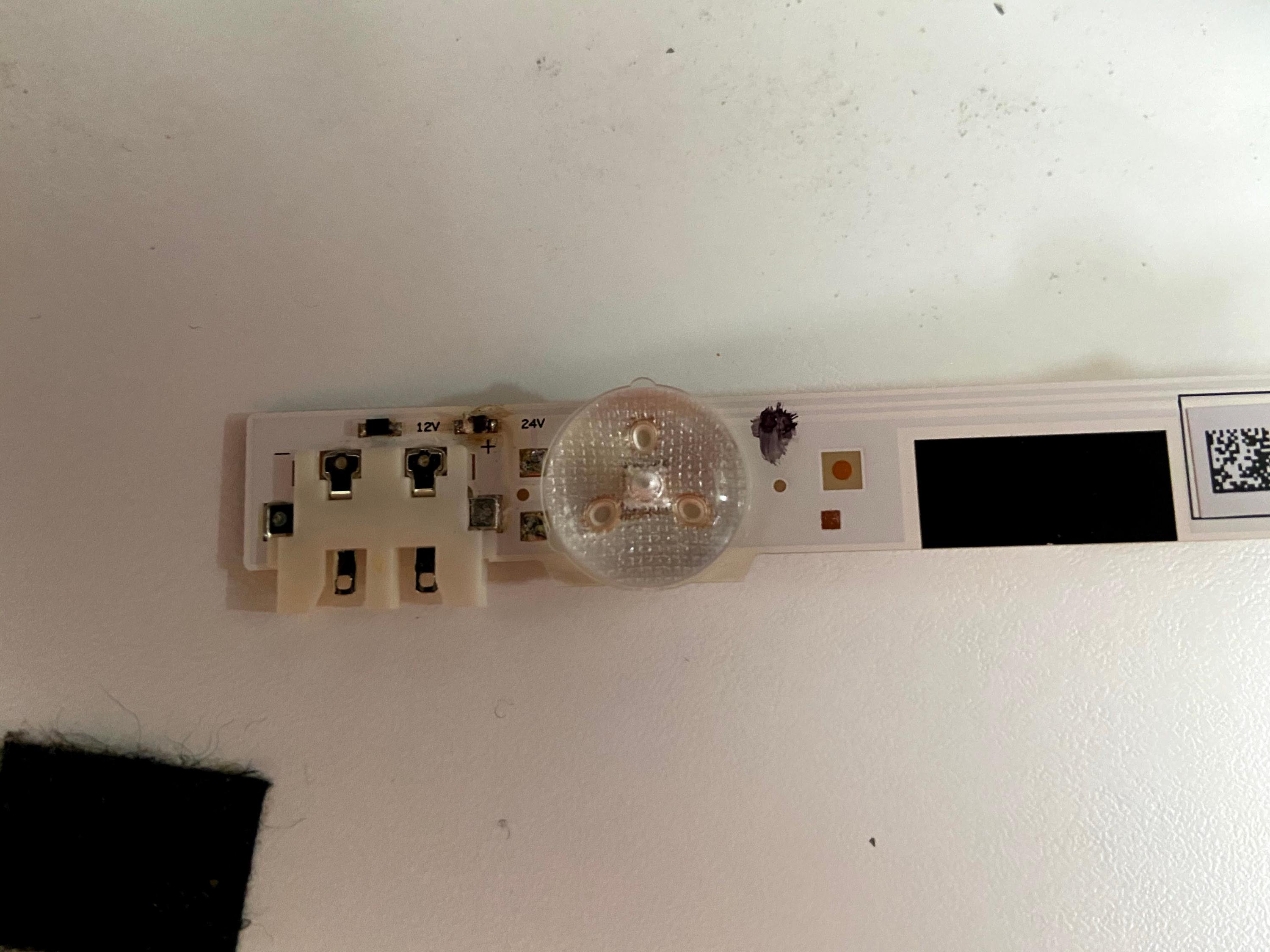

    I have a Samsung TV, Model UN40f5500afxza with burnt out LEDs & Diodes.
    Strip Model numbers
    Samsung 2013svs40f L 8 rev 1.9 130212
    Samsung 2013svs40f R 5 rev1.9 130212
    LEDs
    Samsung 3228 3v 1w 350MA, Cool White Light
    My problem is I don't know what two diodes to get for the strips, in a good video it was stated they where TVS package SOD323. The Diodes are marked 4E BA, and 2 BA. I have looked up SMD code with no luck. If anyone could please let me know what part numbers or specs for the 12v and 24v marked diodes are, it would be greatly appreciated.

    4e = cmosh-4e I also see the same backlight strips with BB diodes shown instead of BA, This might be a date code as I also see a T marked on the diode

      hey op...check this site out: https://www.shopjimmy.com/shopjimmy-...rk-station.htm
      look at the bottom for a list of samsung 3v leds. click each link (3 versions) and compare the back of an led off your strips. pick the ones that matches that pattern.

        So the Diode marked 24v is CMOSH-4E 40v 200ma Schottky SOD523? Any ides on what the 12v 2 BA marked diode?

          I think that you are right that are TVS diodes, schottky has no sense here, the writing 24v refers to the missing optional part that can be mounted in those 2 big solder places, so the options are 2, two diodes in series that protects against a peak over 24v (12+12) or one only diode at 24v, so get two smd tvs 12v .... or one big at 24v.... i'm very happy to see how it is made theese bars, now makers noticed how is important to protect leds, this was one of my big suspicions.. please can you confirm if you have bad leds? bye..

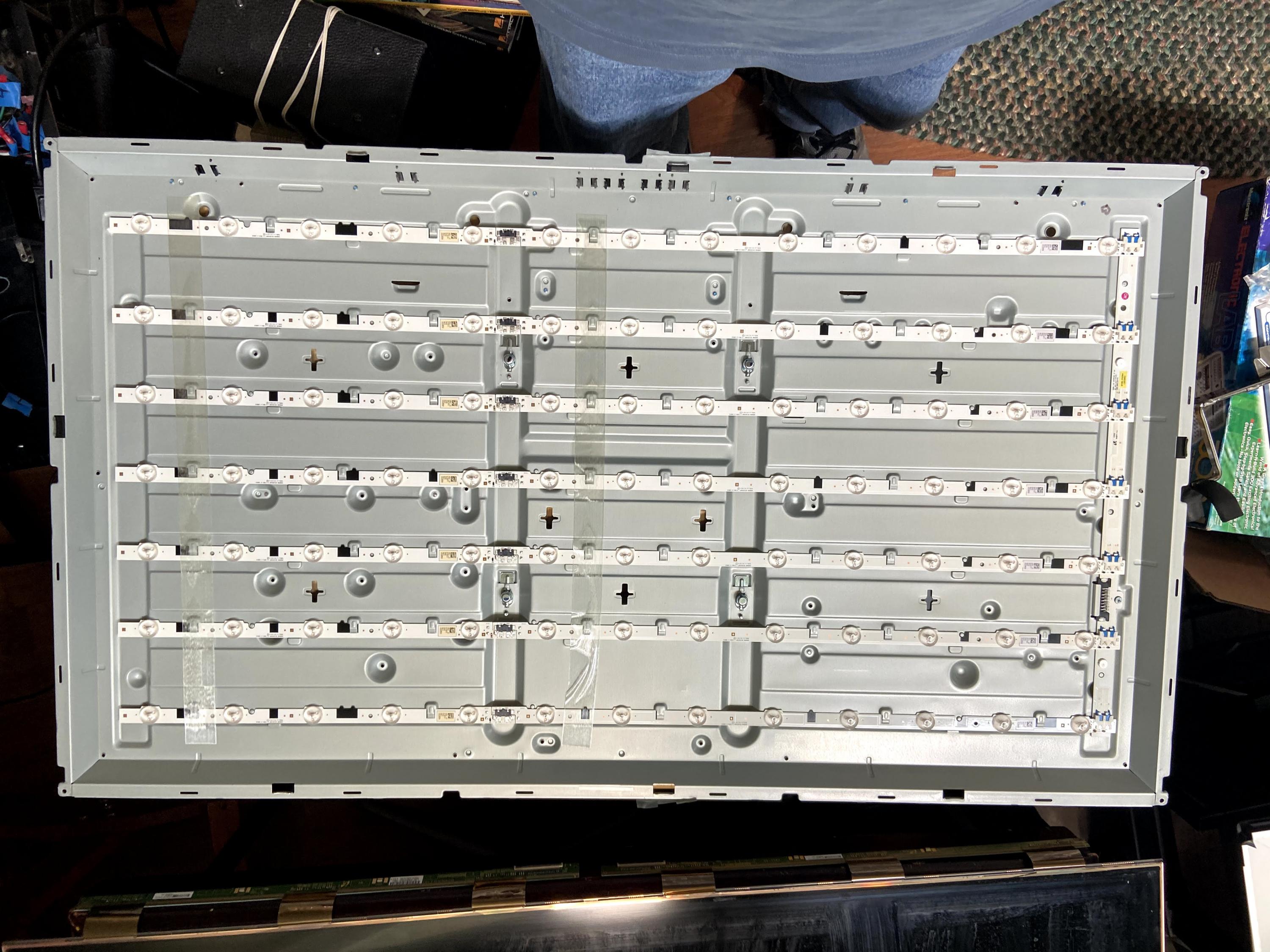

            Yes I have 3 bad LEDs burnt out. But I still am confused on what diodes to get. I have the tools to do this job, but I am not good at just picking out diodes.

              I would replace all the strips with new. The working LEDs have wear and have a high probability of failing in the future.

                2x12v diodes or 1x24v diode, you must respect polarization.
