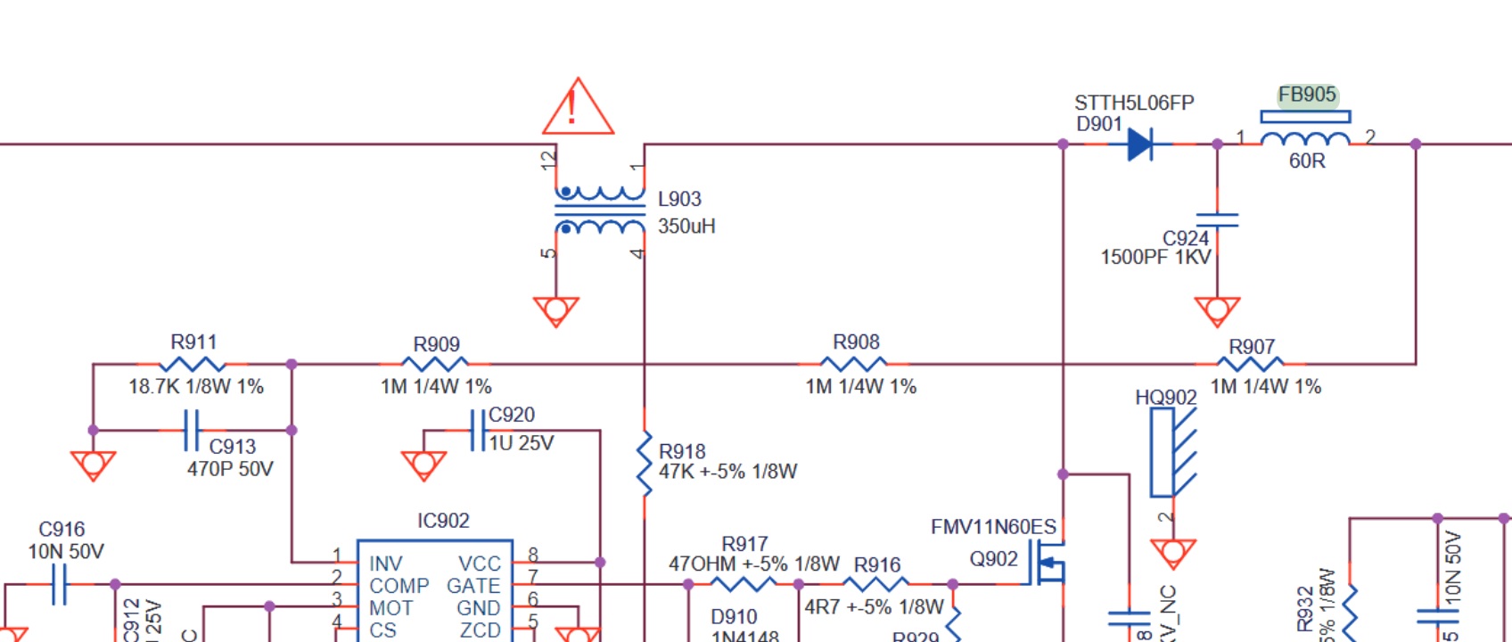

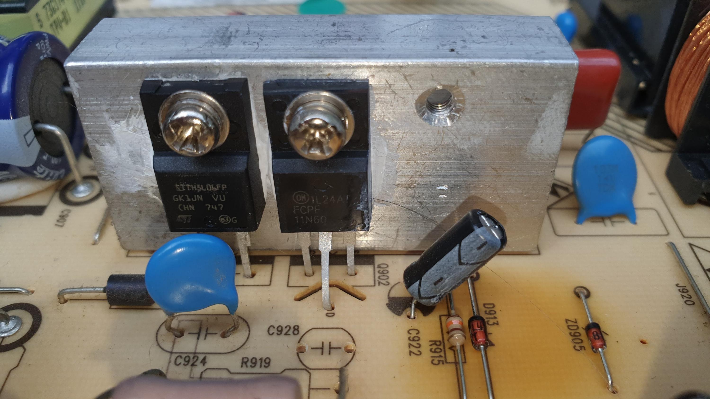

    What were the part numbers that you replaced D901 and Q902 with?

      Re: Philips 37PFL4606 No Power
      Replaced them with these on the photo
        Replaced with identical parts as shown in circuit diagram so they are not the problem.
        Are you able to check the ESR of C915, C922, C920 & C946
          Now iam beginning to doubt about those parts.. especially the 11N60..
          Because transistor placed now is this one
          https://sinuss.nl/componenten/halfge...-semiconductor
          And if have more faith in these ones.. but they are still on the way.
          https://www.ebay.com/itm/5-x-11N60ES...53.m2749.l2649
              it is not valid to check caps in-circuit due to the fact that there are other components connected to the caps.
              If you look at the schematic, you will see that C915 (1uF 25V), C920 (1uF 25V), C922 (2.2uF 25V) are connected in PARALLEL so your readings as shown below from your post do not make sense.
              C915 = 131uf ESR 0.64 Vloss 11%
              C922 = 2341nf ESR 2.1 Vloss 1,4% soldered out of pcb
              C920 = 130uf ESR 0.70 Vloss 11%
              I also wonder if PFC IC902 (FAN6961) is damaged when PFC MOSFET Q902 shorted out.

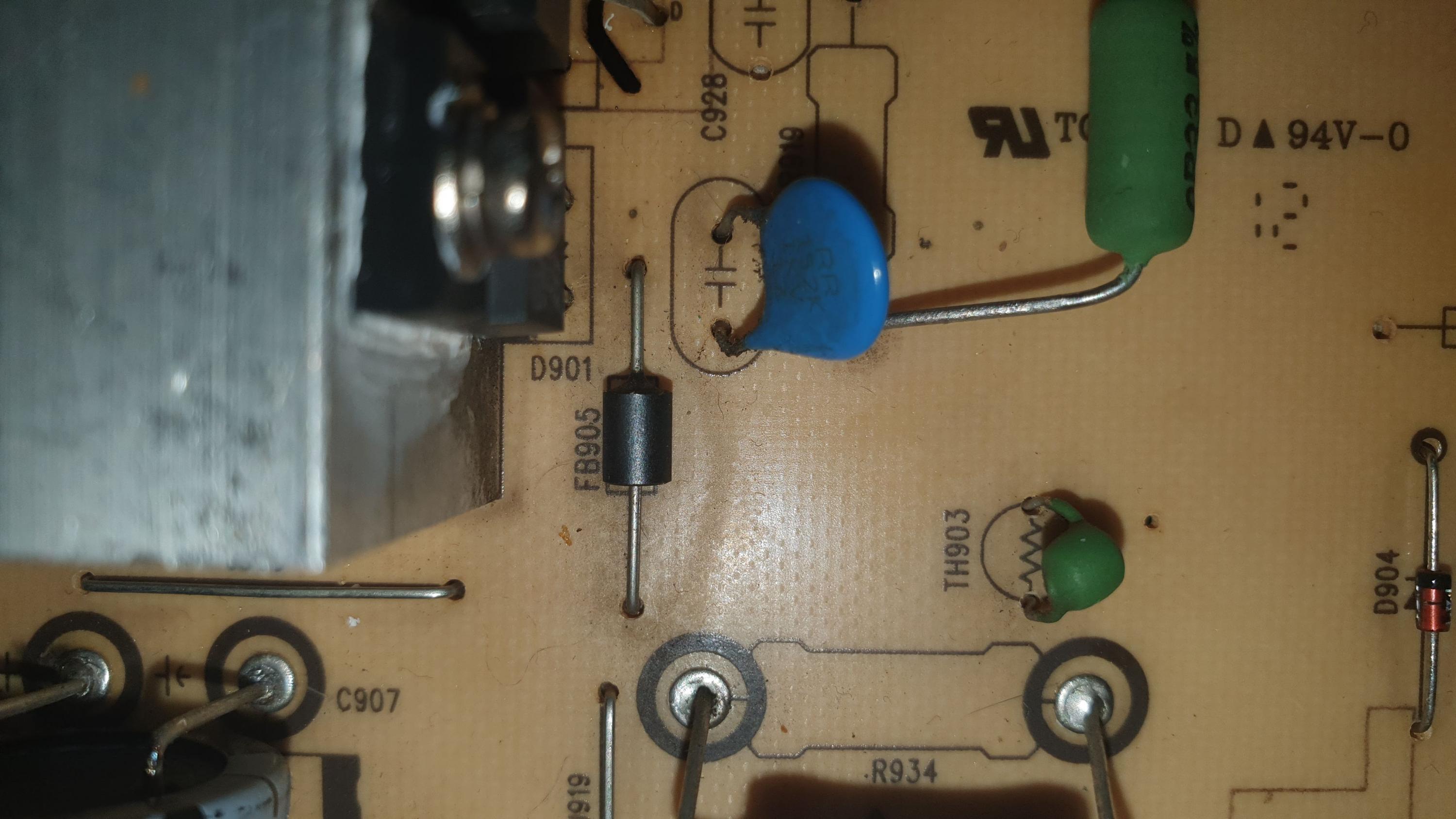

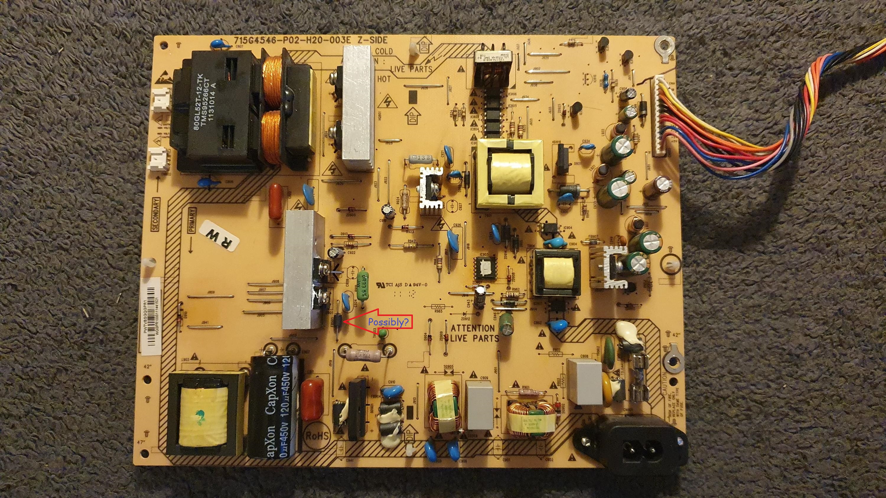

                                      Hello
                                      iam looking at the schematics of this tv and i cant indentify the next part FB905 ?
                                      it should measure 60ohms but iam getting in and out of circuit 0.01ohm
                                      • dick_barton
                                        • Aug 2015
                                        • 6643
                                        • Wales
                                        #59
                                        FBxxx is generally a reference to a ferrite bead or at least some sort of inductor. It may be what I have marked but I cannot read the silkscreen legend
                                        • trunks81
                                          • May 2020
                                          • 265
                                          • Nederland
                                          #60
                                          Sorry i should have marked it out.. but that is the one !!
