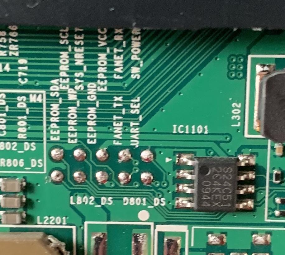

Check and see if you have IC7301 on that mainboard, would be an 8 pin eeprom.Comment
Re: Samsung UE48JU6400W - back light on, sound on, sometimes picture.
I have looked through all the components on the board, but did not find IC7301. If you are referring to the main eeprom I think it is IC1101. It also has eeprom test points.
Im thinking of trying to connect EEPROM_SDA and EEPROM_GND or EEPROM_SDA and EEPROM_VCC and turn on the TV to see if it turns on. I will not disconnect the EEPROM_SDA and GND/VCC signals while the TV is so that I will not erase the eeprom.
As far as I read it should force the TV to turn on with default settings after 20 seconds. If it turns on repeatedly i hope that after that I will be able to fire it up with the current settings, take pictures of the panel info, tuner settings, etc. and perform an EEPROM reset.
What is your opinion?Last edited by dronerat; 05-17-2020, 11:38 AM.Comment

Yes, was going there, that there IS an eeprom reset: (connecting) GND OR VCC (3.3v) to SDA. BUT DO NOT connect both gnd and vcc to sda that would be BAD.Last edited by nomoresonys; 05-17-2020, 01:05 PM.Comment
Ok so I somehow managed to start the TV in service mode with the panel ON. Took a ton of pictures in the different menus just to be sure.
Now the fun thing begins. I connected EEPROM_SDA to EEPROM_GND and have some mixed results.
Now the panel starts 7/10 times, but I still have some of the runs not starting correcly.
I am starting to think that the PSU is acting up on me, because shorting the two signals changed the boot sequence which may have led to the T-Con starting more frequently.
Previously the T-Con was starting just before the backlight, but now the T-Con starts and the backlight starts 20 seconds after that. I am starting to think that the delay in starting the backlight provides just enough stable voltage for the T-Con to start, but not every time (7/10) times.
The crackling noise coming from the PSU in standby which is present in powered on mode (just a lot quieter) is leading me to believe the PSU might be the problem. I am not sure if I will be able to record it and how to upload it here. Sounds like 50hz.
Since the issue is still present with the EEPROM disabled i think that we can rule the EEPROM out of the options causing the problem.Comment
