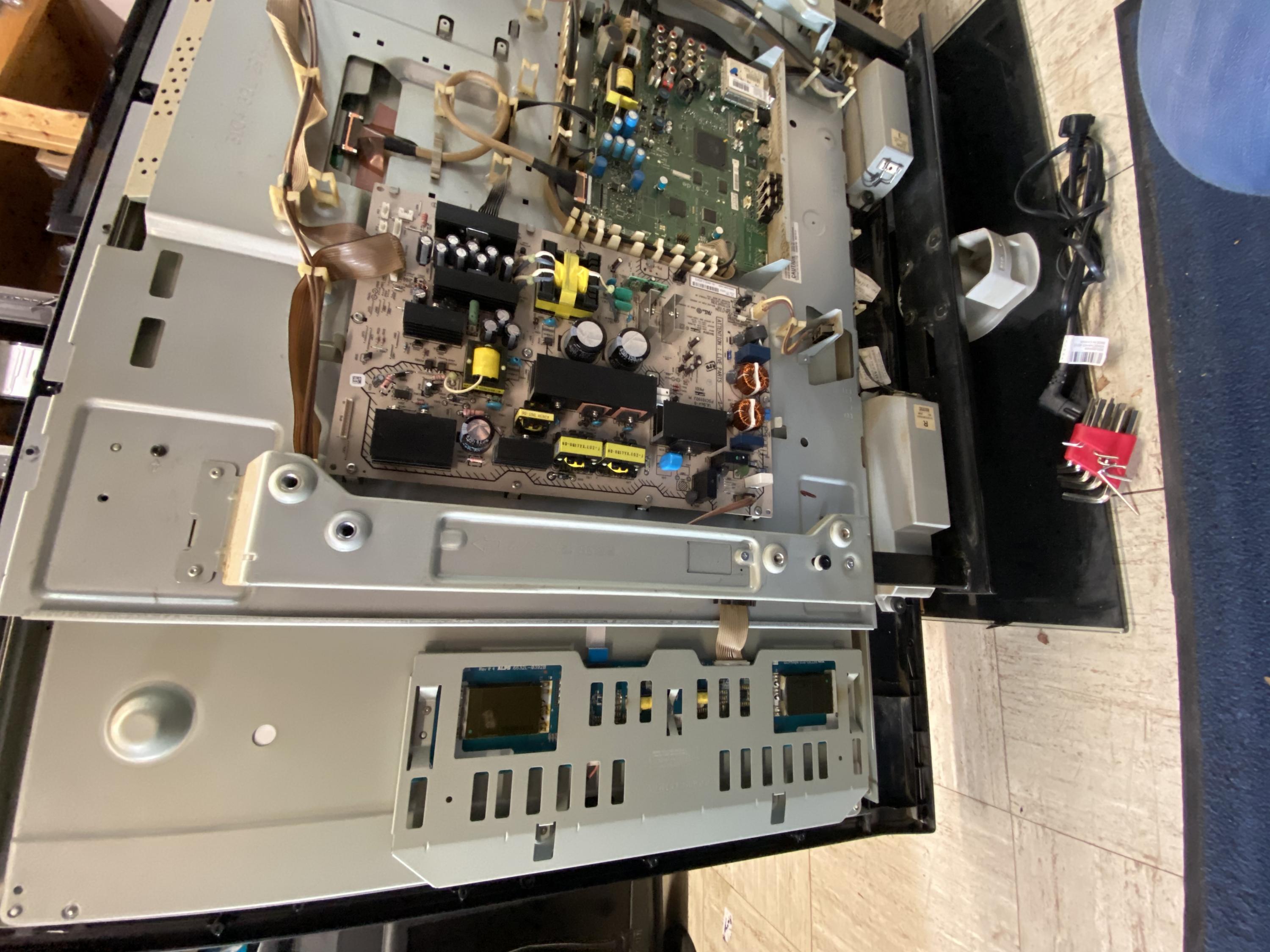

    I have a philips 47PFL7422D/37 that is having some issues. When powered on the tv shows the red led status light. It blinks 6 long and then 3 shorts.

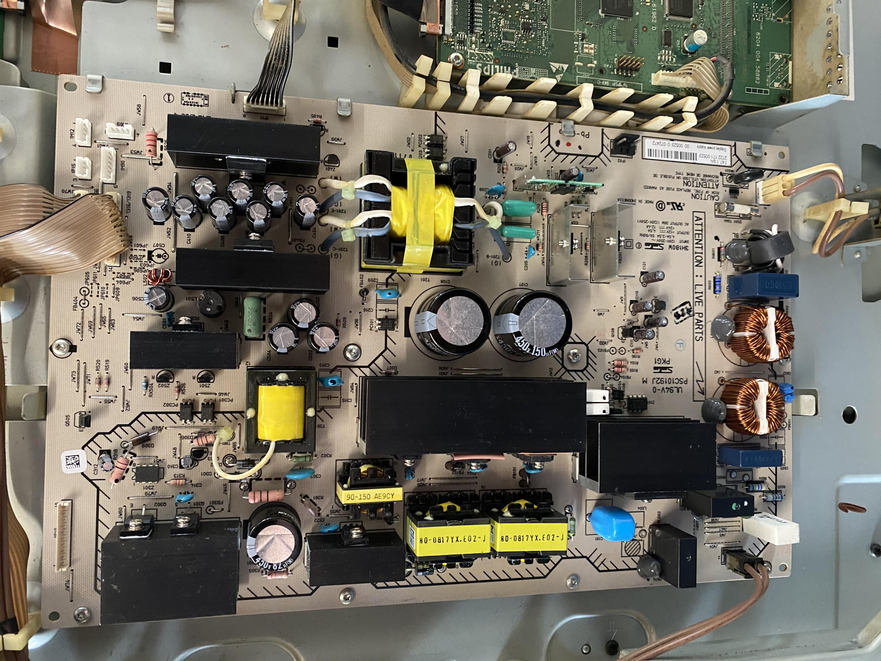

    You say you have a "faint picture" so it is likely a backlight issue, so check the inverter boards. Do you get a flash of the backlights when you first turn on the tv?

    Ypu may have a fault on one of the inverter boards or a bad ccfl in the panel (or a poor connection between the ccfl and the inverter)

      Should i check the inverters then? I did replace the inverters because caps on the inverters were bad.

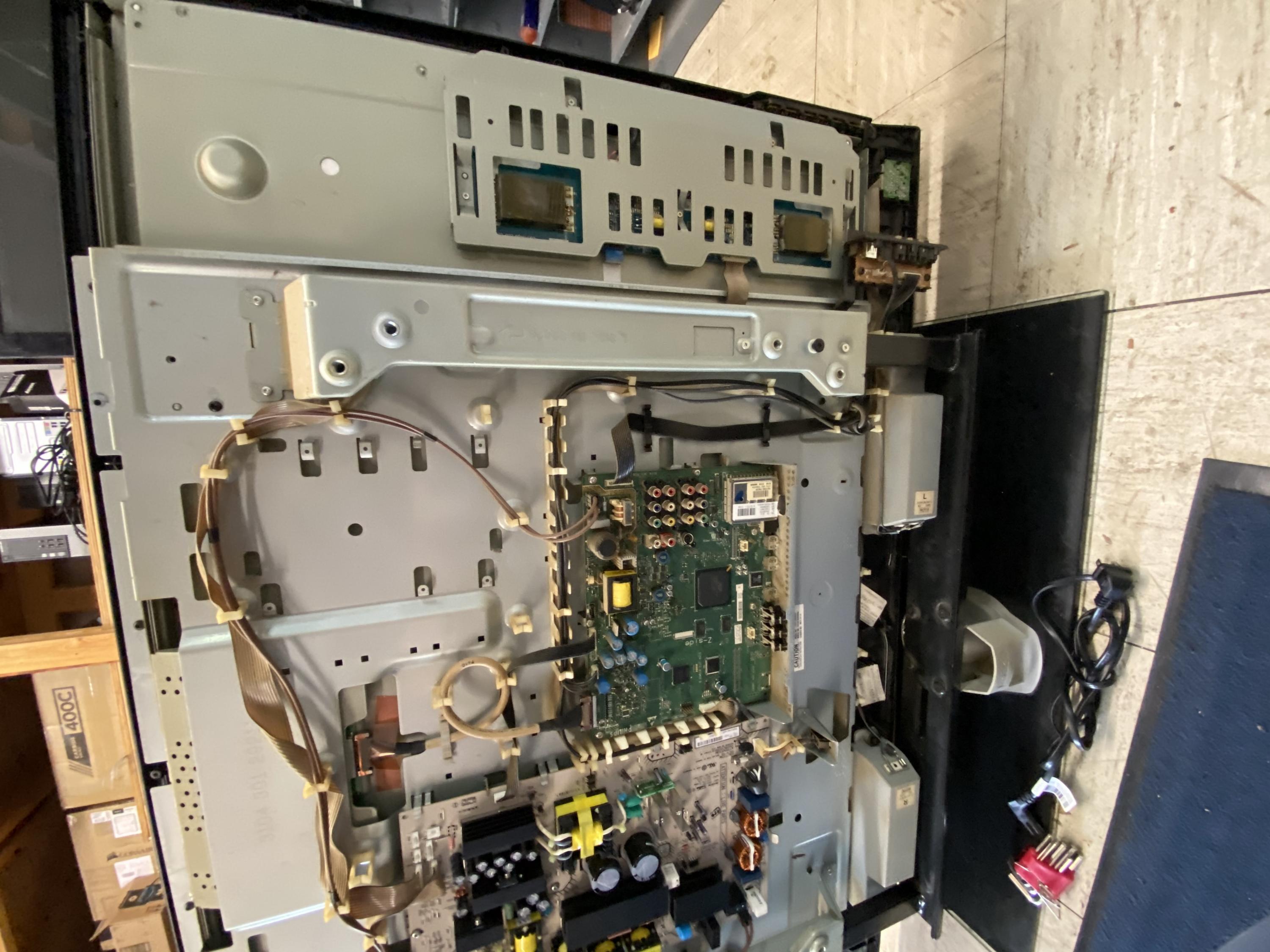

              The backlights are faint. I will update with a picture to show what the tv is doing.
