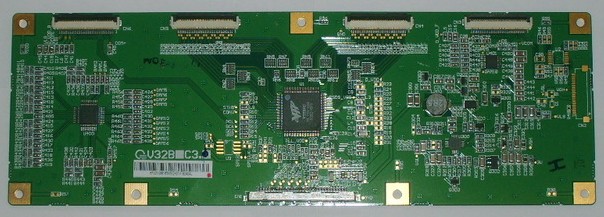

        Re: Sagem Axium HD-L32 LCD - Horizontal Lines
        Thanks for the suggestions.
        The T-Con board is the one at the top centre behind the LCD, right?
        It's marked V32B C3. Looks like this one:
        How can I work out what the voltages should be?
          [I should add (in case it's not obvious), this is the first LCD TV I've pulled apart I've repaired a few digibox power supplies, but just obvious faults.]
          The easiest way is to look up the part number of any three or four terminal devices, particularly those close to capacitors. In many cases the part number includes the output voltage.
            Thanks Bill.
            I think I'm just going to give up on this one Getting access to the boards while the TV is powered on is pretty difficult.
