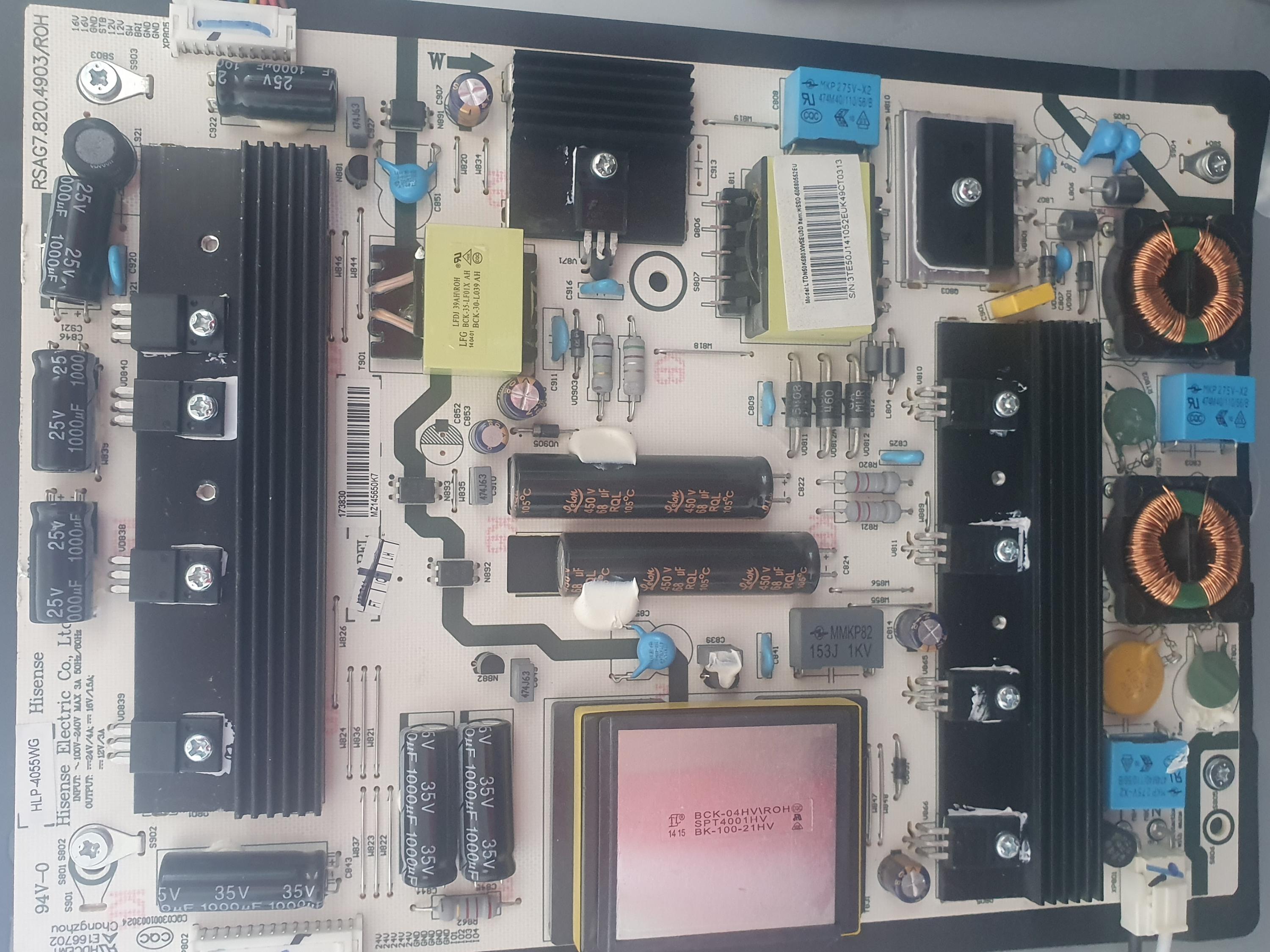

    Hisense 50k680 no power no standby
    Hi folks!
    Just got an Hisense 50k680 with no power and no standby. I dont get any dcv (ether 16dcv or 5dcv) to mainboard. Did some basic checks on diods and seems like there find.
    On large caps C822 and C284 i get 315dcv. Is there a probleme on the cold side?

    Re: Hisense 50k680 no power no standby
    The problem looks like it's on the HOT (Live) side.
    If you have no +12V then check the components around N851 (8 pin IC) and also V871. Dont lose the ferrite bead on the leg of V871.

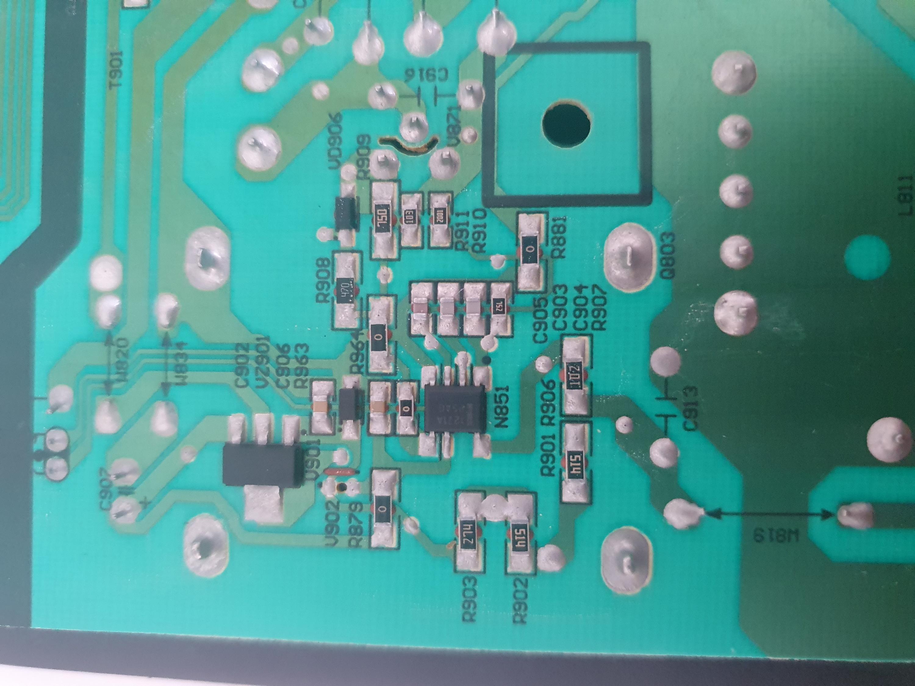

    • EUWest
      • May 2019
      • 44
      Tested V871 in circuit and seems like its fine. Do i have to solder it out and then test?
      And cant finde N851. In schematic its listed but on Board cant see it
      Edit//
      Lol forgot to Look on backside. Will do some testings now

        Checked smd resistors nearby and get following results: in bracket will be value from schematic
        R901 506k (1k)
        R902 507k (1k)
        R903 270k (1k)
        R908 47 (27)
        R909 75 (47)
        R910 2k (2k)
        R911 9.6k (10k)
        R879 0 (0)
        R963 0 (1k)
        R964 1 (1k)
        R881 0 (0)
        Because there are many resistors differ from schematic value, is there problem somewhere Else or are smd resistors died?
          What are the numbers on each of the resistors. Better still a photo of the underside of the board.
          It is quite possible that the component values have changed and is dependant on the board revision.
          • EUWest
            • May 2019
            • 44
            attached photo

              • dick_barton
                • Aug 2015
                • 6643
                • Wales
                They all apear fine and match your circuit except for R964 which you say is 1K and the board shows as 0 ohms. Double check and also check the zener diode VZ901 and transistor V901
                Edit
                Just re-read your results and R964 is down as 1 which I suspect you meant 1 ohm which is fine.

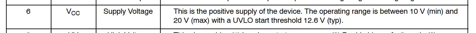

                              Weile testing R906 Burned so i dont now if my results are right or not.
                              I get on
                              Pin 1 (Skip/latch) : 0.34V
                              Pin 2 (FB): 0.34V
                              Pin 3 (CS): 0V
                              Pin 4 (Ground)
                              Pin 5 (DRV): 0.01V
                              Pin 6 (Vcc): 15.7V
                              Pin 8 (HV): 265V
                              Could this be correct?
                              • dick_barton
                                • Aug 2015
                                • 6643
                                • Wales
                                R906 (has 102 printed on it) looks like a 1K ohm resistor so if you measure it you can tell if it's OK or not.
                                So the iC Pin 6 VCC has 15 volts which is a little low since the circuit says 20V but should be good enough for it to run.
                                Pin 5 which should drive the mosfet is not doing so.
                                Pin 3 should be monitoring the current through the mosfet via R912 (which you can check is not open circuit)
                                You said the mosfet V871 was OK so I'm suspecting N851 and would look at replacing it.
