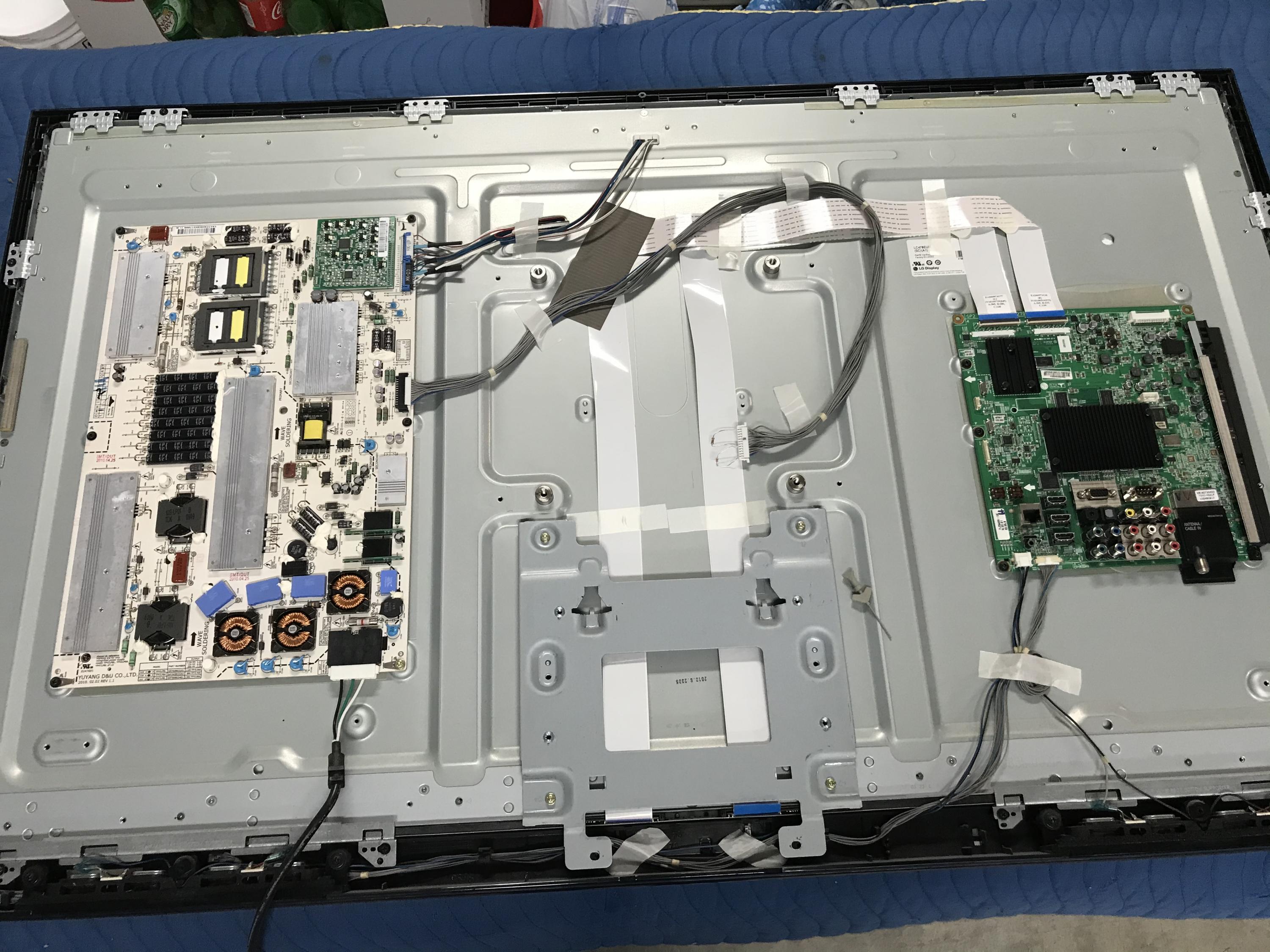

    LG 47LE5400-UC.AUSWLJR - no backlight; no DRV_ON signal
    TV: LG 47LE5400-UC.AUSWLJR

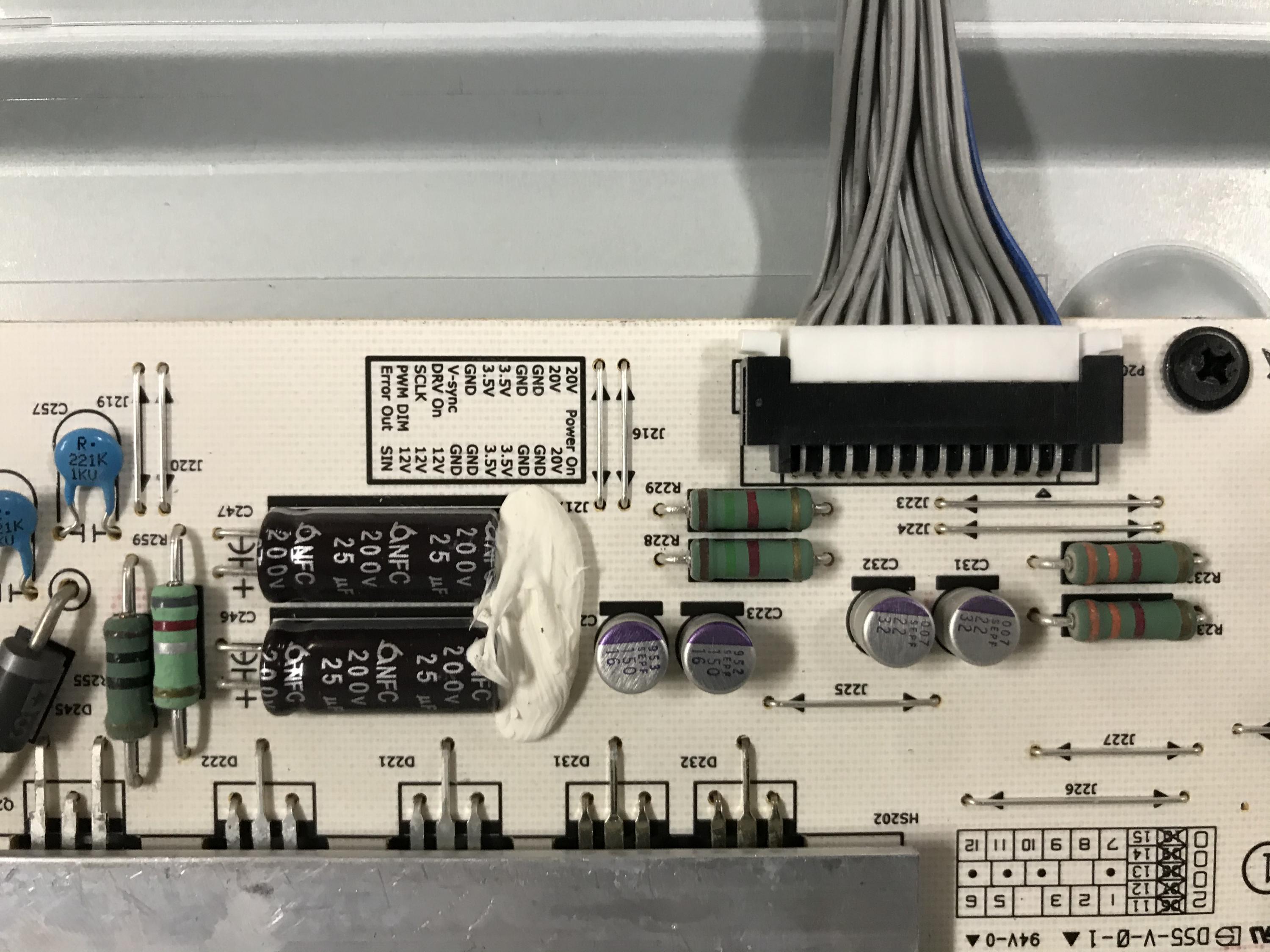

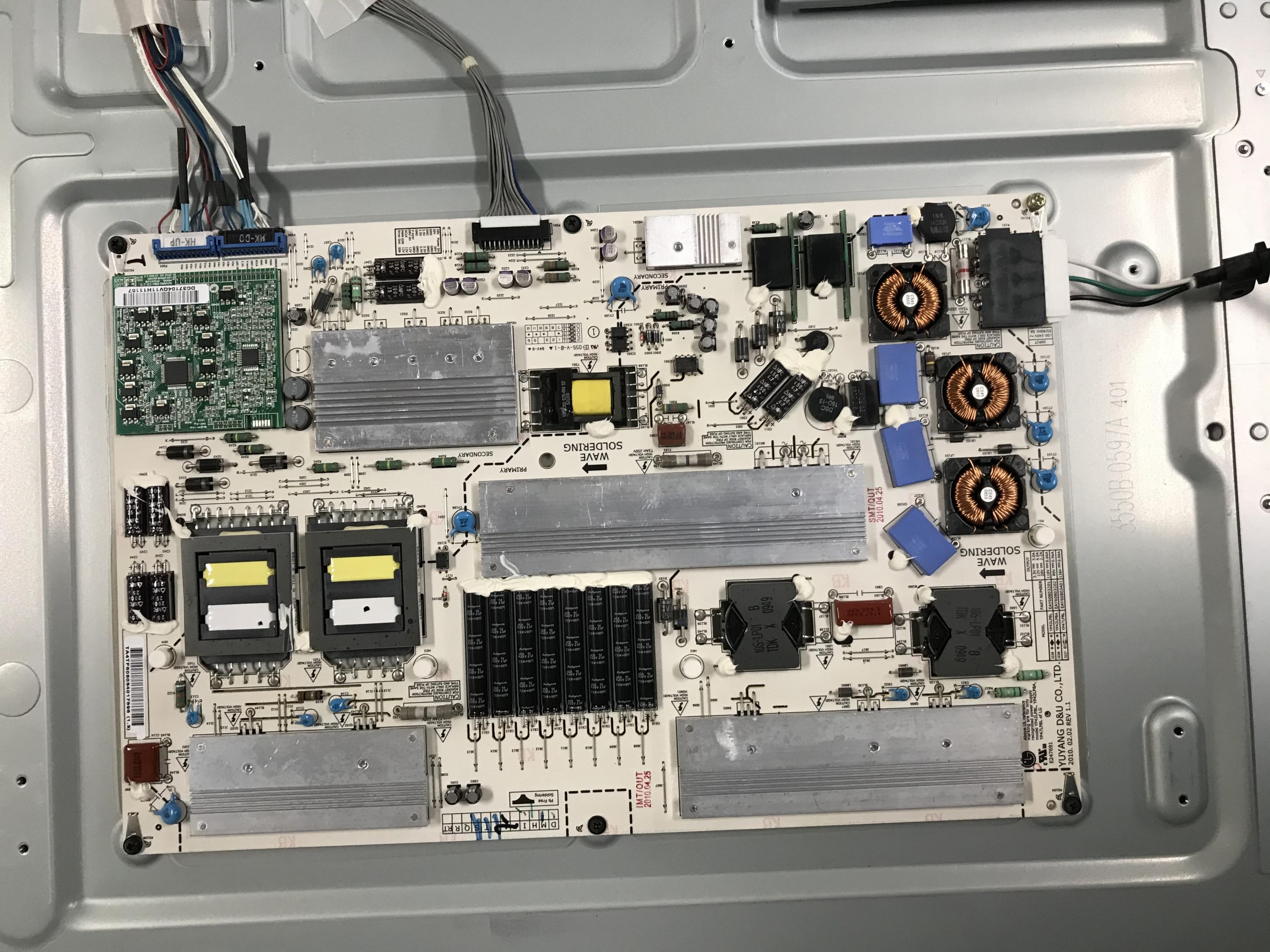

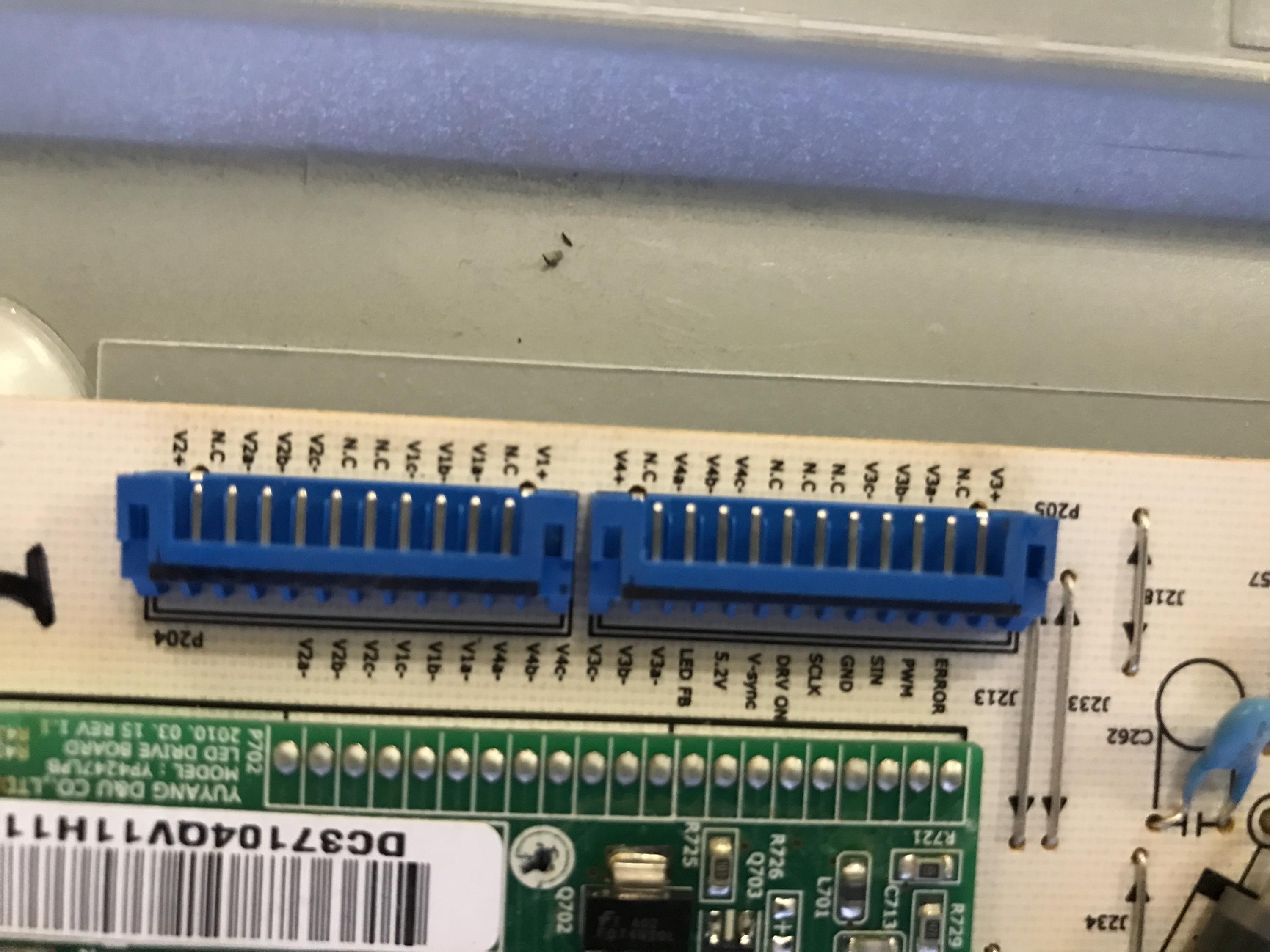

    Symptoms: When i press the power button, i hear the relay click. The front panel touch buttons illuminate and they make a sound when i press on them.
    No backlights (even for a brief moment), and the optical audio light is not on. Power supply appears to be fine though (measurements are at the bottom).
    The mainboard sends the "power on" signal correct as well as PWM DIM, but DRV_ON is not sent.
    I disconnected the cable between the SMPS and main board. I jumped 3.3STBY to POWER_ON as well as 3.3STBY to DRV_ON with two 10K resistors. The backlights came on just fine (yay!). The string tested good as well with the LED tester with the unit off.

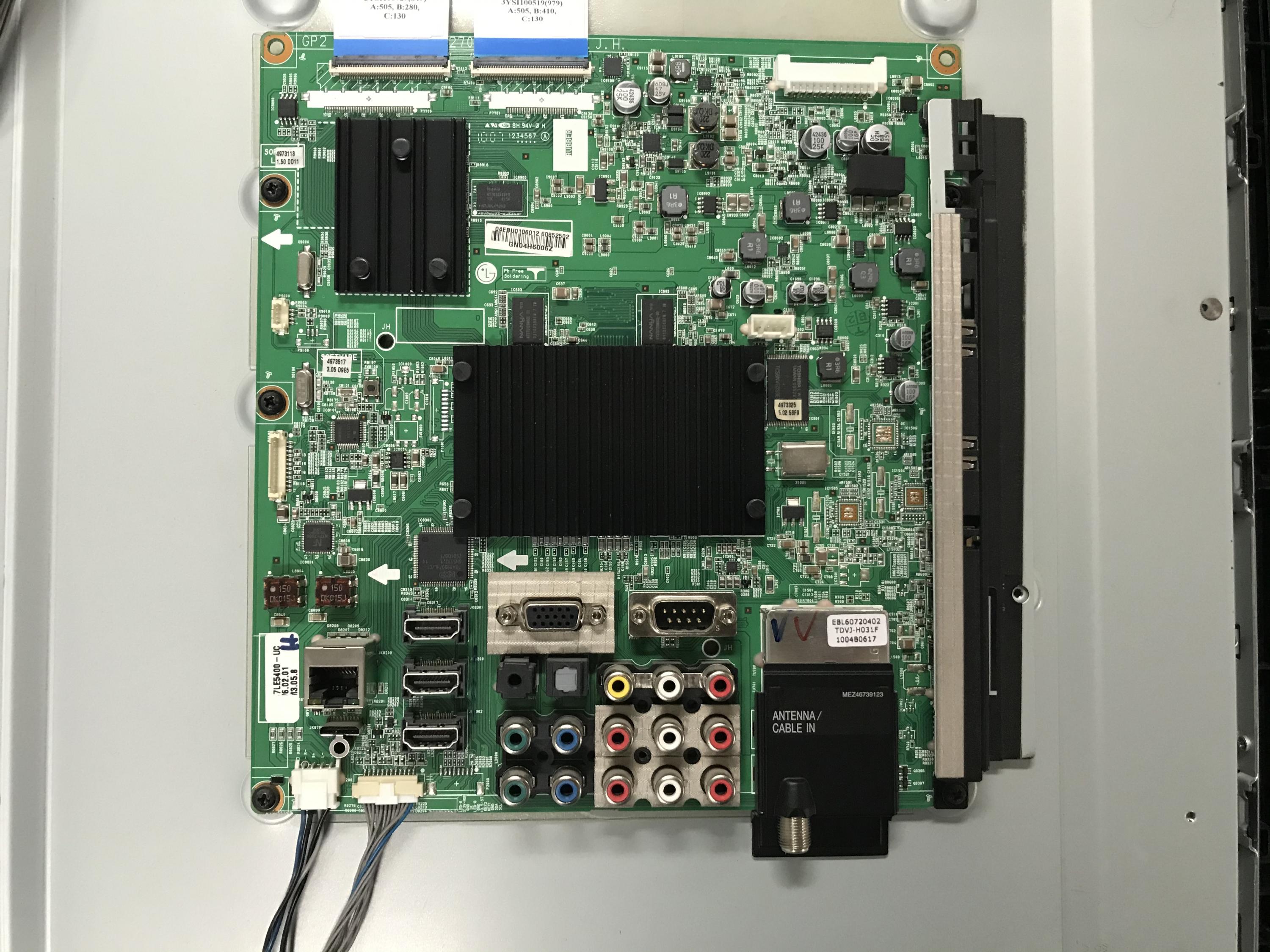

    I'm suspecting that the main board has an issue. Likely a problem with the main processor BGA.

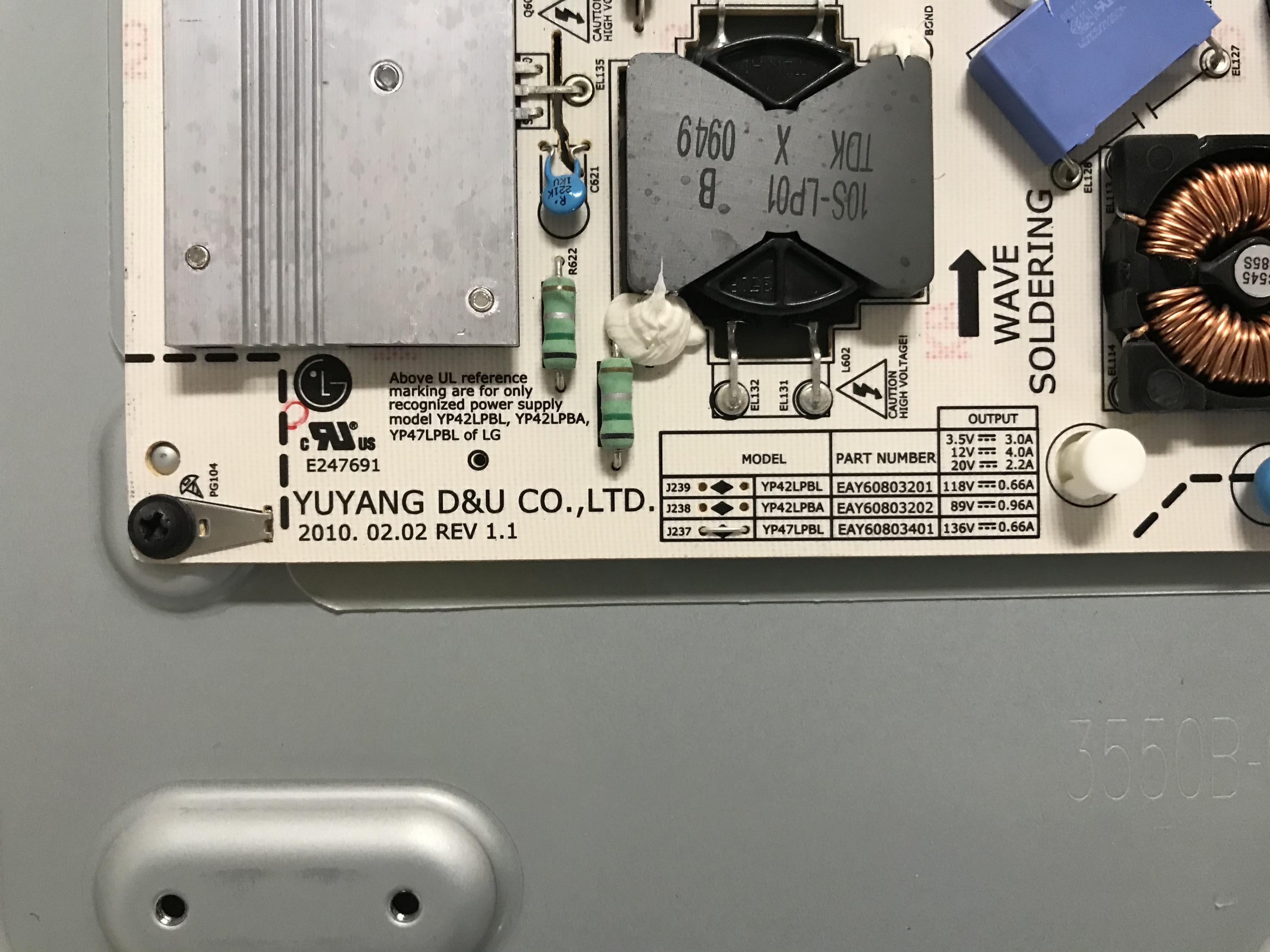

    On a side note, I obtained a 55" version of this TV (LG 55LV5500-UA.AUSYLJR) in 2016 and it failed in the same manner. I ended up replacing the main board for that one.
    Anyway, I measured the voltages with the TV in STBY and when it's ON. Looks like i'm missing DRV_ON. What's the chances it's the micom firmware? (i'm assuming remote).
    Any thoughts on this would be greatly appreciated. If there are no other suggestions, this thing will get a quick "heatgun treatment" to the BGA under the main heatsink to see if that temporarily fixes it.
    Code:
    P201, odd pins are the top row, even pins bottom row.
    Pin	SIG	V_OFF	V_ON
    1	PWR_ON	0	3.329
    3	20V	0	21.26
    5	GND	0	0
    7	GND	0	0
    9	3.5V	3.49	3.438
    11	3.5V	3.49	3.438
    13	GND	0	0
    15	GND	0	0
    17	12V	0	12.46
    19	12V	0	12.46
    21	12V	0	12.46
    23	SIN	0	0
    2	20V	0	21.26
    4	20V	0	21.26
    6	GND	0	0
    8	GND	0	0
    10	3.5V	3.49	3.441
    12	3.5V	3.49	3.441
    14	GND	0	0
    16	V-sync	0	0.252
    18	DRV ON	0	0.043
    20	SCLK	0	0.21
    22	PWM DIM	0	2.917
    24	ErrOut	0	0

    Re: LG 47LE5400-UC.AUSWLJR - no backlight; no DRV_ON signal
    No DRV_ON is probably BGA failure (common in LG LE, LV and LS? series). Repair services for the main board on ebay. I would try a hair dryer on the processor first to confirm.

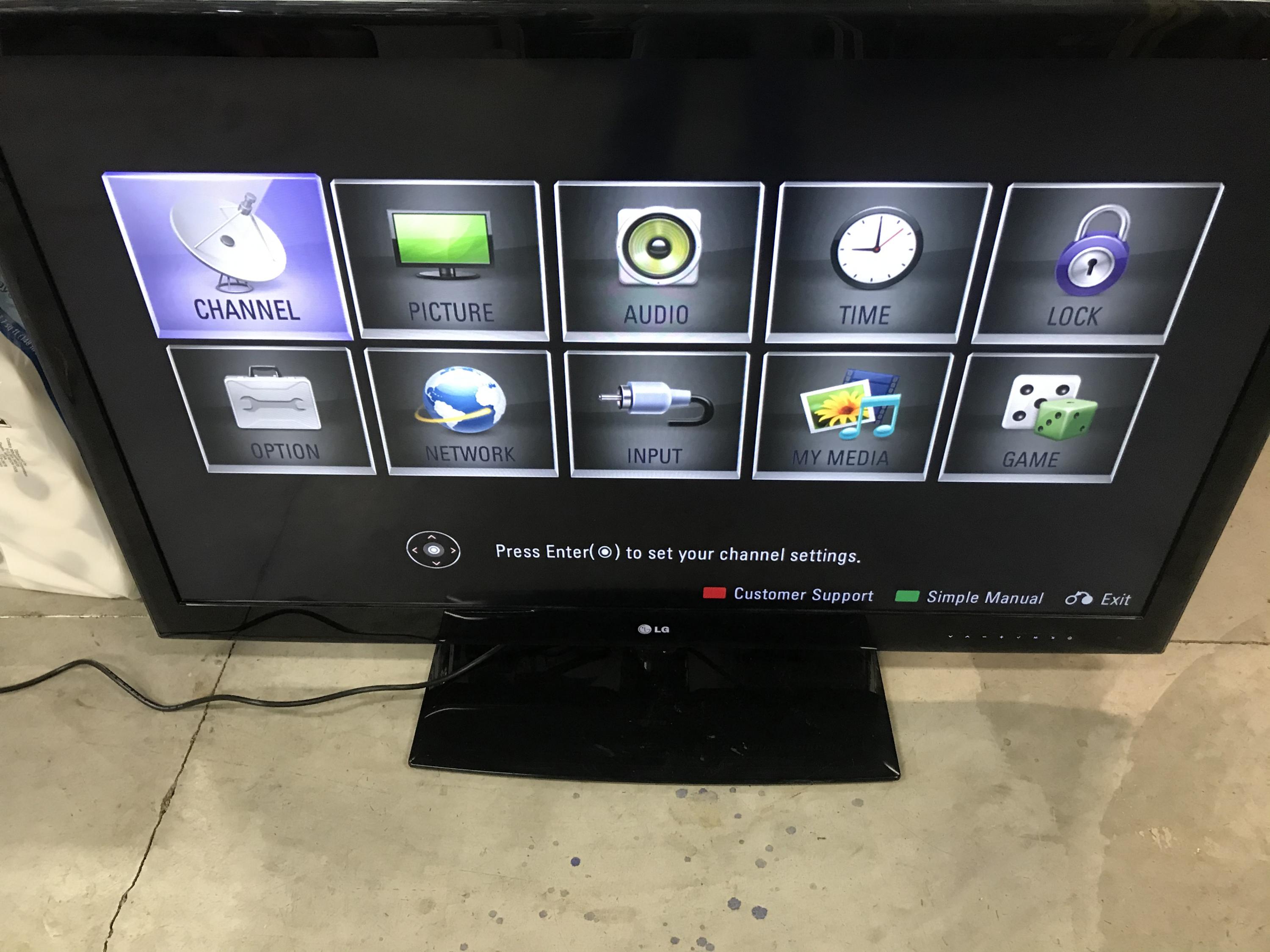

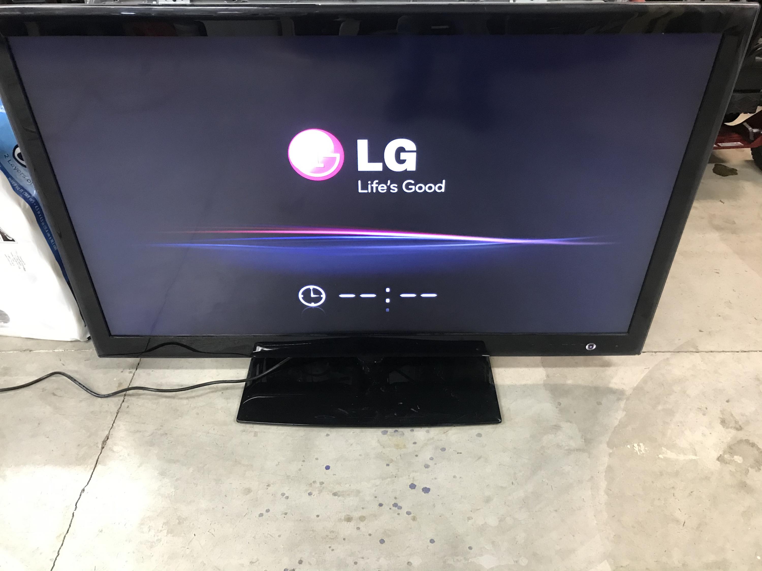

        I heated up the main processor and surrounding board area with a heat gun. Works for now. I'll let this TV run for a few hours today and see how it goes. My other option is to stick it in the dedicated toaster oven for electronics if it fails again.
        Thanks! Onwards to the next item.

          The hair dryer trick is same as wrapping a ps3 or laptop in a blanket to get them to start. The cracked solder joints will expand enough to make contact. I have tried to bake boards before but the problem came back in a few months (tried on ps3 and laptop). Proper repair is to reball.
            Agreed. I just updated post #4 with pics. I agree a proper fix is a reball, LG and authorized repair shops want an arm and a leg for a new main board. eBay "repair services" want ~$50 just not worth it.
            I got this TV for free, it can just be given away for free to a family in need (or hang yet another TV in the garage... already have two. A third is excessive lol)
            I was combing FB market place and saw a dead TV local to me, just couldn't pass up the opportunity to have a crack at it.
            At the very least, this thread may help someone else in the future.
            Thanks!
