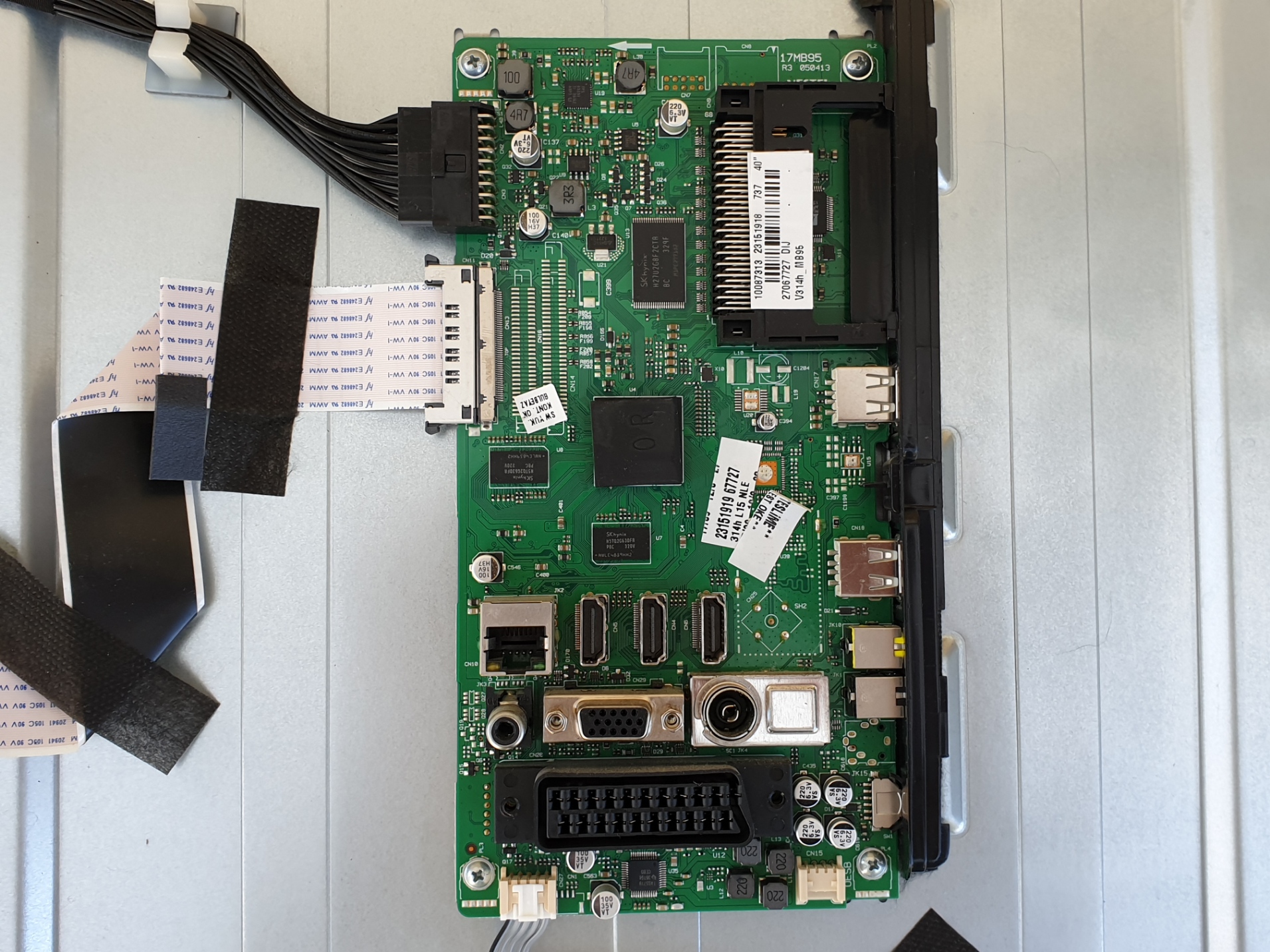

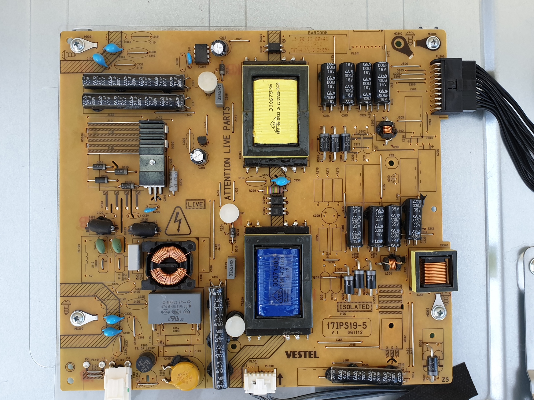

        • Jason Powell
          • Apr 2020
          • 8
          Re: Fault on a Finlux 40F8073-T
          Photos of the Boards.

            • dick_barton
              • Aug 2015
              • 6643
              • Wales
              What is the voltage on each of the diodes when you power up the set.

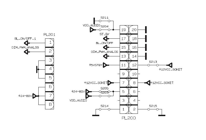

                • R_J
                  • Jun 2012
                  • 9624
                  I can't tell how many wires are on PL500, but check the voltage on each pin that has a wire connected. You will need to have your meter on the pin when you turn the tv on. this is the plug going to the led's in the panel. (pin7 is the side with the arrow)
                  pin1 =
                  pin2 =
                  etc.

                    • Jason Powell
                      • Apr 2020
                      • 8
                      pin1 =
                      pin2 =
                      etc.
                      Hi
                      20 wires connected, 10 on top of 10.
                      Readings are as follows:
                      Top Row Bottom Up :
                      Pin 1 - 0.0
                      Pin 2 - 0.0
                      Pin 3 - 0.0
                      Pin 4 - 0.0
                      Pin 5 - 0.0
                      Pin 6 - 0.0
                      Pin 7 - 12.1
                      Pin 8 - 23.5
                      Pin 9 - 0.0
                      Pin 10 - 0.0
                      Bottom Row Bottom Up :
                      ALL 0.0
                      Except Pin 7 12.1
                          Some of the voltages on PL200 are missing. Can you put the voltage readings alongside the connector pin numbers.
                          • Jason Powell
                            • Apr 2020
                            • 8
                            Pin 1 0.0
                            Pin 2 0.0
                            Pin 3 0.0
                            Pin 4 0.0
                            Pin 5 23.5
                            Pin 6 0.0
                            Pin 7 12.1
                            Pin 8 12.1
                            Pin 9 - 20 0.0
