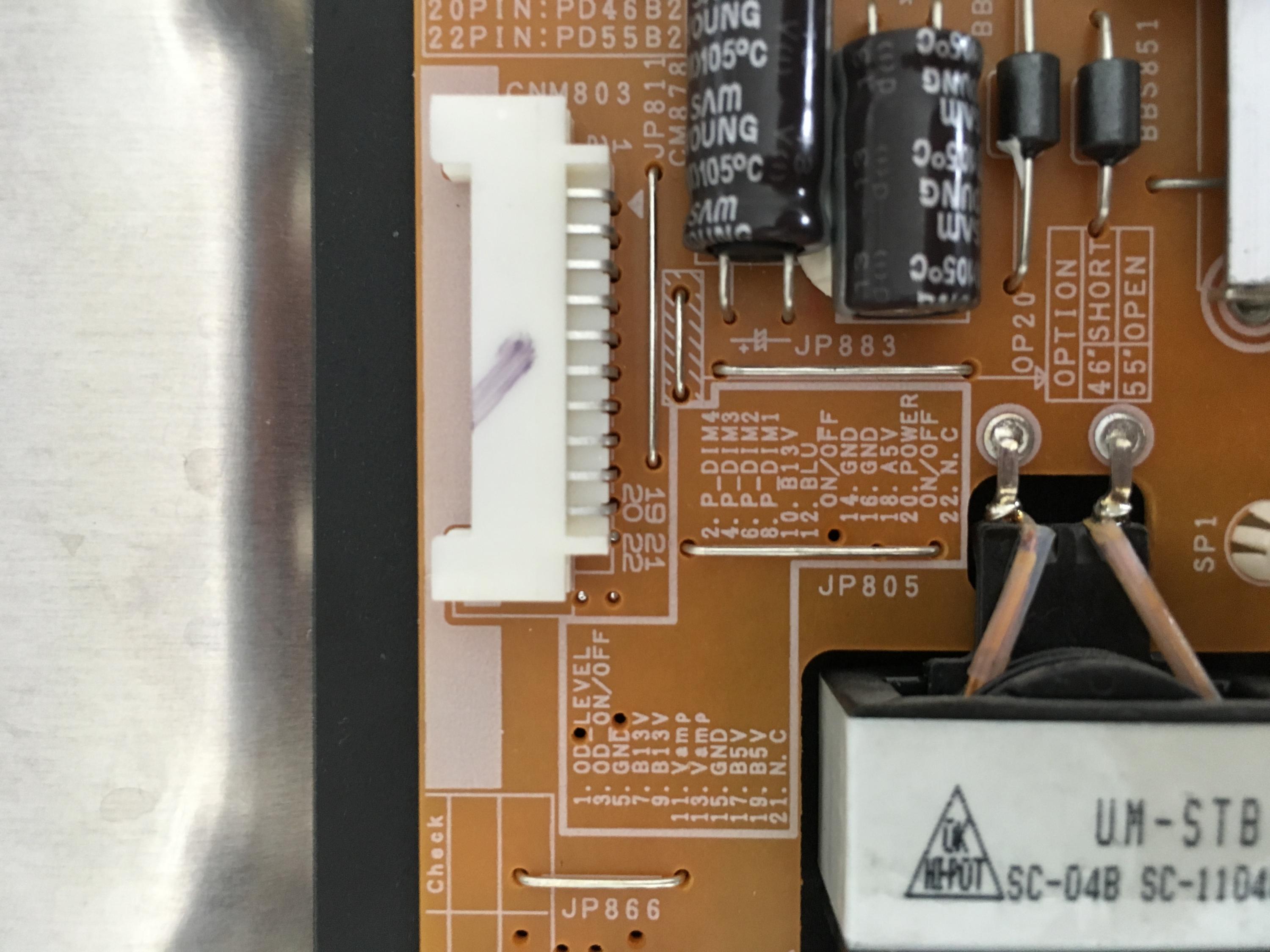

Samsung UE46D6500 doesn't turn on and clicks
  • voxahbc
    • Mar 2020
    • 10
    • Turkey
    Hello guys. I have a problem with my Samsung LED Tv UE46D6500 and hope to find a cheaper soultion with your helps.
    Here is the situation. I have this tv since 2011 and never had any problem, never got repaired and even cover opened. Recently it's started to not turn on. When I plug the cord stand by led lights steady. When push to button to turn on "Smart TV" logo shows up and turns off with an endless cycle.
    I opened the back cover to control the boards as general symptoms shared by people led me to check the capacitors. During the cycle the power board clicks. All capacitors are in very good physical condition, no burn or color change visible. No cracked or bad solder joints visible.
    With a multimeter I checked the fuses and they're all good. To identify which board has problems I removed 22pin (to the main board) cable and cables to the led panel then did some measures. Here are the readings:
    1 OD_LEVEL 5.3V Max - fluctuating
    3 OD_ON/OFF 5V Max - fluctuating
    5 GND Continuity checked - OK
    7 B13V 12.8V Max- fluctuating
    9 B13V 12.8V Max- fluctuating
    11 Vamp 13V - constant
    13 Vamp 13V - constant
    15 GND Continuity checked - OK
    17 B5V 0V
    19 B5V 5.4V - constant
    21 N. C 5.4V - constant
    2 P_DIM4 0V
    4 P_DIM3 0V
    6 P_DIM2 0V
    8 P_DIM1 0V
    10 B13V 12.8V Max - fluctuating
    12 BLU 4.8V - constant
    14 GND Continuity checked - OK
    16 GND Continuity checked - OK
    18 A5V 0V
    20 POWER 5.4V - constant
    22 N. C 3.4V - constant
    Fluctuations are between 0V and the max reading.
    There are two high voltage (450V) capacitors and they gave me around 380V
    With the results above I assume power board has problem, so any idea, experience or helps to identify where the problem is, are appreciated. I also attached the photos of the power board. Thanks

      "17 B5V 0V
      18 A5V 0V"
      Are you sure you count the pins correctly? Look at some of your readings, they do not look right.
      Without Standby A5 power supply then you cannot have ANY control Voltages, i.e. PS-ON, BLU, etc. but you are showing you do have them. The Standby power supply output is connected to the pull-up resistors to simulate control signals when power supply is not connected to the main board to perform power supply board self-test.
      Power supply board BN44-00427A
      https://www.shopjimmy.com/samsung-bn...upply-unit.htm

        Re: Samsung UE46D6500 doesn't turn on and clicks
        Originally posted by budm
        "17 B5V 0V
        18 A5V 0V"
        You're right. Somehow, I think in an absence of mind I included pins 21 and 22 and made a shifting in both reading and the table. Anyway I redid the measurement with same conditions (like I did in the previous, all cables except 220V power are disconnected). Here are new readings:

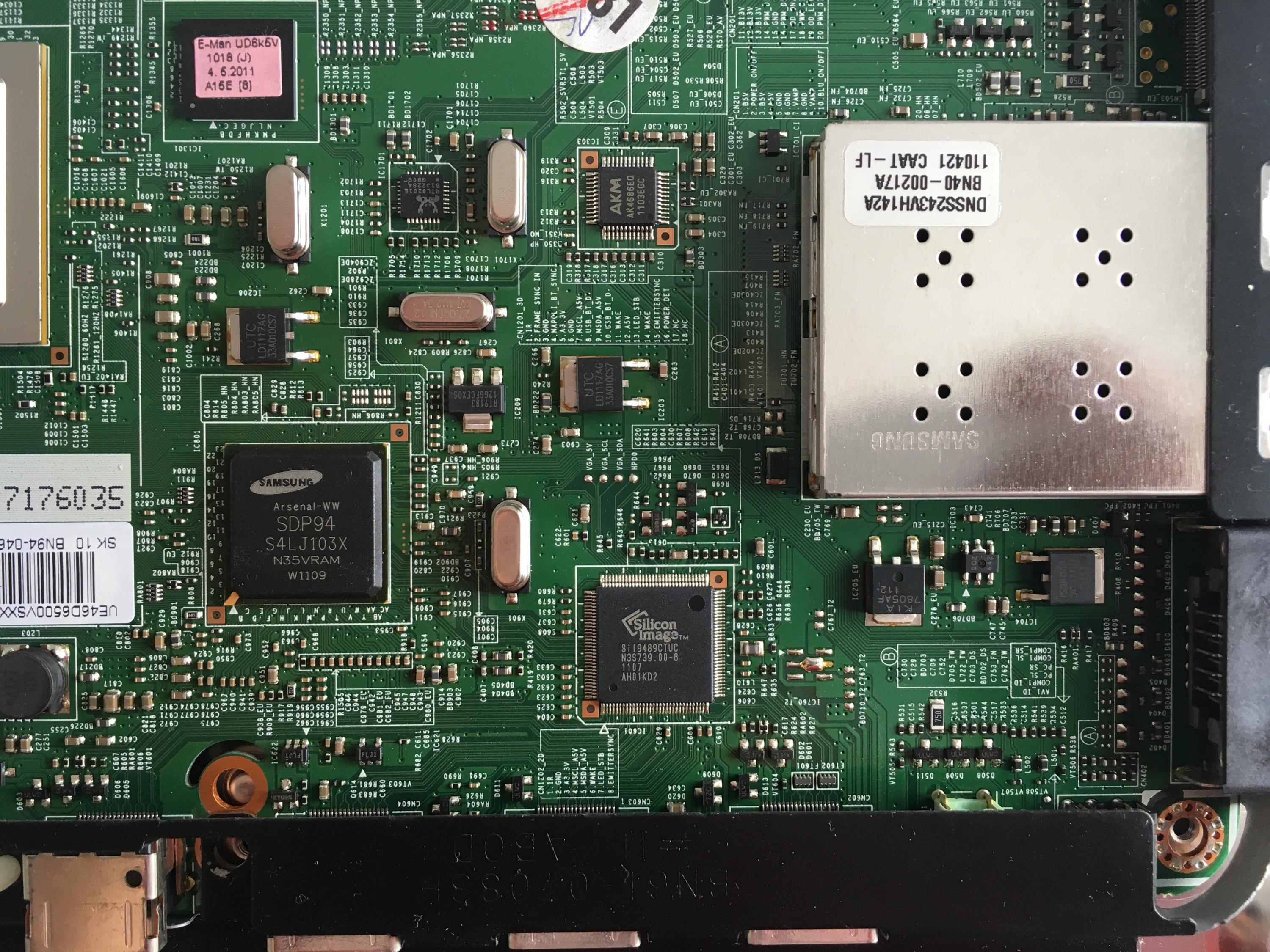

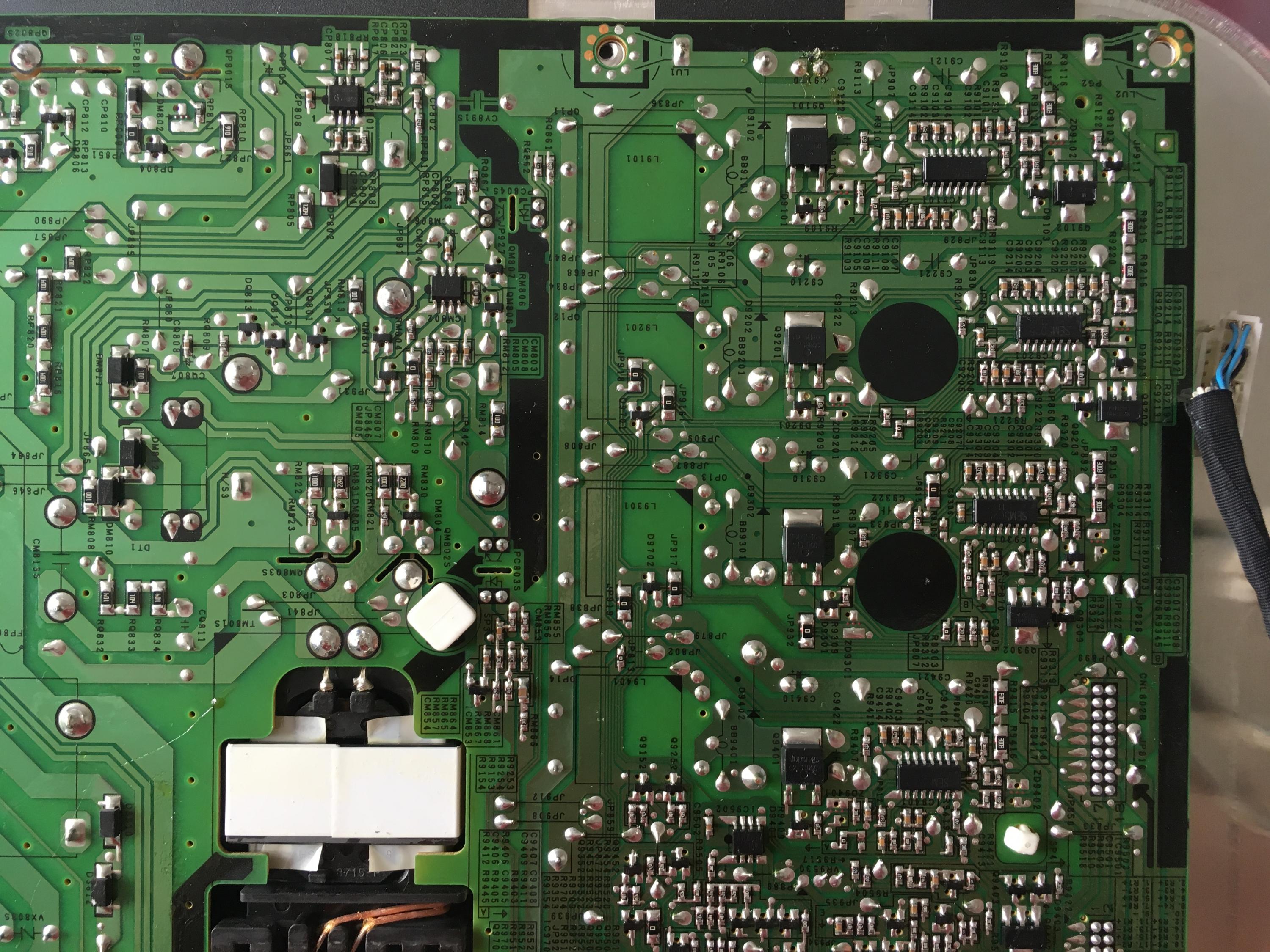

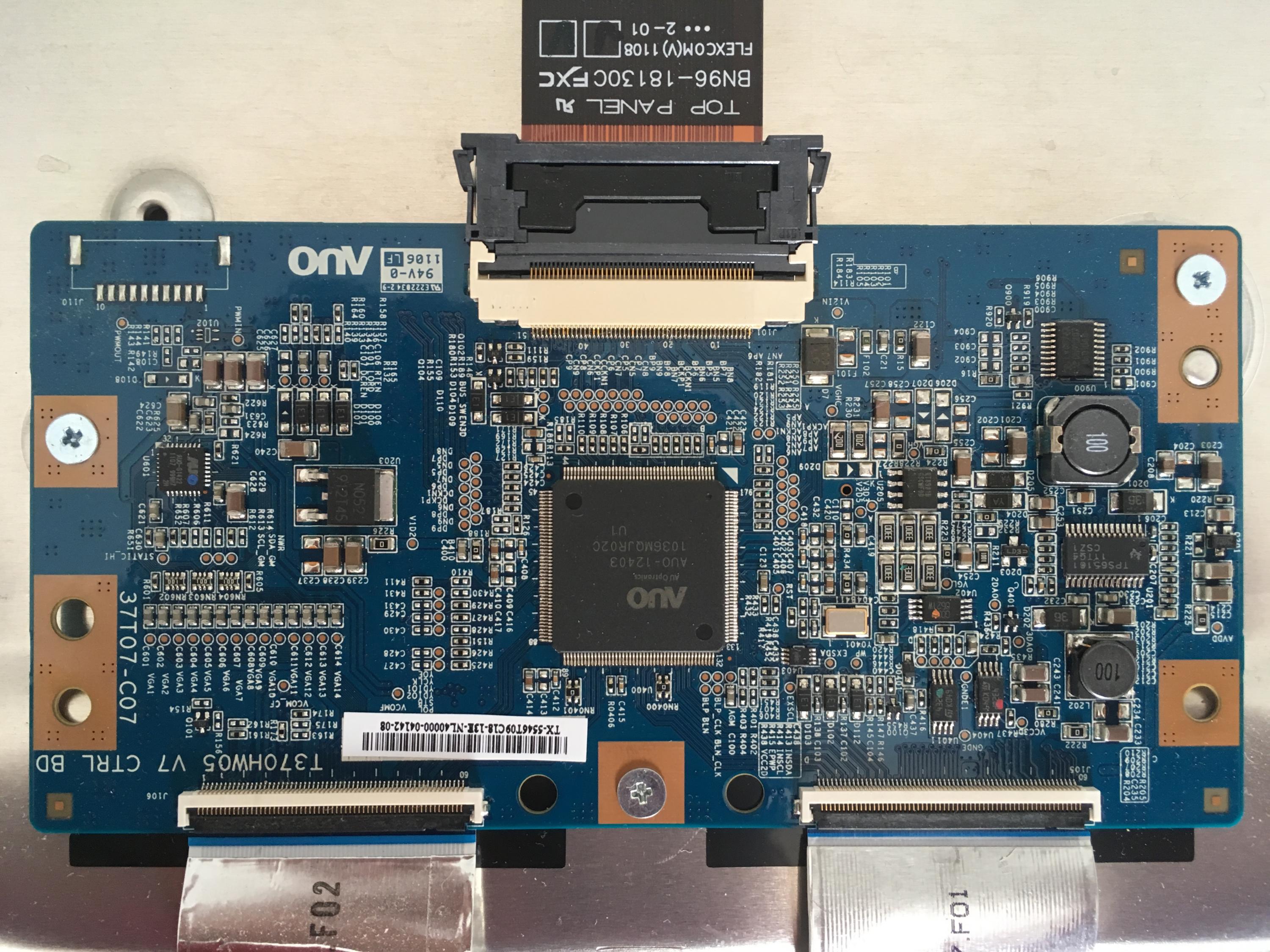

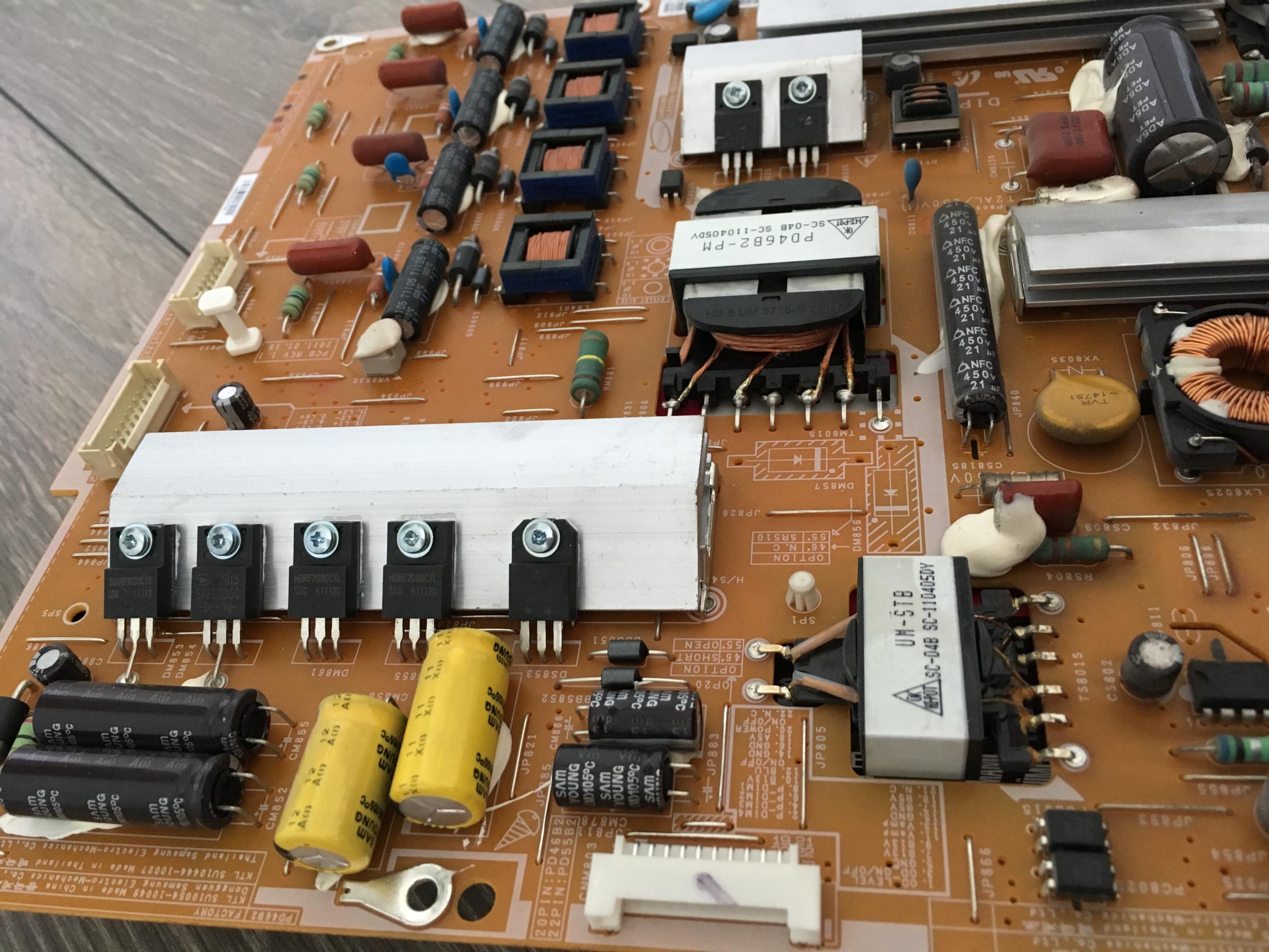

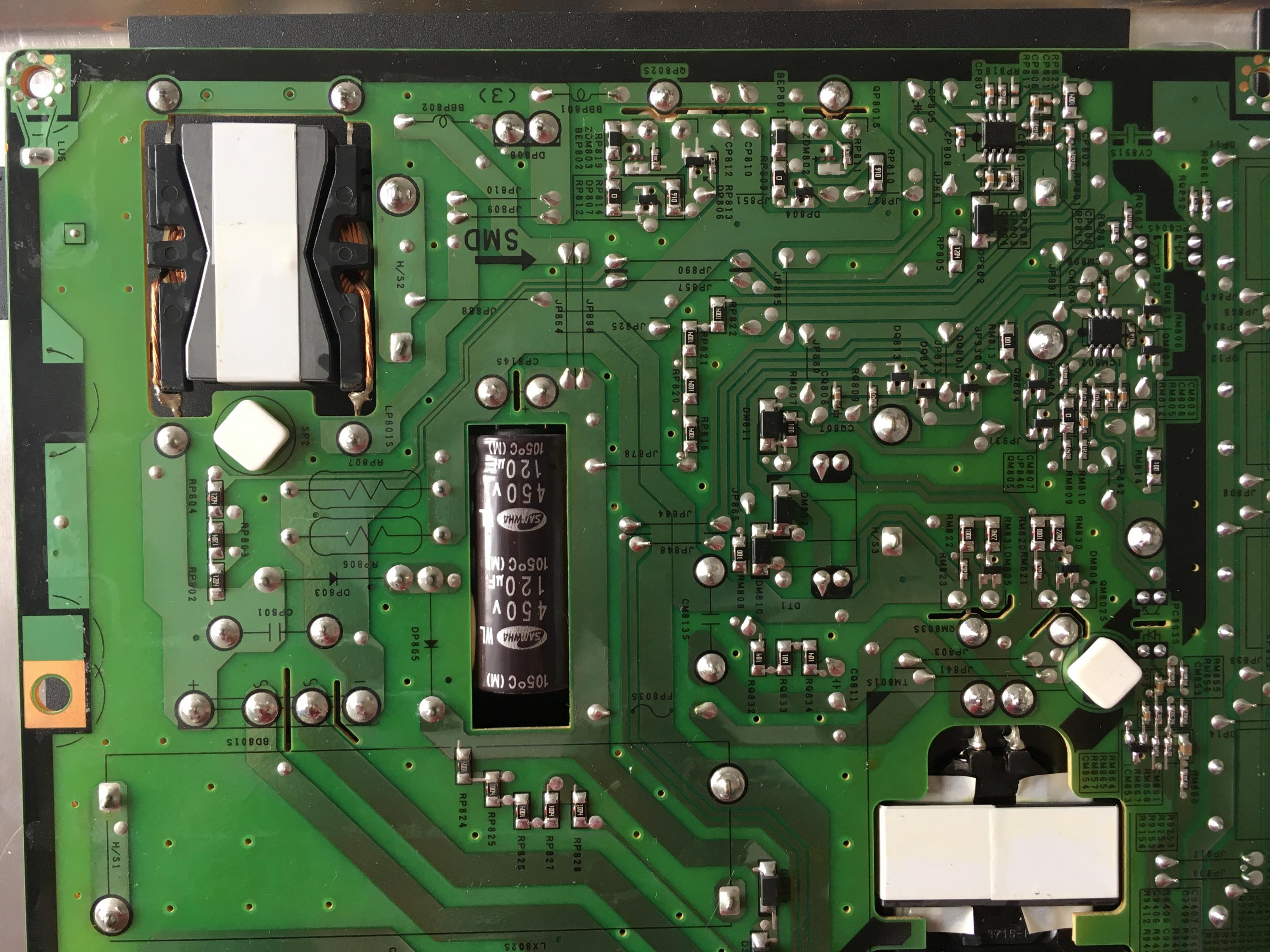

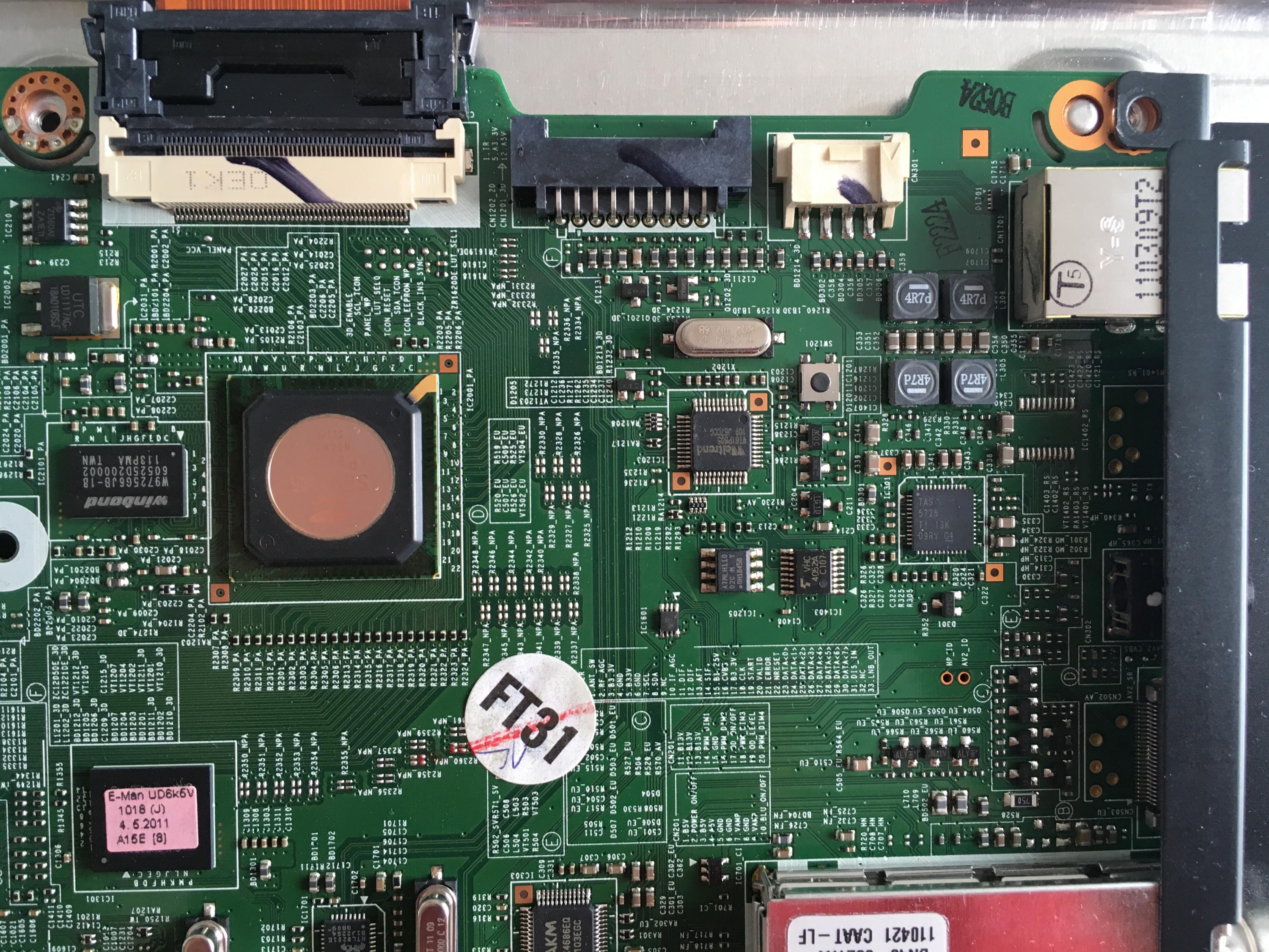

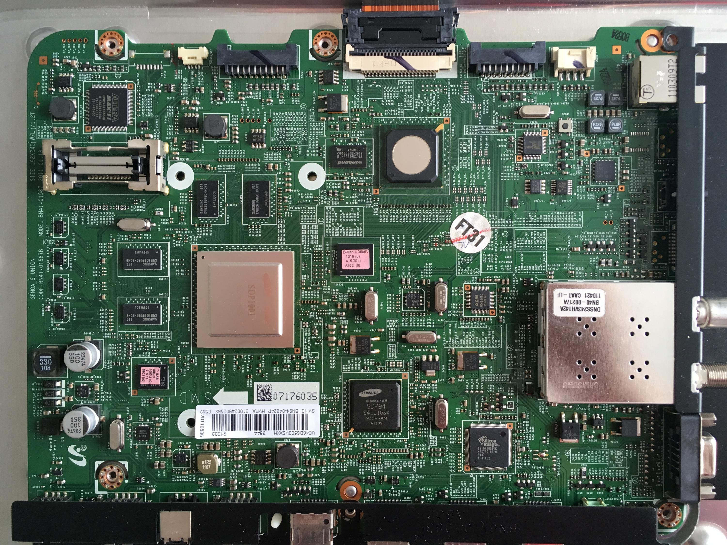

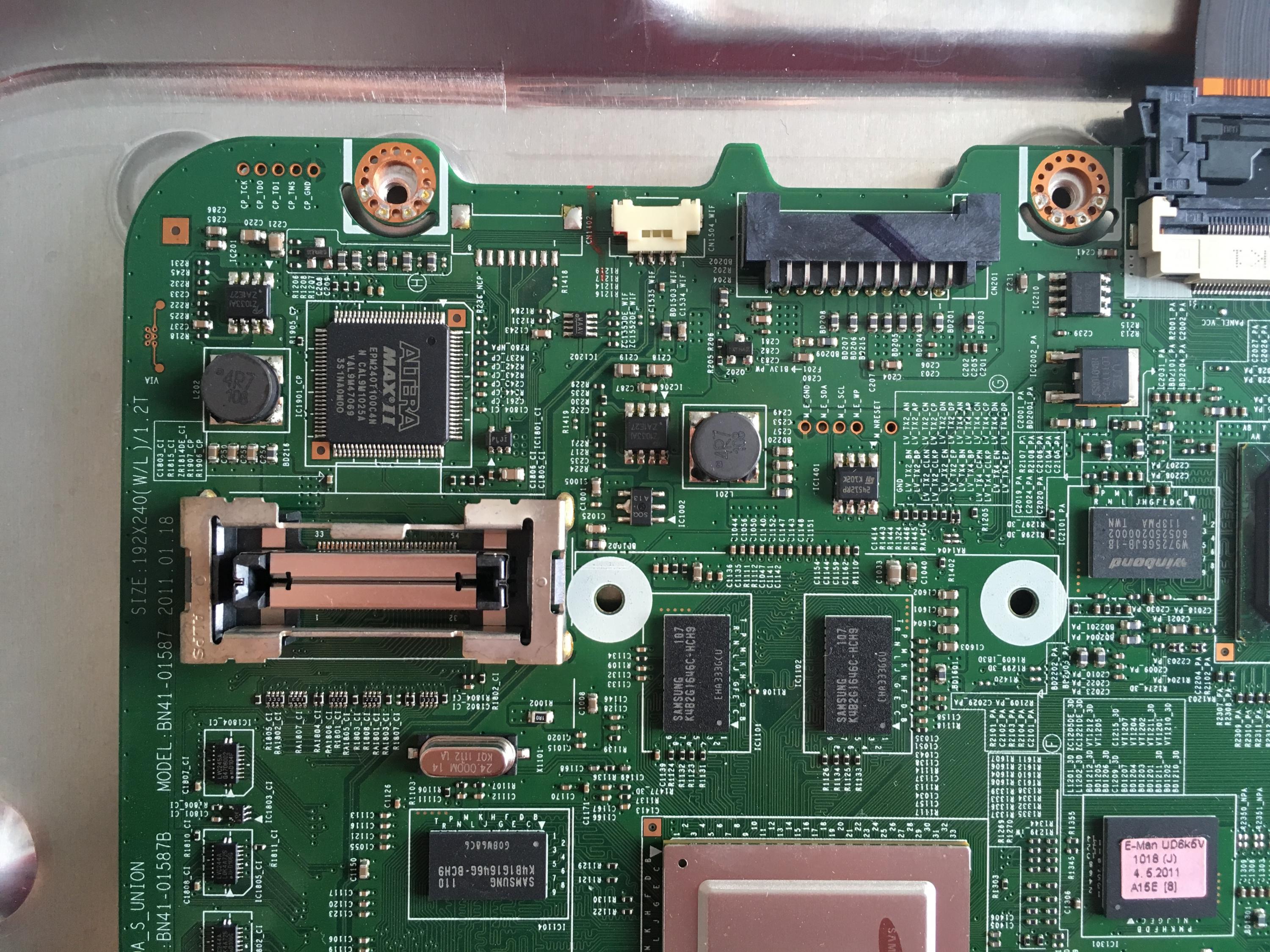

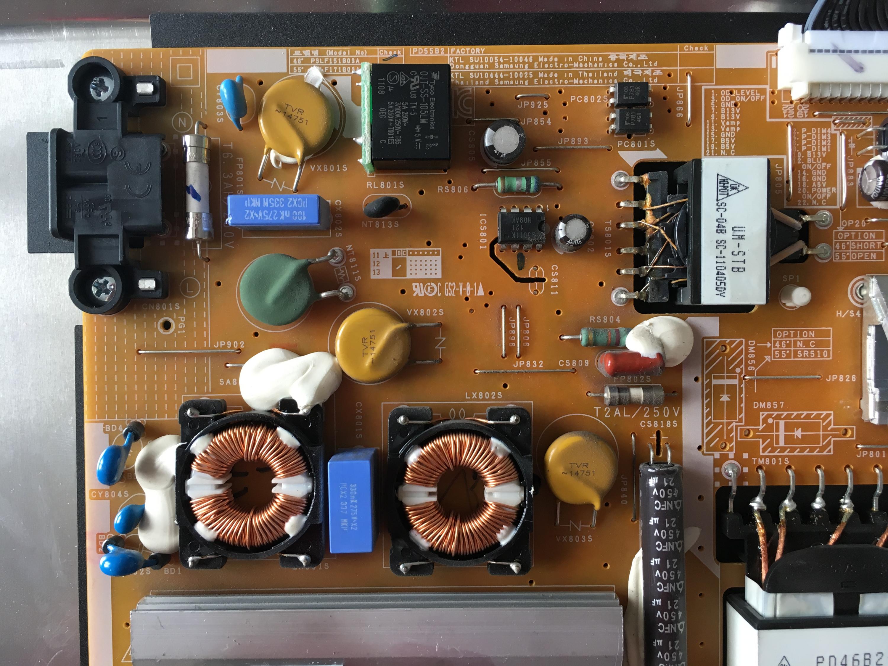

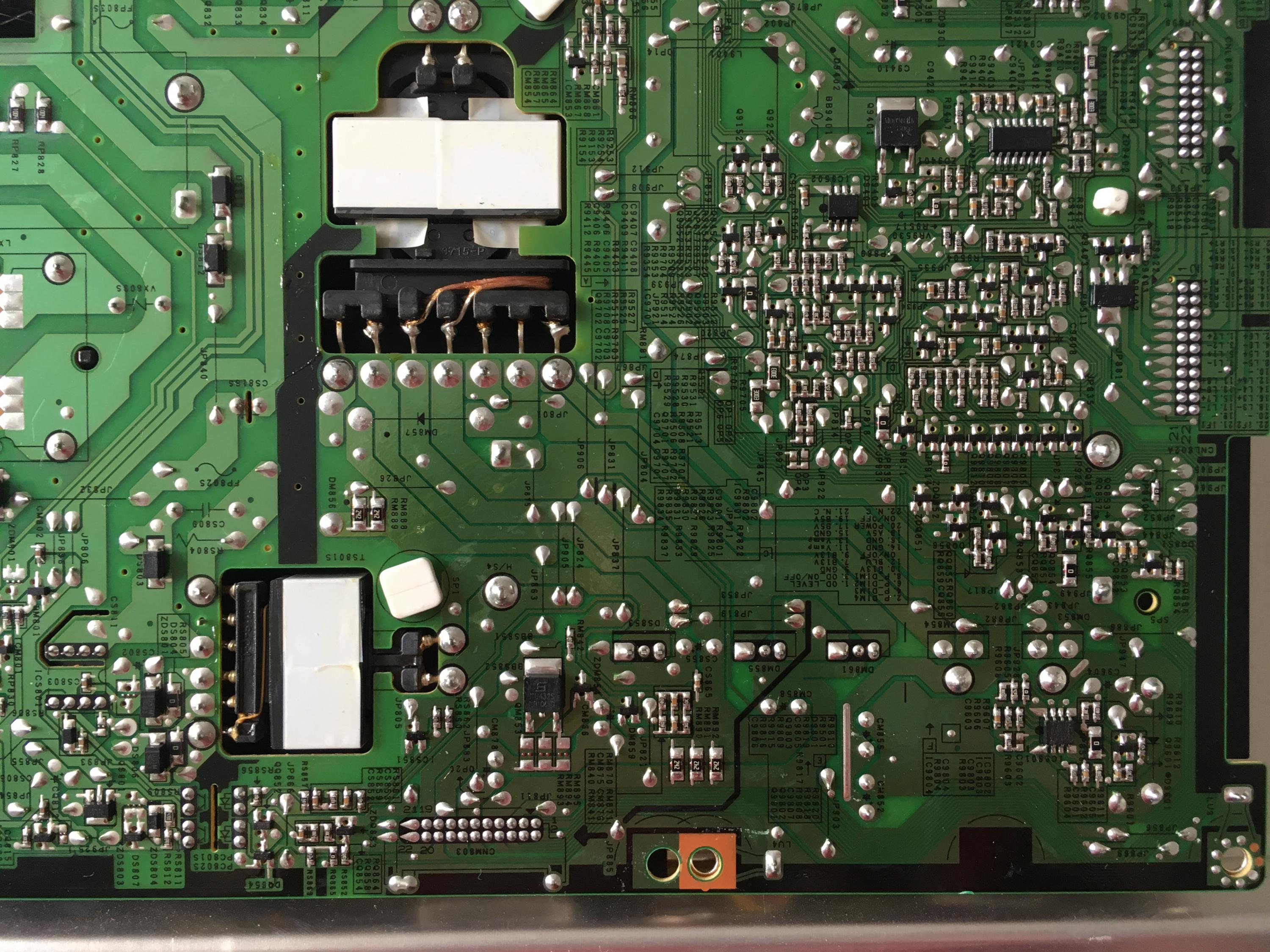

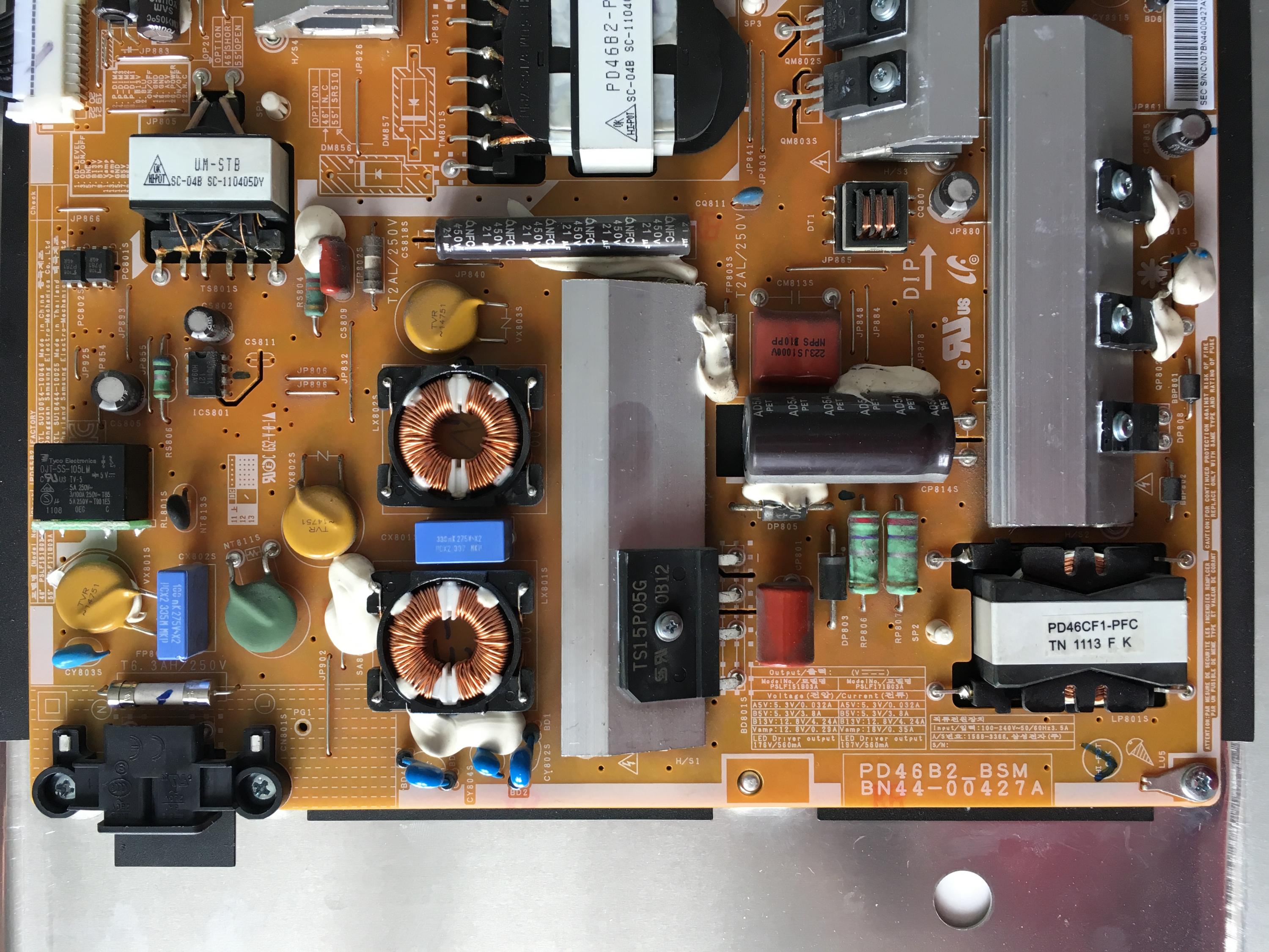

                        • MANNOFSTEEL
                          • Dec 2019
                          • 2

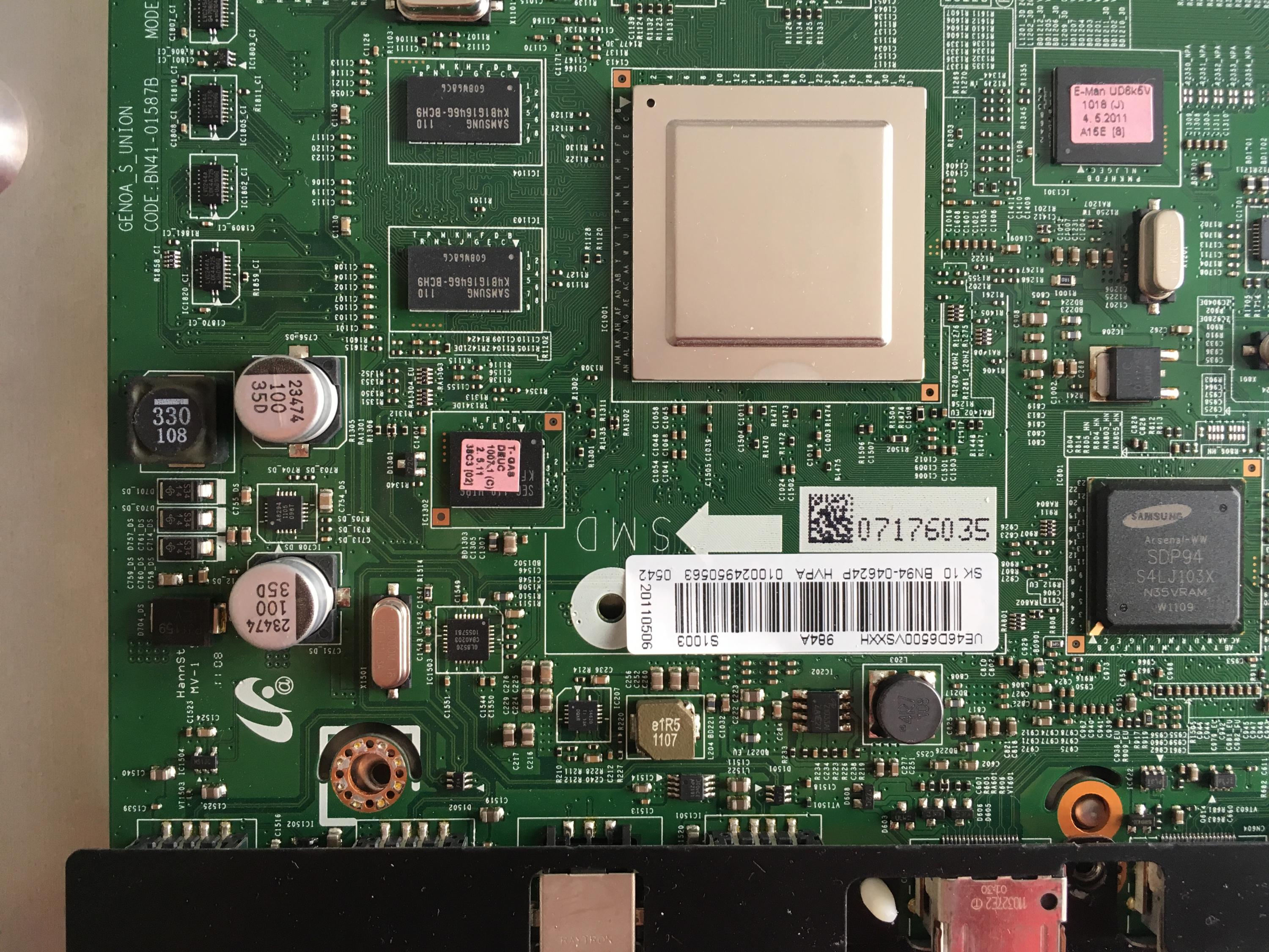

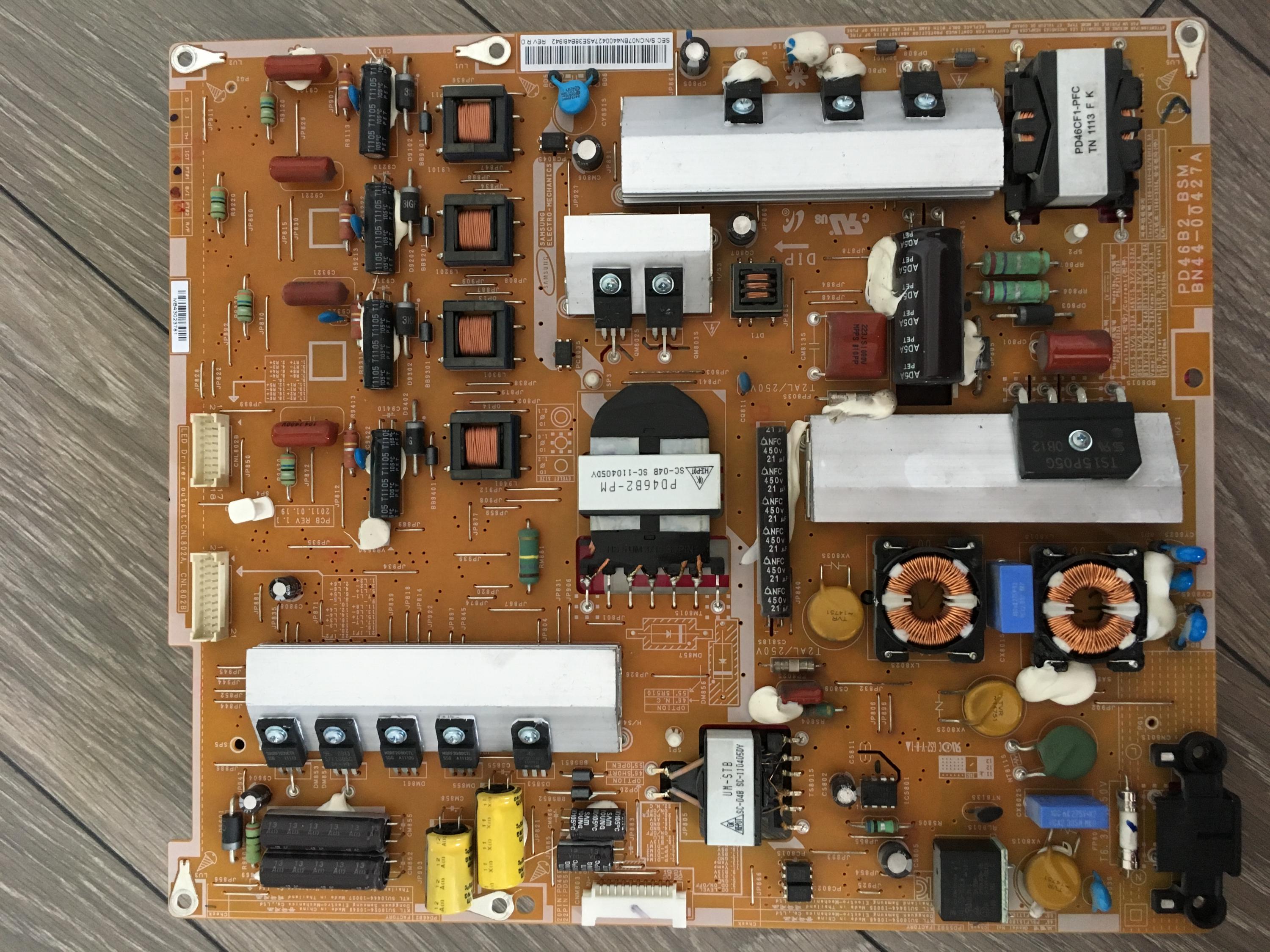

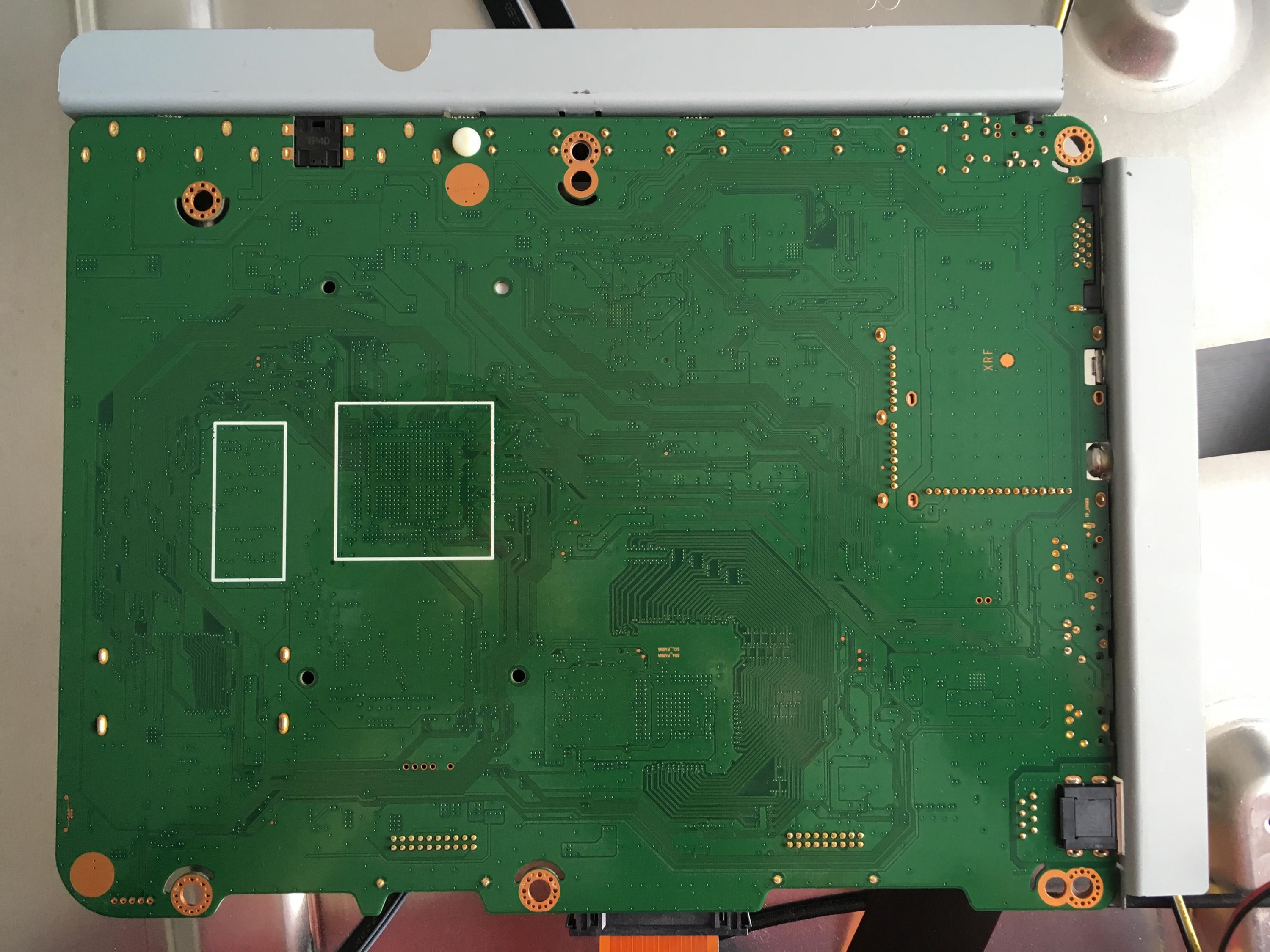

                          can you post a pic of the mainboard ( back)

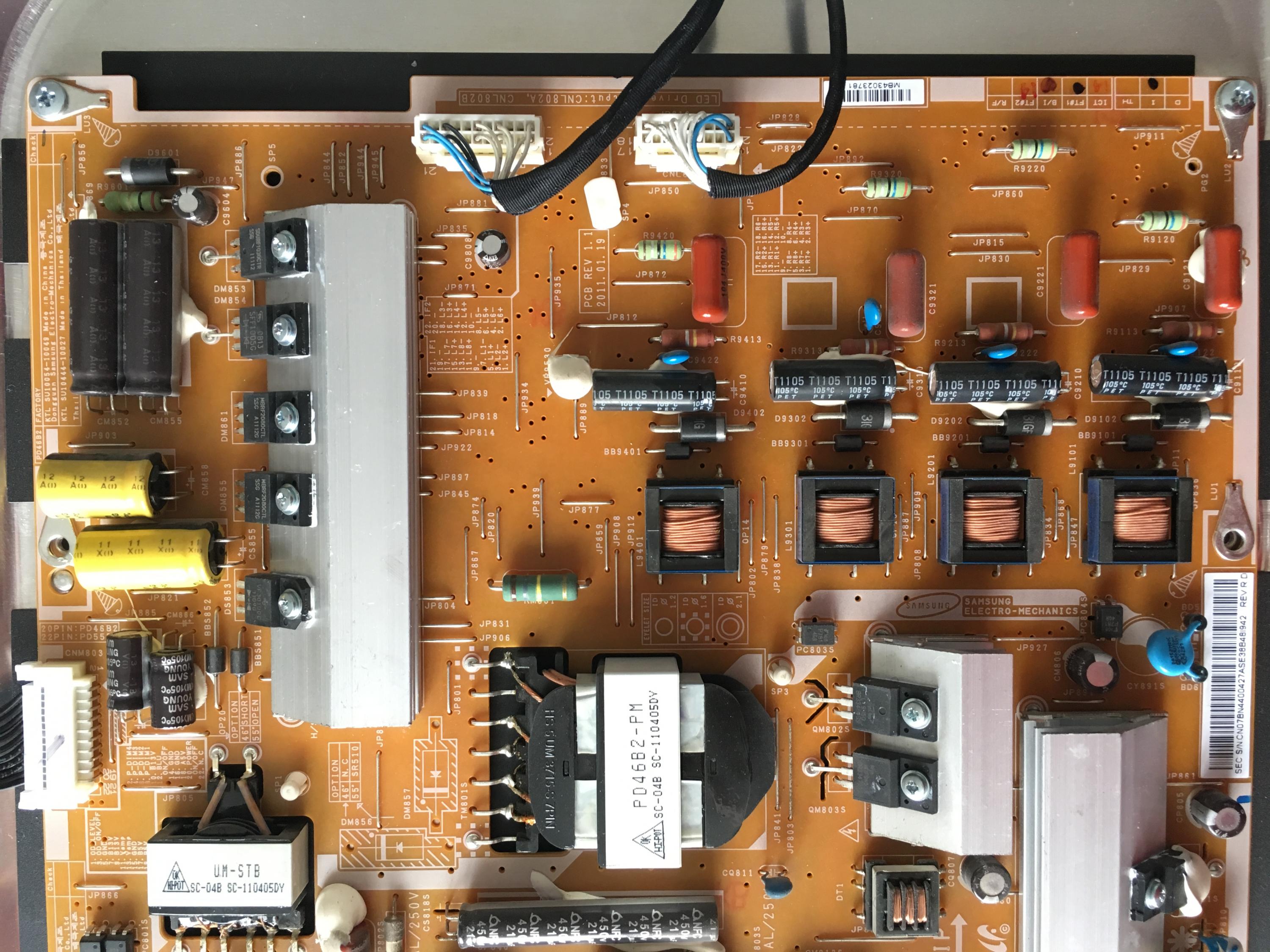

                            Can we see good clear pictures of the whole backside of the TV showing all the boards?
                            18 A5V 5.4V - constant
                            20 POWER Either 0.25 or 3.3V with the cycle Right now the standby power supply is steady but the main board is not sending out solid HI command signal (PS-ON/POWER) to turn on the rest of the power supply.
                            • voxahbc
                              • Mar 2020
                              • 10
                              • Turkey

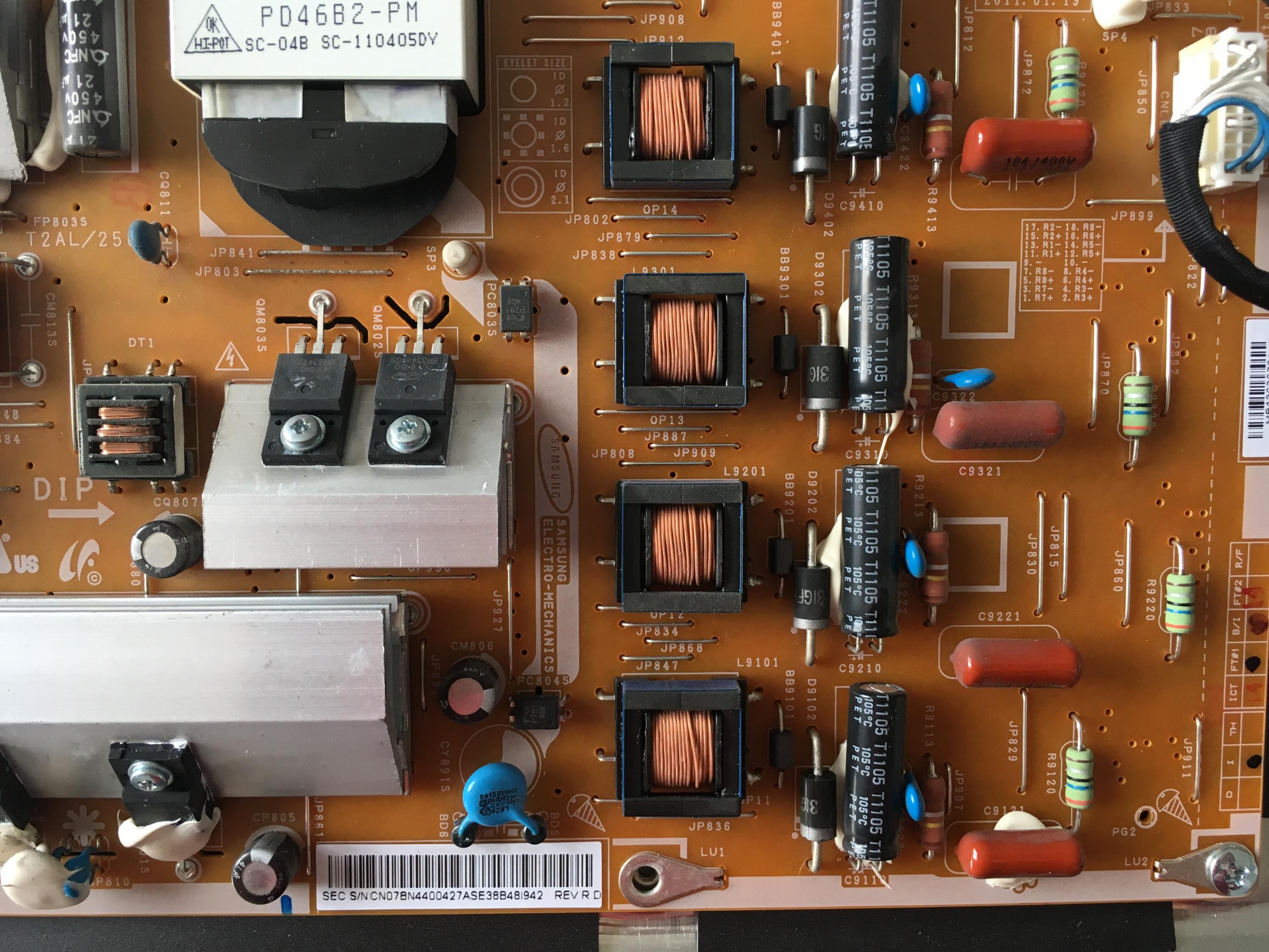

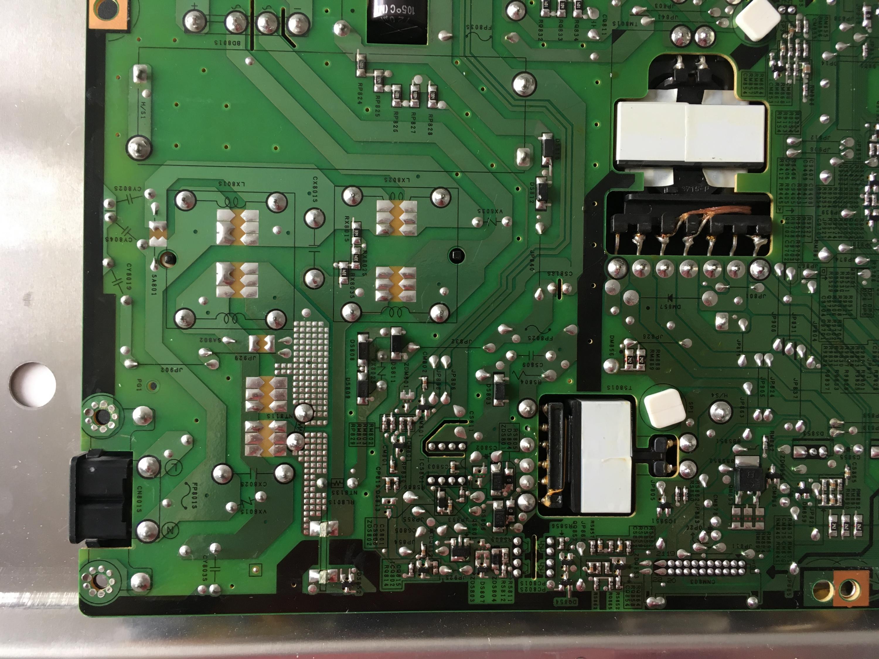

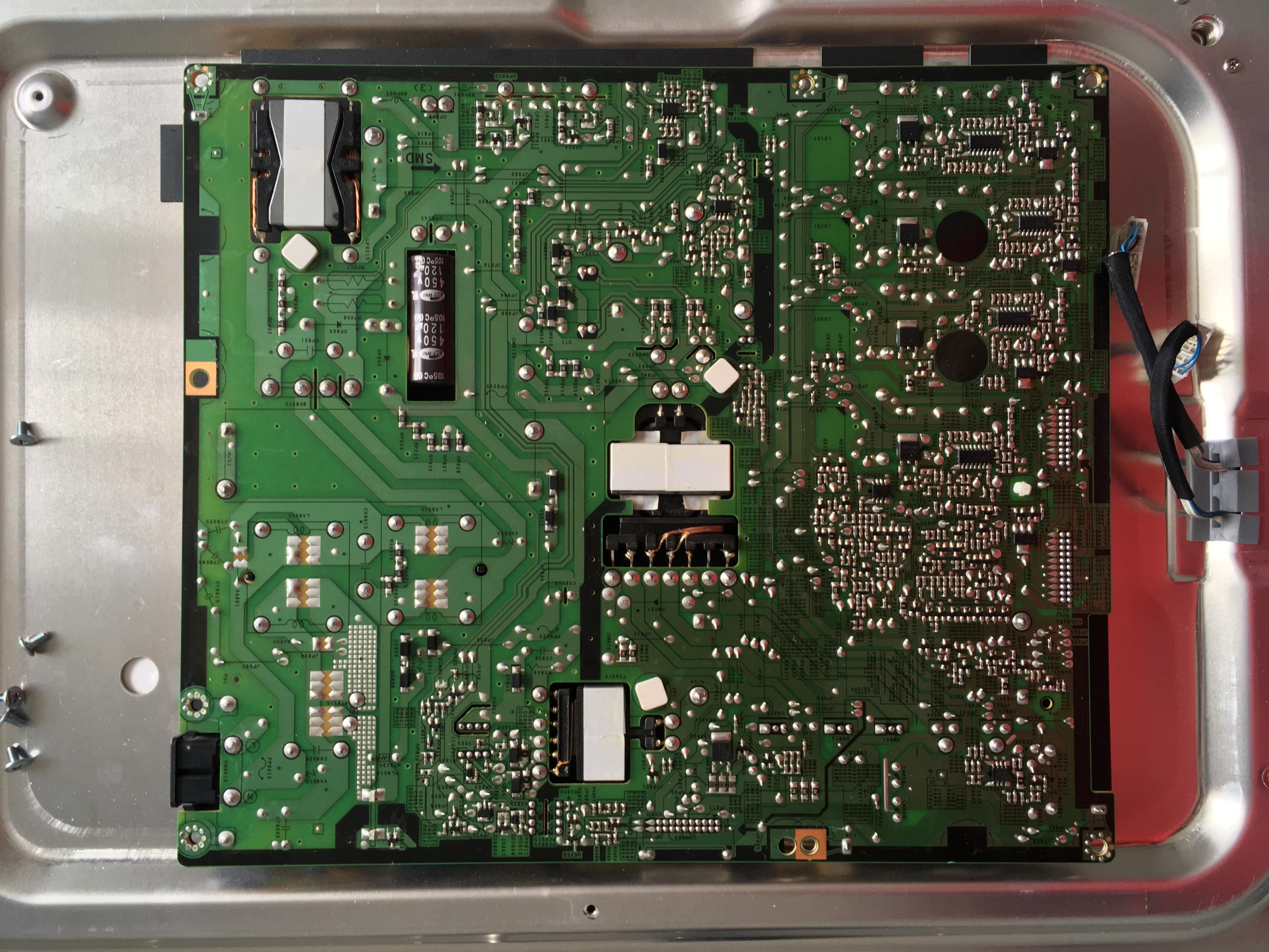

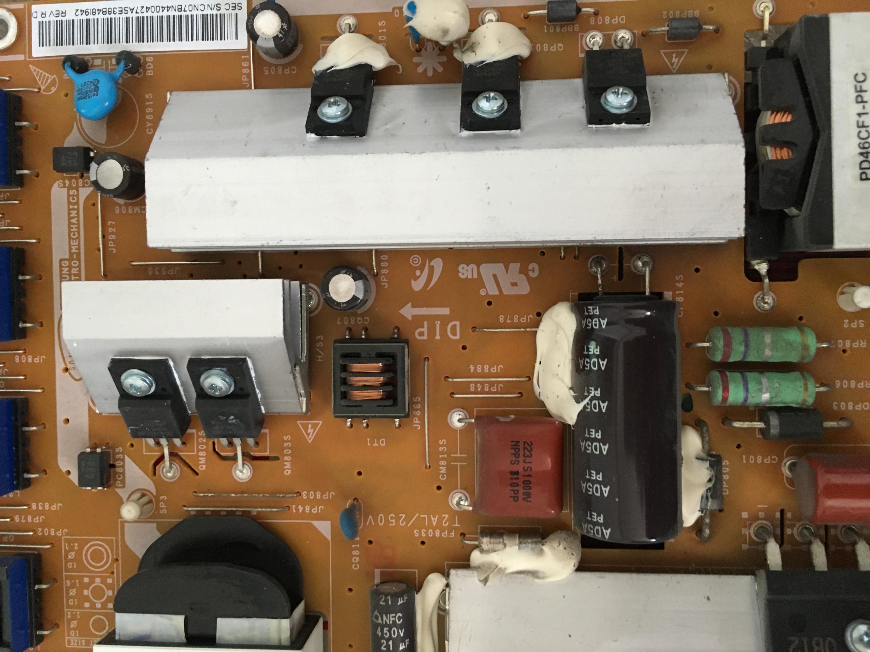

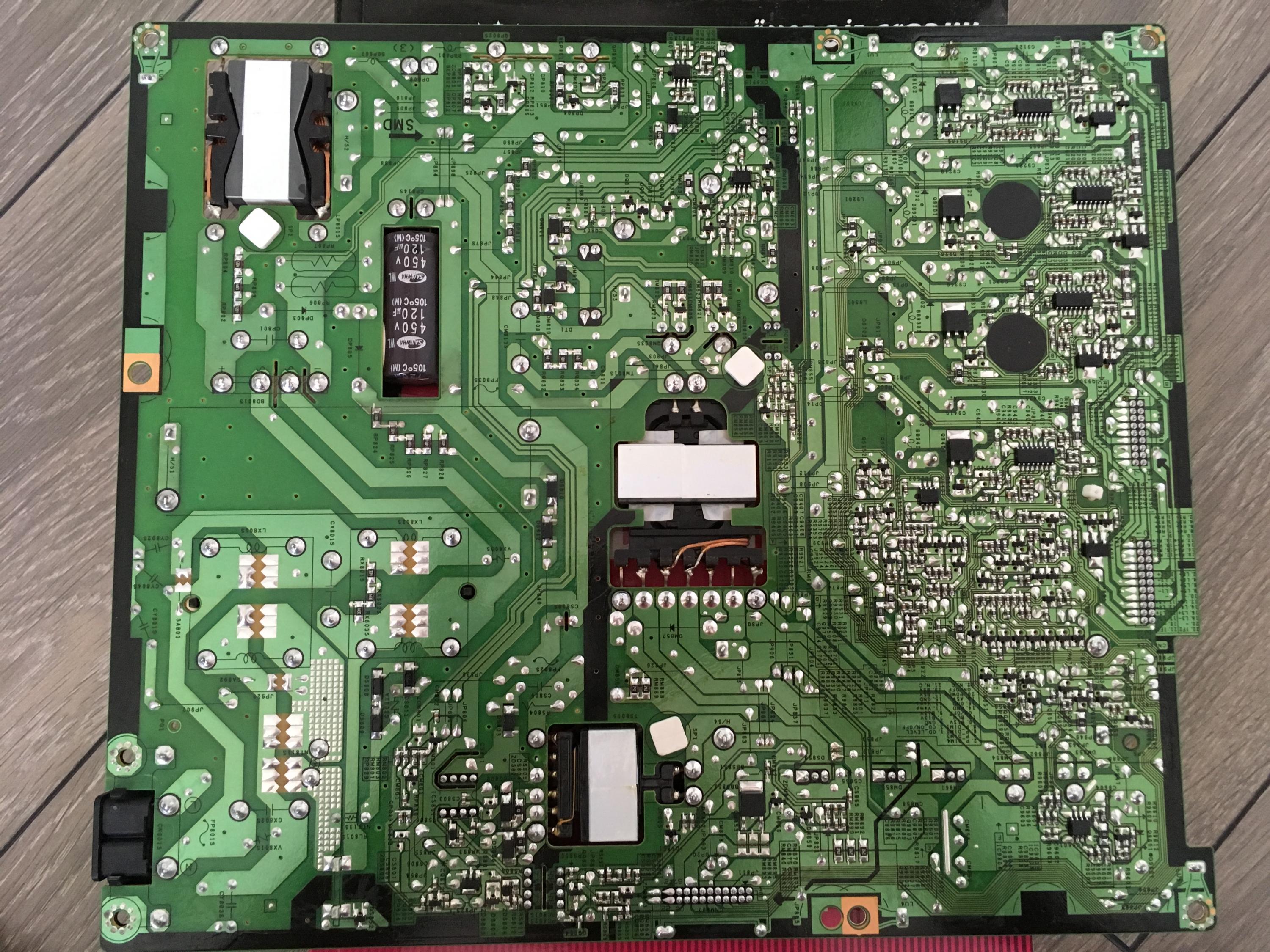

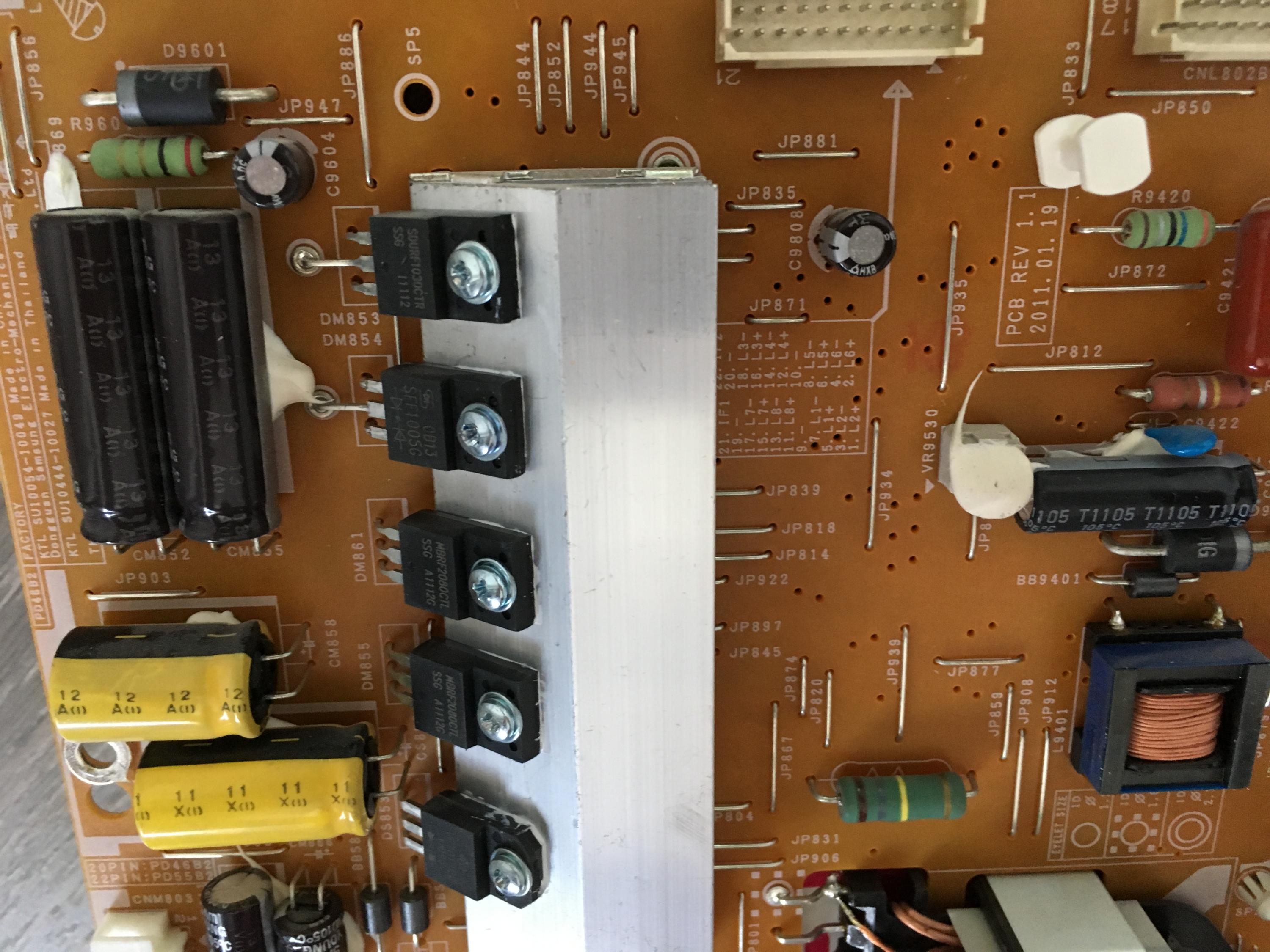

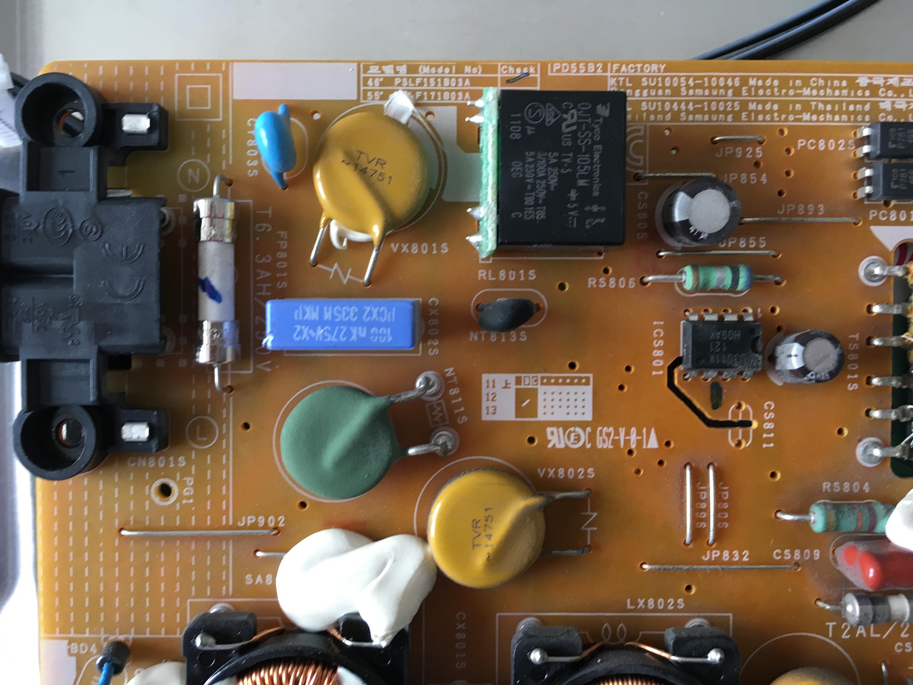

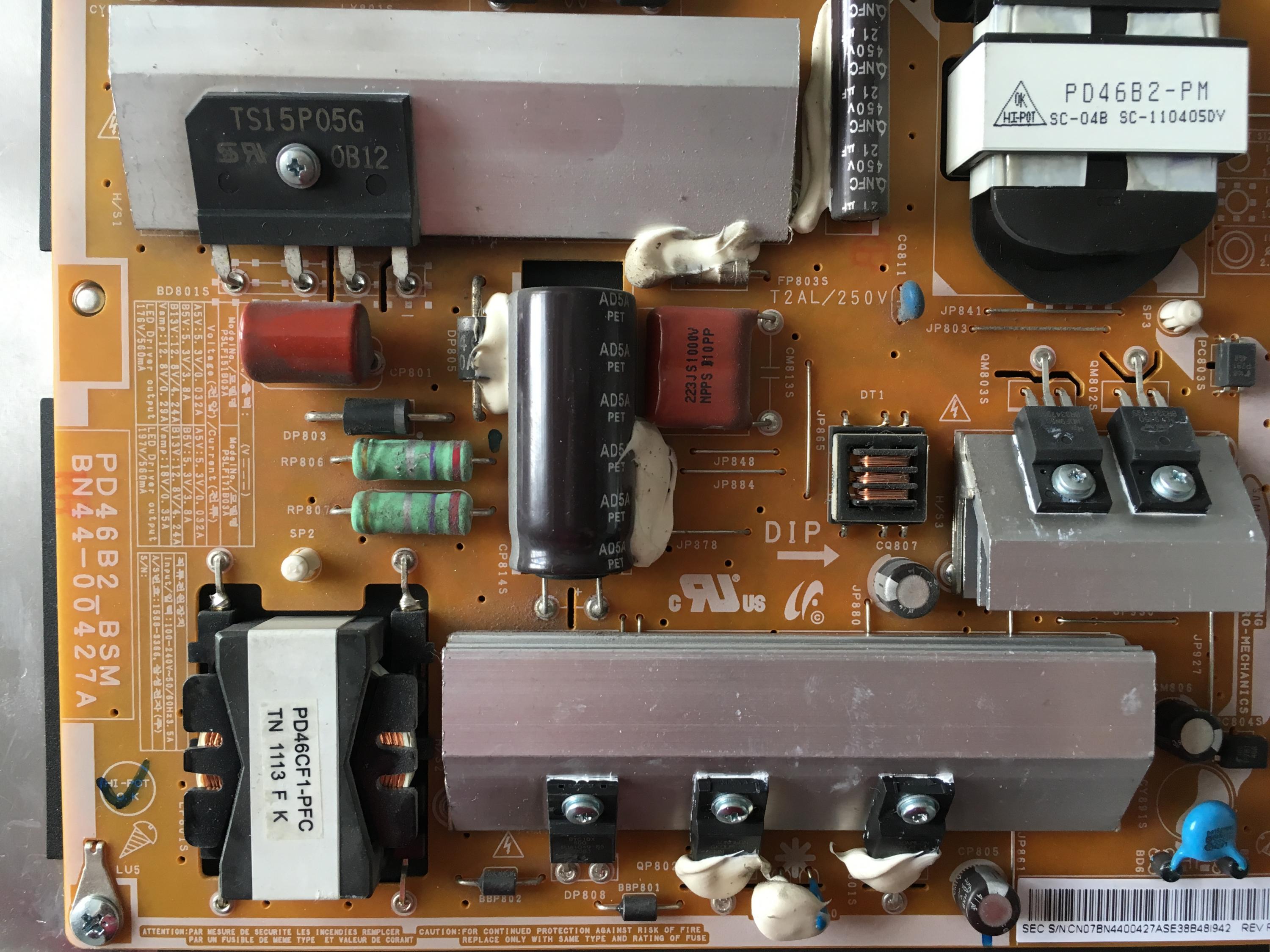

                              Thhanks for replies again. I'm sending detailed photos of all the boards.

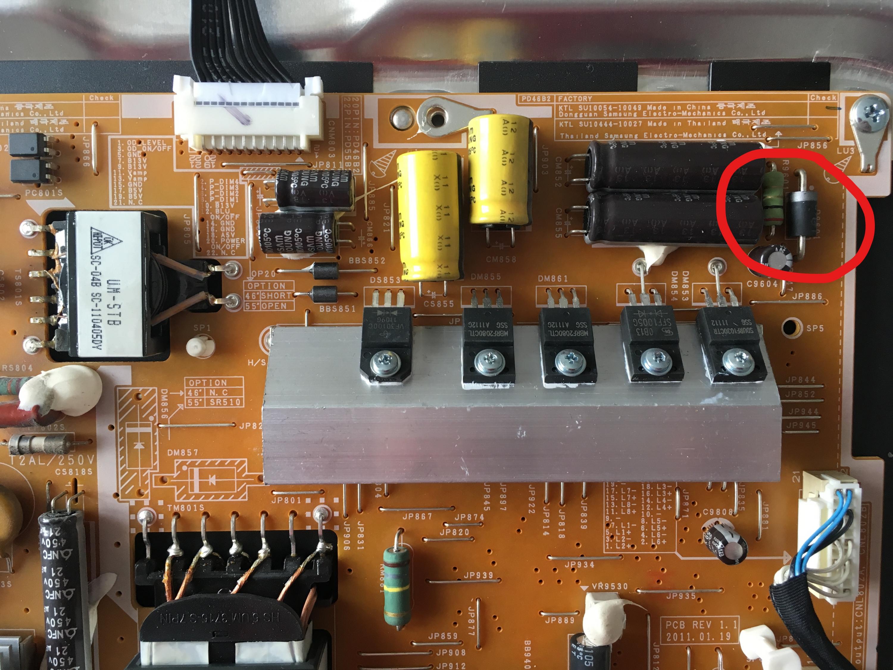

                                Well did you check al the diodes per post #10??

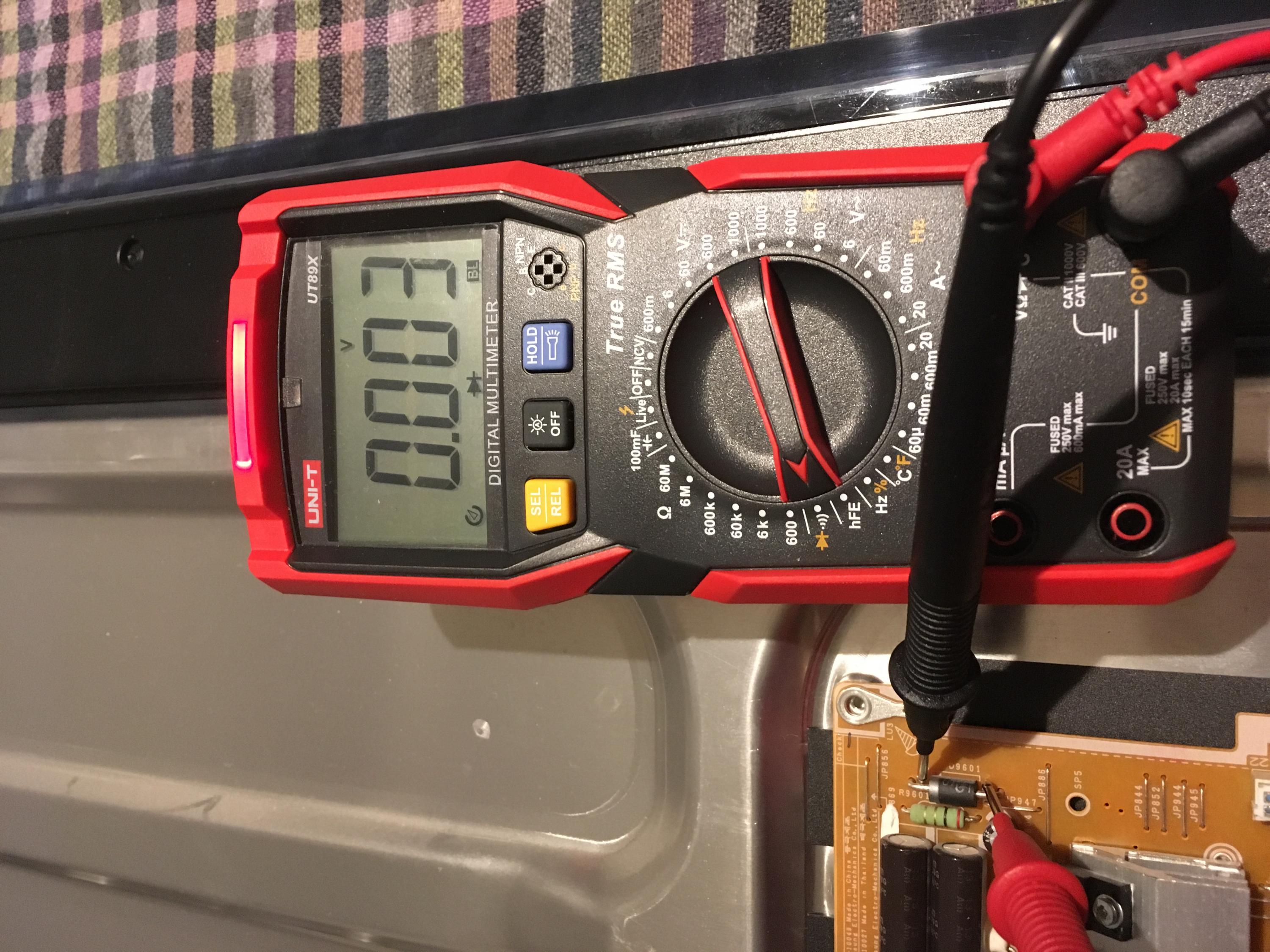

                                • voxahbc
                                  • Mar 2020
                                  • 10
                                  • Turkey
                                  I just did. I got a bad diode shorted. It blinks red on the multimeter either way. The others passed the diode test.
                                  • nomoresonys
                                    • Jan 2013
                                    • 12331
                                    • U.S.
                                    Ok, easy way to verify is just clip a leg in the middle so it will be easy to re-solder if it's ok and retest out of circuit.
                                      The diode D9601 tested bad in the circuit because it is connected in parallel with LOW Ohms resistor R960, you can look at the bottom side of the board to see how the Diode and the resistor are connected together.
                                      Samsung BN44-00427A
                                      https://www.shopjimmy.com/samsung-bn...pply-unit.htm#
                                      BTW, we never get to see what Voltages you have (you power up just the power supply board) on the power supply connector when the connector from the power supply NOT connected to the main board.

                                        Have seen lots of main board issues with the D series. Try freezing the NAND with upside can of duster and see if it turns on.
