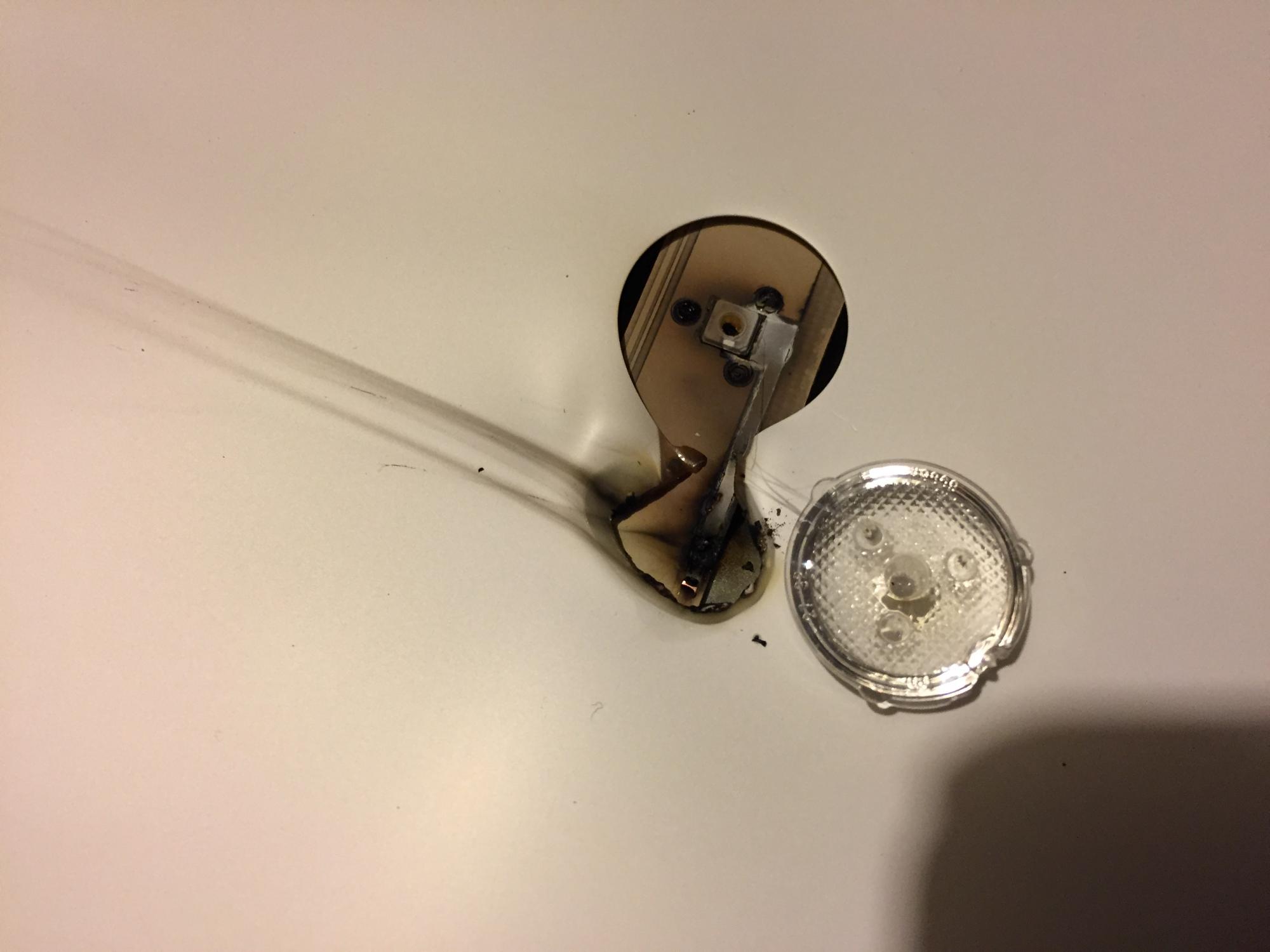

                    Finally got in there and it was like everyone said. It kind of looked pretty much like neilc6's photos. Many shorted and open leds. Will order new strips today from SJ. While waiting I want to trace out those strips back to the pins as it is not readily visible to me about which strings are in series which each other. Their are 9 rows of 16 leds. There were 2 rows which were working and all the others were totally out or a few lit here and there. Will be back in a few days. Thanks.
