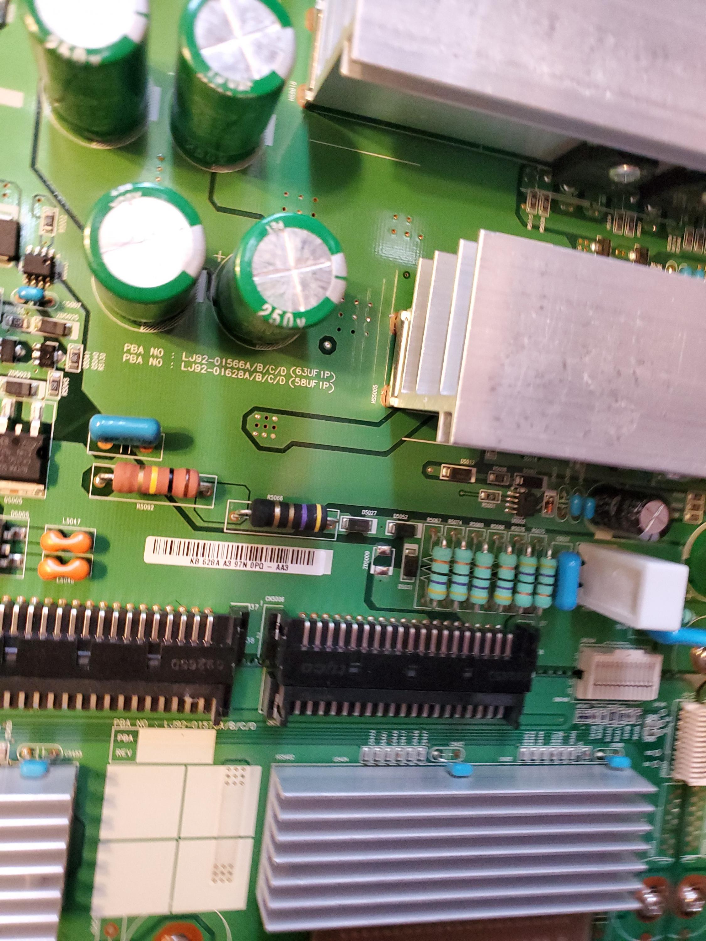

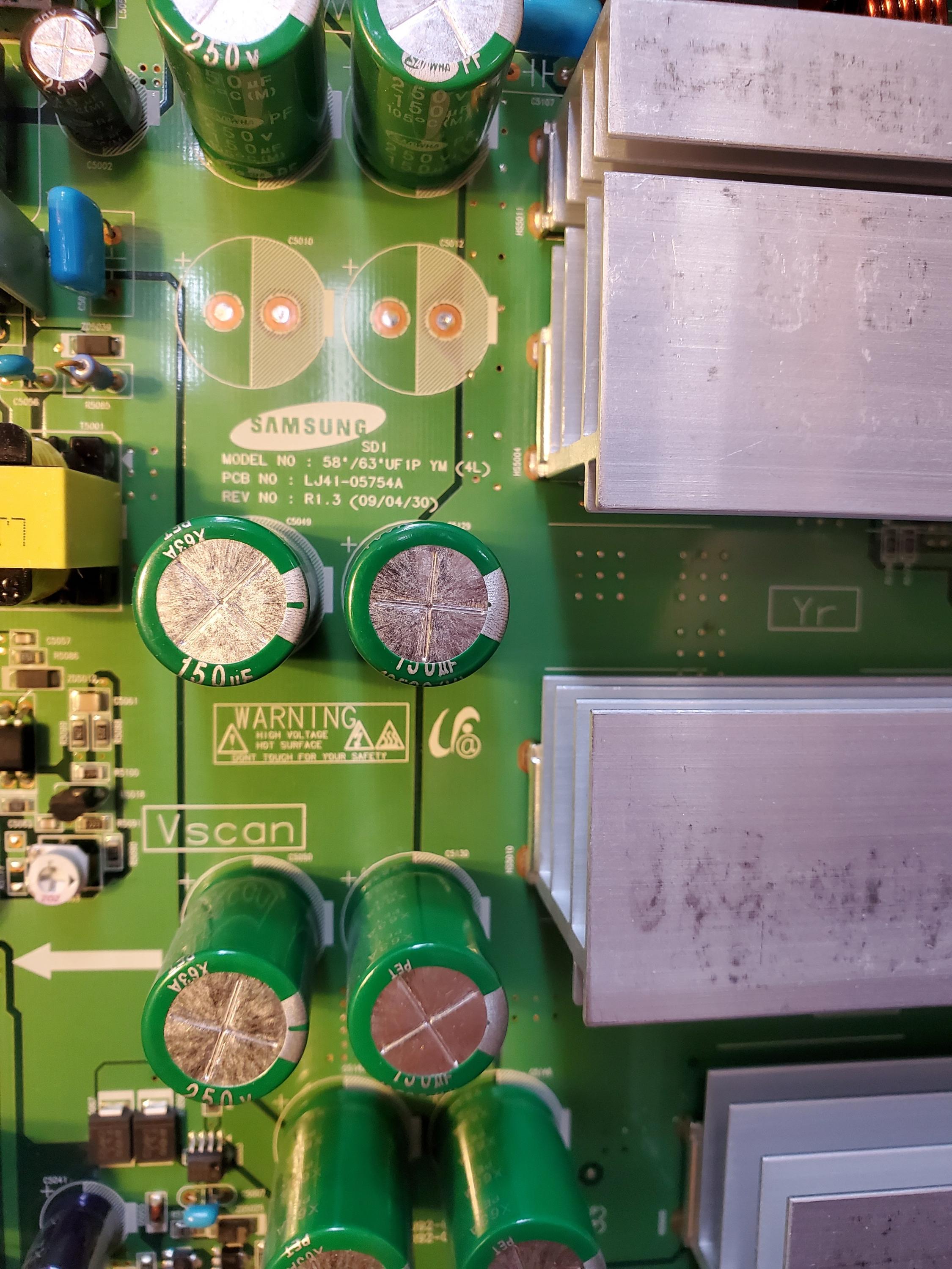

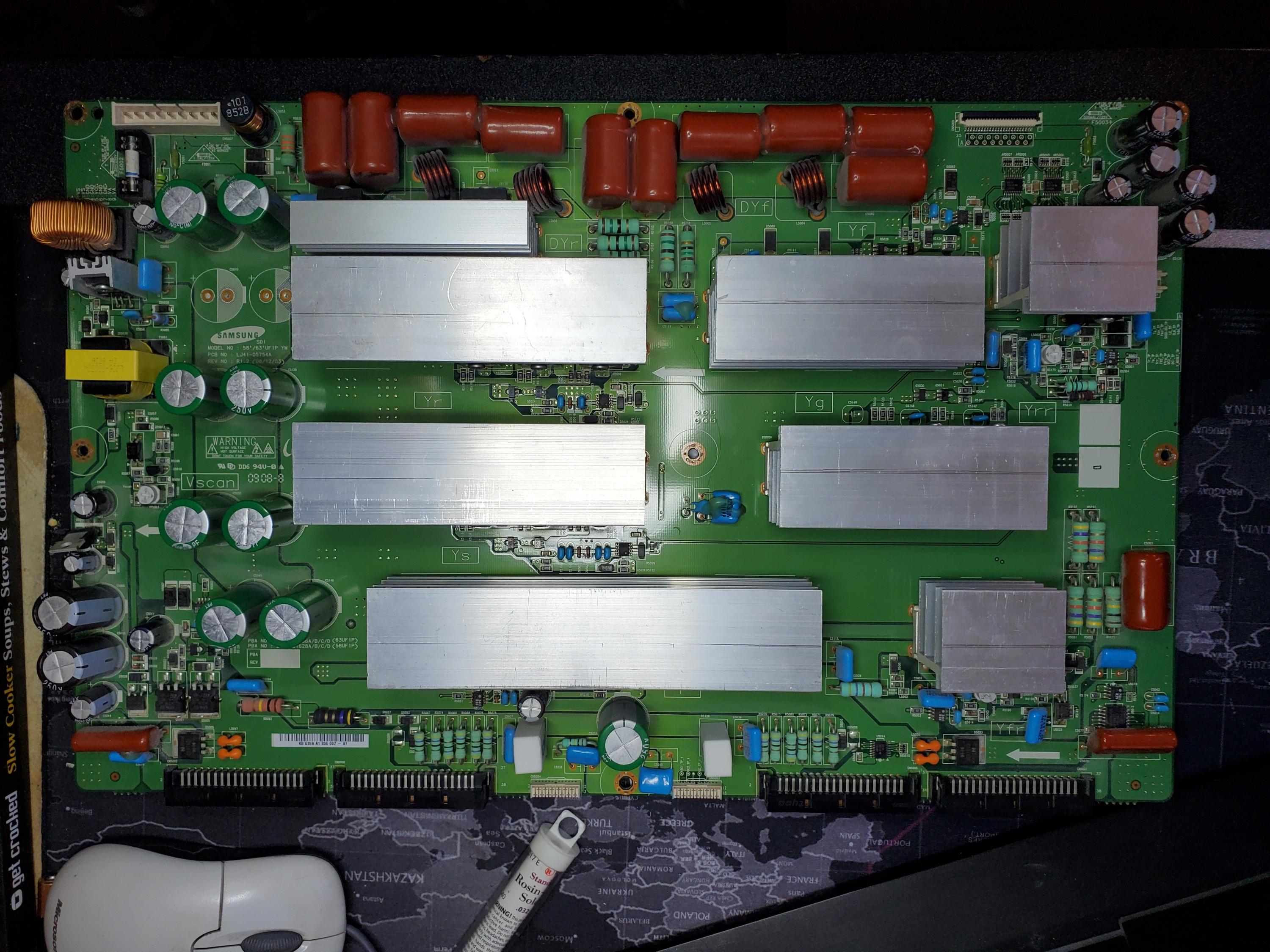

      Re: Samsung PN58B650S1FXZA Plasma
      Guys,
      Problem...Looking for Suggestions...
      New board came in the box very well packaged etc looks identical to the old. Very clean as expected...does not look like its been ran etc....looks as advertised as new-old-stock...I am able to send this back.
      Plugged it all in and did a power up from the front panel...the ring of the Samsung sound at startup was heard but no picure. I can turn the set on and off from the control panel and each time the sound is heard. I have plugged in a BluRay by way of HDMI and did the input selection on set (no video or menu on set is displayed so doing this by ear). Finally after a few selections presses I heard sound from the BluRay movie playing but still no video.
      I have double checked connections... including the removing and applying the TCon ribbon connection to the Y Sustain(Main) but still nothing.
      I do see the flashing LED (LED2000) on the TCON just as it was before with the old Y-Sustain board...Is that normal?
      There is 203 Volts on both sides of the removalable Fuse on the Y Sustain (Unlike the old Y Sustain (Main) Board). VS and VA at the cable to the YMAin are the same as before 203 for VS and 55 for VA. Also probing different spots on Y-buffer shows Voltage is out there on the Y Buffers.
      I have included some pics of old and new...The single board pic is the old...I did see one difference between the board (which was not mentioned in the sale)...one says rev 1.2 and the other is 1.3 and the date difference are about a month apart...Could that be the issue...as I said previously I can send it back...Is there a way to test that the panel is good now that there is no revolving click from the PSU as before (Single Color Screen or just a way to confirm)?
      As mentioned previously the Y Buffers tested good.
      I see voltage on the TCON connectors - VS_ON of 3.3, nothing on PS_ON, and the 5.3 Volt label lines both have 5.3 on them.
      Ideas?
      Thanks Again everyone.
      Chris

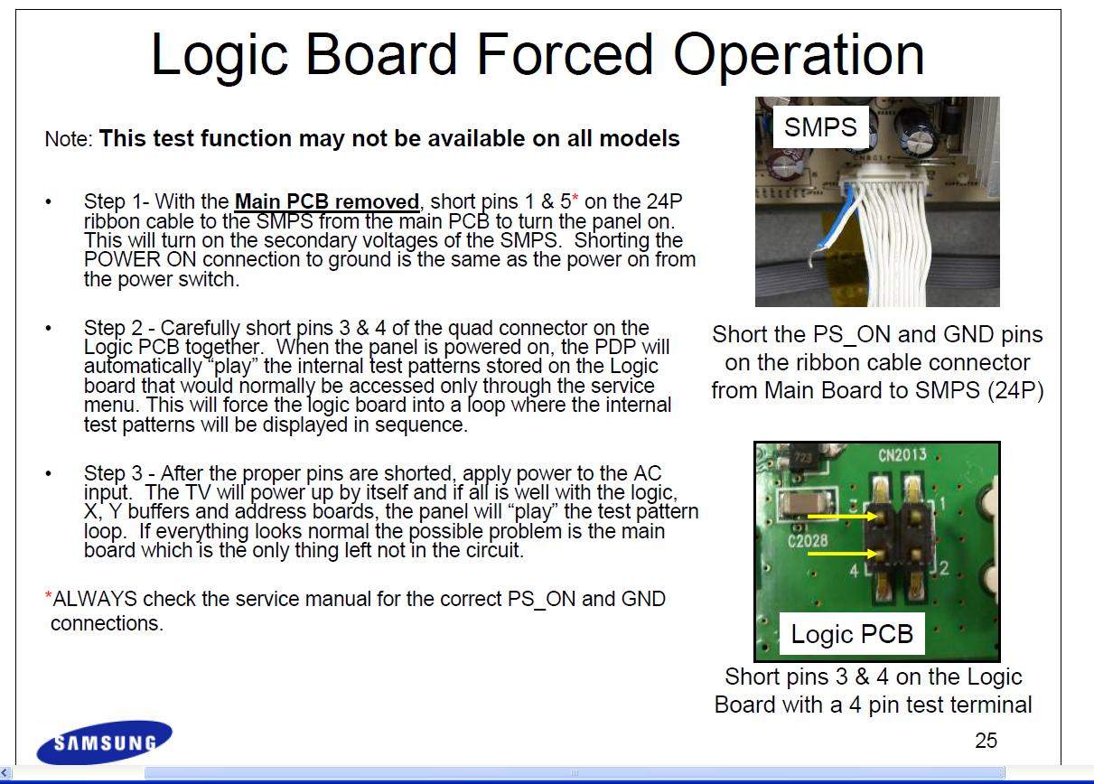

        Have you tried to run the test pattern with mainboard disconnected and jumper placed on the control board in the event that you may have a mainboard fault?

            Post a photo of your control board.
            instructions here https://www.badcaps.net/forum/showthread.php?t=26790

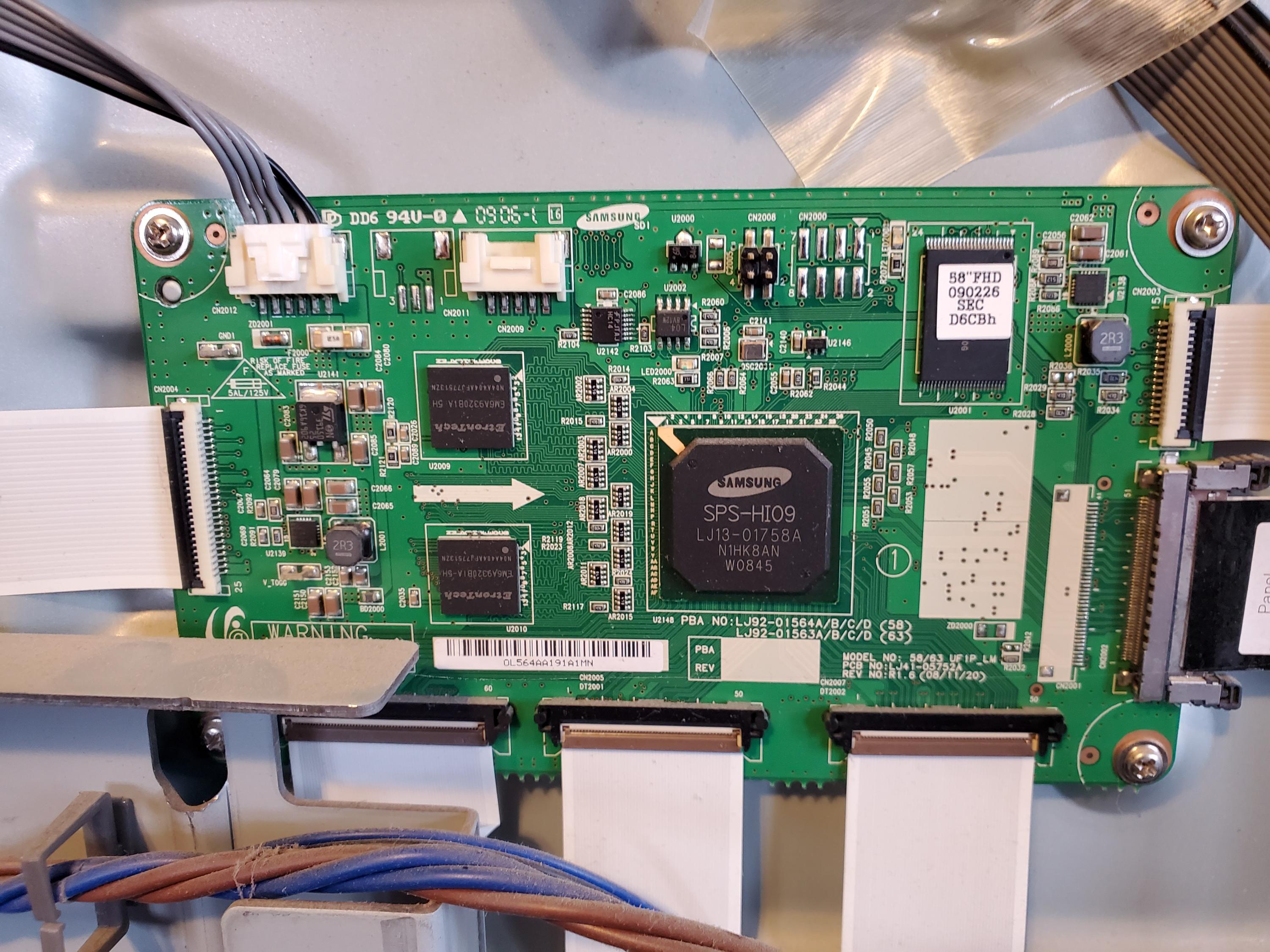

                With the Corona Virus Lock down thats been called for my state about 40 minutes ago...may be sporadic/longer time between my posts...I have to run to in-laws and care for family needs (move freezer) but I am watching my phone and will try and respond as fast as I can.
                I have included a pic of the T-Con...and will try and watch the videos...

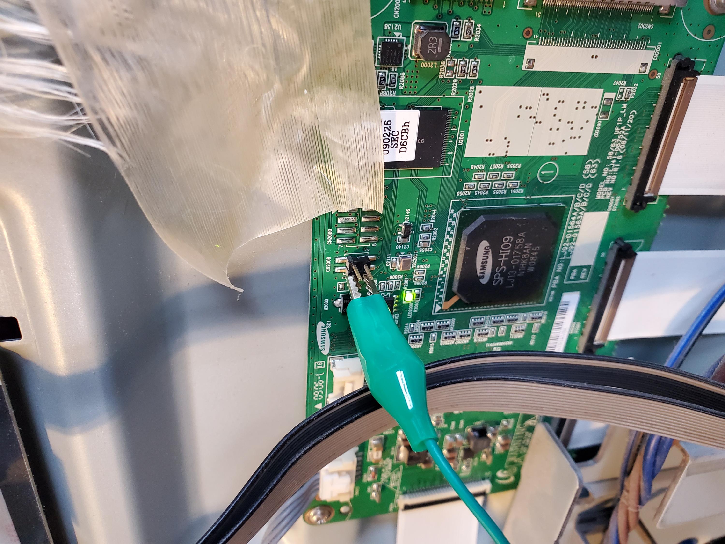

                  • tvtimmy
                    • Mar 2015
                    • 1160
                    • usa
                    #29
                    Try the test patterns.
                    • SolomonMan
                      • Apr 2019
                      • 206
                      #30
                      Tvtimmy/All,
                      With Power Cable unplugged (setting the whole night unplugged);
                      I unplugged the SMPS connector to the main board and crossed PS_ON two pins over to one of the GND pin connectors. I used a LED leg that was cut from the light/LED to short.
                      Plugged power back in...heard a single click from the PSU board.
                      Removed the LVDS Cable from the Logic Board.
                      Shorted Pins 3 and 4 on TCON with a Alligator clip.(Left 2)
                      Screen black no life. (No Power up as before in screen)
                      Shorted the top pins on TCON like in the video. (Pins 1 and 3)...there was a discrepancy in video and my units pin numbering.
                      I assume this points to a failure?
                      Chris

                              You did'nt do the test correctly, Pins 3&4 on the control board need to be shorted BEFORE power is applied, not after.

                                #35
                                All,
                                Thanks for the responses once again!
                                I have reconnected everything again and tested as before and received the same results. (when the TV is back to the state of original Assembly)
                                I then did the test pattern test again (As I Described above)...I have included some pics of my process...Am I missing something?
                                Power is reapplied at the end..exactly the same as the video mentions previously.
                                The video basically has you power the TV down, short the ps_on to a ground pin and then shows the PSU relay click after you apply the Wall Outlet power to the set. Then the video has you turn the set off (remove wall power) and has you short the pins 3 & 4 together on the TCON and then apply the Wall Outlet again.
                                I do not see test patterns on the screen...Voltages are simlar regardless of test pattern attempt or original state.
                                The LED 2000 Light is still flashing about 1 a second in both cases.
                                Could this be a Logic board issue?...Why no test pattern?
                                Chris

                                      #38
                                      Guys,
                                      Thanks again for the help!
                                      I have read and reread the test pattern process.
                                      1) I have turned off the power to the TV (pulled the plug).
                                      2) I removed the Main PCB Power (24P) from the Main board.
                                      3) I have shorted pins 1 and 5 (24Pin connector PS_ON pin to Ground pin).
                                      4) On the Logic Board (TCON) I located a jumper shorter (like they use on hard drives etc) and shorted 3 & 4 pins properly.
                                      Upon adding power to the TV (AC Plug)
                                      I here the faint PSU click and there is voltage as required for the Panel at this point at the boards (Ve,Vs,Vscan,Va).
                                      Still nothing appears on the panel.
                                      I then have tried with everything to the Main Board Disconnected (board out-(Shorted PS_ON to GND).), Everything connected to the Main Board (including 24P - no short PS_ON to GND), and every disconnected but Power to the 24P connector (Shorted PS_ON to GND).
                                      Same result no life in Panel.
                                      Is there a way to test to see whats not actually working...my novice feeling is its something in the panel (Bad Panel)...or somehow the TCON is not doing its job. Looking for ideas...Keep in mind I do have a Scope (Rigol DS1054z upgraded)...no experience with scope but if that would help...I am game.
                                      Thanks again,
                                      Chris
