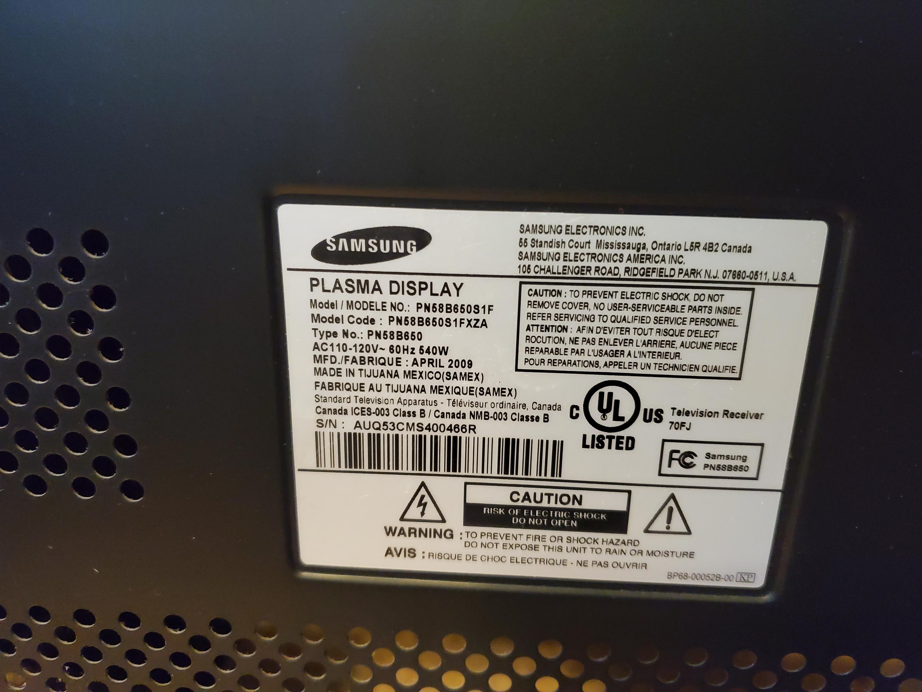

    Guys,
    I swore off Plasma TVs after my last Samsung Plasma failure $$...but this one found its way home by way of a Nordic Track CR2050 my wife was wanting on Craigslist...it was also real close to my home (I live in the sticks).
    Anyways I was told they were watching it one day and it clicked/popped off. They wrapped it in blankets and put it in there nice and Clean Empty garage in the hopes of fixing it and ended up buying something bigger.
    Got it home plugged it in...no remote but it seems to have a touch pad front on the right side.
    Anyways touched the touch area on front and there is sound (music) when turning on.

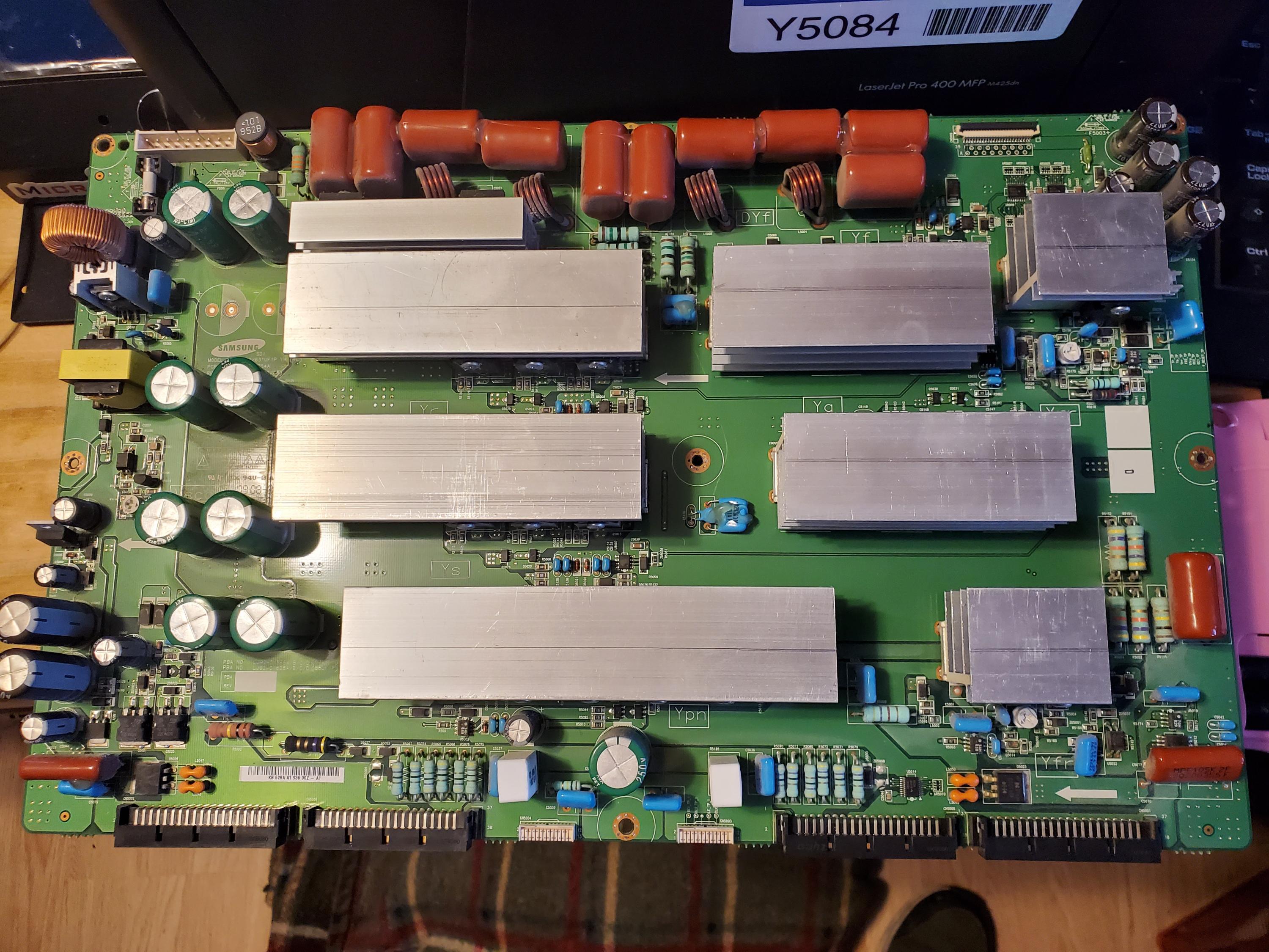

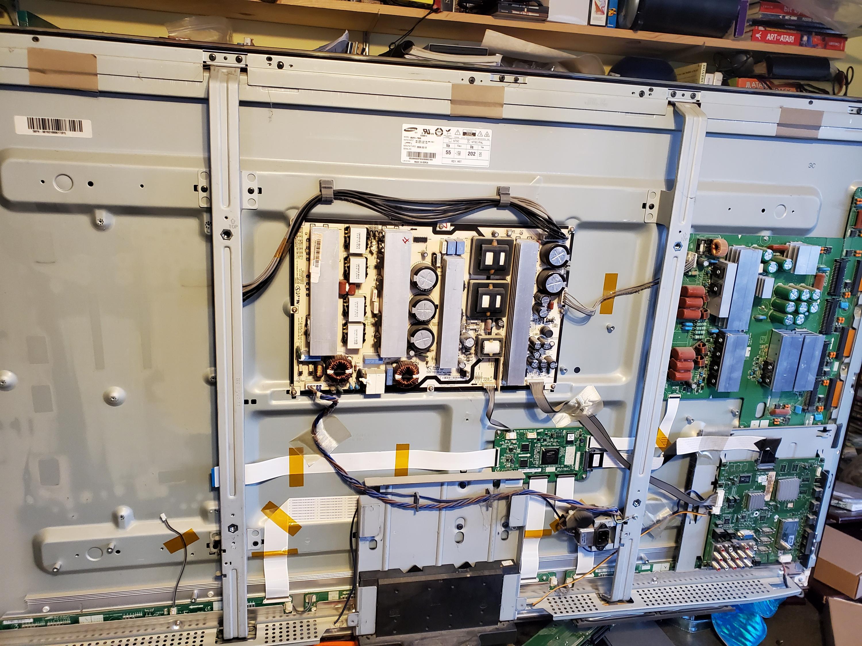

    Started testing fuses found the Y Main board (I believe) with a fuse blown.
    Voltages test at VS 202 and VA 55.
    Put in a fuse and once fuse is in the PSU started cycling no startup music. So I remove the Buffer Boards...Still PSU cycles with the Y Main installed - No Music. Unhooked the Ymain and the PSU stops cycling and does the sound start up thing....So I am thinking the failure is in the YMain?...

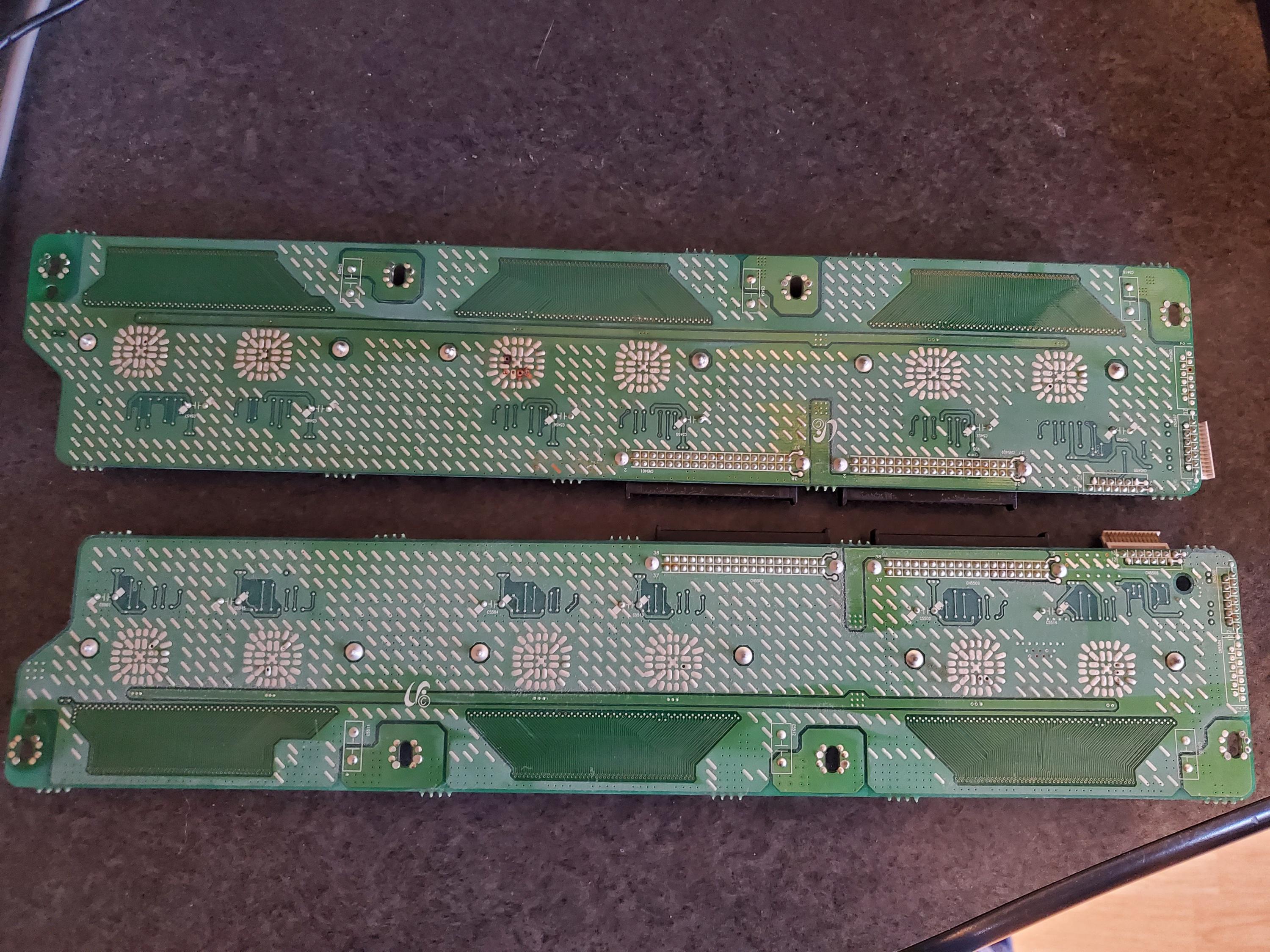

    No visible signs of failure except the solder point on some of Mosfets seem very dull on the YMain...bad solder joints?

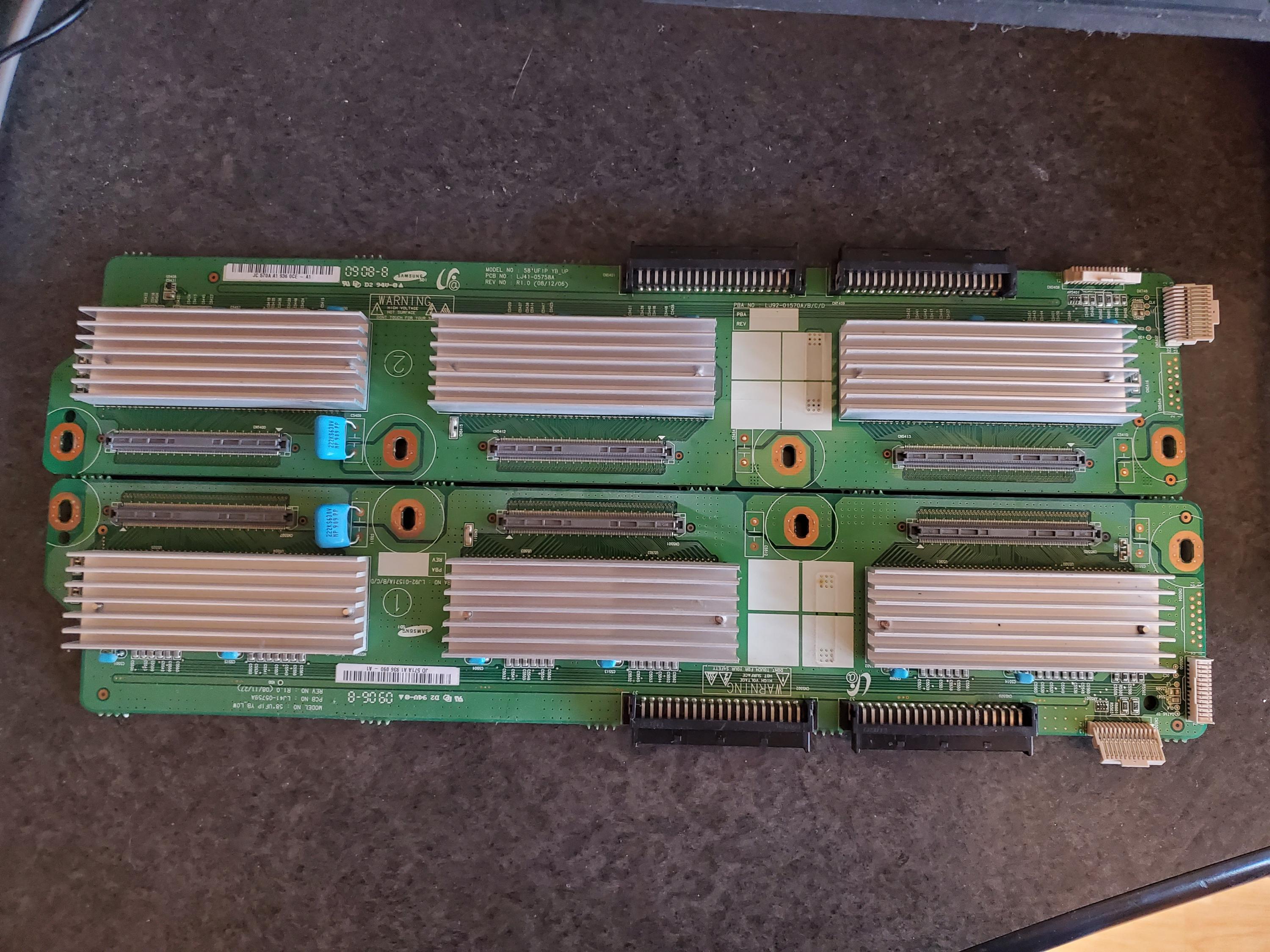

    One Buffer board on the back... the IC area looks leaky/grungy but not horrible. (like the other Samsung I did).
    I have include some pics...Not had a chance to test Mosfets/Diode/Caps etc...This TV seems to be built much better then the previous Samsung I had.
    Any common failure points on this TV?
    The last Samsung the panel had a failure...hope this is not the case on this one.

      The first time when I powered it up the red light on the front was on and the sound tone on startup was present.
      I discovered the YMain Fuse Blown. Swapped the fuse out from another board (Another Plasma YMain from another set - same fuse size/type).
      Upon startup now with the new fuse the PSU is clicking. I assume this is a relay clicking on and off. The front red light follows now the PSU clicking.
      I have VS of 202 volts at the YMain and XMain Connectors.
      The VA is 55 Volts on YMain. The VC is 15 volts on XMain.
      If I remove the fuse (the one I replaced) on YMain the red light on front and sound tone is heard again. The red light stays on if you mess with the touch pad to turn the TV off.
      I am guessing the issue is in the YMain.
      I have done a once over visually and this YMain board does not have any jump out at me burn issues or Bulging Caps.
      I have a ESR meter and I have started this morning to test the Caps...Any other suggestions are greatly appreciated as I am very open to learning as I am definetly a Novice.

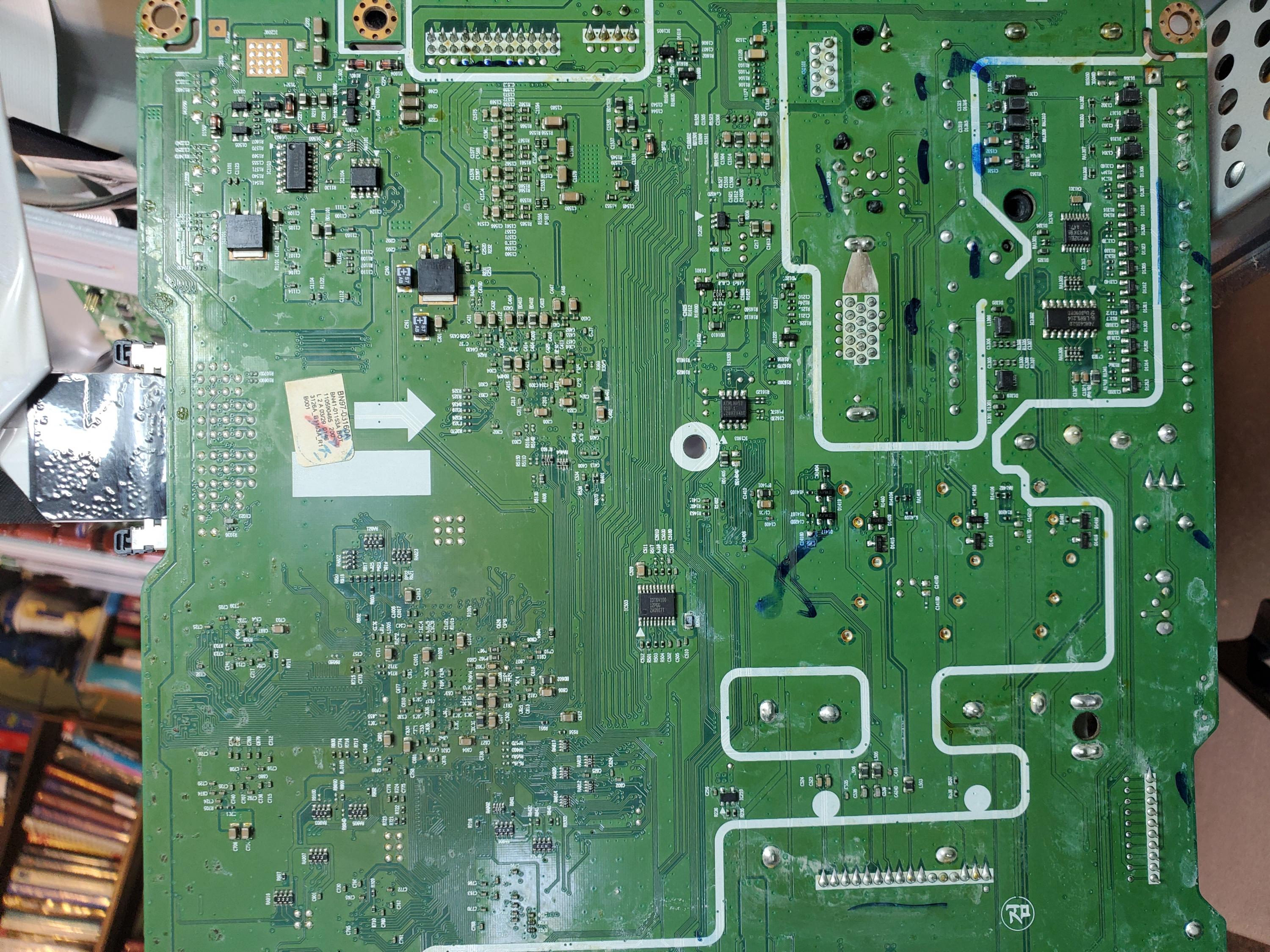

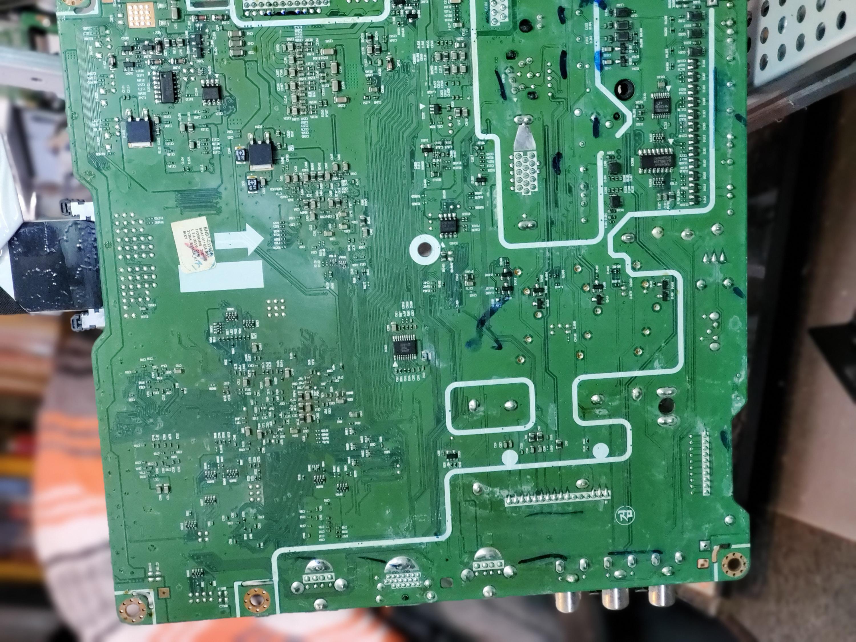

            Search c102 main board on this site. Many posts on this design error. Capacitor C102 SMD is on back of main board. 47 UF 10V cap. Replace it with low esr tantalum 47 UF 10 or 16 volt cap - plenty of room on back of board to solder it on. I would also check relays solder joints on back of power supply board. Re-solder them.
            • SolomonMan
              • Apr 2019
              • 206
              Re: Samsung PN58B650S1FXZA Plasma
              Ajshoe,
              Went through the back of the logic board with my lighted mounted magnifying lamp and I do not see a C102...I do see a lot of what appears to be resin or something (resembling spilled dryed coke a cola) on the back of the Main Board.
              I did a cleaning of the back of the board to make sure something isn't being shorted out by the "mess".

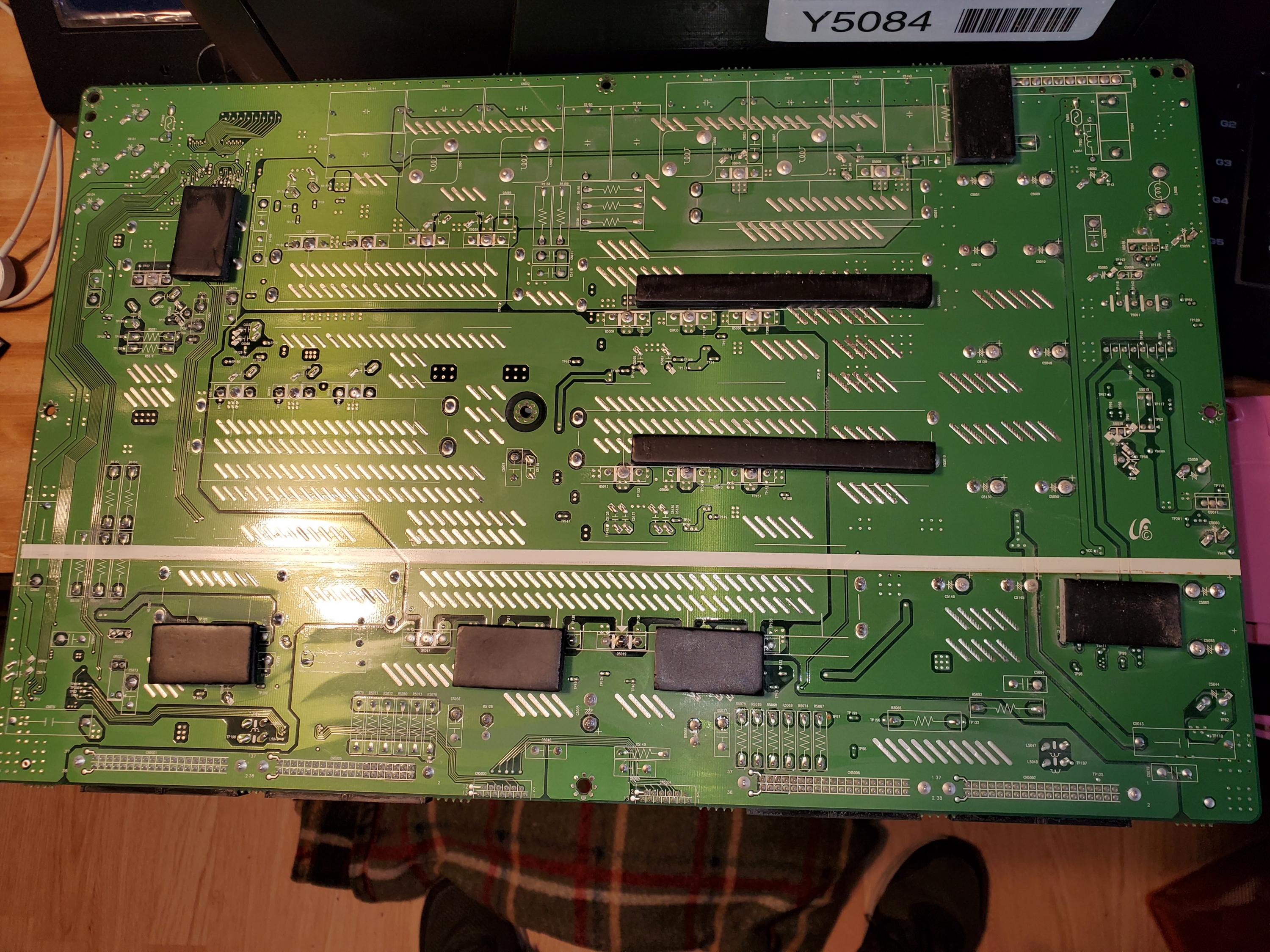

                You won't have a problem on the main board if without the Y-sus fuse you here the tv turn on with chime. You have a bad Y-sus or bad buffer boards. Disconnect the buffer boards from the Ysus (you can leave the panel ribbons connected to the buffer board) and then try the tv, does it turn on? do you have Vs & Va?
                Then unplug the TV and reconnect just the lower buffer board and see if the tv turns on (you might get the lower half of the screen).

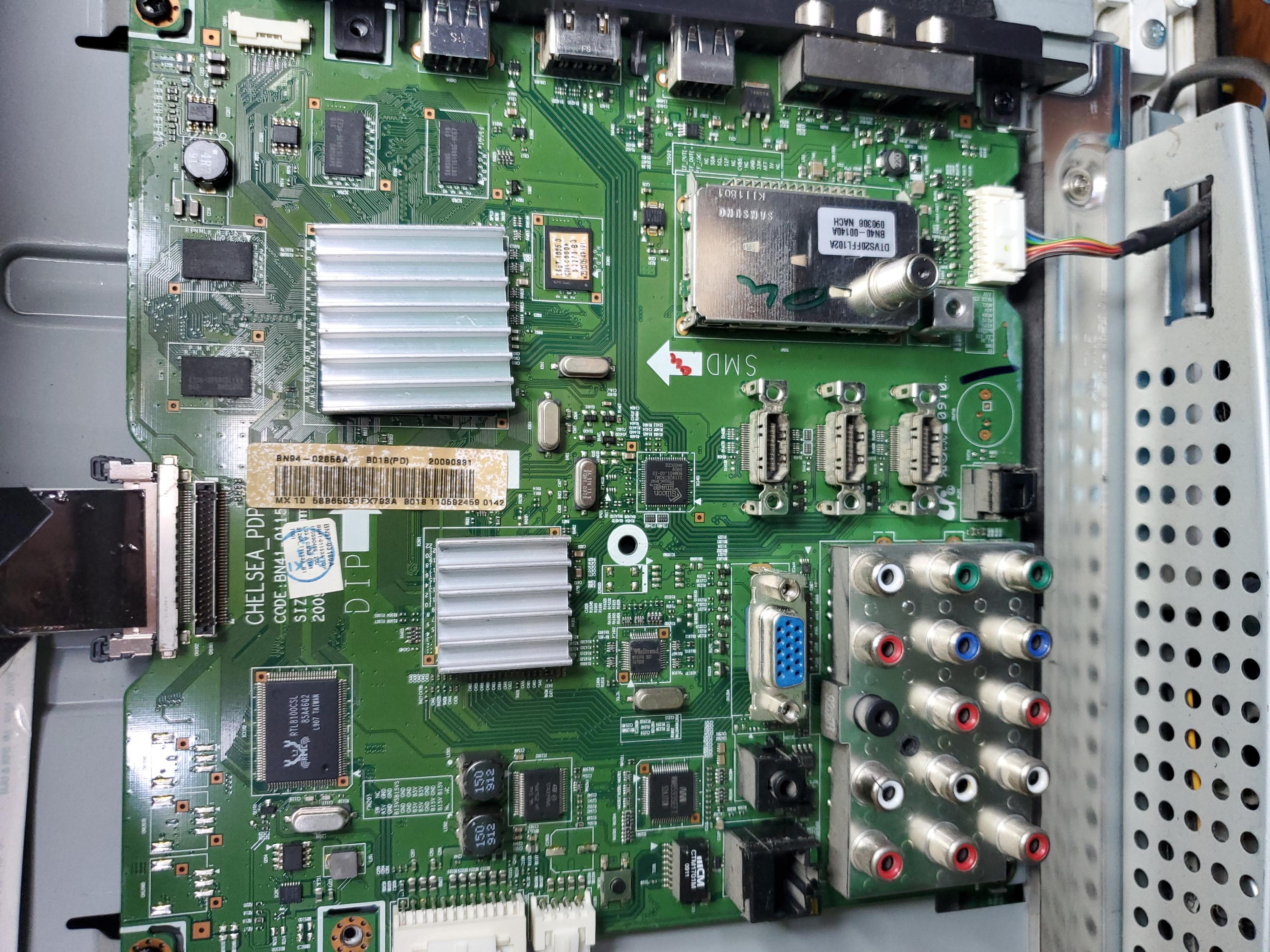

                  pics of main board front and back

                    I have disconnected the Y Buffers and it still caused the PSU to Cycle/relay.
                    Probably should do the continuity Test on the YBuffers? From Memory its a Continuity Test scenario....

                        Caps are not the answer for everything, The reason there is no VS is there is likely a short on the Y-sus board. Check ALL the mosfets. there are likely a few that are shorted. Power supplies have protection so when there is too much of a load they shut down. If you removed the buffers and you still have a shutdown problem, why bother checking them at this time?
                          I realize his set is prob Ysus or buffers. I'm just curious if this set has C102 on back of main board
                            Go to shopjimmy and look at the mainboard pictures for this model and see if you can find it.
                            • SolomonMan
                              • Apr 2019
                              • 206
                              Images are included....I had them already...so I could see things better when looking for C102.

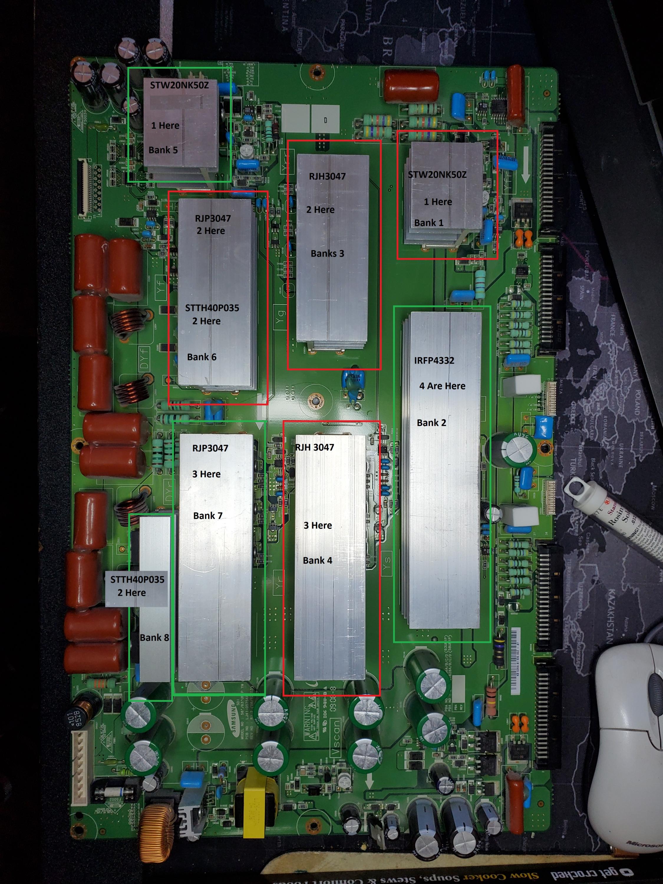

                                Guys,
                                Keep in mind I am a Novice here...So I need some verification on things please;
                                I started measuring the MOSFETS;
                                In circuit Testing in Diode Mode of My Klein Tools MM700 DMM.
                                The Red Squares are Bad and Green are Good in my included image.
                                A) STW20NK50Z - Bank 1- Red - Pin 2 and 3 of the N-Channel Mosfet (1) are shorted - Regardless of which lead of my DMM is used.
                                B) STW20NK50Z - Bank 5 - Green - Pin 2 and 3 are not shorted and the internal Diode is working based on DMM Probes.
                                C) IRFP4332 - Bank 2 - Green - Pins 2 and 3 are not shorted and the Diode is working based on DMM Probes choosen. N Channel Mosfet (4).
                                IGBTs? - Assume Testing like a Mosfet - Saw online should not test in circuit?
                                D) RJH3047 - Bank 3 - Red - Silicon N-Channel IGBT High Speed Power Switching - Pins 2 and 3 are shorted - Diode on Emitter and Collector seems bad.
                                E) RJH3047 - Bank 4 - Red - Silicon N-Channel IGBT High Speed Power Switching - Pins 2 and 3 are shorted - Diode on Emitter and Collector seems bad.
                                F)RJP3047/STTH40P035 - Red/Green? - Bank 6- (Not RJH3047 previously but RJP3047) - Another IGBT (RJP3047) but I can not find much on this other than a Large Manual (sales)... Is it like a RJH3047...If so...To test the internal diode - Pin 3 Emitter (Red Lead) Pin 2 (Black Lead) each of the RJP3047 Give me a .414Volts. If I reverse the Leads I get O-L on both of the RJP3047 in the Bank.
                                The STTH40P035 - ULTRAFAST RECTIFIER - Bank 6 again - A-K-A - Diode The Anode Pins (1 and 3) and the Cathode (2). When in diode mode positive probe on 1 or 3 and black on 2 the reading is .331. If I reverse the probes reading is 2.71 V instead of O-L. (Going Bad?)
                                G) RJP3047 - Red? - Bank 7 - Again Not sure 100% how to test the IGBT. But if I test it like a RJH3047 - To test the internal diode - Pin 3 Emitter (Red Lead) Pin 2 (Black Lead) each of the RJP3047 Give me a 1.020V. If I reverse the Leads I get O-L on all three RJP3047 in the Bank.
                                H) STTH40P035 - Green - Bank 8 - The STTH40P035 - ULTRAFAST RECTIFIER - A-K-A - Diode The Anode Pins (1 and 3) and the Cathode (2). When in diode mode positive probe on 1 or 3 and black on 2 the reading is .329. If I reverse the probes reading is O-L.

                                Guys, what are your thoughts on the YMain Board specifically on the RJH/RJP3047 IGBTs?
                                Suggestions on how to test either IGBT would be greatly appreciated.

                                  If your a newbie - recommend purchasing another Ysus or send it in for repair. You have a bunch of removal and soldering - there not that easy to get to - have to remove heatsinks to get to them. You pic in earlier post of back of main is not whole board - think C102 is in area where pic is cut off. think C102 is on bottom of pic.
                                        after examining this main board - not the C102 issue. They re-designed the main bd - hopefully fixed this issue. Have you ordered a new Ysus bd
