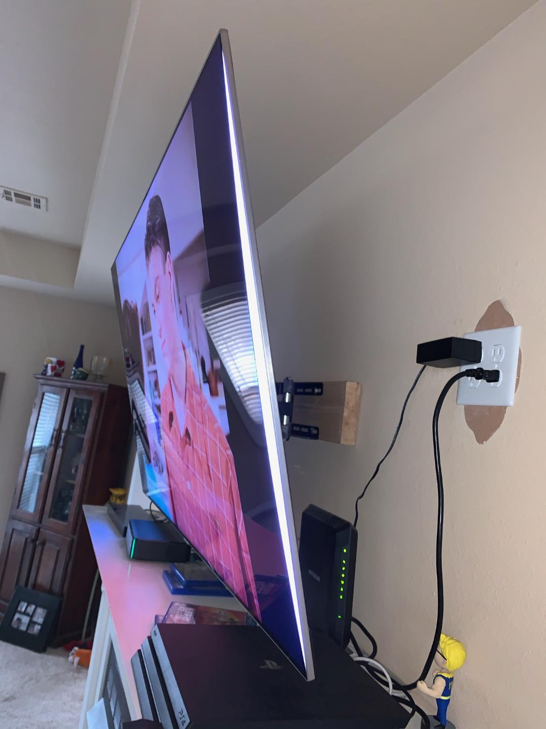

            We had to change our backlight repair policy to see if we can safely pull the new Samsung Qled panels with the Bezeless design due to the panel being held in with adhesive strips like Sony likes to do. The minute Yuppie Scum goes to mount that Tv over his FIREPLACE with a ambient temperature about 100 degree F or more he'll see that panel adhesive give way and start bowing like this fool. When I saw that I refused the repair and ran as fast as I could. We won't do backlight repairs on any Tv that does not have a bezel to hold the panel in. Look at the angle this fool had on this Tv and with that much heat I'm surprised the panel is not sitting on his floor by now. 2 year old Tv. I feel sorry for him cause Samsung wouldn't do anything for him. I suggested to put it back on the stand and find a different location. I never recommend putting any Tv over a fireplace. But that's the way Yuppie Scum is designing these new Preppy Homes nowadays. Pitiful
