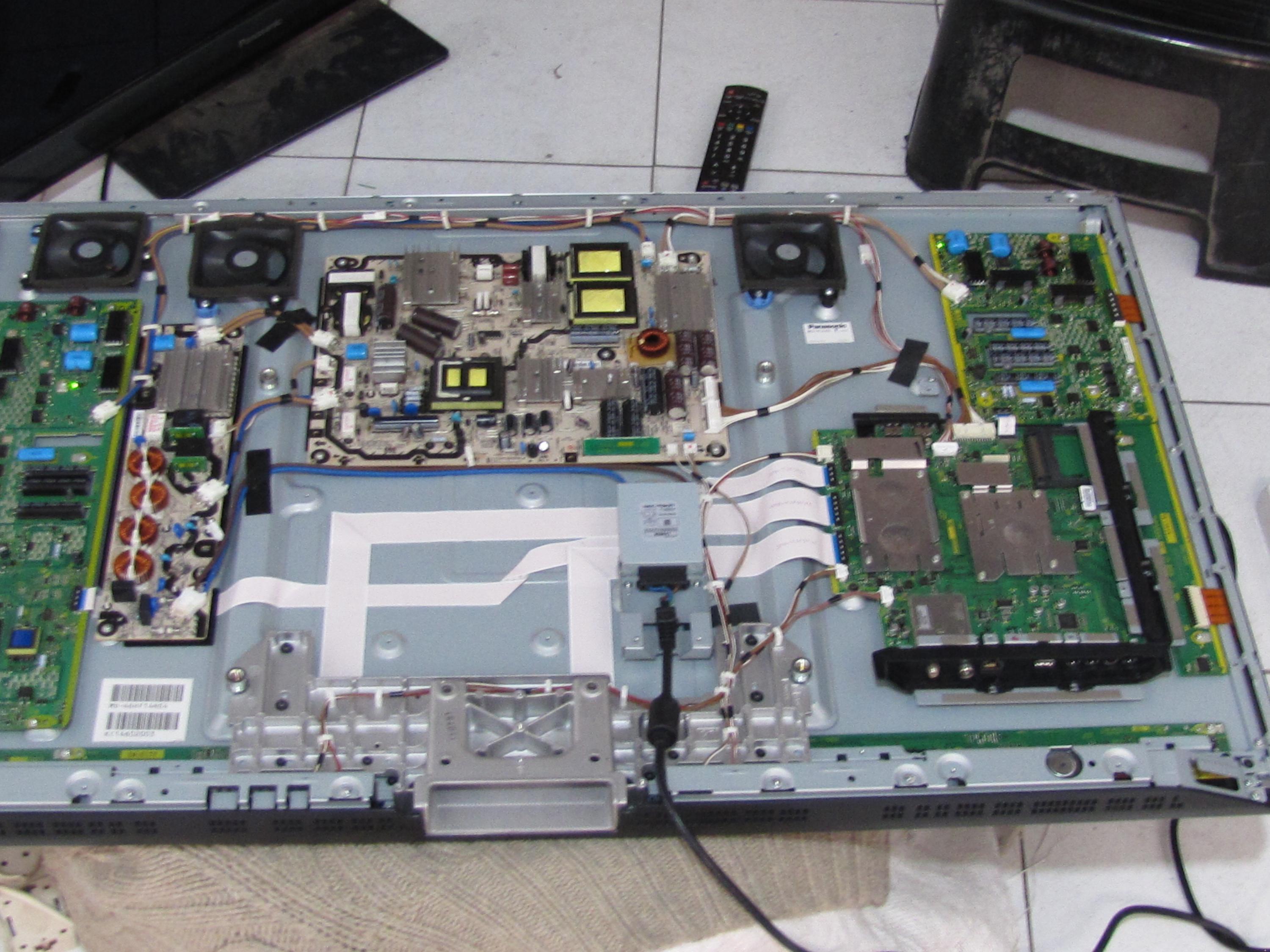

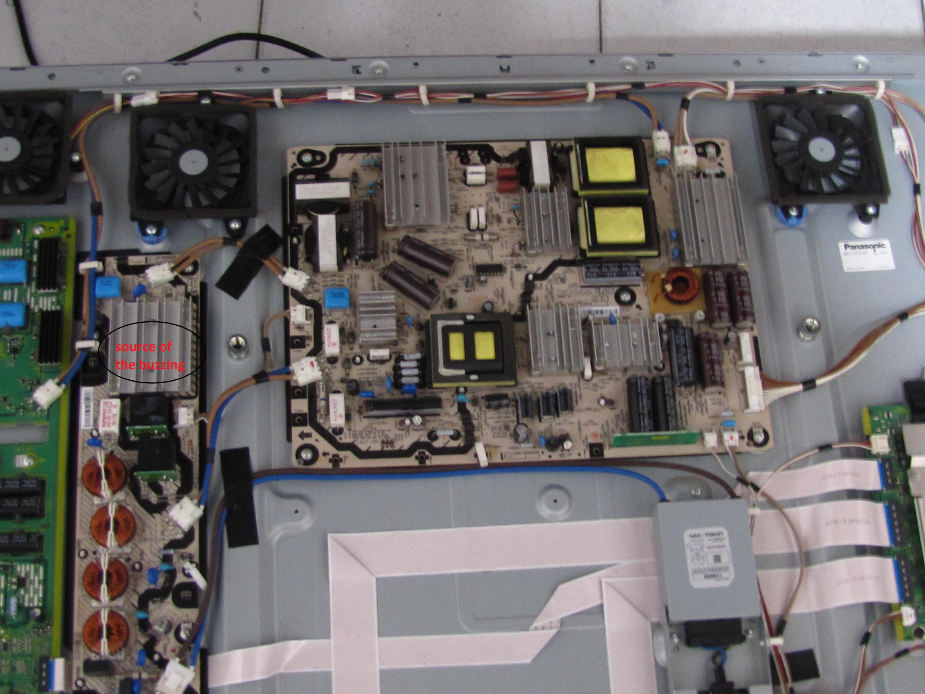

    i have this set that switches on,with a buzzing sound coming from the ac
    power supply no image not even a glow,following a training
    manual to switch the power supply with no load,it switches on fine
    (with no buzzing ).changing the 2 power supplies leaves it with the same behavior.
    Attached some photos of the set and measurements.Can
    someone please help to find the problem.
    measurements(I have let the set on for approximatively 10 to 15 min):
    SC2=215V
    C631=111V
    C632=111V
    TP126=0V
    TP82=15.54V
    TP98=1.13V
    TPVAD=71V
    TPVSUS=215V
    P15V=15.5V
    P5V=5V
    TPVE=164.6V
    VEREF1=2.43V
    VEREF2=2.43V

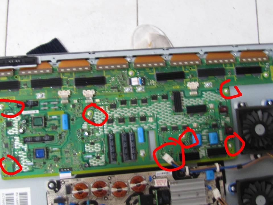

    Check if some of the 7 SC board mounting screws are loose . Then test for a short on the connector. Unplug tv before testing anything for 10 minutes.

      Re: tx-p46gt30e power supply with buzzing sound.

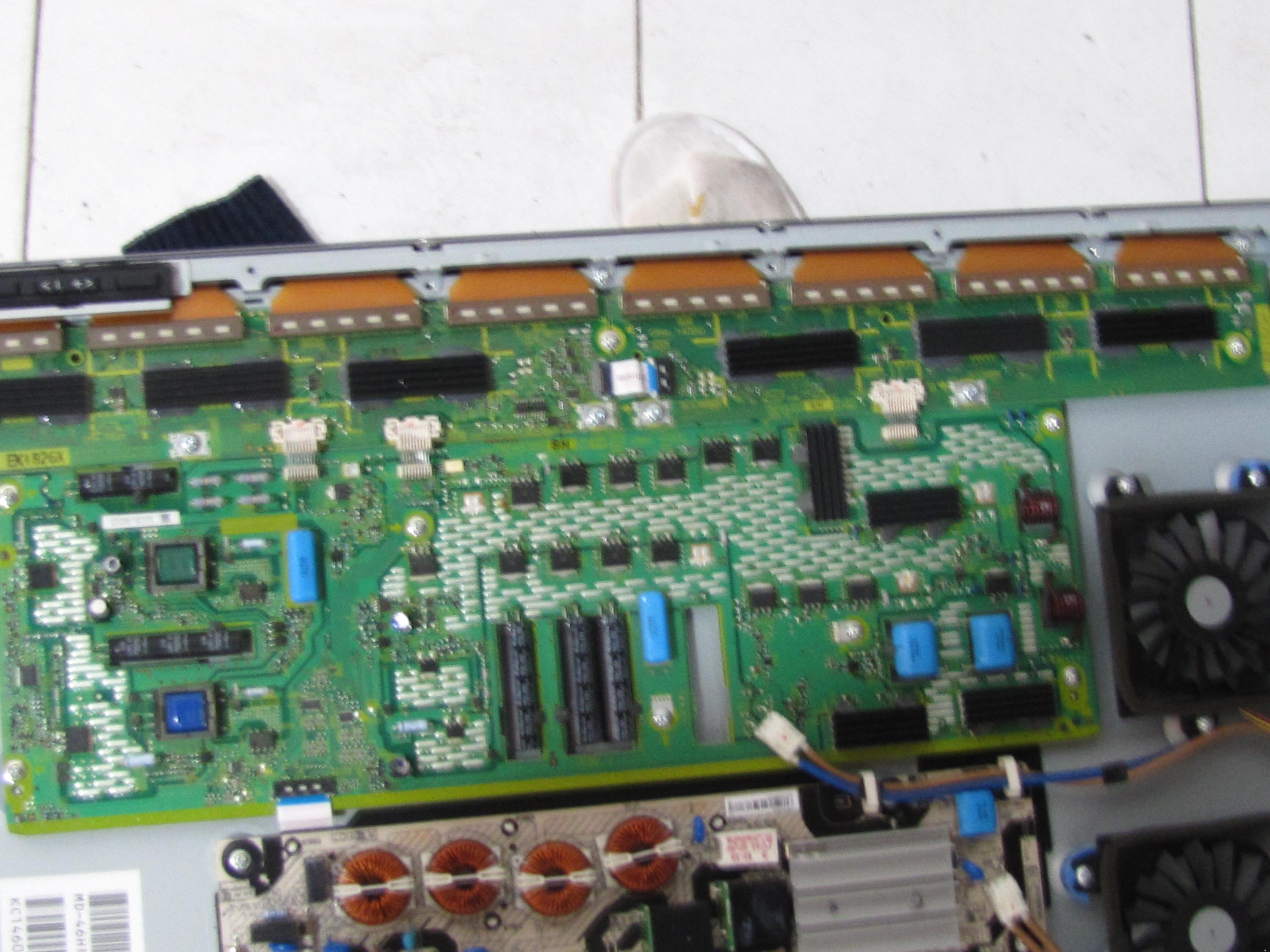

      thanks for your reply.the screws were the first thing i inspected.they are thightened.i can`t see any short in SC or SS board.also inspected C1 and C2 on the caps have 55v.

        Check the buffer boards for a short.

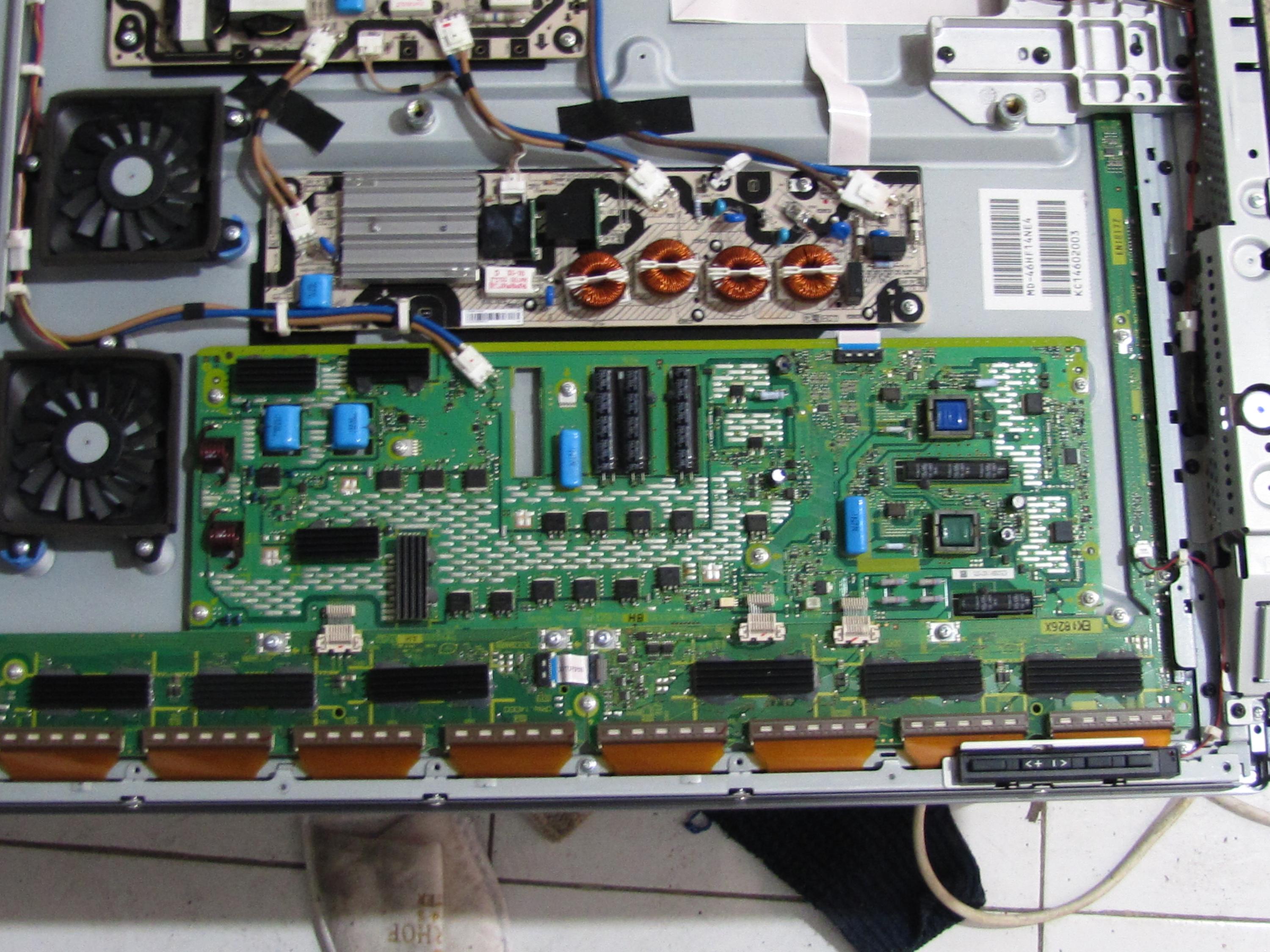

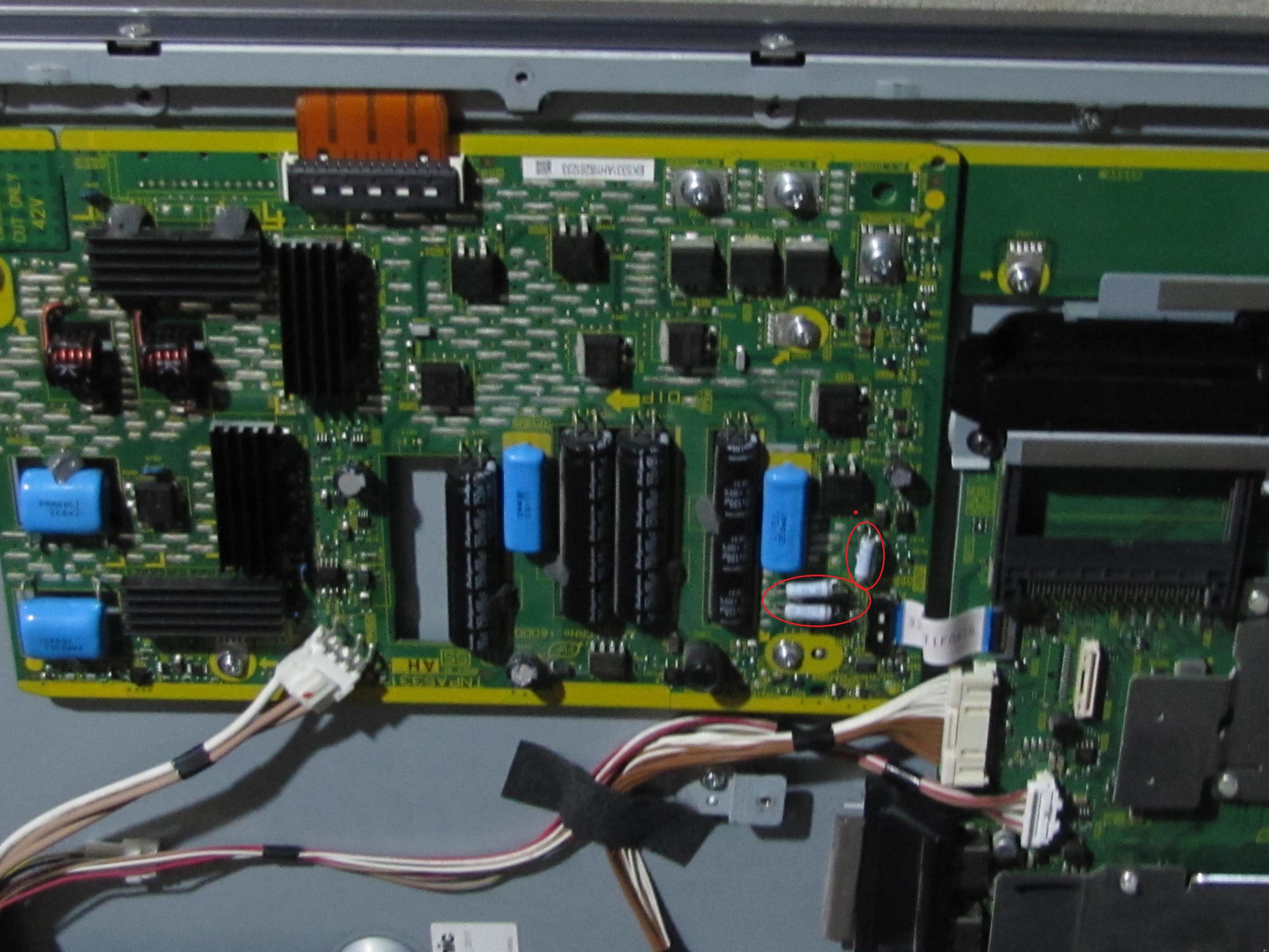

          checked the buffer boards for short with reference to VFG;they are not shorted.Isolating the SC board (disconnect SU and SD and using jig) the buzzing still present.Till thr only thing i noticed is the resiistors marked in the photo are hotter than the other parts (after disconnecting the power,of course)

              Try supplying a video source, does the buzzing sound change as the video signal changes, Does the sound seem to be coming from the panel? A panel that has lost it's gas can buzz.

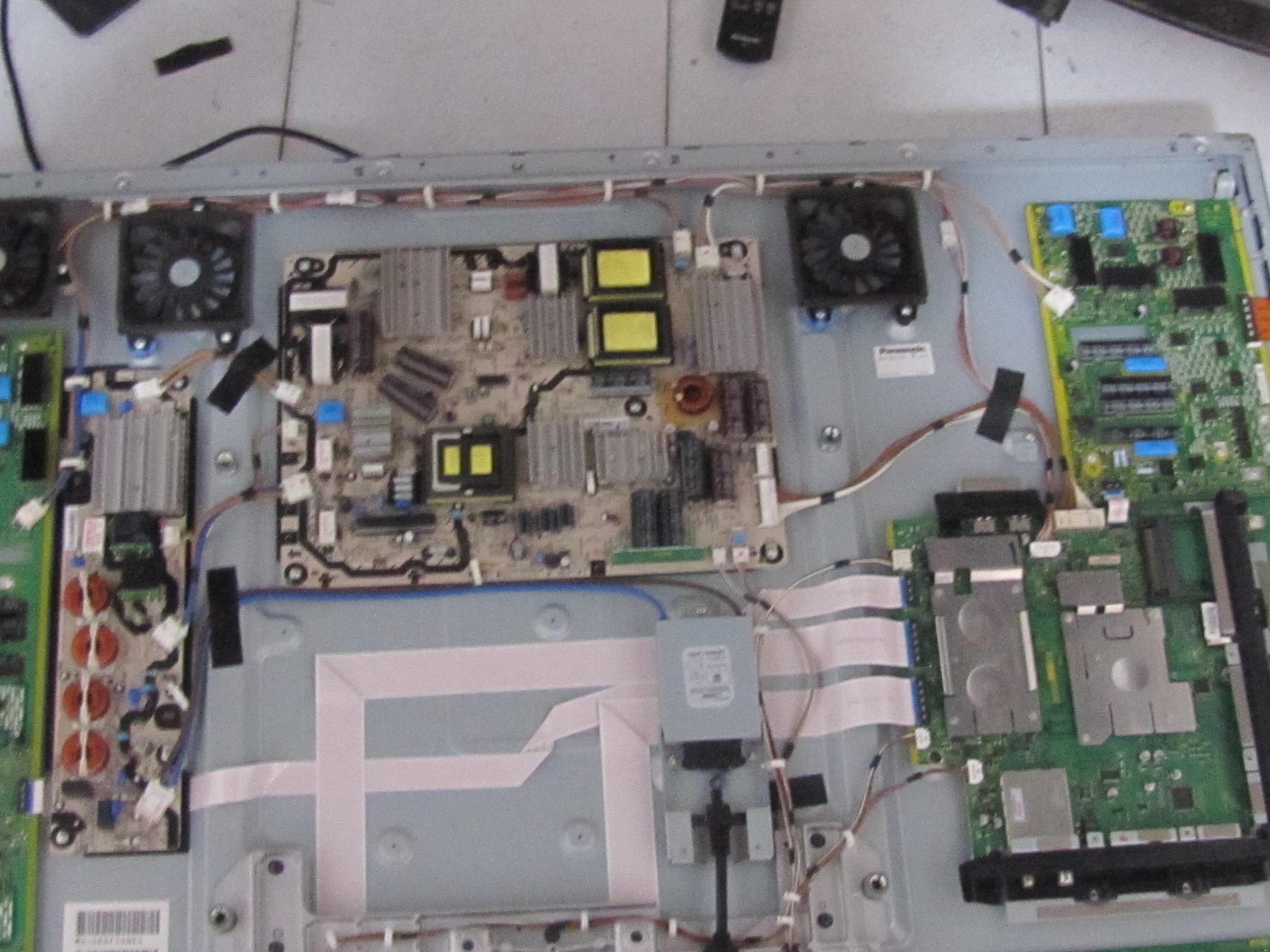

                many thanks R J for your help.in the photo you can see where the buzzing comes from.is isolaating the buffers good enough to know if the panel is good?
                  I have had older panels that lost there gas and the sound was more of a growlling/buzzing sound, but you could tell it was coming from the panel. I don't believe that board has anything to do with the panel drive, it is part of the power supply.
                      I looked at the board you have pictured in post #8 and the buzzing is coming from the heatsink for the two bridge rectifiers, so I doubt that is a problem.
                      I would check for shorted igbt on the Sc and SS boards
