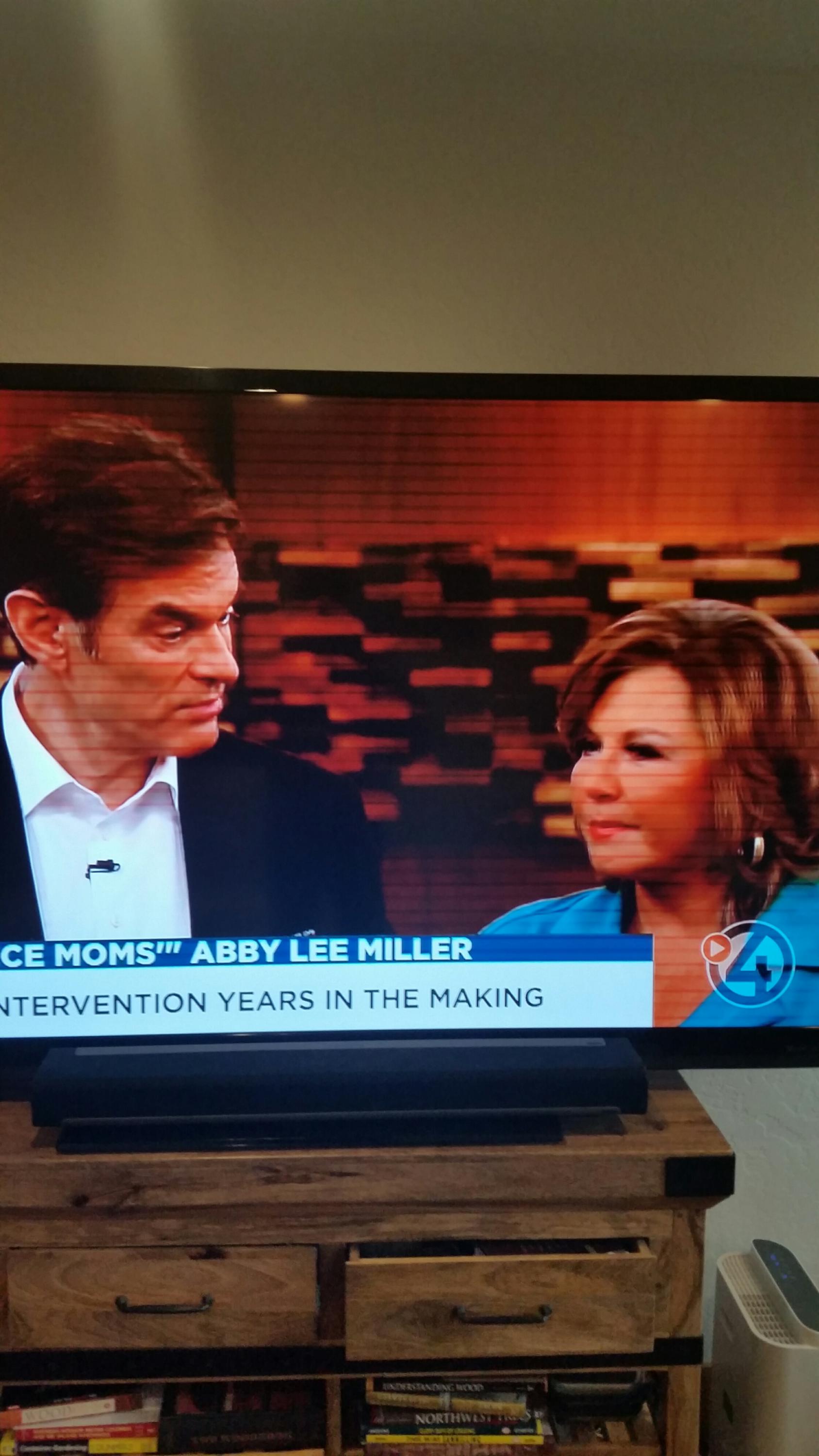

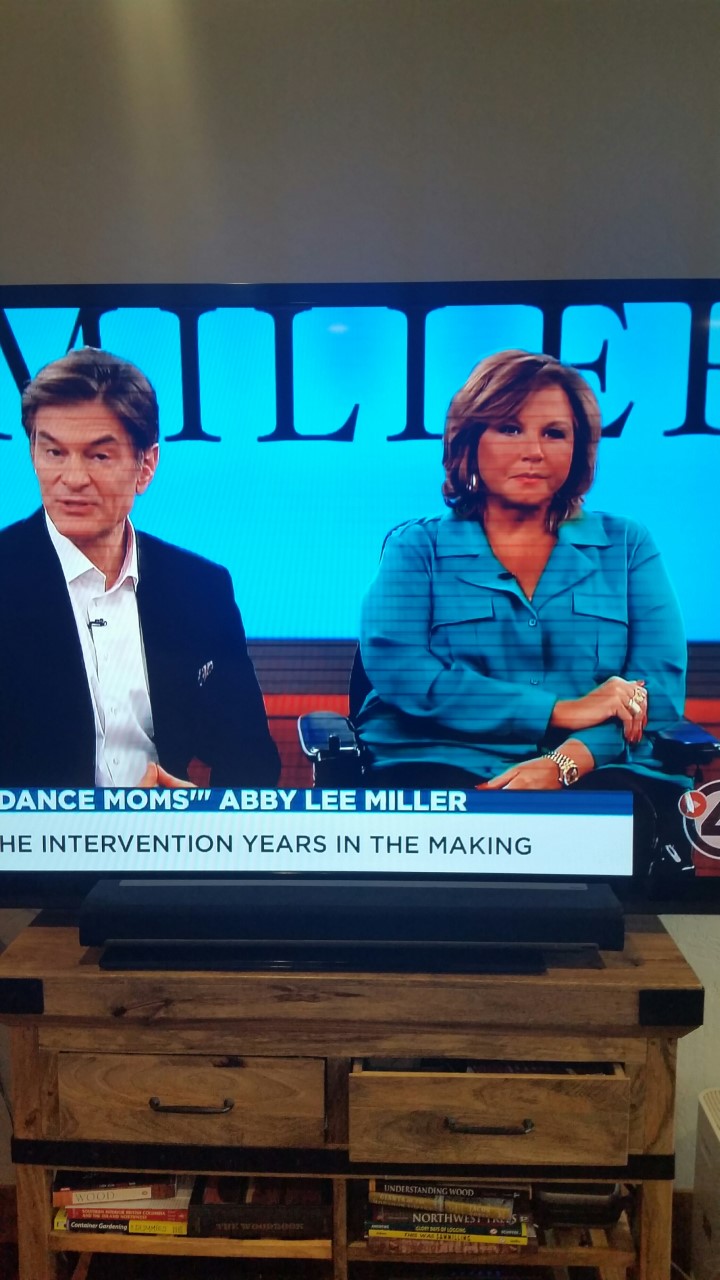

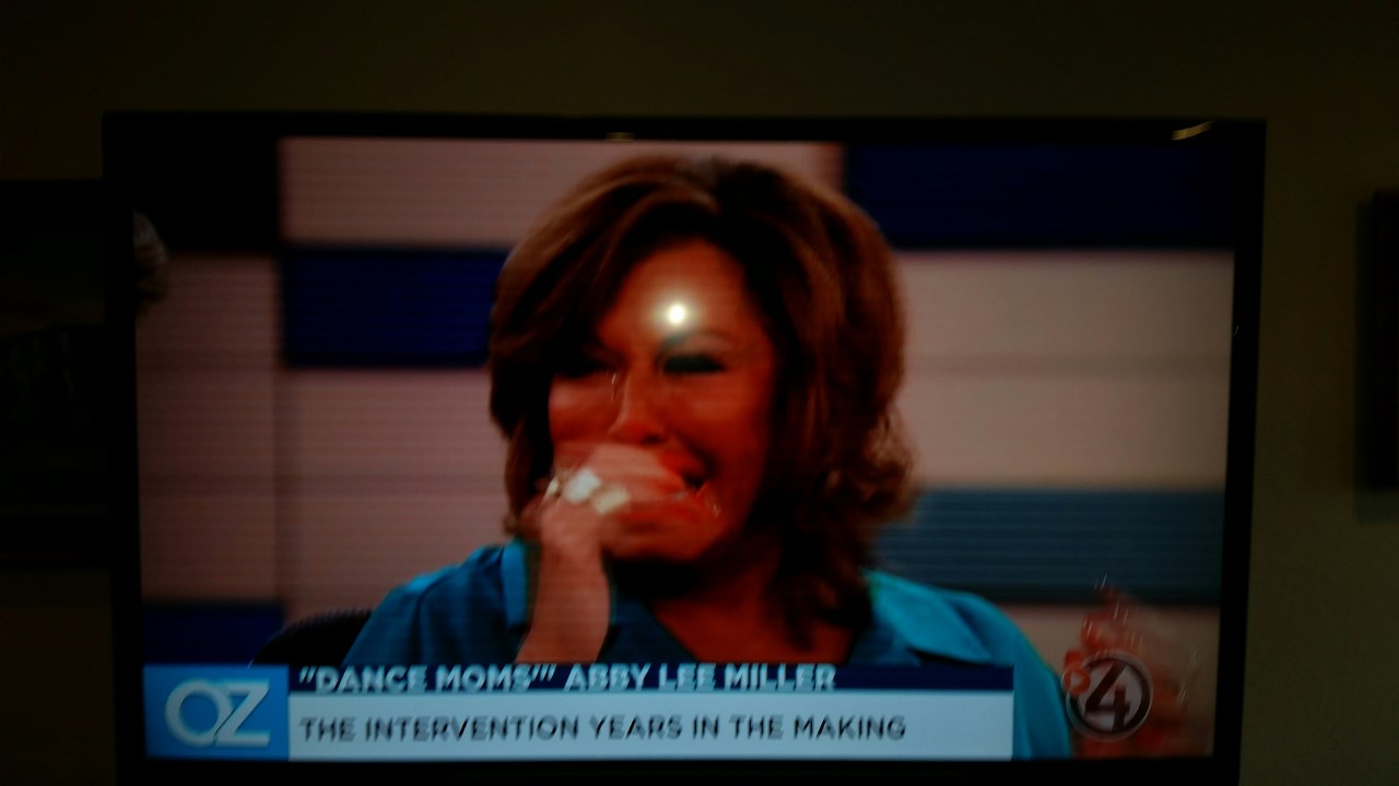

Sharp LC-80LE642U Image problem?
  • Audioplus
    • Feb 2012
    • 157
    A client asked me to look at this image problem he has neglected for at least a couple of years. I've seen plenty vertical T-Con issues in the past, and panel separation problems with Sharp. I have never seen a consistent pattern on a video display like this. Any ideas? Any help is appreciated!
  • Audioplus
    • Feb 2012
    • 157
    Re: Sharp LC-80LE642U Image problem?
    Sorry, I intended to include First time I have ever seen a HORIZONTAL display issue like this?
    • CapLeaker
      Leaking Member
      • Dec 2014
      • 8326
      what does the osd look like?
      • Audioplus
        • Feb 2012
        • 157
        3 pics attached in original post.
        • budwich
          • Jul 2015
          • 3097
          closely check the cabling from the main to the tcon.... pins and alignment.
          • Audioplus
            • Feb 2012
            • 157
            Thank you, that could be it, client said after a move problem presented itself. Could have jarred a ribbon cable?
