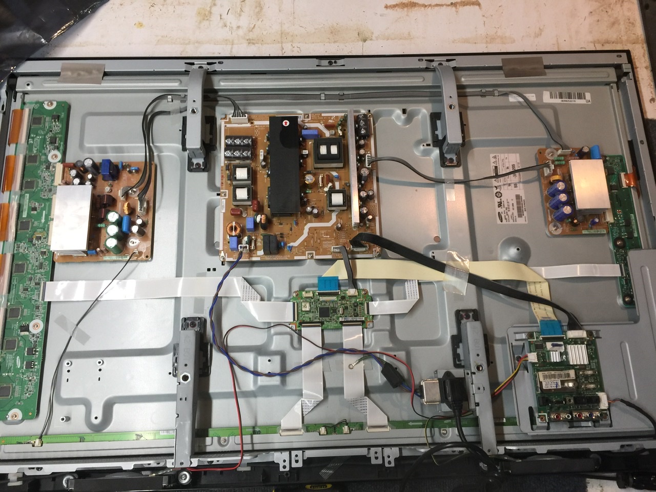

    Emerson PL-P42W-10A plasma
    It will just click on and off twice then nothing. Most voltage reading I only get when it's clicking then gone except standby.
    CN801
    PS On 3.2
    STBY 5.28
    GND 0
    D15v 15.4
    GND 0
    GND 0
    D5.3 5.26
    D5.3. 5.26
    GND 0
    D15v 15.4
    D15v 15.4
    Again only while clicking on do I get correct voltages.
    CN802
    D5.3v. 5.3
    D5.3v. 5.3
    GND 0
    GND 0
    Ps on 3.2
    Vs on 3.2
    CN803
    Not sure if this says V5 or VS
    V5 17-18 range
    V5 17-18 range
    GND 0
    GND 0
    D15v 15
    CN804
    VA 22
    GND 0
    D15 15
    GND 0
    Vs or V5 around 18
    Vs or V5 around 18

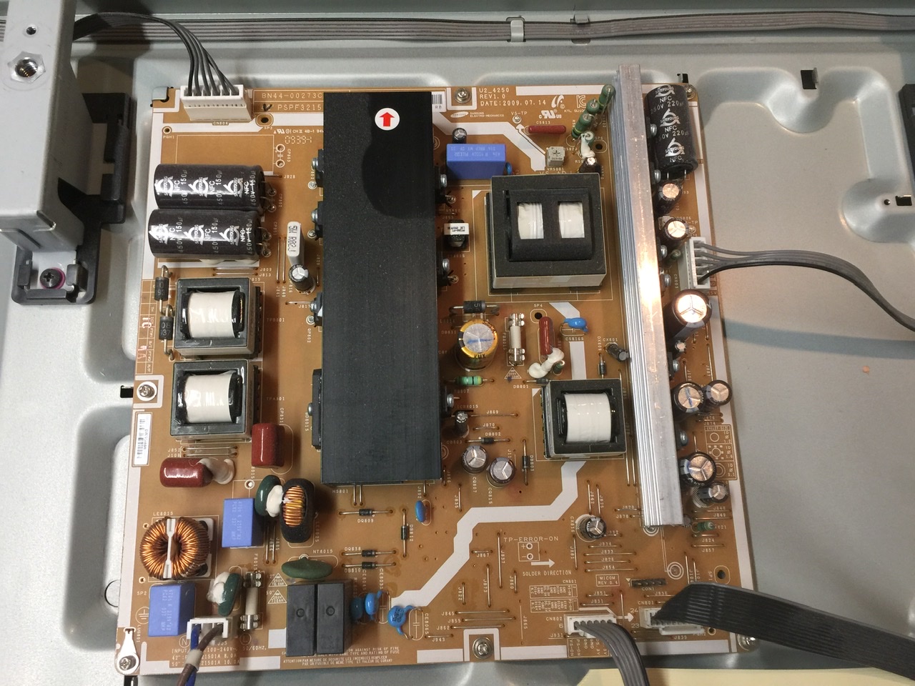

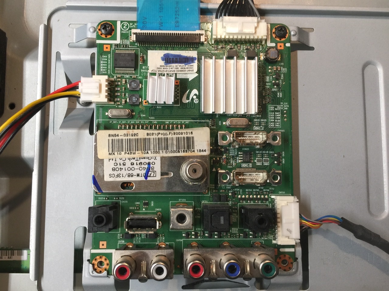

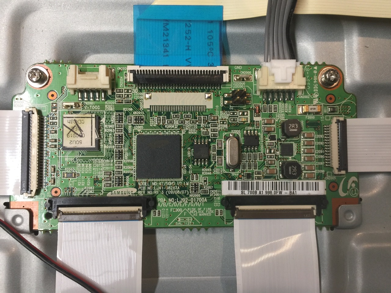

    I have replaced power board, the small green board and swap eprom on connection board. I have also have unplugged each board and powered on but to no avail.

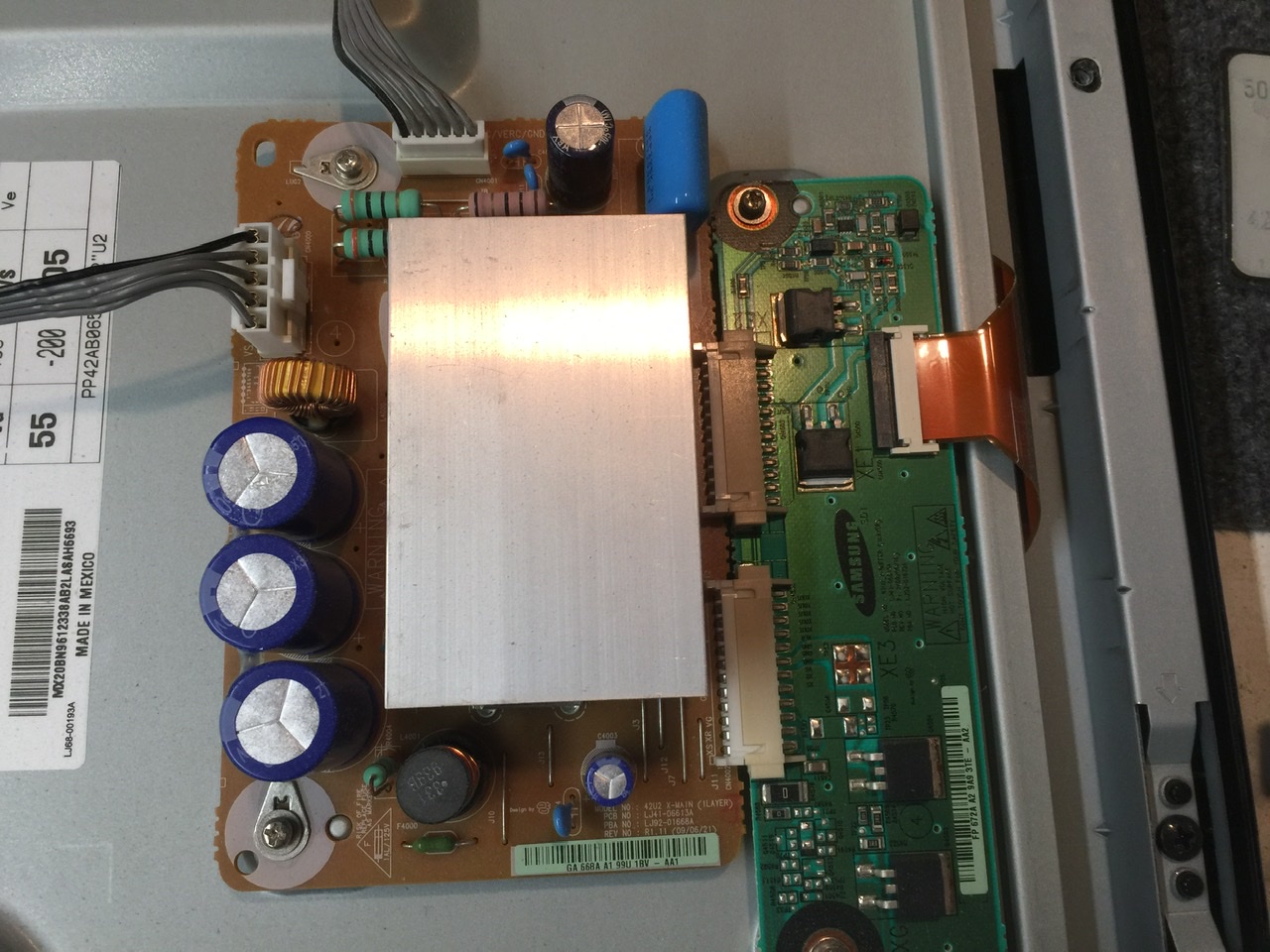

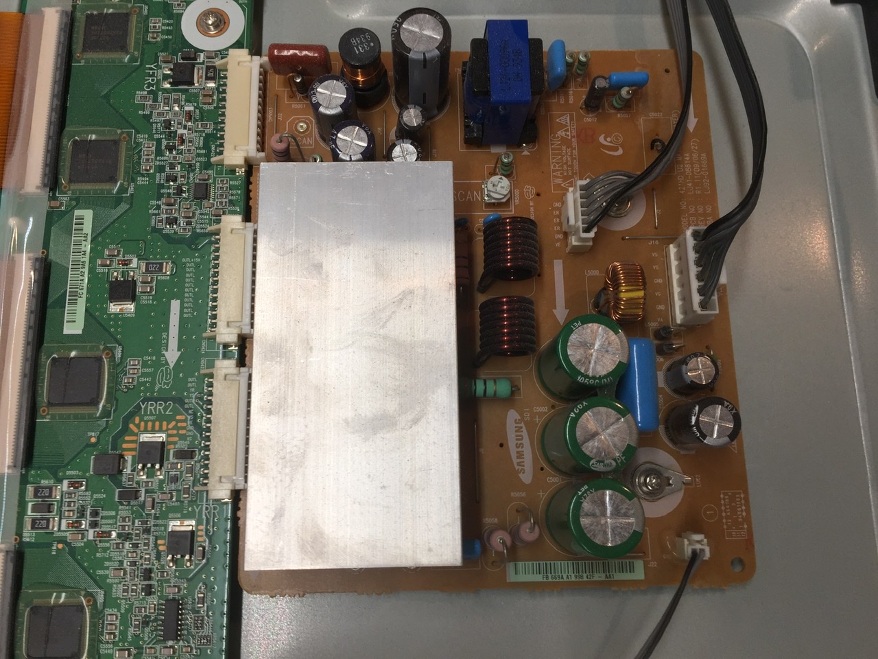

    That will be Vs, there is a sticker on the panel with the correct voltage, It looks like the Vs should be 205Vdc, and the Va 55Vdc
    I suspect you have a problem on either the Y-sus or Z-sus boards

      So should I be able to unplug one or the other and it should stay on?
      • R_J
        • Jun 2012
        • 9583
        Re: Emerson PL-P42W-10A plasma
        Yes you can disconnect the y & z boards, and monitor the voltage on the Vs of the power supply to see if it comes up to 205v.
