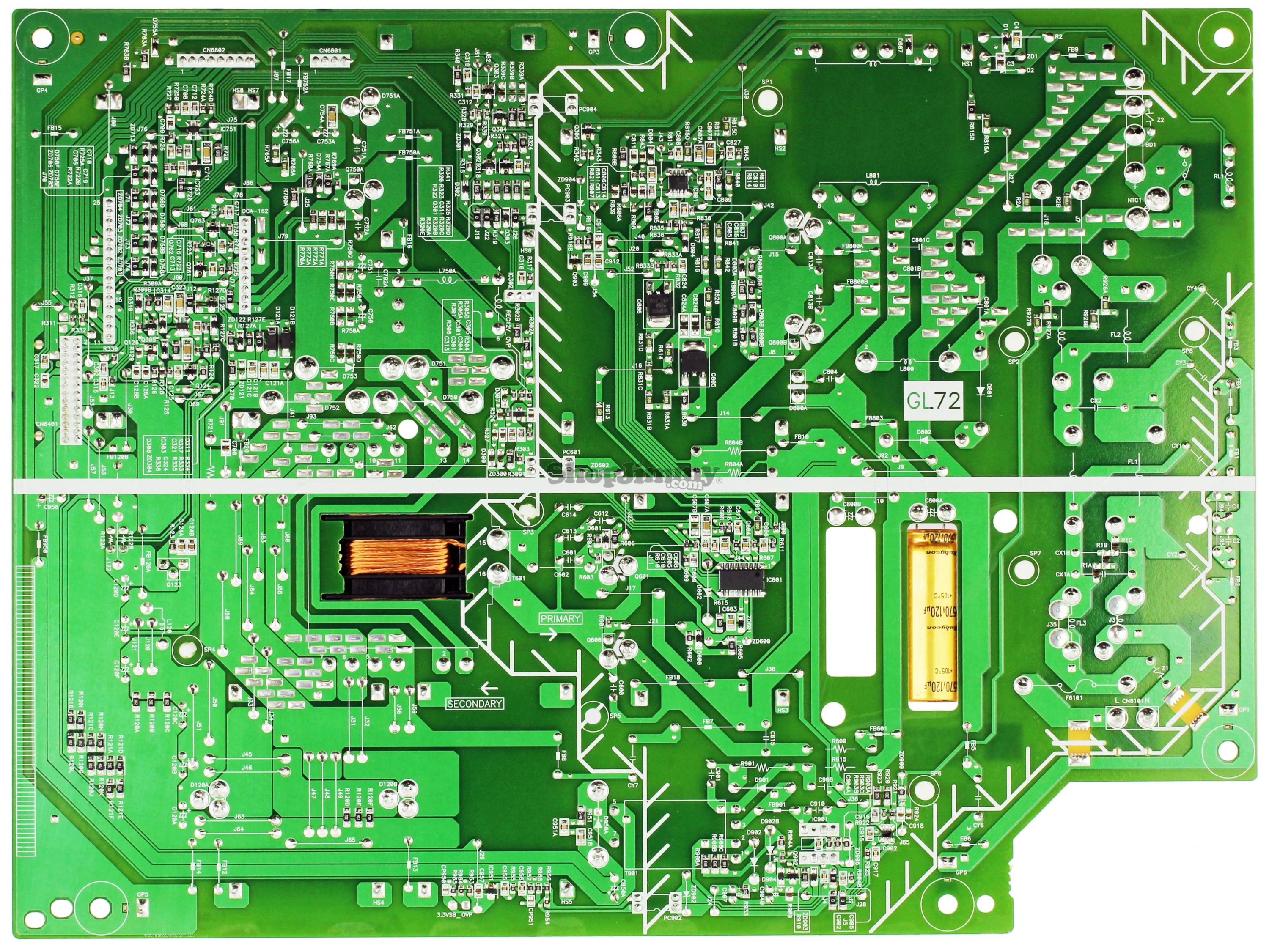

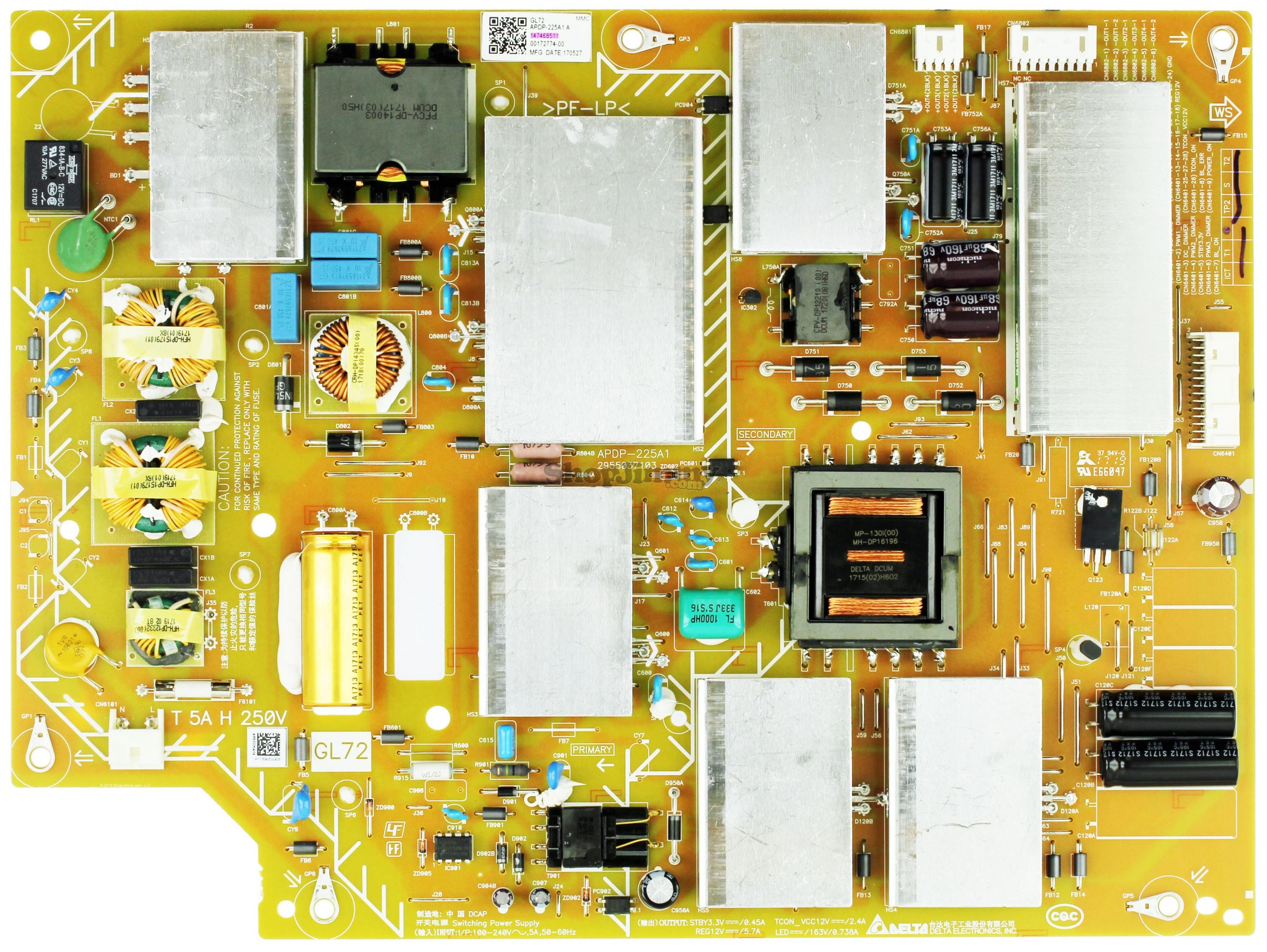

    Hi everyone,
    I need some help repairing this power supply. I've been testing it and my conclusion is that it's sorted. Now I don't know how to find the faulty component. Can someone give me a hand?
    The model number of the board is:
    GL72
    APDP-225A1 A
    1-474-685-11
    This is all the information I've gathered:
    The TV does not turn on. When I push the on button a click is heard (the relay) and the red led shows the 2 blinks code (faulty power supply).
    I've removed the power supply and these are the tests I've already done:
    - when plugged in to mains, stand by voltage is ok.
    - when I turn it on, by shorting the stand by and power on pins, REG12V are ok, but there's no voltage at TCON_VCC12V pins. Also, the voltage to the LED arrays is 97V, lower than the 163V expected as per board labels.
    - with the board unplugged I've found continuity to ground in places that I believe are not supposed to have it: both ends of D950A; REG12V, TCON_VCC12V and BL_Error pins at CN6401.
    - I've desoldered some components,and all have tested ok: Q123, D950A, C950A, C120B&C and C958.
    My assumption here is that one or more components are faulty and shorting to ground. Am I right? Maybe one of the small ones on the bottom side of the board? How can I find the culprit?
    I haven't been able to find the schematics of the board or a repair kit. I'm attaching hi-res pics of the board downloaded from shopJimmy. I'll try to take others myself if I manage to get the right light to get good pictures.
    Many thanks in advance.

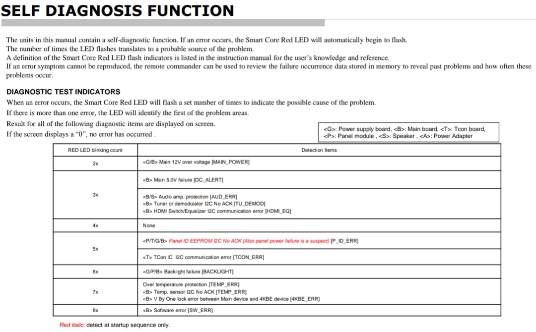

          Re: Sony Bravia KD-65XE7096 with shorted power supply
          Where did you find the error code discription? You have the REG12V which is good, The TCON_ON signal controls Q124 which controls Q123. Q123 acts as a switch, and switches the REG12V to become the TCON_VCC12V

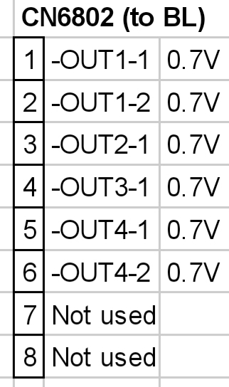

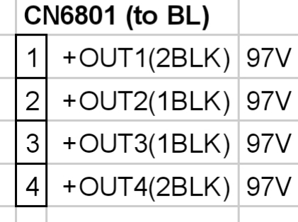

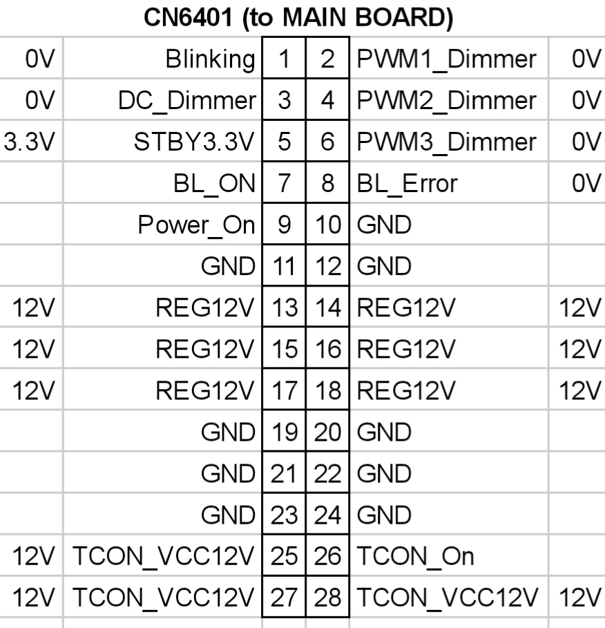

            I've just tested the power supply while activating POWER_ON, BL_ON and TCON_ON and all voltages seem right except for BL. I've attached my readings at the connectors to main board and to BL.
            +out to BL doesn't go much higher than 97-99V, even when the power on button is pressed. On the other hand, -out is always almost 0.
            This is the same no matter if the main board is connected or not.
            What can be the cause?
              Many thanks for your answer.
              The description of the errors reported by the TV blinking the red light can be found in Sony's service manuals. I've attached a list of error codes and it's description.

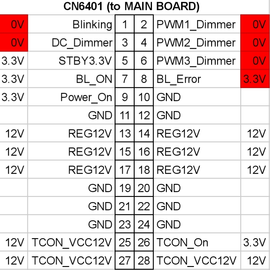

              I've connected again the main board and the voltage never goes higher than 97-99V at power on. With the main board and BL disconnected the voltage is the same.
              BL_ERROR reads 3.3V after pushing power on button, even with both BL cables disconnected.
              Could be an fault in the led boost circuit you mention? What other tests can be done?

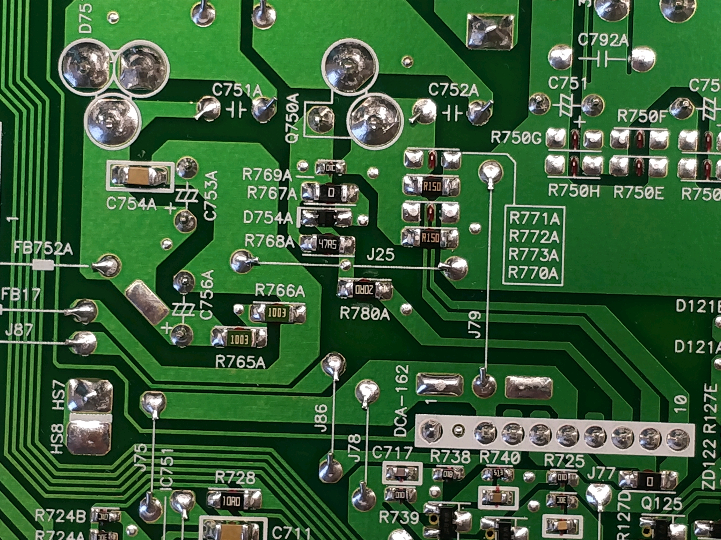

                I guess it is possible that the led boost circuit has a problem, I have not worked on this particular power supply.
                Check Q750A and check that R770A,R772A are not open. I'm not sure what the dca-162 is (looks like a driver ic) but it drives Q750A which seems to be the boost output fet.
                  https://www.badcaps.net/forum/attach...9&d=1580005552
                  So at what condition are readings were measured?
                  How can you have no Voltage on T-CON on but you have 12V on TCON_VCC12V?
                  Are you sure about all those Voltage readings?
                  What happen if you leave the meter probe on the BL-ON pin then turn on the TV while watching the meter?
                  The Dim controls also not present?

                    Sorry, maybe the picture is confusing. Pins POWER_ON, BL_ON and TCON_ON have 3.3V because I connect them to STBY.

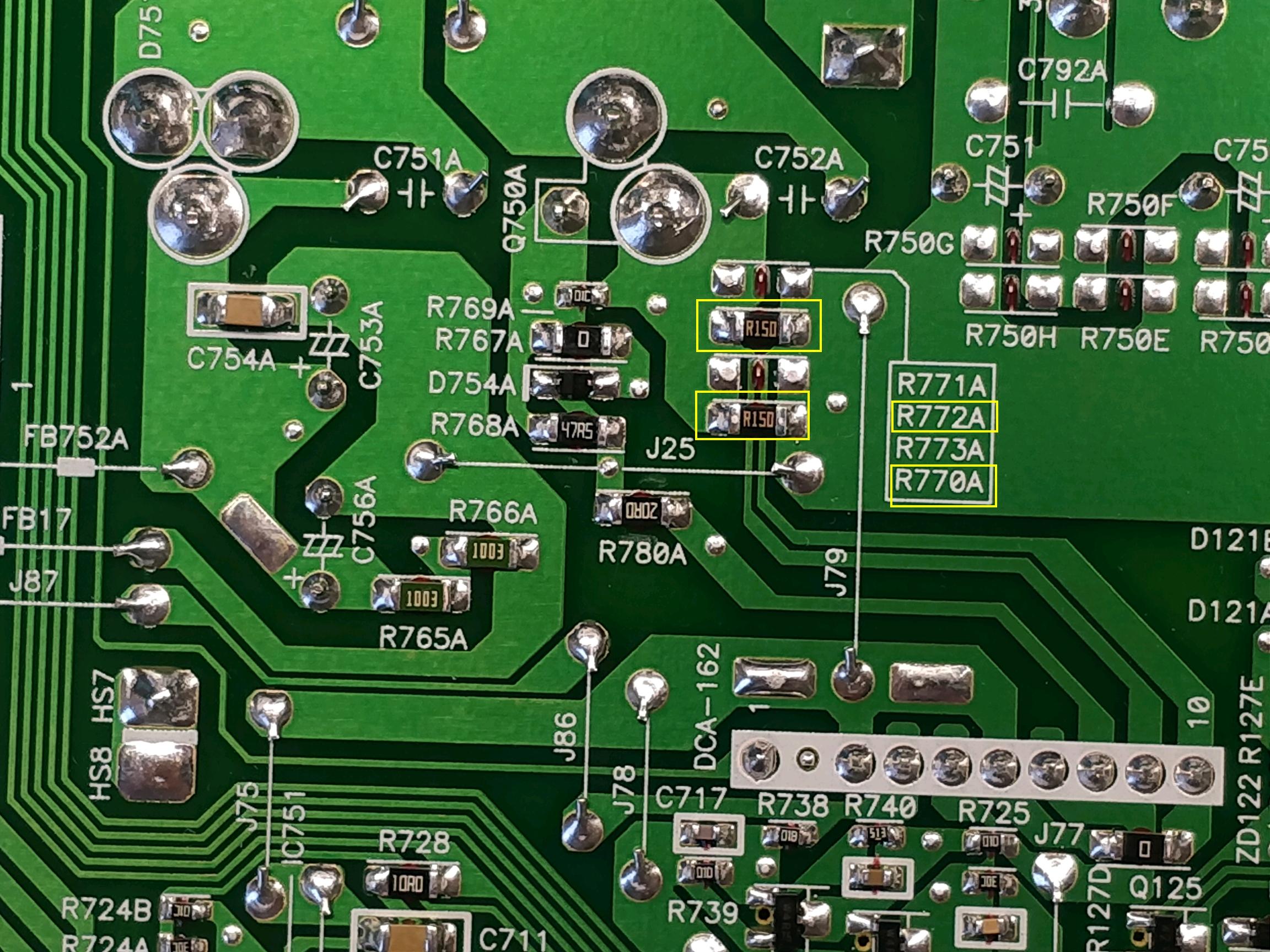

                          I think I've found two broken resistors: R765A & R766A. They show no continuity, should be 100 kOhm). The rest of the resistors in the area are good.
                          Mosfets and diodes of the secondary seem good to me. I've tested them by measuring DS resistance:
                          Q750A: 400 stable
                          D751A: 550 stable
                          Q123: 500 and then increasing
                          D120A: 130 stable
                          D120B: 130 stable
                          Seems like I need to replace R765A & R766A.
                          NB: I've attached a picture of this area on my actual board.
                          • R666
                            • Jan 2020
                            • 18
                            • Spain
                            Ooops! No, these resistors are ok. I just rechecked then because I was not confident that I did it right yesterday. My multimeter doesn't have multi range and it was set to read ohms, not I ohms.
                            What else can I check?

                              Oh, and I haven't located R770A and R772A.

                                To summarise:
                                Sony TV that turns on for 1-2 seconds and then it turns off by itself. No sound and no backlights. Starts with a white status led, then a relay is triggered and the TV is shut down, left with a red led that blinks 2 times. According to Sony's documentation (attached) this code means that the power supply is bad.
                                I've taken the power supply off of the TV, no other boards are connected to it. I've connected POWER_ON, TCON_ON and BL_ON pins to STBY_3.3V pin to simulate the power on state of the TV. I've attached a picture with the readings at the connector to main board and the connectors to back-lights.
                                -STBY3.3V, TCON_VCC12V and REG12V voltages are ok.
                                -BLINKING, DC_DIMMER and PWM_DIMMER have 0V, which I presume is not normal. Am I right? Not sure what is the function of this pins.
                                -BL_ERROR is set to 3.3V, which I presume is what tells to the main board that there's a problem with the back-lights and to stop the normal power on process of the TV. Then the relay at the power supply switches it off.
                                -Voltage to back-lights only gets to 97-99V, but 163V was expected.
                                -components around Q750A seen to be ok.
                                Any suggestion?

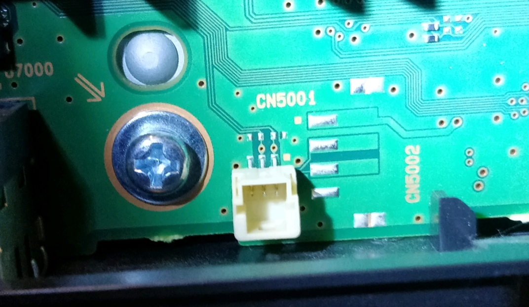

                                  Also, located at the main board there's this tiny connector. Probably it's a service port. Could TV logs be accessed through this port? Anyone happen to have it's specs?

                                        • 9625
                                        If this is a picture of your board, the resistors look ok.
                                        Do you know the number on the ic DCA-162? If your led's are indeed ok, It could be this ic that has an issue. OR that the main board is not sending the PWM, blinking and dimmer signals to the drive the ic.
                                        The BL_ERROR, seems to be controlled by Q761, It is possible that when the led circuit is working ok, then the BL_ERROR would be low (0V)
