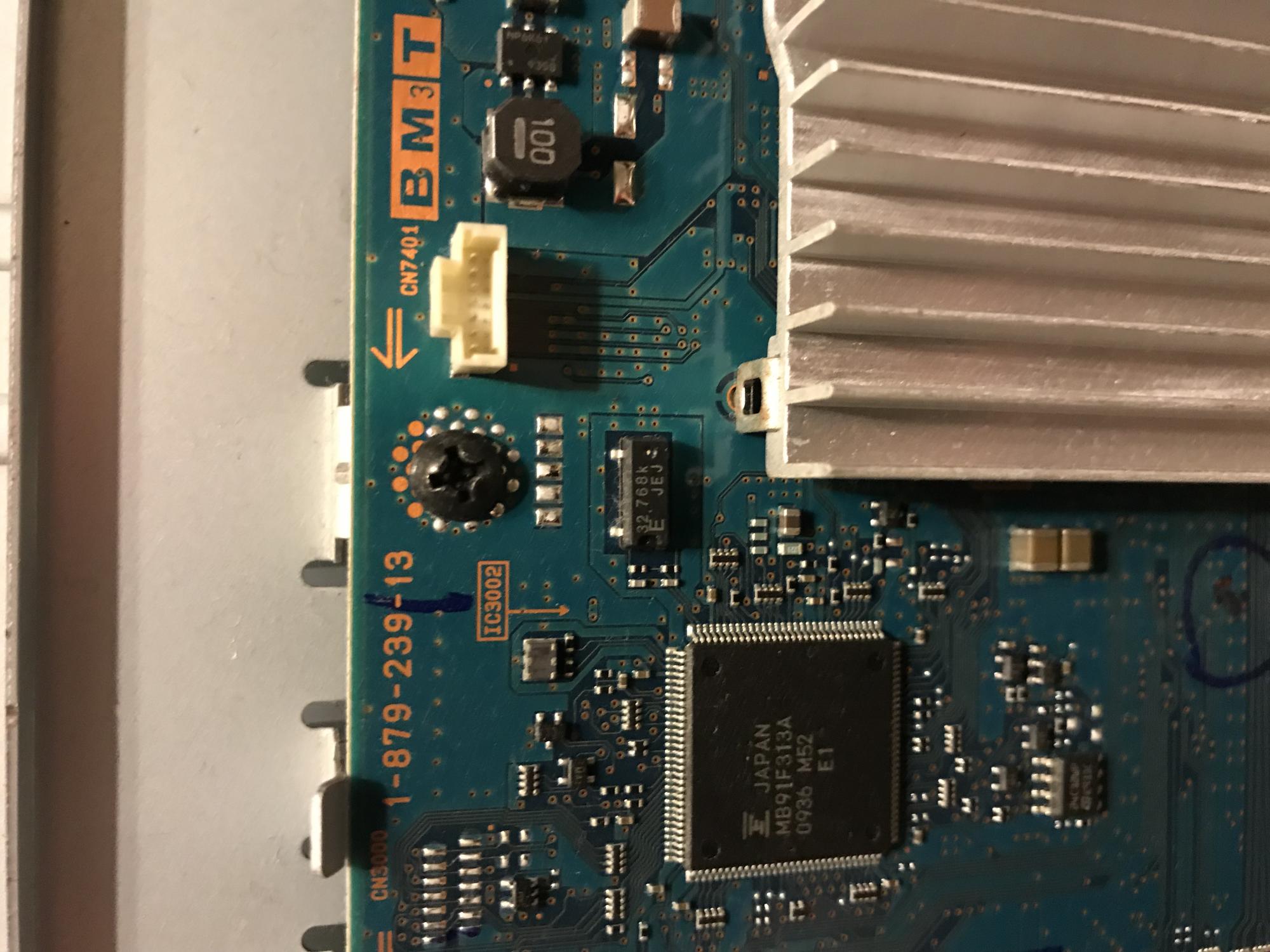

                    #29
                    Re: Sony KDL-47V5100
                    I’ve tried everything suggested. Now it sometimes turns on and off using a Sony universal remote I had and by the side buttons. Sometimes it doesn’t.
                    Sometimes it turns on and the backlights stay on, if I plug the coaxial cable or an hdmi from my roku in, it starts cycling the backlights every 10 seconds. Sometimes it doesn’t.
                    I give up. A new mainboard on eBay is more than I can get for the tv.
                    Also
                    The mainboard that is in it has a different number than on shopjimmy. On shopjimmy it ends in -11. Mine ends in -13.

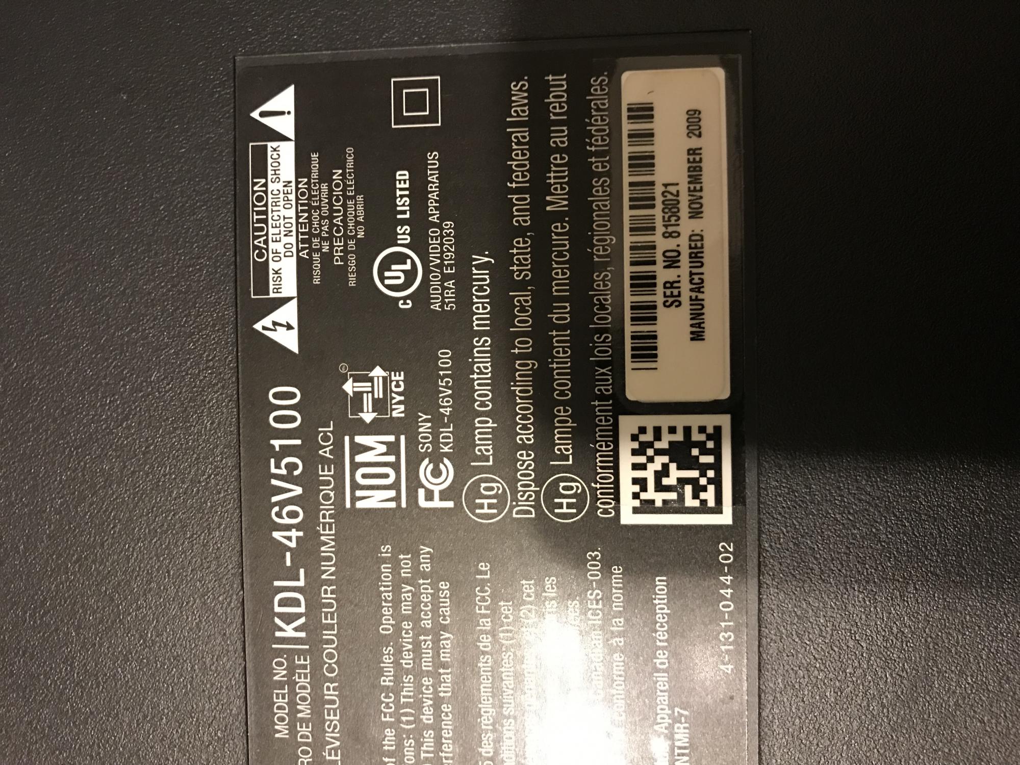

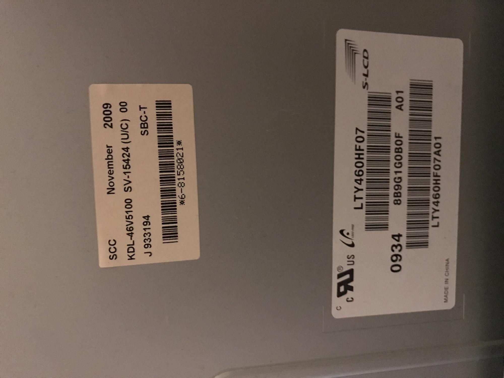

                        What is the panel sticker numbers?

                          You may be on to something, someone might have put the wrong board in there, not sure if 11 and 13 will interchange.

                              What is the panel sticker numbers? And service code on back cover and first 8 letters of serial number?

                                #35
                                The panel sticker is in my previous post. That's all I could find.

                                  #36
                                  that is what i thought since the first posts, someone tried replacing mainboard with a different version, if you get a cheap programmer and first find a dump of the serial eprom for the correct model on the web you can put it in and you'll probably end with a perfect working set.
