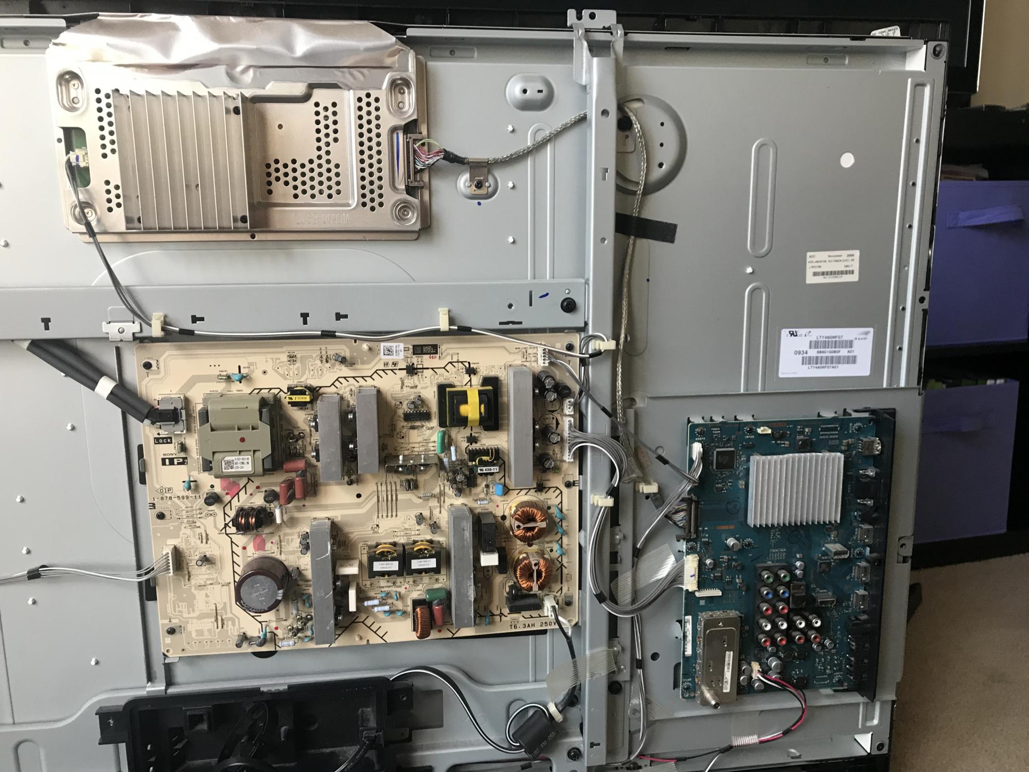

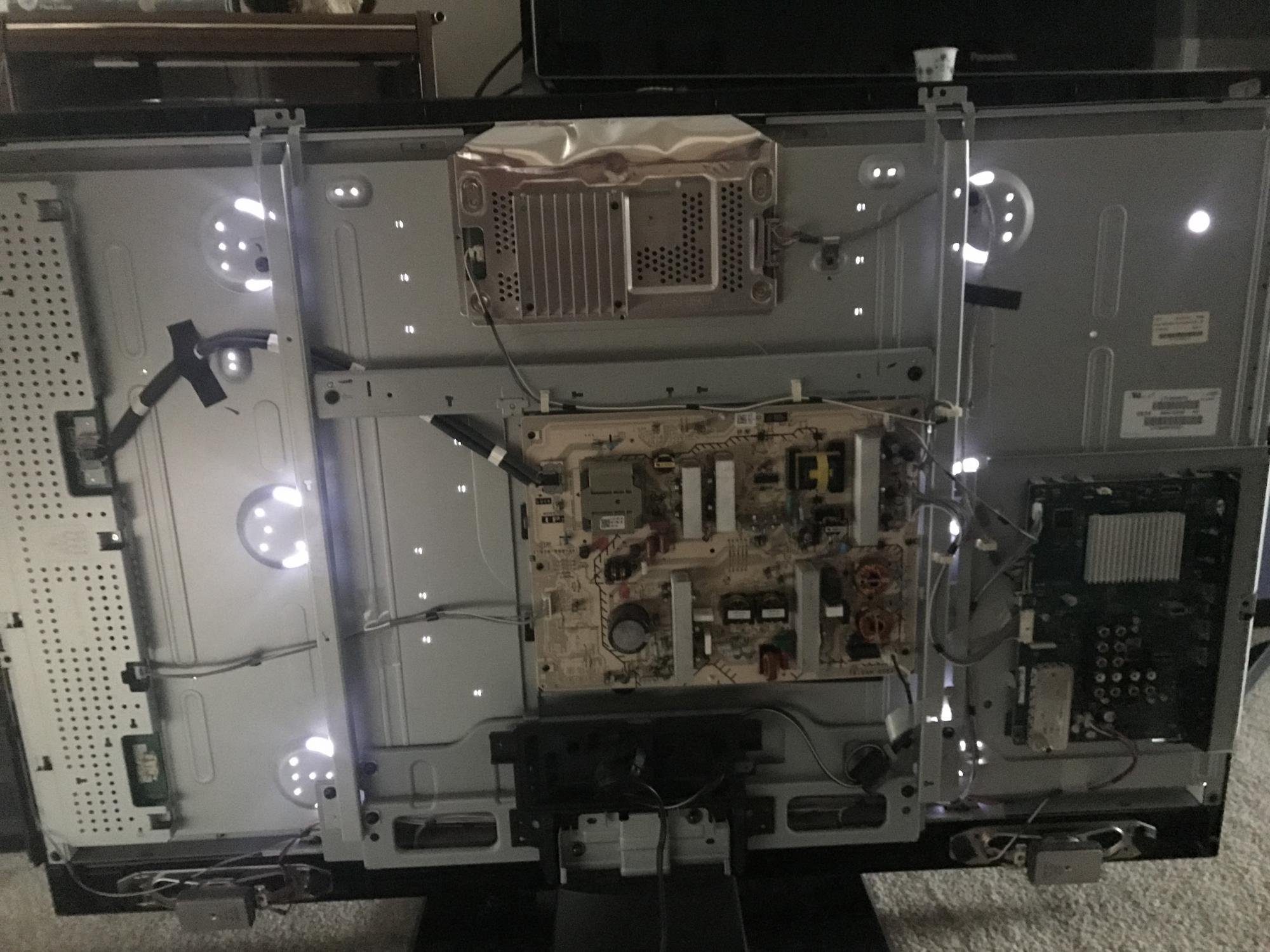

    Picked this tv up for $10. The backlight comes on as seen in the picture but nothing on the screen.
    At this point I'm thinking it's a mainboard issue.
    If needed I can take readings if you want.

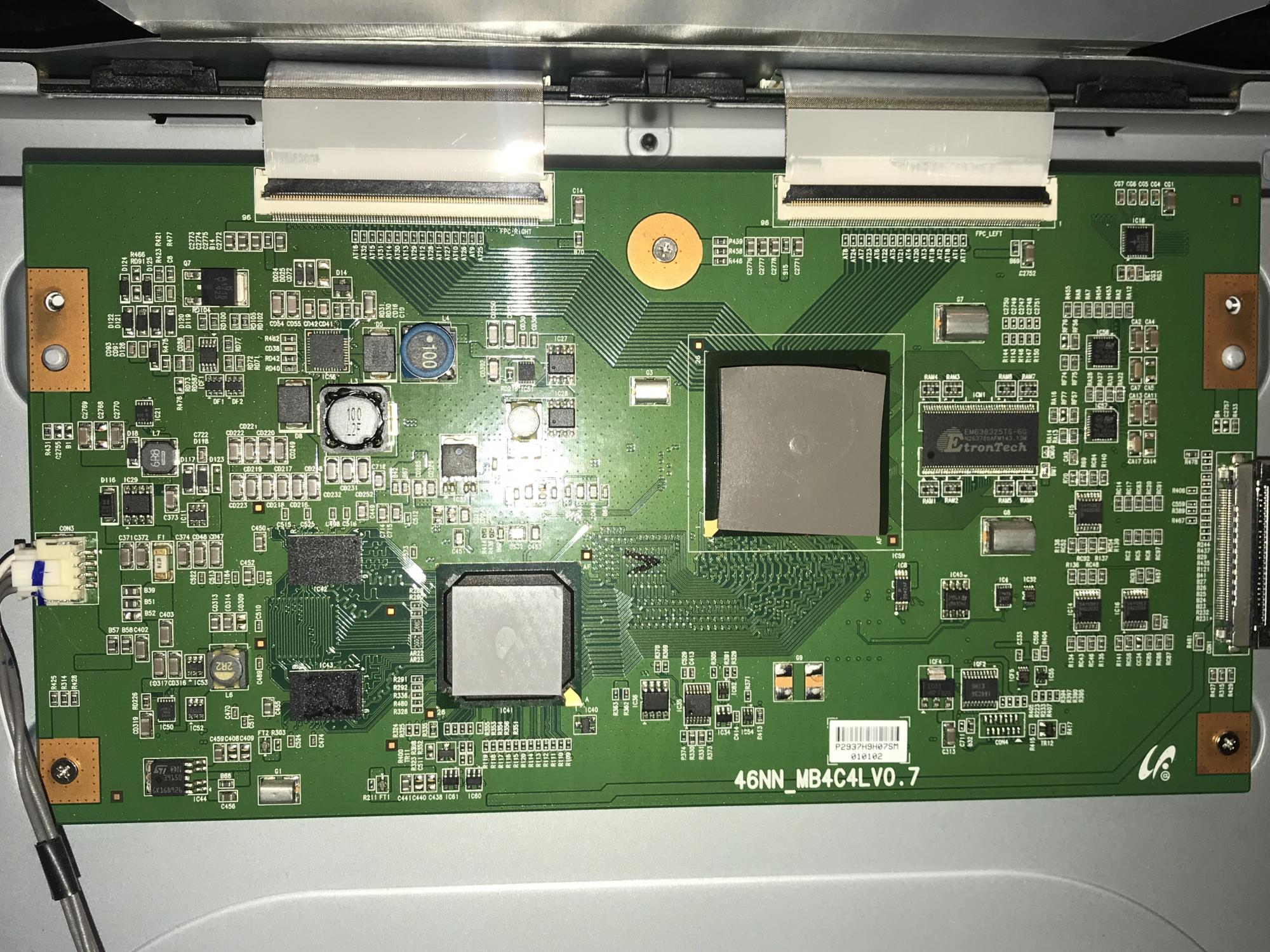

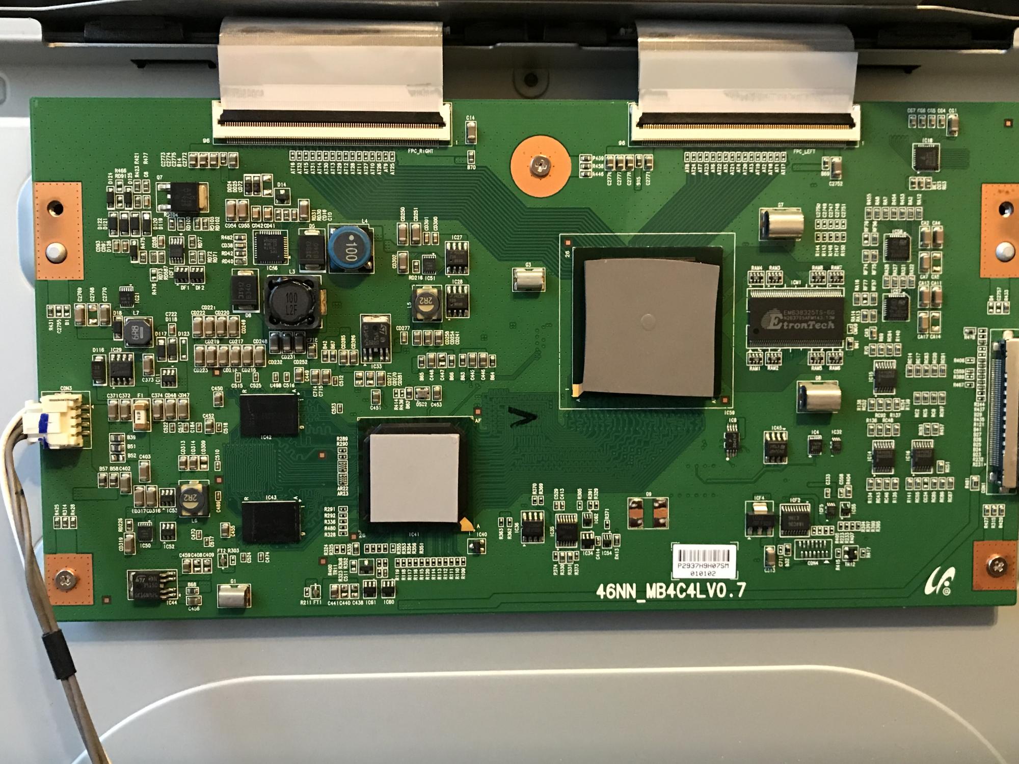

        What happen if you have ribbon cables between T-CON and the LCD panel connected one at a time?
        Can we see good clear pictures of the T-CON board?

          Re: Sony KDL-47V5100
          T-con.
          No change when trying either ribbon disconnected.
                    No, just a solid red standby and amber pic off/timer led.
                    I also just noticed the backlight turns off after about 15 seconds and then come back on. It repeats that, nit sure if it’s because the shield and heat sinks are off of the t-con.
                    I will put it back on this afternoon.
                    Also it doesn’t respond to the side buttons. I have to plug it in and unplug it. I don’t hav the remote.

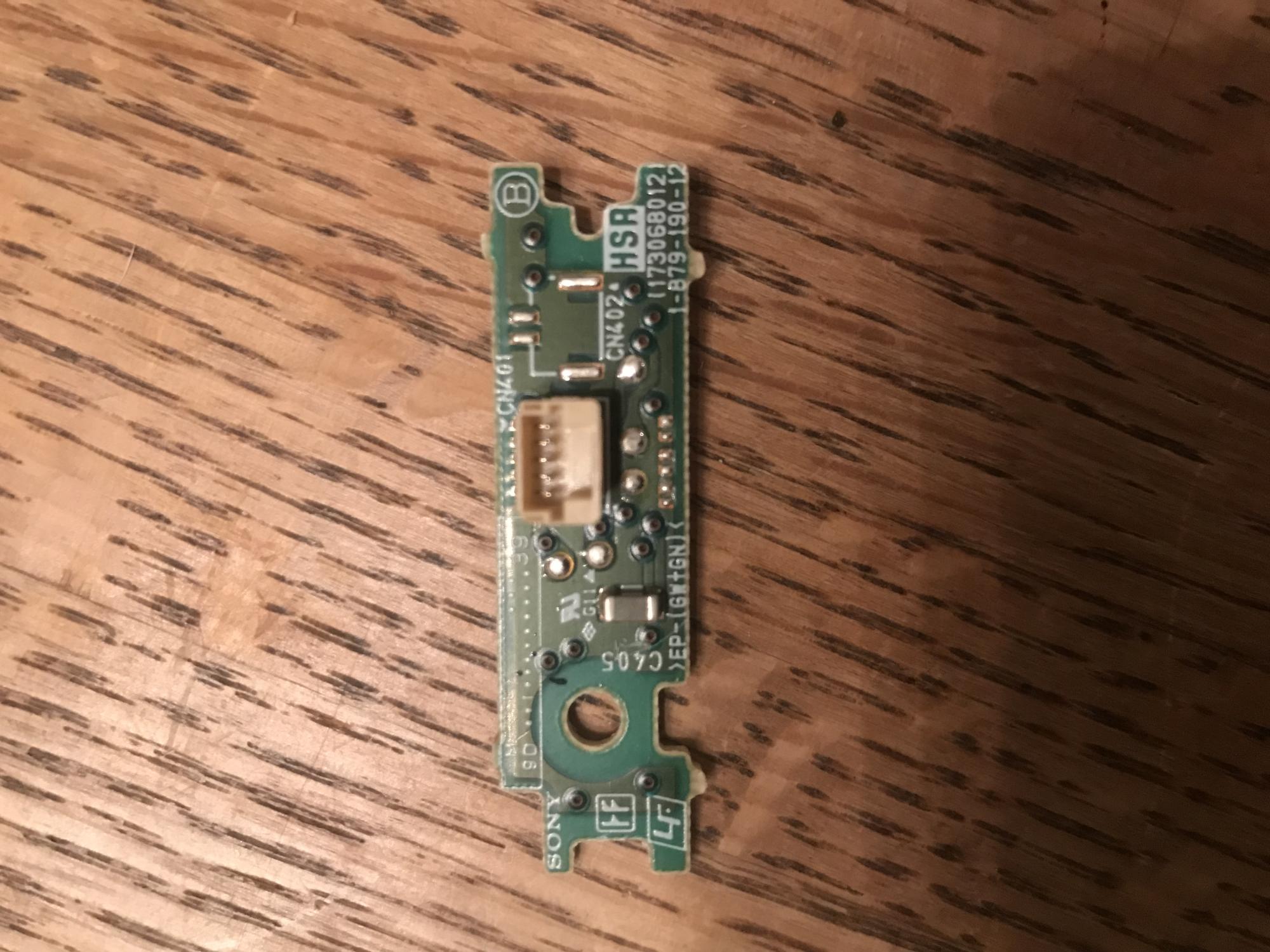

                        Aha, important info.
                        What happen if you disconnect HSR board connector?
                          Already tried disconnecting the buttons. I’m assuming that’s what HSR board is? No difference.

                            Nope!
                            Did you download the service manual to know where HSR board is?
                                Look at shopjimmy link to see what the HSR look like.
                                  Found it, no change. Btw, it's different than the one on shopjimmy. Only 1 connector.
