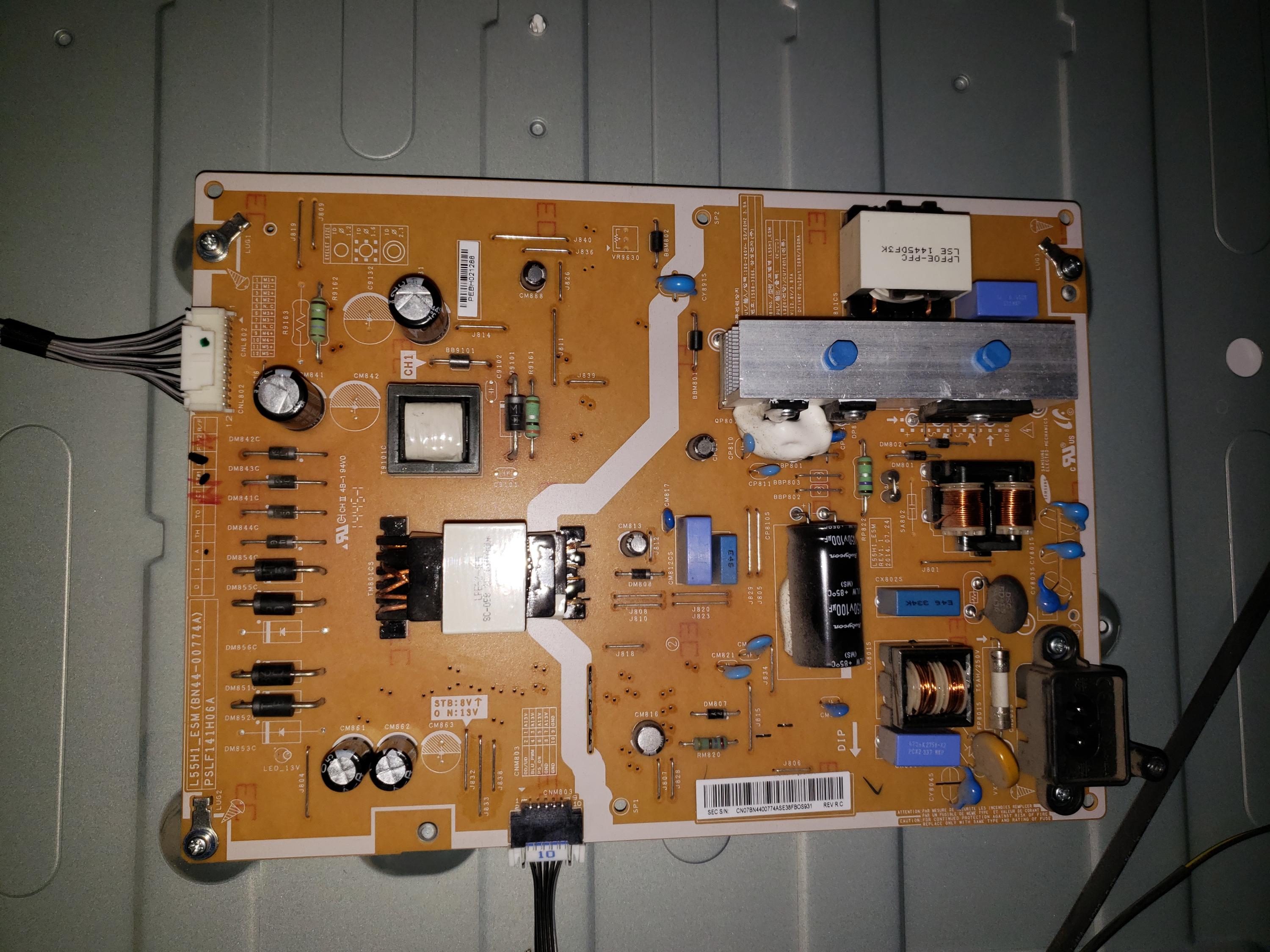

    I stated testing this unit and I had no backlights but I can see a picture with a flashlight to the screen. I started testing voltages at the 10 pin connector on the Power supply board (BN44-00774a) where the main board harness plugs in but and I accidentally touch 2 pins together (I believe it was pins 7 (13volts) and pin 9 (ground) Now I have no picture and no led on t con board. The red standby light come on and I can see the optical red light also illuminate. The backlights were shorted and was my original problem but now I cause this problem.

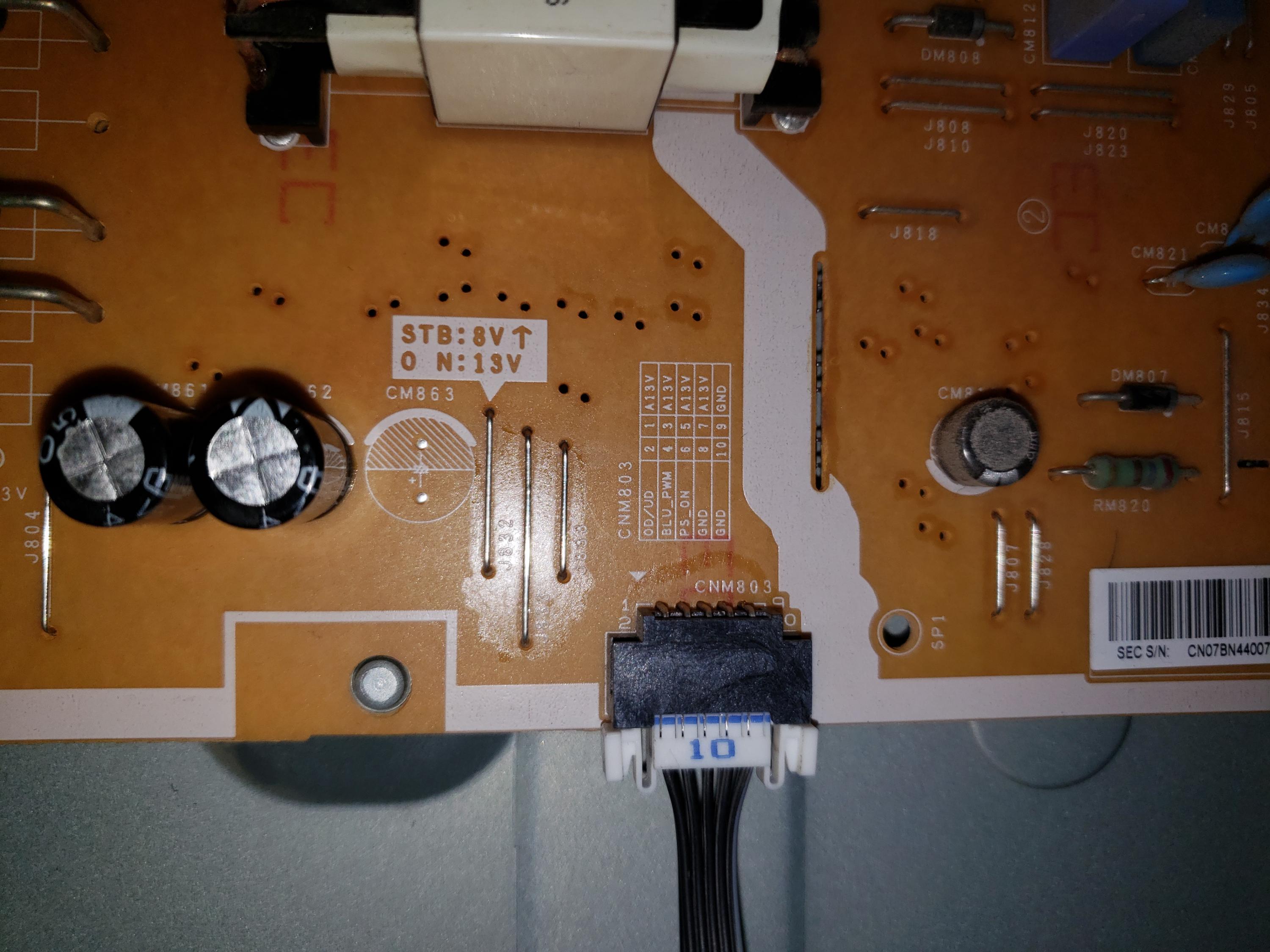

    Voltage is as follows on these pins:
    (1) 12.8v (13v)
    (2) 2.33v (od/us
    (3) 12.8v (13v)
    (4) 3.29v (blu/pwm)
    (5) 12.8v (13v)
    (6) 4.49v (ps/on)
    (7) 12.8v (13v)
    (8) ground
    (9) ground
    (10) ground
    Voltage @ cm863
    11.9v (standby) voltage drops to 10 or so volts when main board plugged in (load)
    12.8v (on) voltage tropes to 11 or so volts (load)
    Voltage @ cnl 802 (output to backlights)
    320v to 280v with main board unplugged
    280v and drops with main board plugged in
    Ps/on voltage drops from 4.49v to under 1v with power on and 4.49v in standby
    The backlights were unplugged during these voltage readings because I know I have to repair them due to being shorted.
    My question is does it sound like the main board was damaged when the pins were shorted during testing or maybe the Power supply got damaged? Before I go throwing parts at this tv I would like to see if there is anymore testing that can be done to be sure. I am not a tv repair guy but I do have electrical background in other areas. Please excuse me if I am not asking the correct questions or not testing what I should be. Any help to push me in the right direction would be greatly appreciated. Thanks.

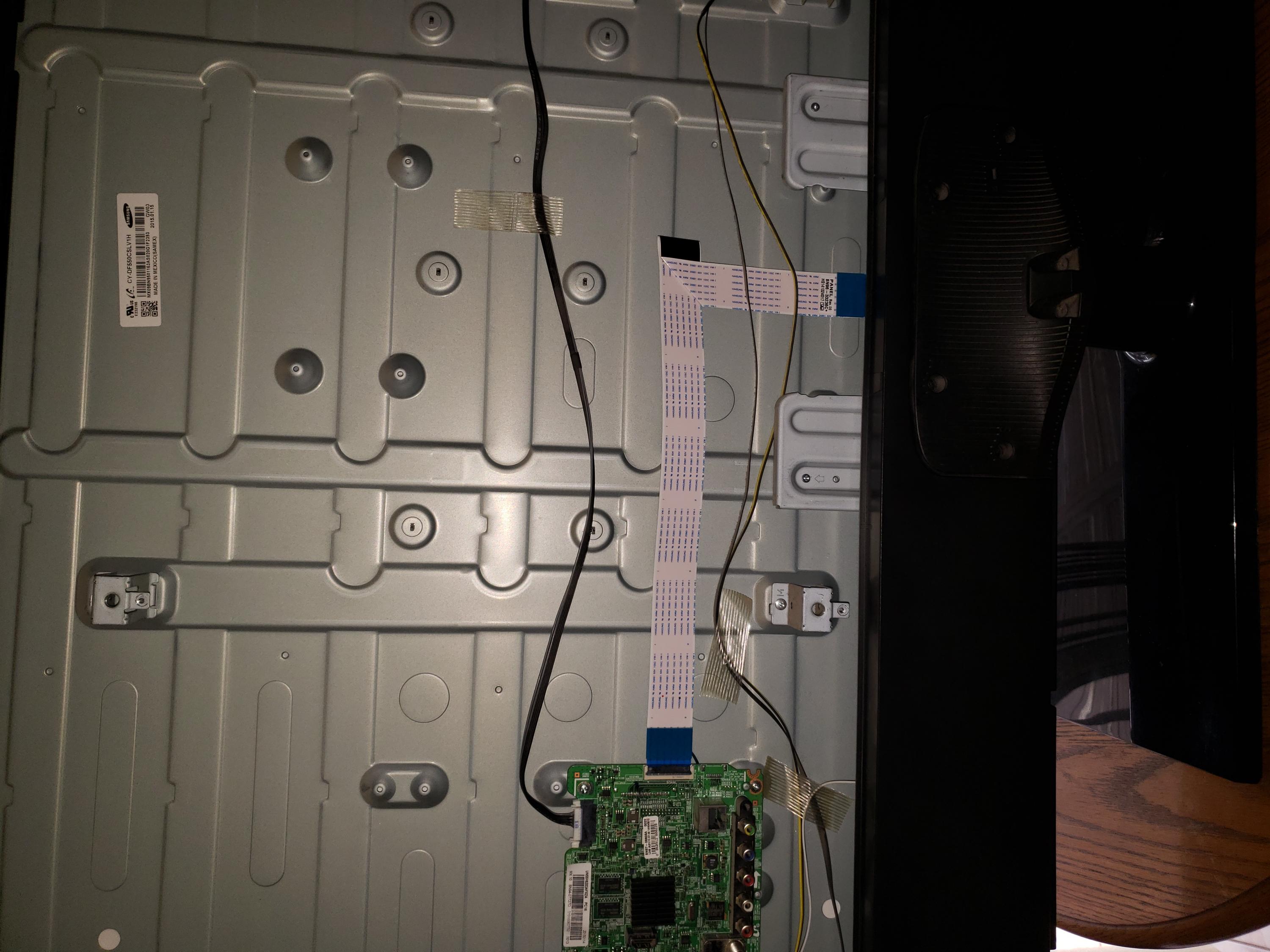

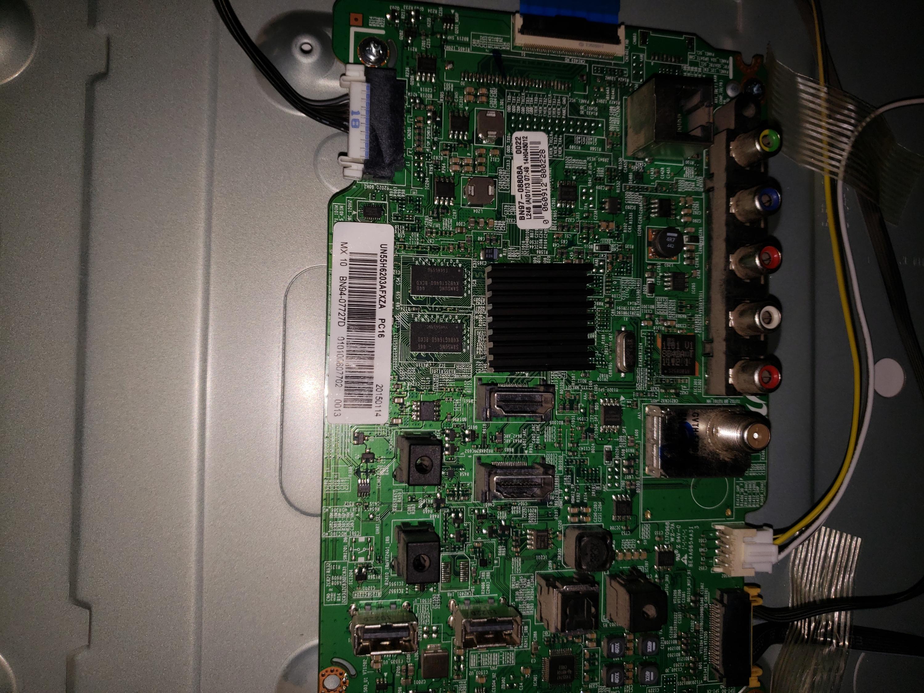

    Throw up some good clear straight on pictures of all the individual boards and one of the whole back to see how they are connected.

          Maybe test those voltage regulators on mainboard, good video there: https://www.youtube.com/watch?v=ocqnqmBxiqY

                Are those the Voltage readings at connector CNM803 WITHOUT connection to the main board? Are these what you are getting right now?
                Post #1:
                Voltage @ cm863
                The Voltage should be around 8V (PS-ON has to be grounded to put power supply board into standby mode due to the fact that the power supply board has Pull up resistors to simulate PS-ON signal when it is not connected to the main board. When main board is connected to the power supply board, the PS-ON will be kept low when TV is in standby mode by the main board, and it will go high when TV is turned on).

                        whats weird is at the test point j832 where it says 8v stb /13v on iam getting 11.5v and fluctuates to 10.5v in standby and 12.8v with tv on.

                                I believe the circuit involved for producing the 4.49v for standby on the power supply is damaged by the short and reads fine until the main board is plugged in and puts a load on it or i have a shorted main that loads up a good power supply. But should the main board have any activity on PS/On pin in standby that will cause it to be low?

                                        Re: Samsung 55H6203FXFA won't power up
                                        It may be that the switching circuit (8V to 13V is damaged).
                                        Did you remove the power supply board and inspect the backside?
                                        But the thing is that in your post #1:
                                        At that state when TV is off, the PS-ON is low and with main board connected the standby did go down below 10V, correct?
                                        Can we see the good clear pictures of the whole backside of the board?
                                        Beside, when the 13V is present when TV is turned on, the TV should function normally since it has the required 13V to fully run all the functions.
                                        In this TV instead of having 5V STBY power supply and the second power supply for the 13V, it uses only one power supply for the main board that switch between 8V (TV off to save power) and the 13V when TV is fully on to save money.
                                        BTW, when TV is turned on, do you get switched 12V to the T-CON board?
