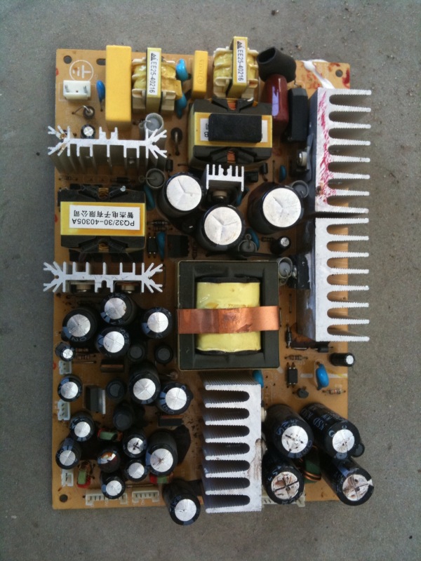

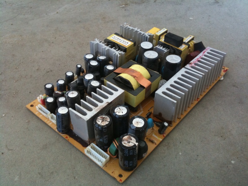

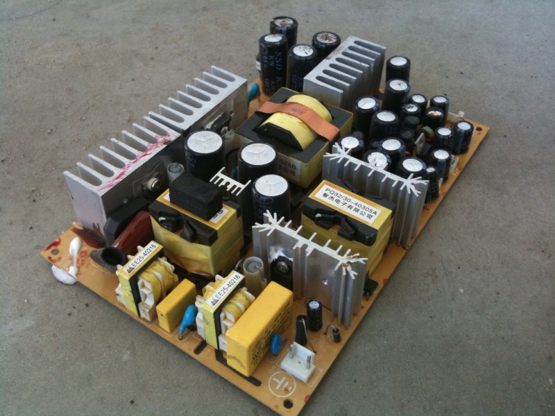

    Akai LCT2662 with bad caps
    I received this TV for free from a friend. He had already opened it and gave it to me in pieces. Not sure what symptoms the TV suffers from but I suspect it doesn't even turn on.
    Lots of bulging/spooging caps on the power supply. Here is a list of the caps:
    (8) 2200 uF 25V
    (4) 3300 uF 35V
    (7) 1000 uF 10V
    (1) 1000 uF 6.3V
    (4) 100 uF 25V
    The three big caps in the center are marked like this (going to replace them as well):
    (1) ZS 47uF 450WV
    (2) LX 100uF 450WV
    All caps are temp rated at 105 and are KSD Brand. I plan to recap all of them, just thought I'd post here and see if anyone has any thoughts/opinions. For example, should I consider increasing the voltage rating on a few of these caps, or would simply replacing them with good quality caps of the same rating suffice. Anything else I should consider?

    Re: Akai LCT2662 with bad caps
    Increasing the voltage rating doesn't buy you anything. They're not failed from overvoltage, just crap caps.
    >>The three big caps in the center are marked like this (going to replace them as well):<<
    Good! Somebody's paying attention.
    >>or would simply replacing them with good quality caps of the same rating suffice.<<
    Yes.
    Check the connections on all the transformers. Common to have bad joints there.
    Toast

          Man I haven't seen so many hatched caps so close to each other it looks like Alien in there .
          Are there any caps in there not getting baked by a transformer or heatsink?
