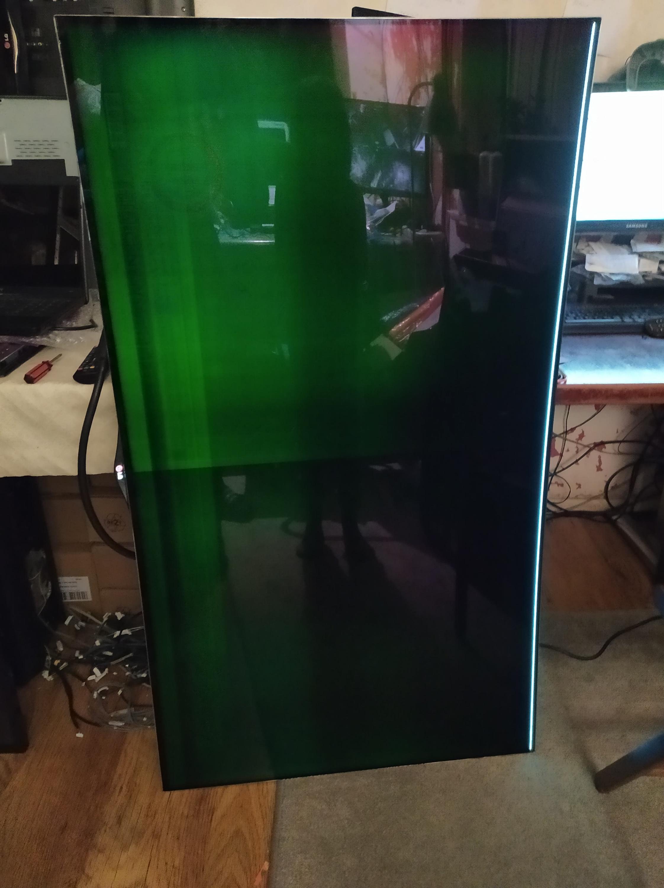

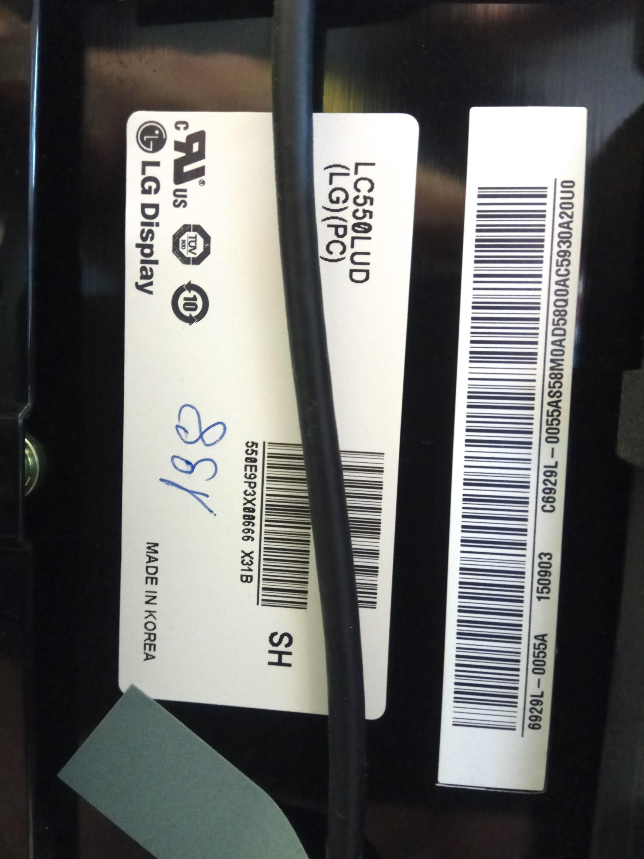

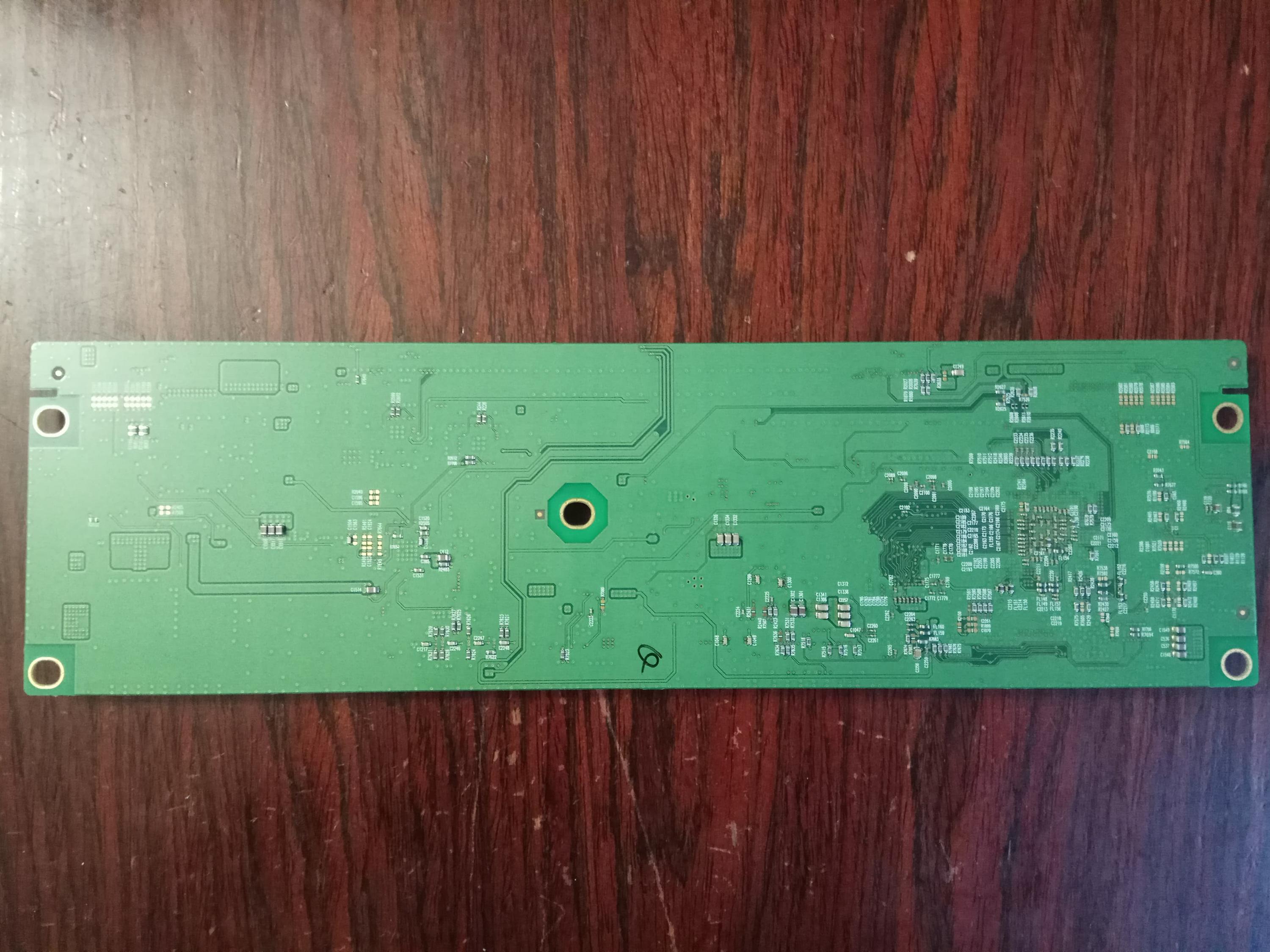

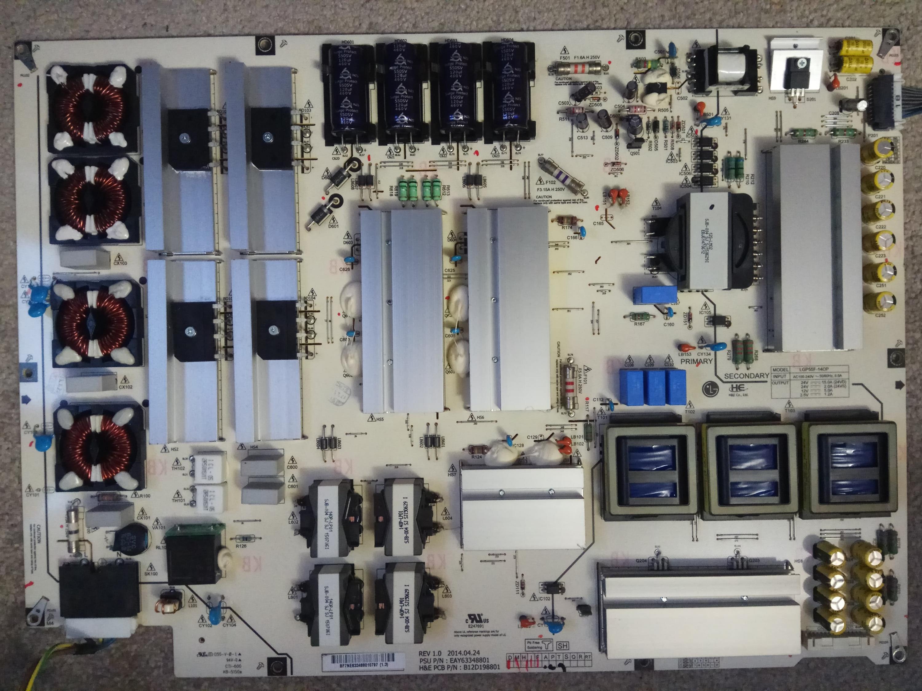

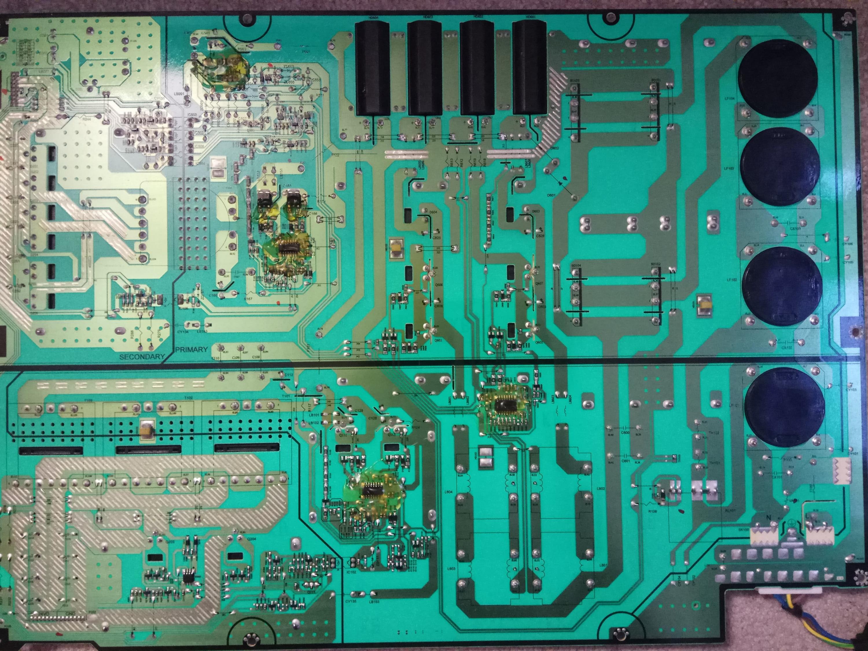

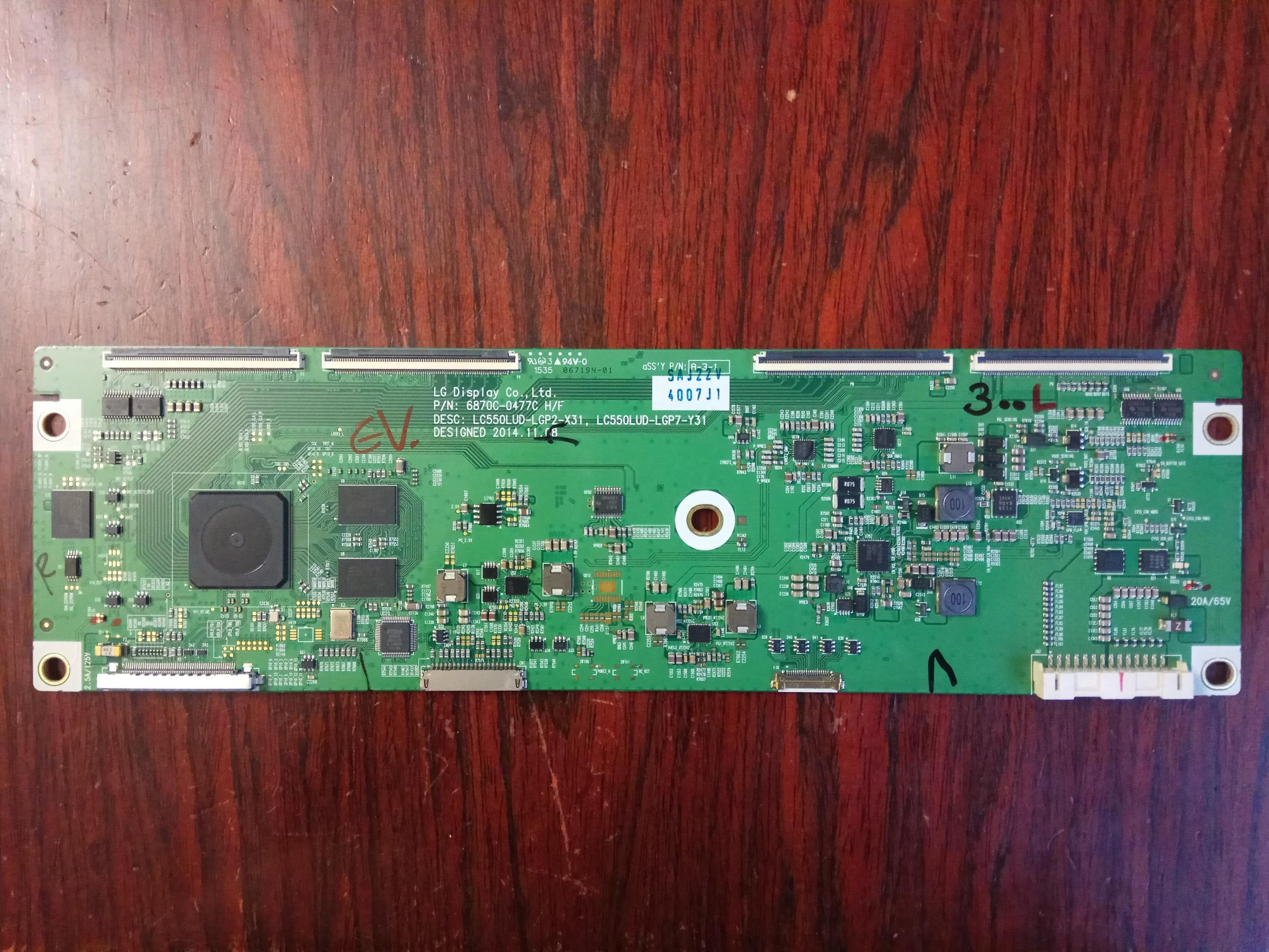

    I've bought faulty OLED TV. When pressed power button it Powers on for 2-3 seconds. Relay clicks for on and then off click. LG logo fades out.
    Checked power supply according to OLED SMPS Testing manual.
    All voltages fine. Bulb test fine.
    Installed MyRemocon on android device with IR. Pressed "power only" button. Got same cycle like with normal remote.
    Inspected LVDS and can 4 cables that goes to panel. Panel cables as new. LVDS contacts slightly discoloured. Cleaned with contact cleaner and brush. No changes.
    As member Diah offered disconnected middle two cable going from T-Con to panel. Pressed "power only" this time I've got difference.
    TV screen switched on for 1-2 seconds. I could see some green background and a bit of round shape left hand corner, and white horizontal line over top the the screen.
    Do I have dead panel and TV does not want to start due to it?
    I have attached part and screen photos just in case you need.

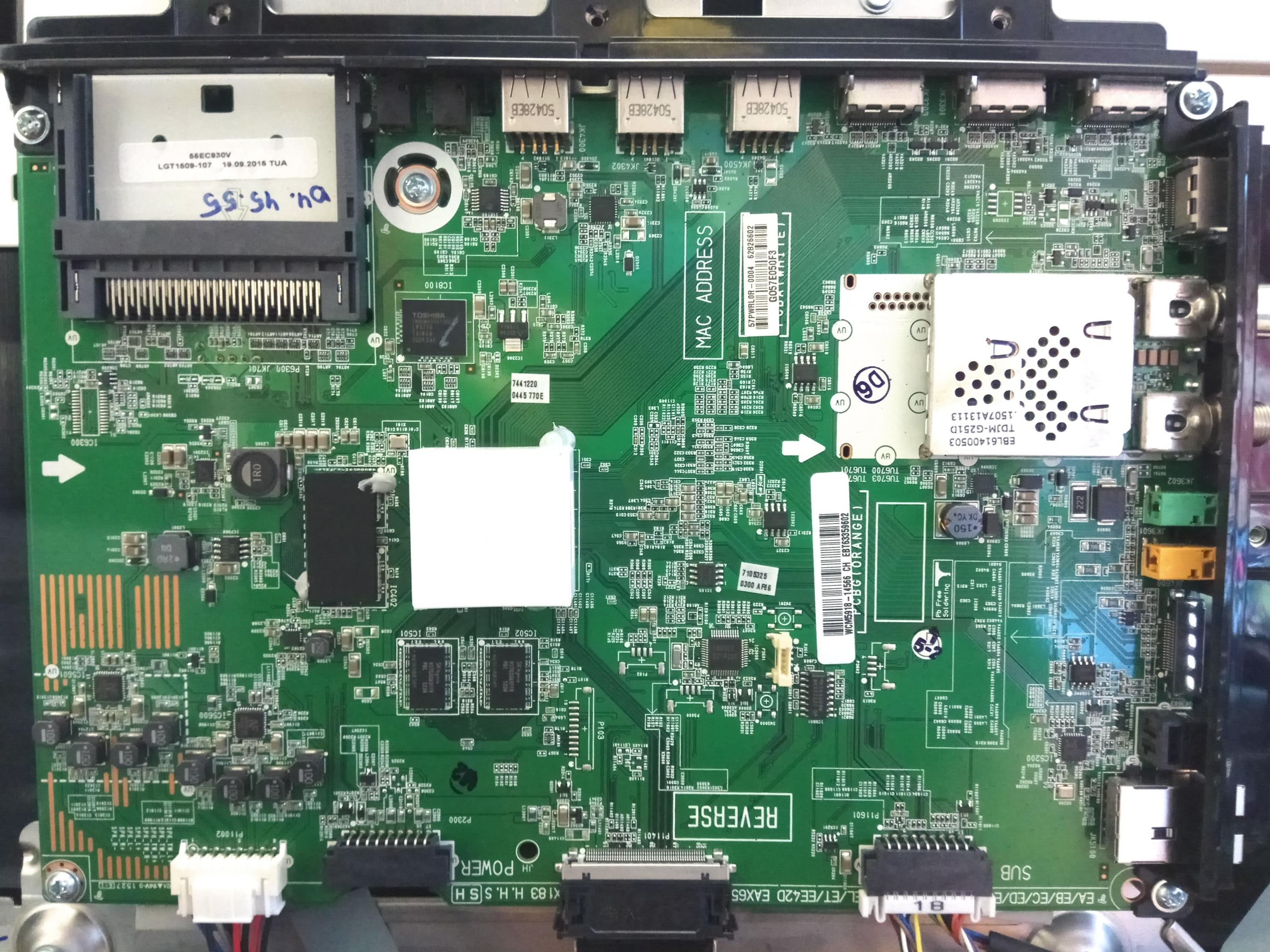

    Re: LG 55EC930V OLED Is panel OK?
    uc18 looks strange on the pic . maybe photo angle .
    • lin4sm
      • Sep 2011
      • 67
      UC18 was under silicone thermal pad. Marks on chip are from the pad.
        put all sockets in place...only the LVDS disconnected from Main boards side.. feed it with HDMI signal on HDMI IN 1 while the feed signal played turn the set on.. give attention to the speaker if it make any noise or sound.. report the result
            don't use the apk power only.... use always the power key on the set.. keep the lvds disconnected at test
                read the 12 V and 24 which goes to MB when you power on the set... tell the value and if it goes high or low before turn off
                  do the same as my mentioned while LVDS connected and write the value of 12 & 24 v which it feed the MB
                    When I was reading 12 and 24 volts without main board doing SMPS testing.
                    P201 11.9 V and 24.6 V. P202 24.1 V. P202 after some time with car bulb dropped to 24V exactly.
                    When all cables connected I get different readings.
                    P201 11.8 V, 25.2
                    P202 1.2 V
                    Panel or t-Con drawing too much power?

                                      Ar you sure that its main board fault? When yesterday I did tests, screen had white line.
