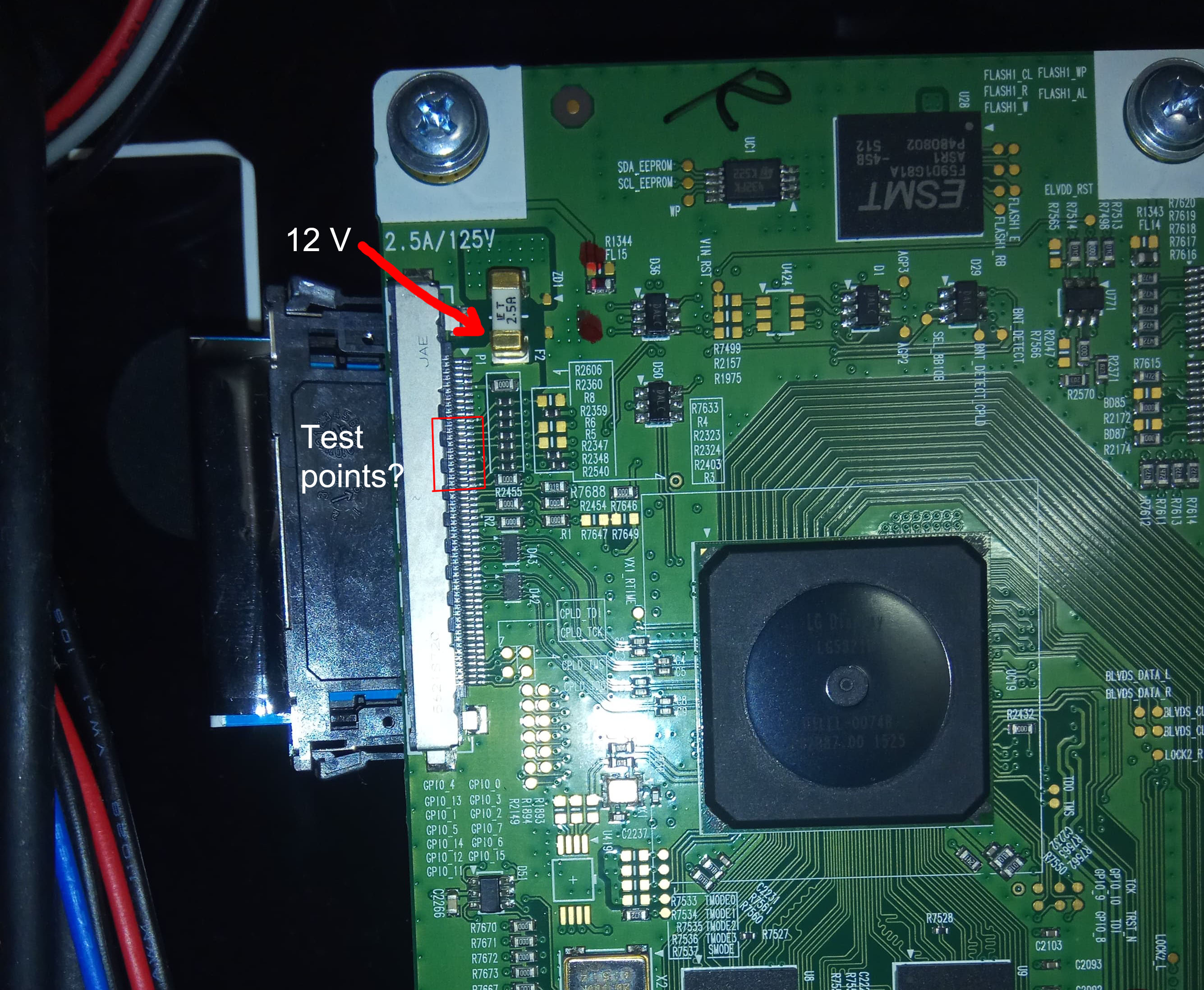

      • lin4sm
        • Sep 2011
        • 67
        Re: LG 55EC930V OLED Is panel OK?
        I want to double check that I would not make mistakes.
        In the photo I have market where I will connect 12 V.
        And I will need to test screen on pins that I have marked in red square, am I right?
        Is it OK to use external power supply for 12V?
        • Diah
          • Feb 2013
          • 6599
          1- the 12 volts point correct on F1
          2- the test points correct...but you can skip them if you had at first turn on one color screen
          3- you can not use external Power. it should 12 V from same source of the PWB which supply the screen driver 24v. if you in case used before out source 12 then you had toasted the driver... hope you didn't lol

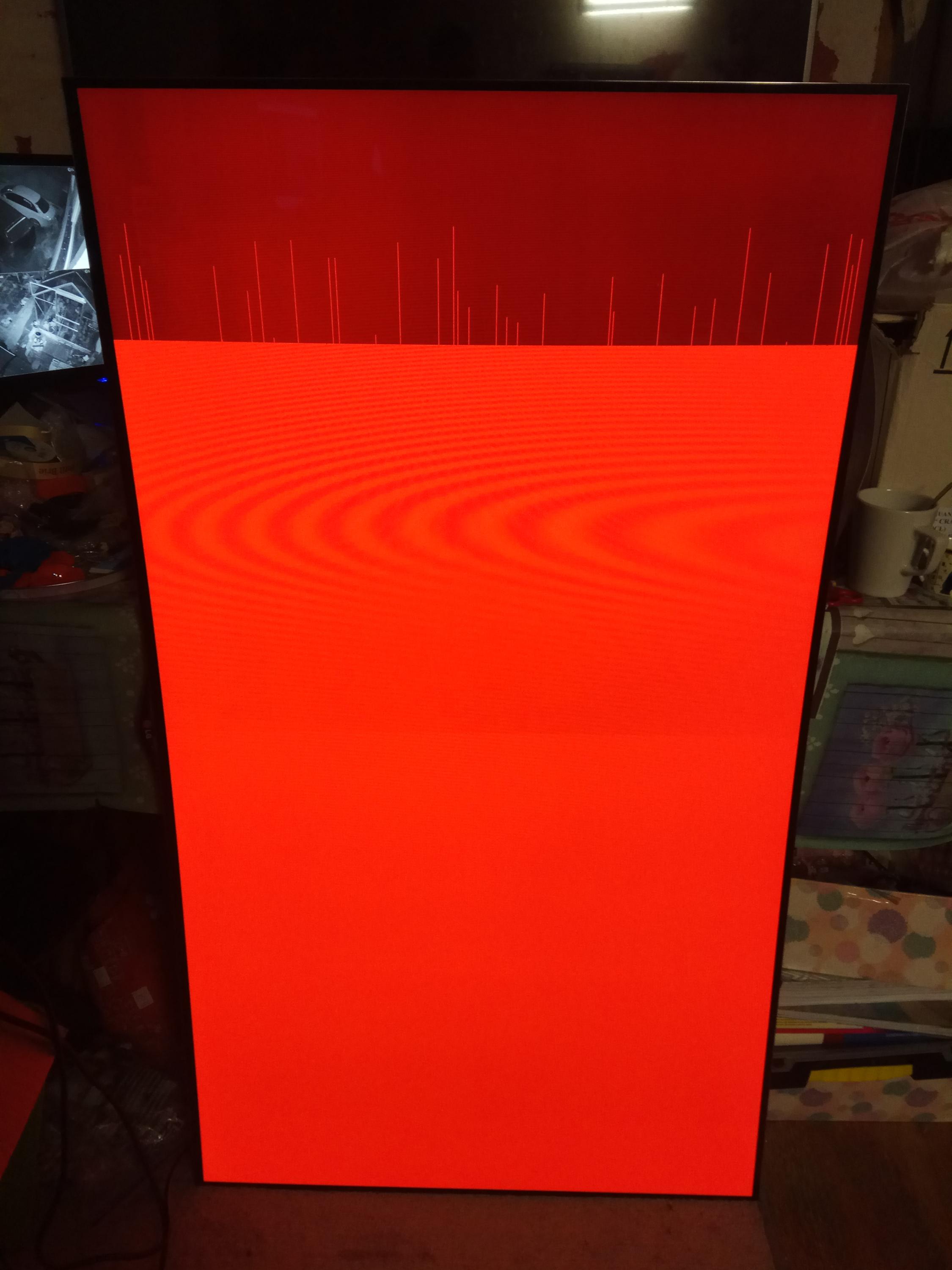

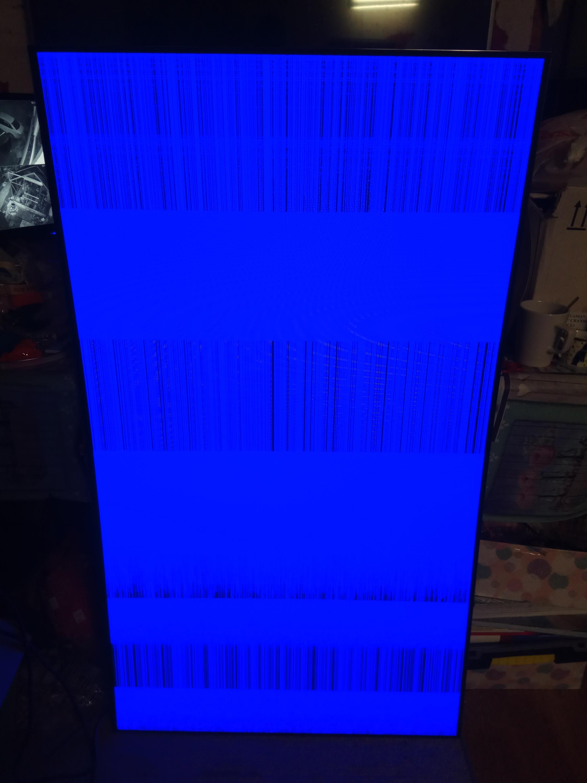

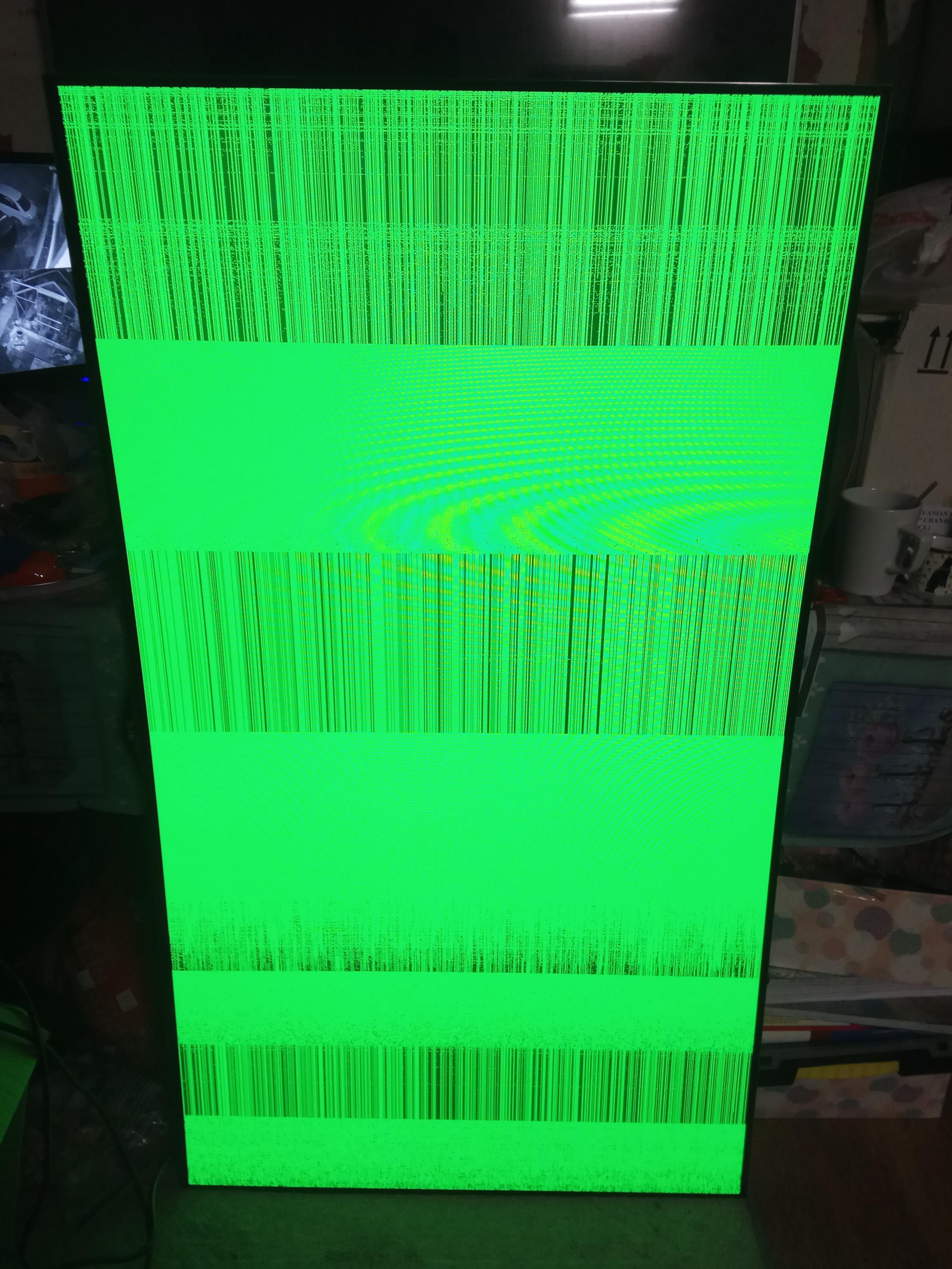

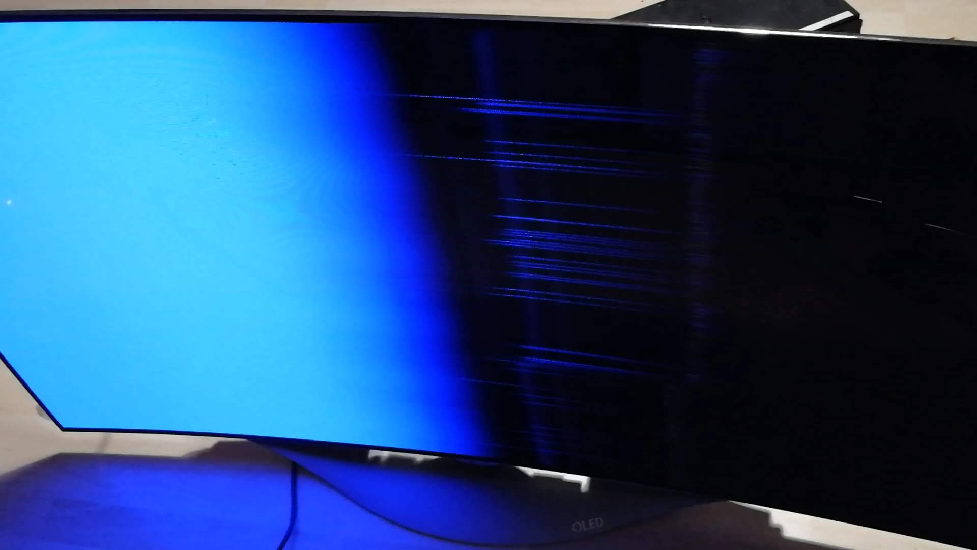

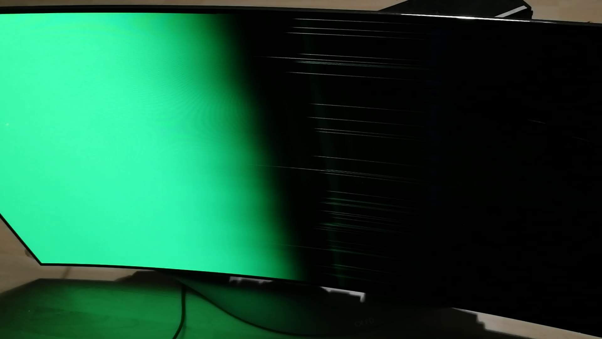

            • lin4sm
              • Sep 2011
              • 67
              I've got test pattern when turned power supply on. Did not do test points.
              I get green, red, blue, white, black screen. All colours has specific distortion, see attached photos.
              • Diah
                • Feb 2013
                • 6599
                i read before you get out the cooler silicon from the T-CON IC.. put it back, and be sure the ribbon cable you you before disconnected are sitting in place.
                then let the test run again. keep it running for at least 30 minute to clear cells
                you should after time to see the one color will be clear as the red screen but on all scree.
                at this condition .. yours panel / T-CON don't need signal (P) test

                      #30
                      Change the oled panel.

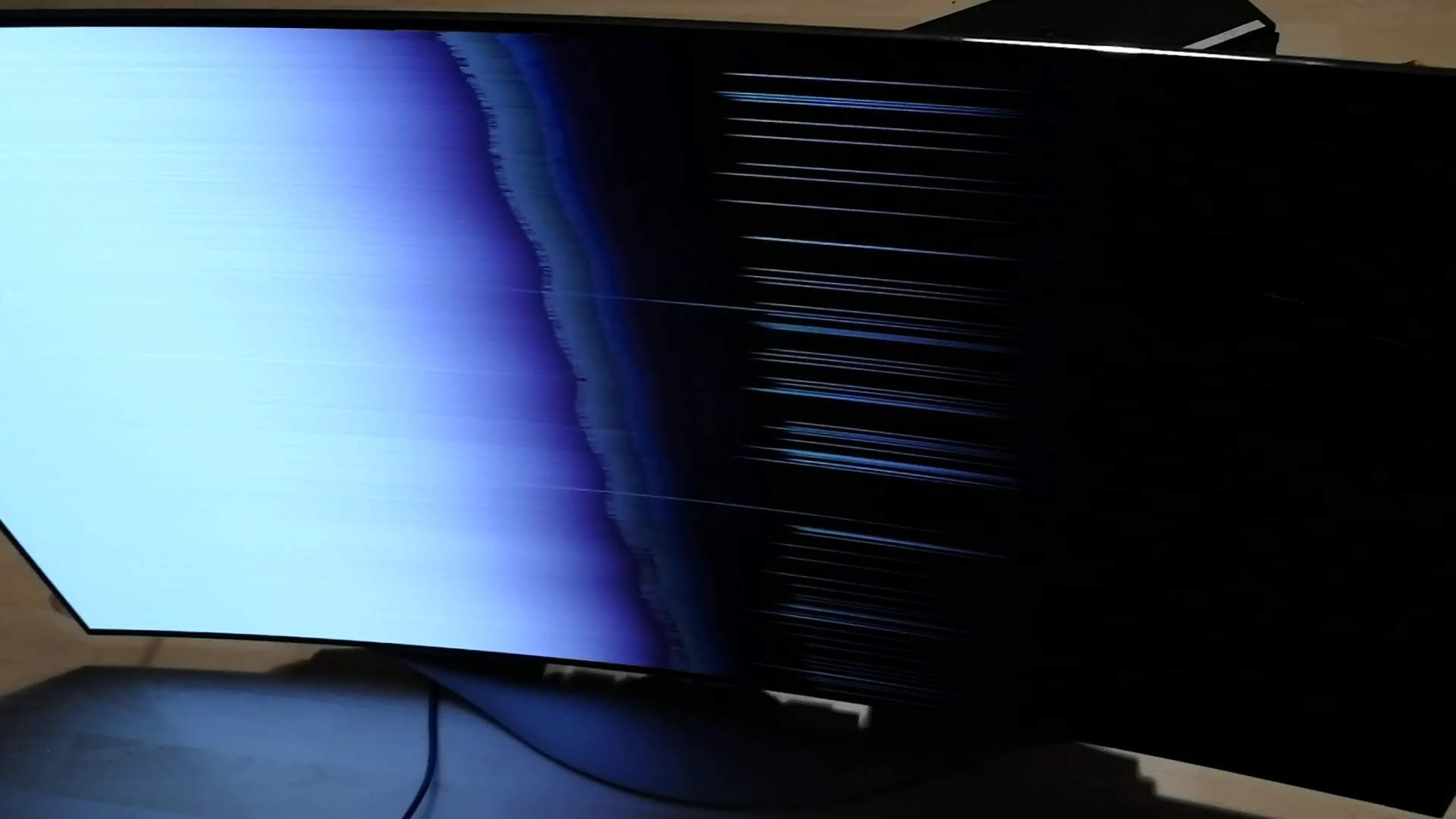

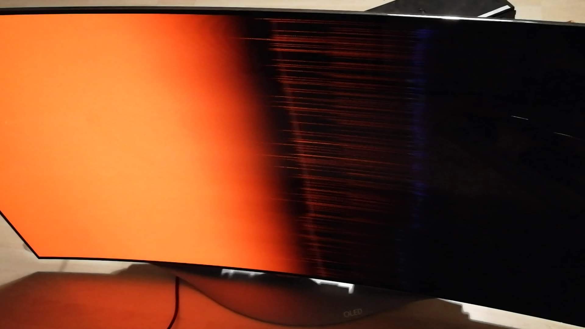

                      • romulus123
                        • Jun 2015
                        • 8
                        • Belgium
                        #31

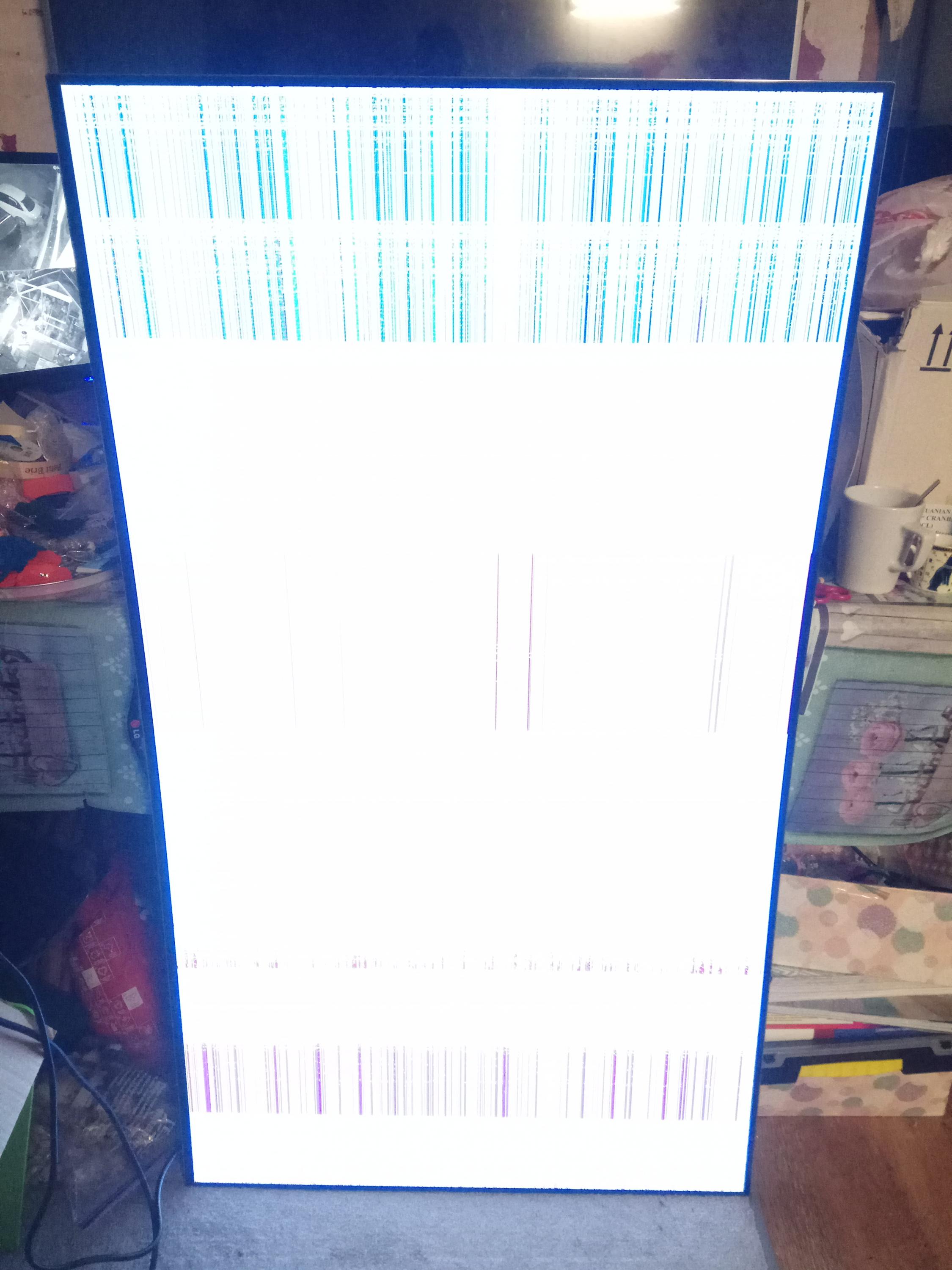

                        I have the exact same problem with a 55EC930V.
                        Here is what happens with the "self-test" procedure explained by Diah.
                        Should I try to replace the T-CON or can I consider that the OLED panel is dead ?
                        Thanks !
                        • Diah
                          • Feb 2013
                          • 6599
                          #32
                          half dead.. LOL
